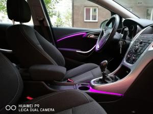

Dobrý den,    toto je mé " domácí" osvětlení.
https://www.youtube.com/watch?v=QYMsjBEkz-Q&t=5s

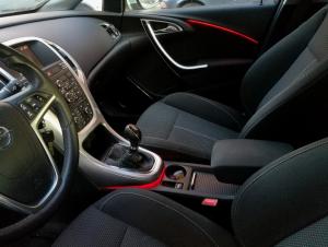

Hi,
i have in plan something lake this. Only for rear door. In front there is already ambient light, so that part i dont wont to touch.
I will buy this, and put in rear:
https://www.ebay.com/itm/Red-Car-LED-Int...1438.l2649
Maybe in future in front to...

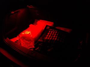

Using this guide I fitted led's to the footwells and boot, found it easier to take the feed from the roof lights, now fade with the interior lights cool, much brighter than the pics show.

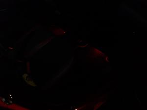

Hi,
First of all thanks for your time..
Could you post all the pictures again?
Some of then ara invisible or not focused.
Thanks

Can the colour of the ambient lighting in the doors and geer stick be changed?
