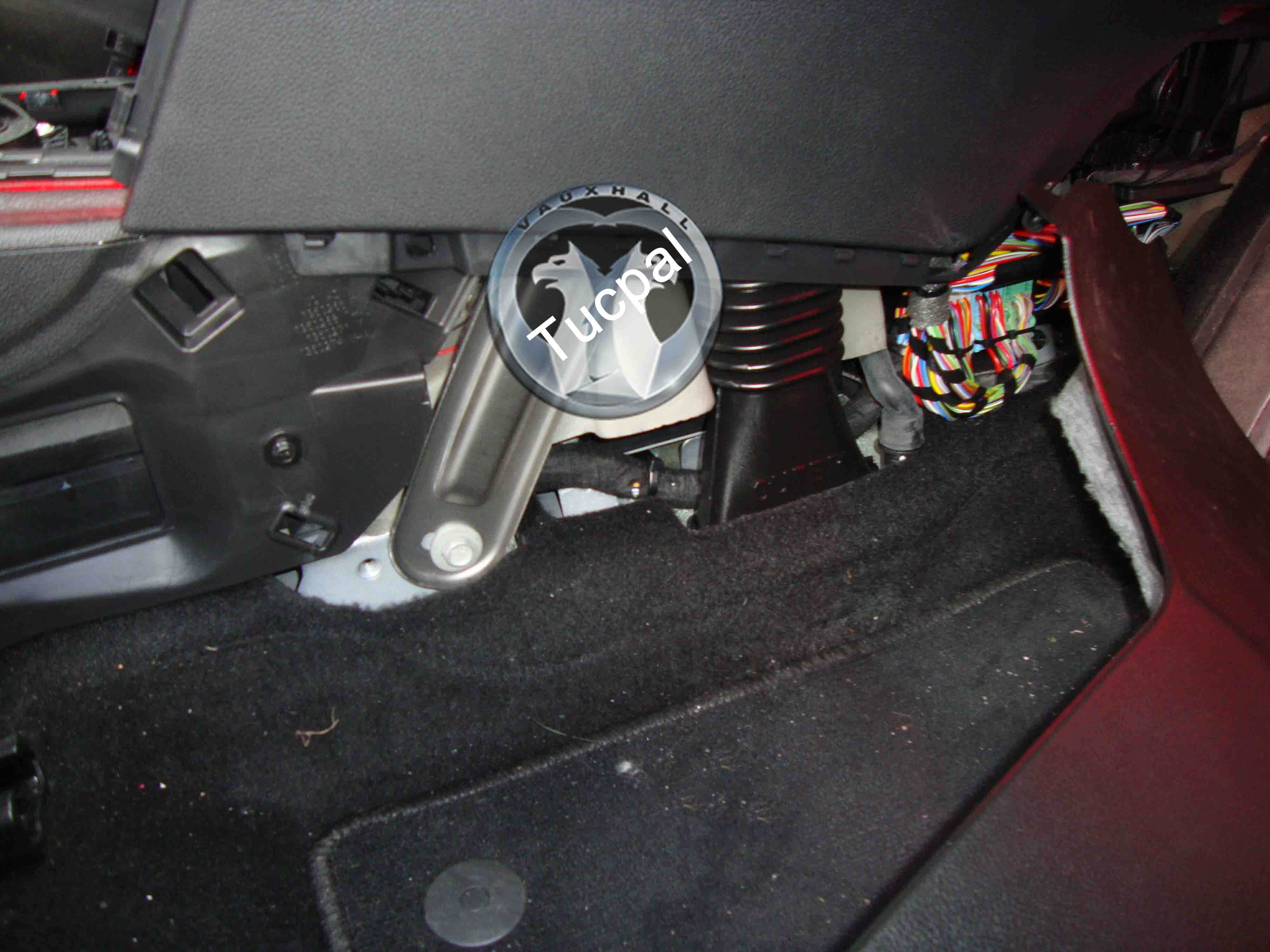

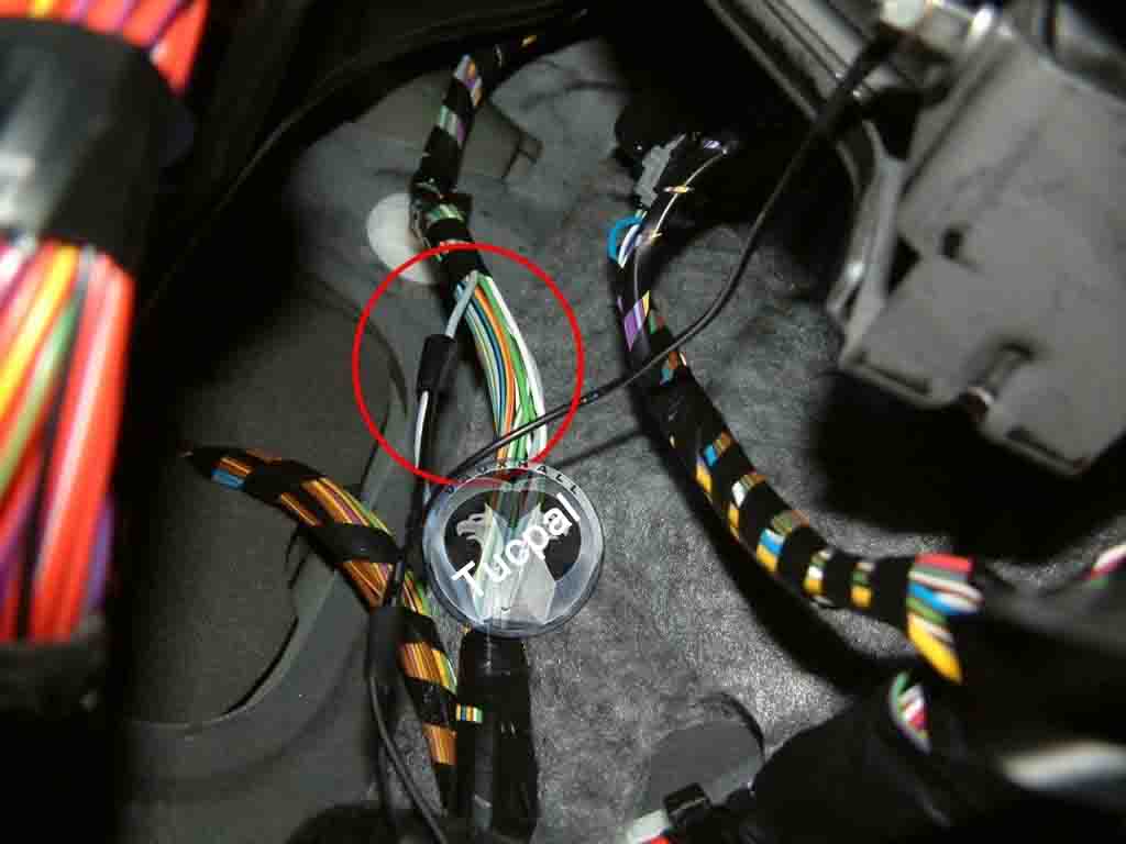

Look just Behind the Fuse Box
and Pull the top Left Hand Side of the Carpet back
and you will see Three looms there.
[Image: 4.JPG]

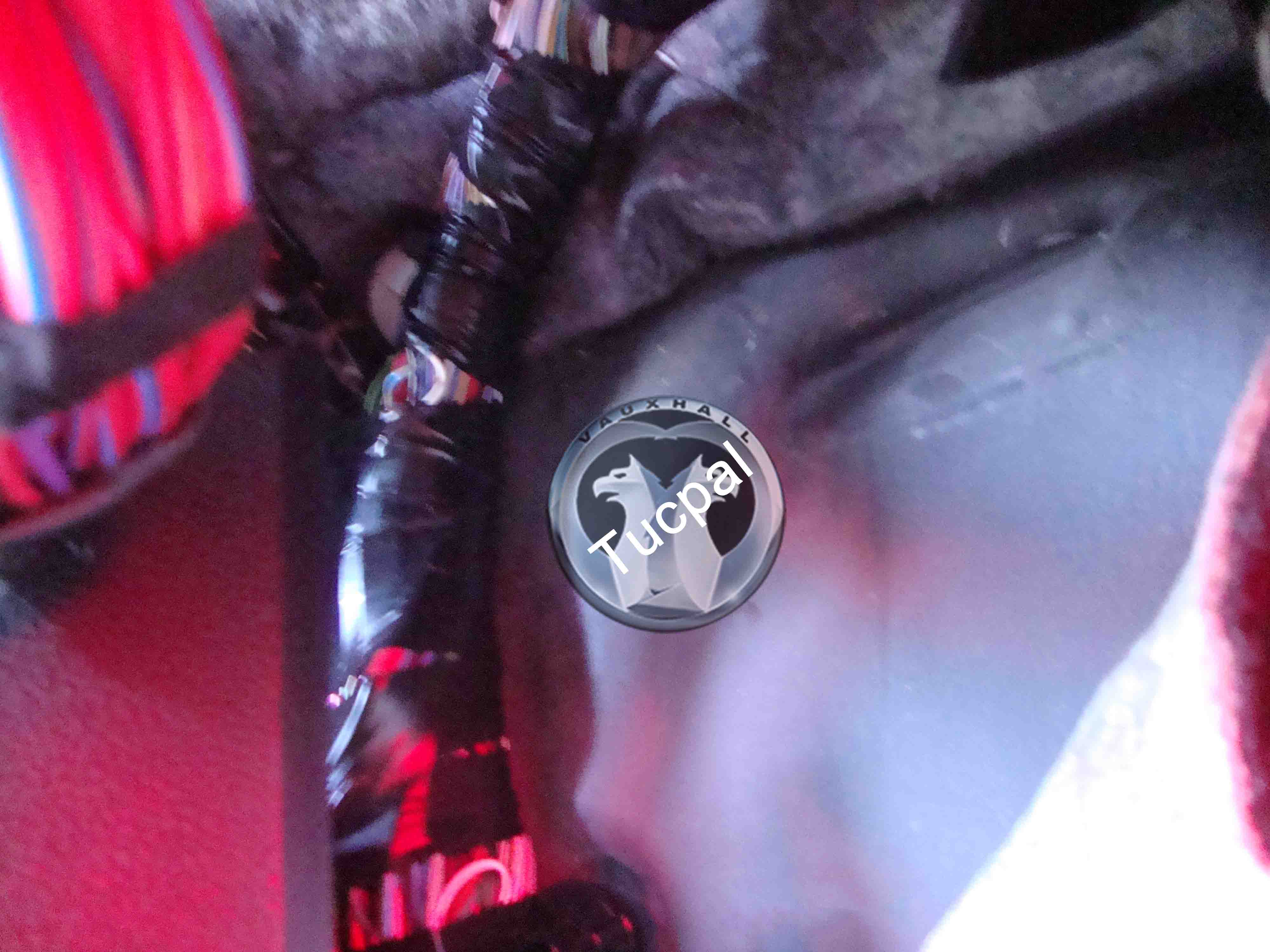

The loom that you want is the Loom
that Goes up the A Pillar to the Headliner.

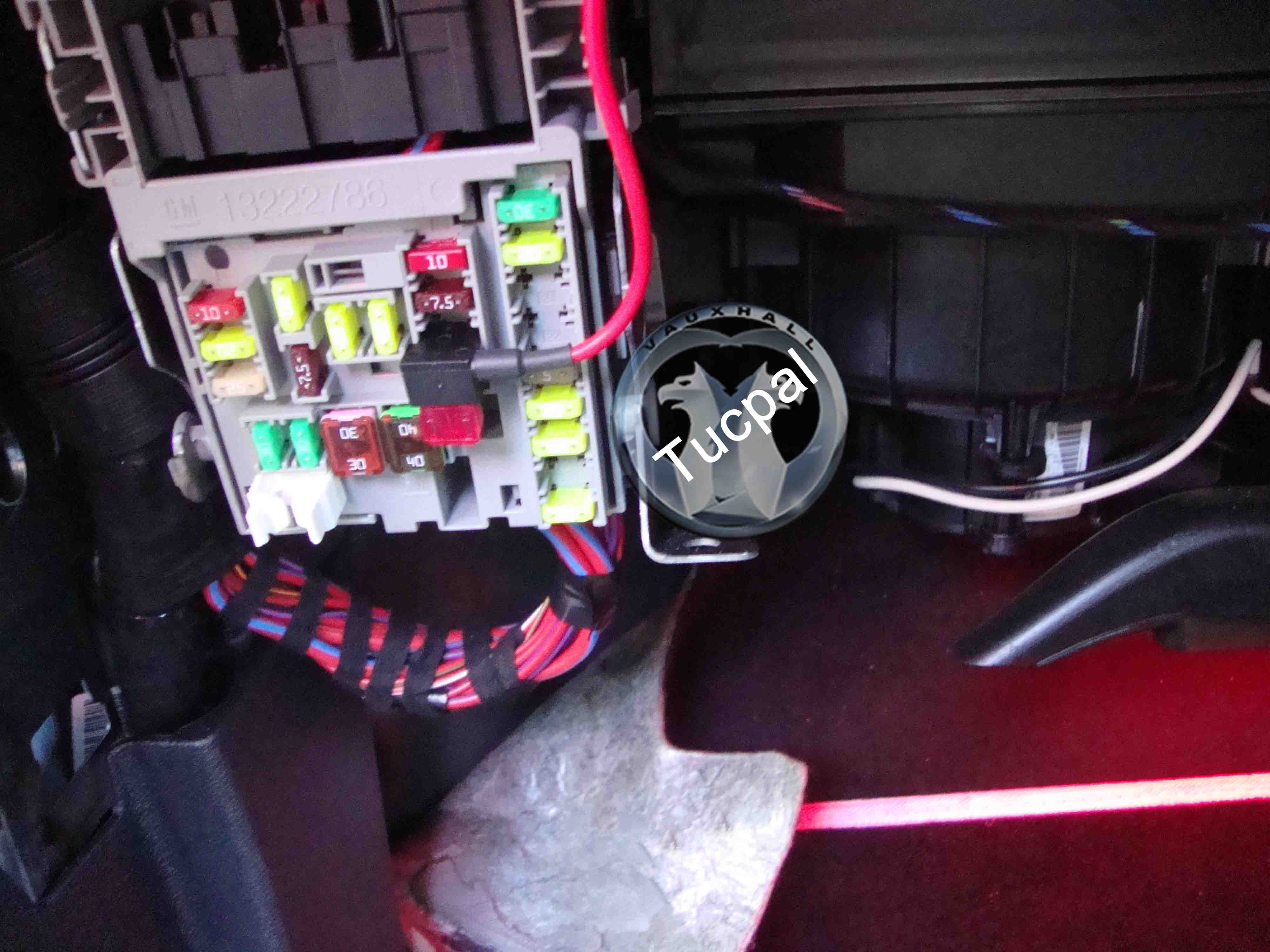

[Image: 5.JPG]
[Image: 6.JPG]
You need to Remove some of the Black Insulation Tape to get to the Wires on the Loom
& find a (GRAY) Wire there are (THREE GRAY WIRES) you need the (THICKEST ONE)
that is the Positive Wire And then Find a Black Wire
That is the Ground for you LED’S.

Splice one Wire to the (Positive, Grey) and One Wire to the (Black, Ground)
make sure you Have the Correct amount of Wire
you need to Reach the first LED in the Passenger side.
Look around for a good Place to fix the LED LIGHT
I Fixed it with zip Ties to the Heater Blower vents
then add the Power & Ground to the LED Light
It will now Work just Open the Door or Press the Button on the Light Unit in the Headliner
and the LED will Light up But Keep the LED
Out the way of Passengers Feet so it Does not get knocked off.

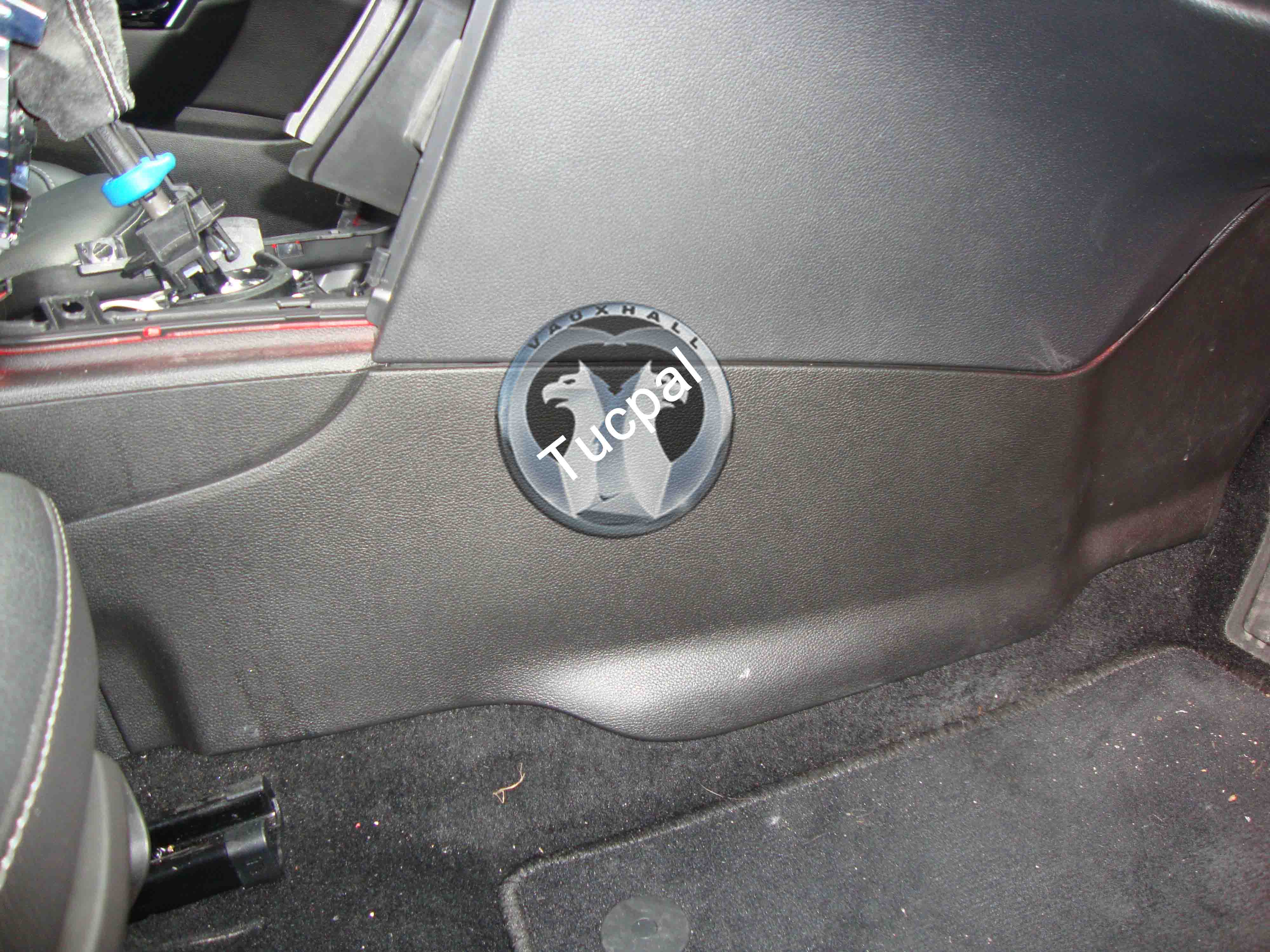

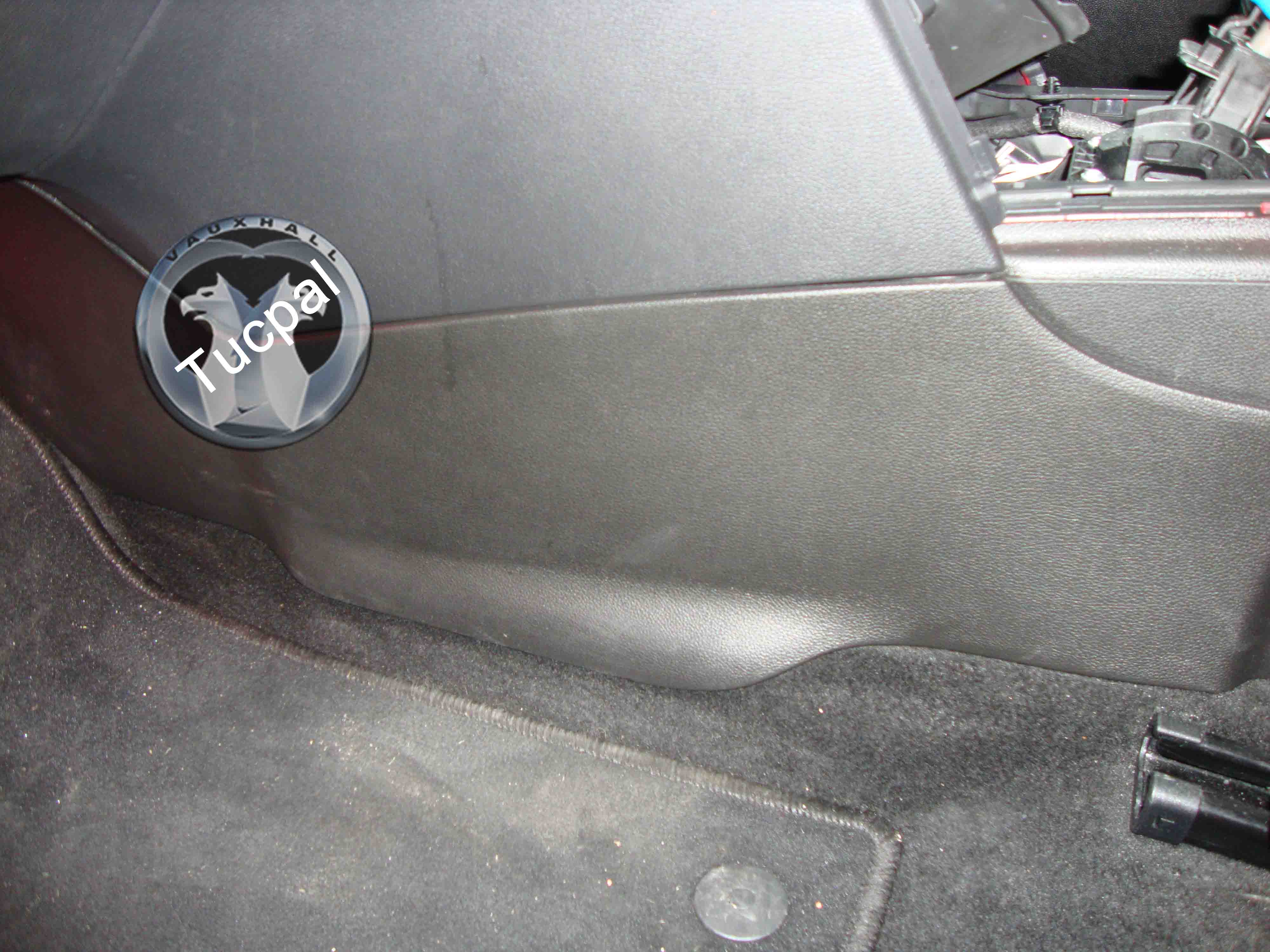

Remove the Side Trims from both Sides of the Center Console they just Pull off.
[Image: 8.JPG]
[Image: 9.JPG]
[Image: 10.JPG]
[Image: 11.JPG]

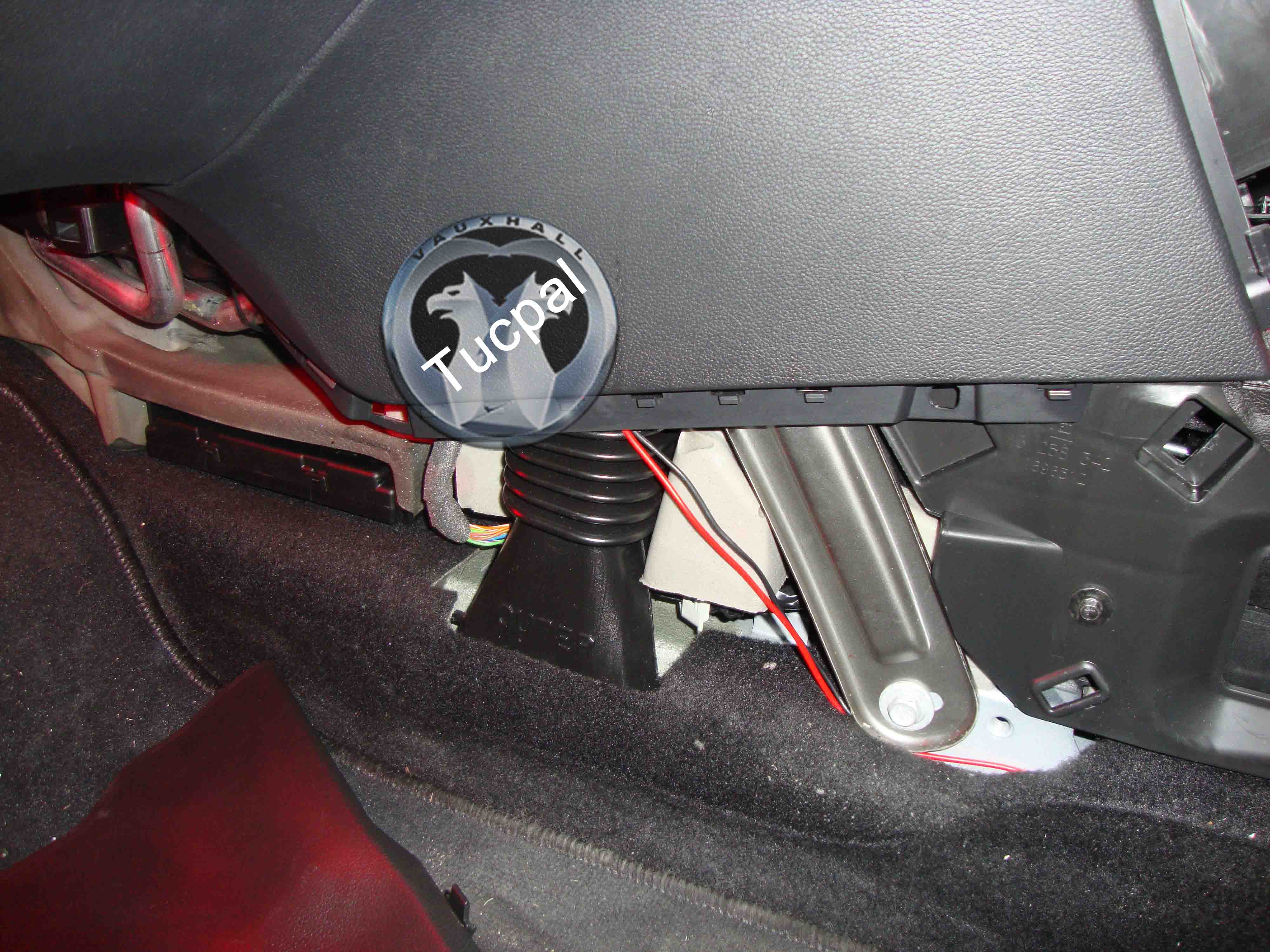

Now Splice Two Wires from the Wires you have just Done on the Passenger side
And run them Through the Gap in the Center Console to the Driver side
and Add the Two Wires to the LED
Again I zip Tied the LED too the Heater Vents just above the Peddles.
[Image: 12.JPG]
Now make sure Everything is taped up
and all safe & all Neat and Tidy with zip Ties Tape etc.

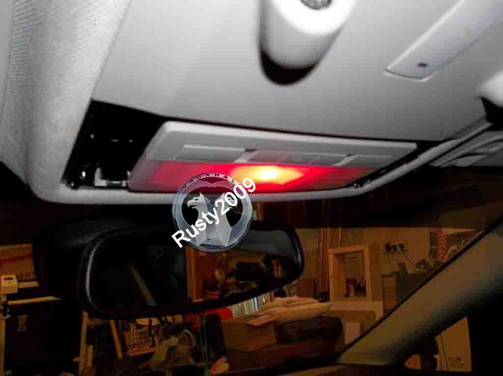

ALTERNATIVE OPTION

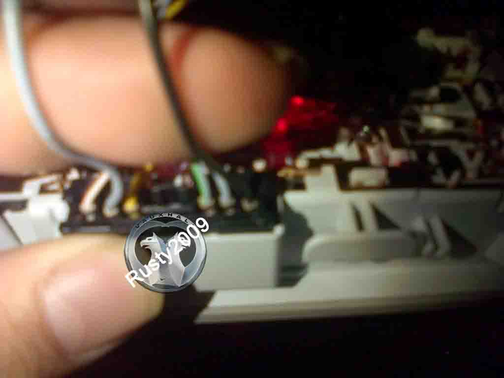

You can also Take Power from the Console in the Roof if you like
so Remove the Console from the Headliner.
How-to remove courtesy light can be found here
[Image: 13.JPG]
[Image: 14.JPG]

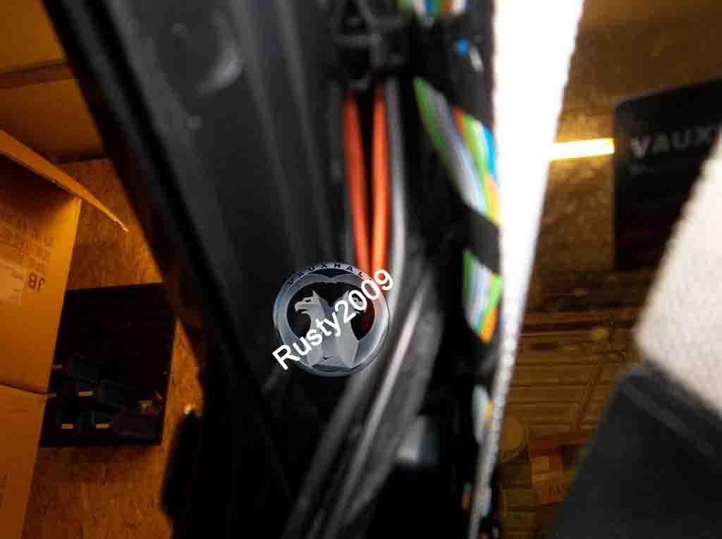

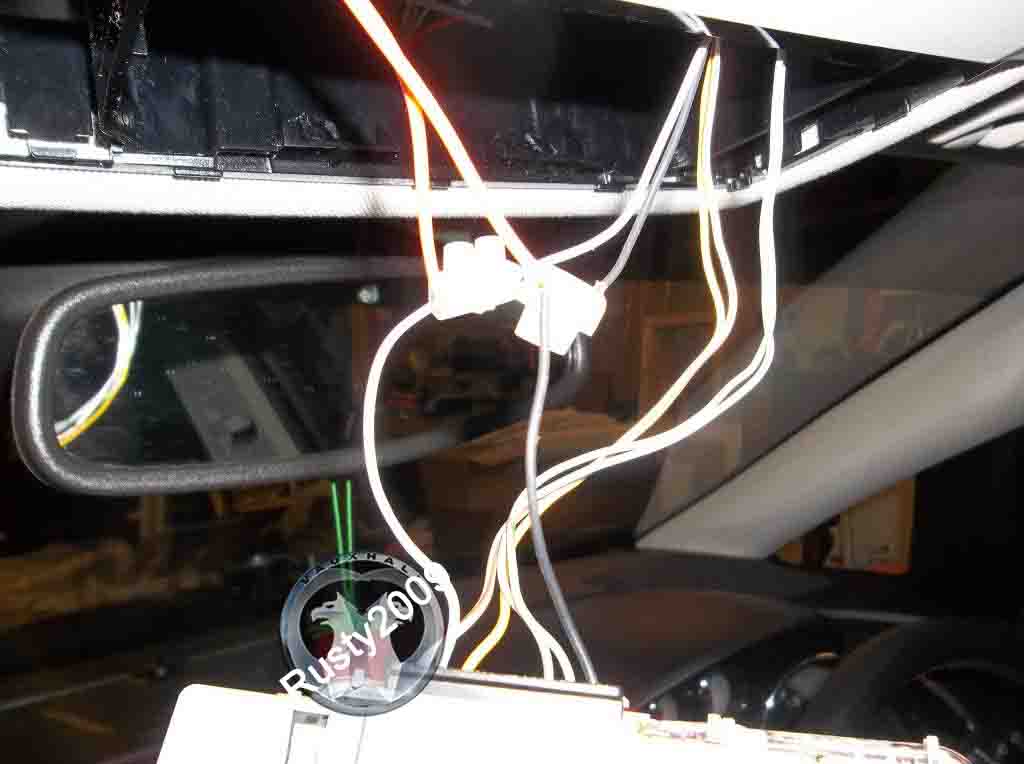

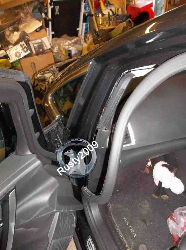

Again you will See one Grey and one Black wire on the Connector.
[Image: 15.JPG]
You add the Two Wires from the Connector & run them Through the Headliner & Down the A Pillar
heading to the Passenger Foot well you also can Pick this Loom up Here
And Pick the Grey & Black Wires out from the Loom if you Remove the side Trim.
[Image: 16.JPG]
[Image: 17.JPG]

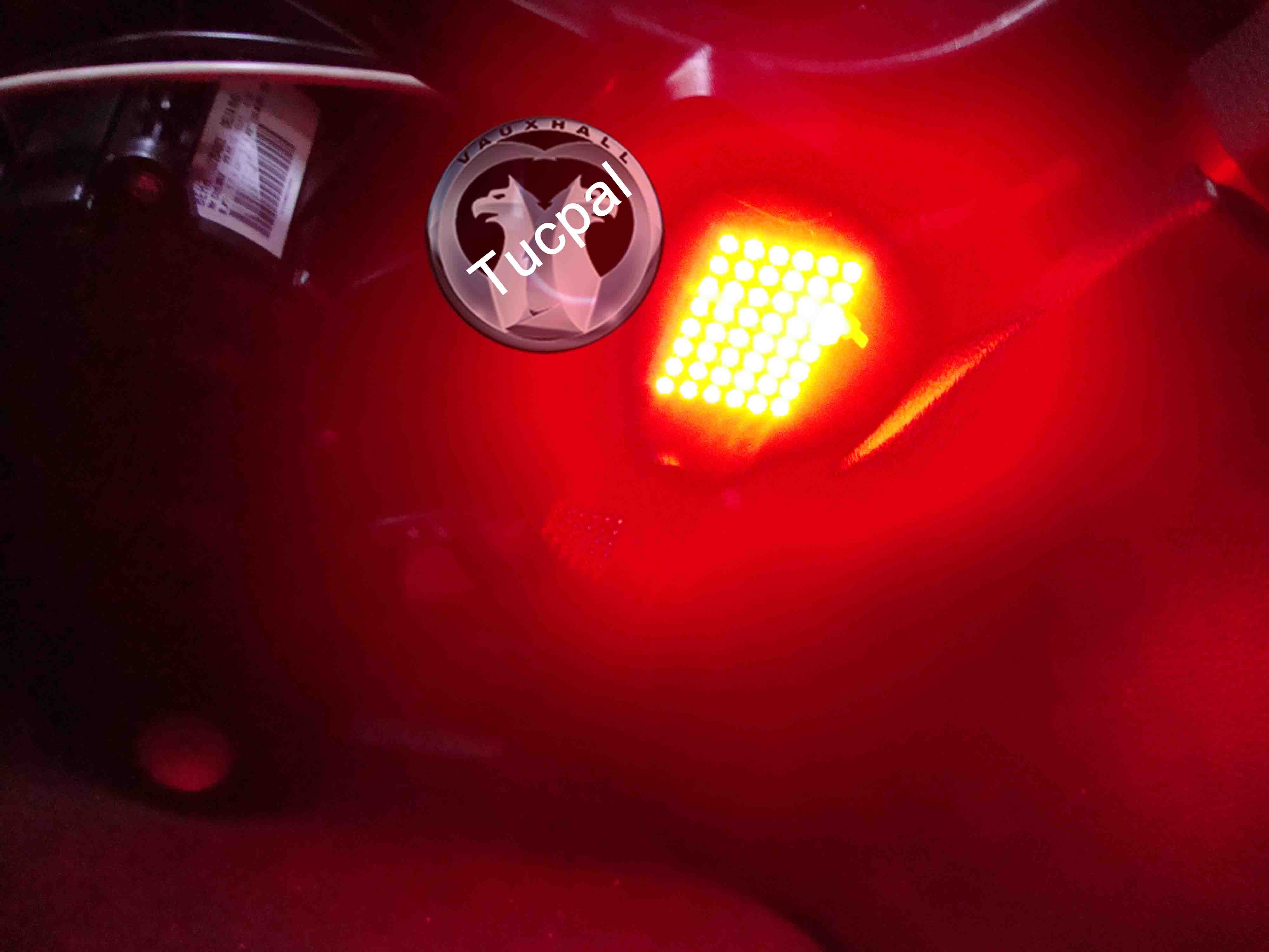

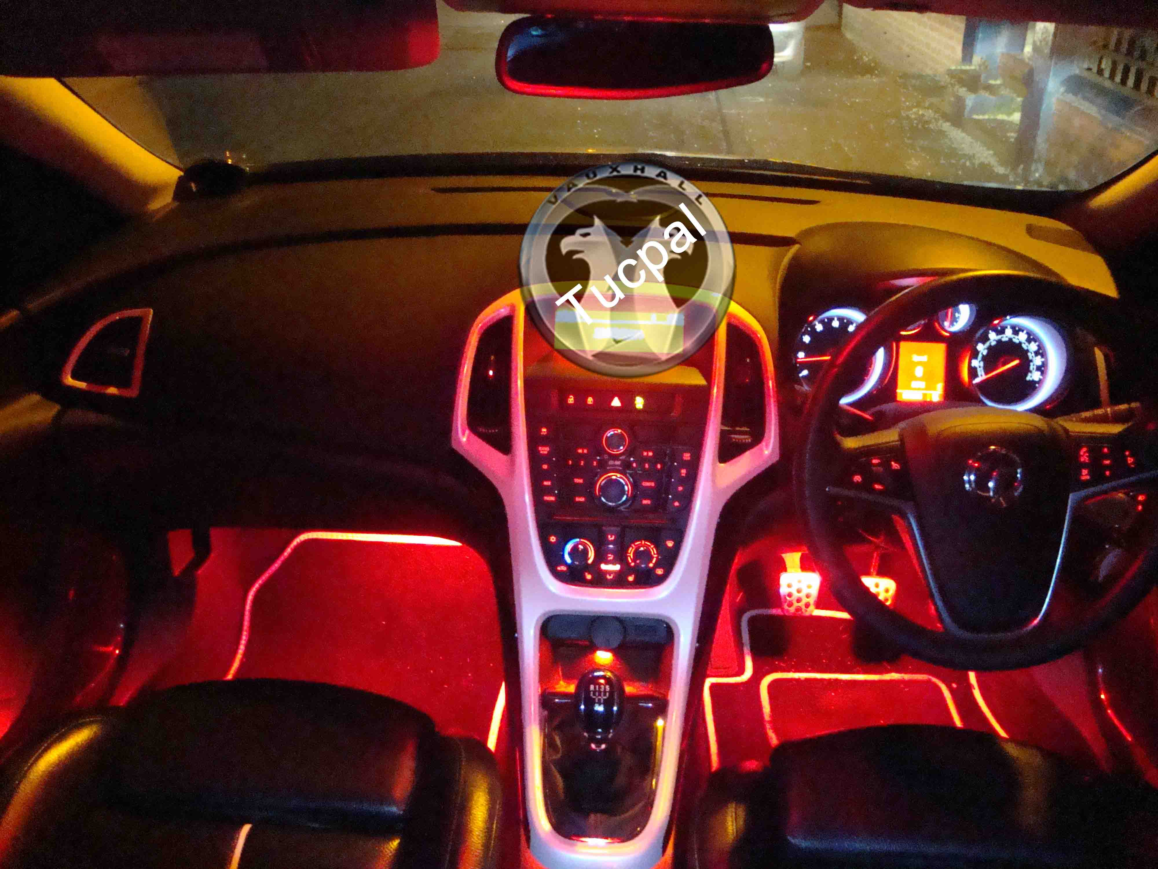

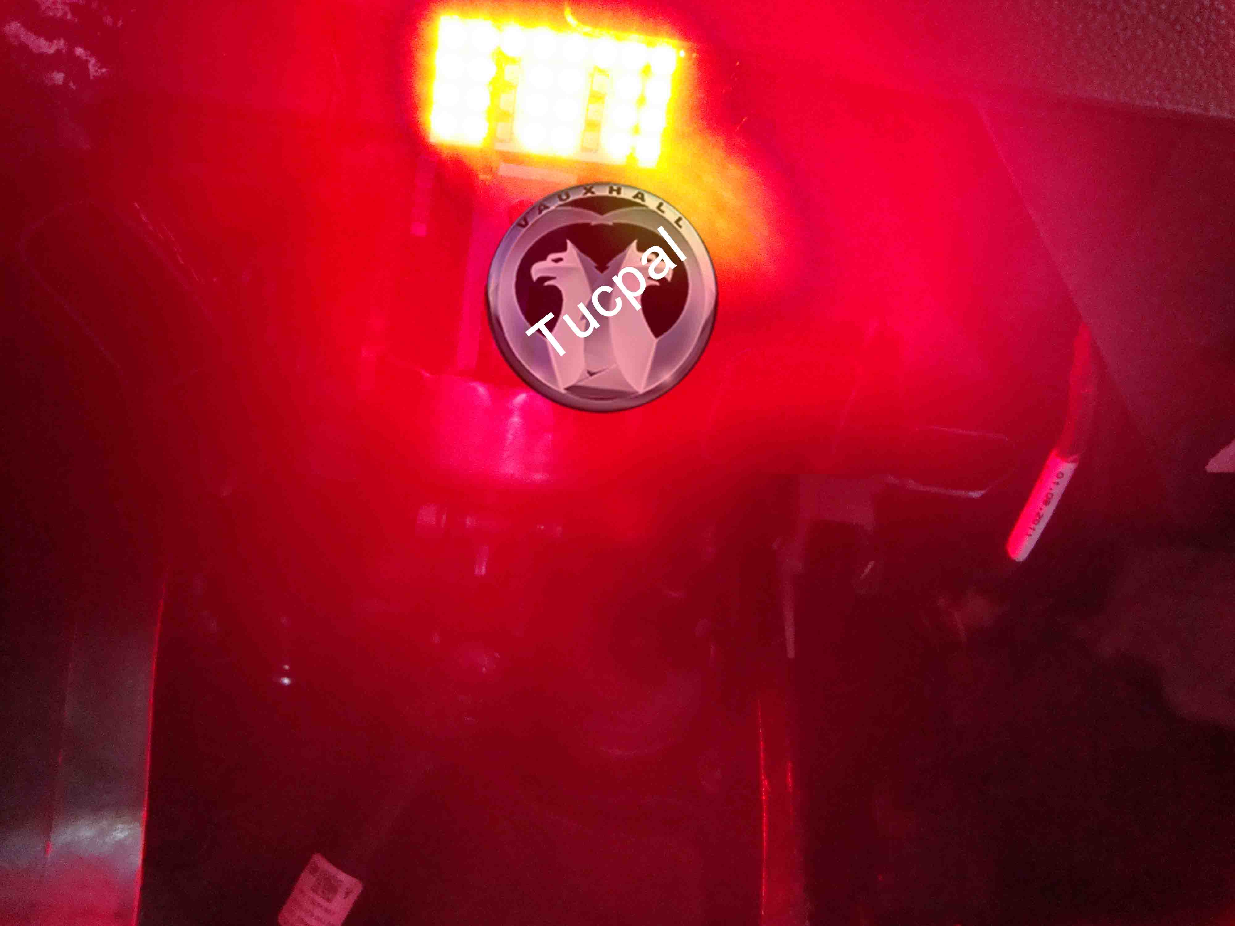

RESULTS
So now that is it all Done
you now have Foot well Lights.
[Image: 18.JPG]
