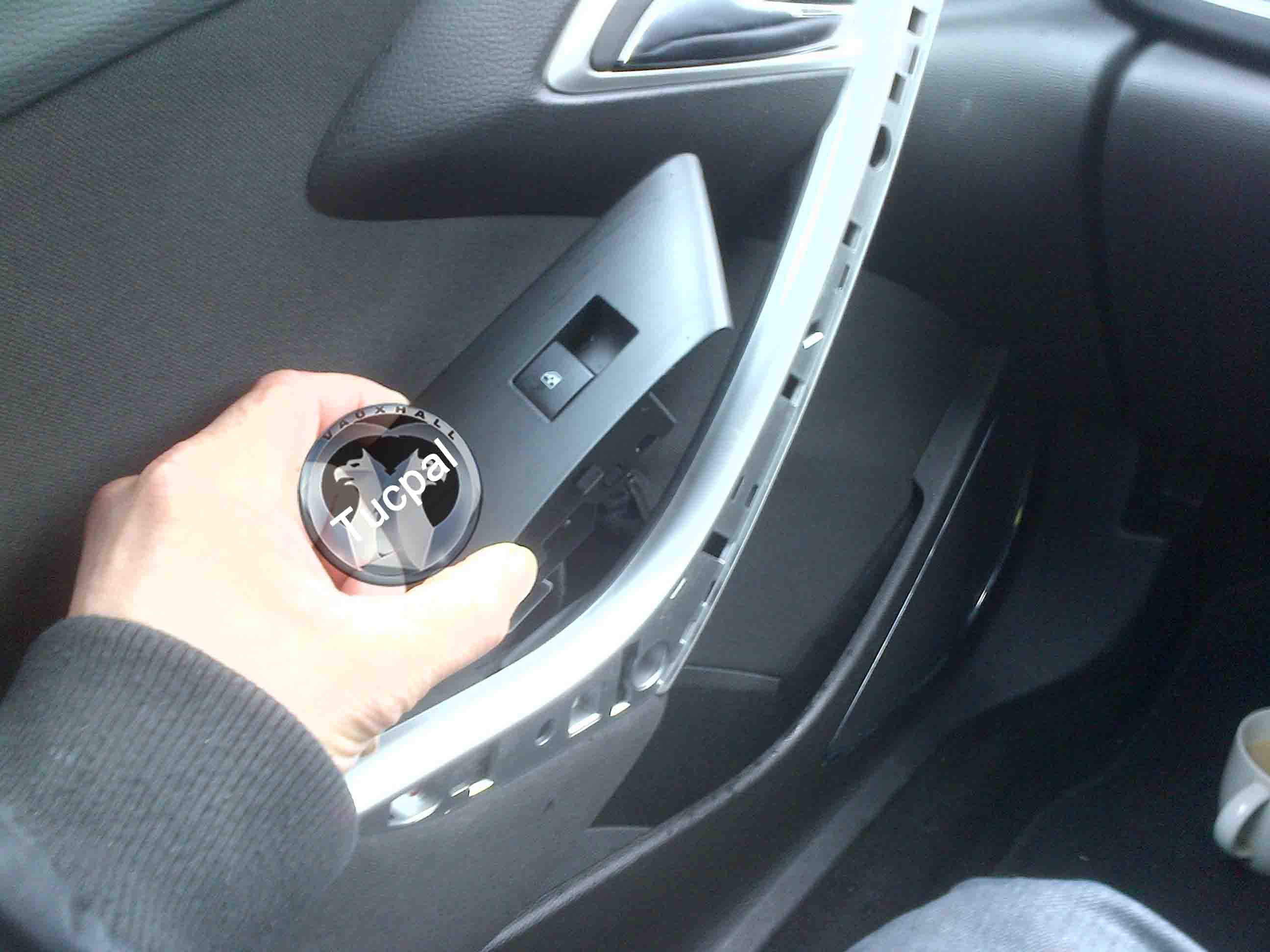

STEP ONE.........

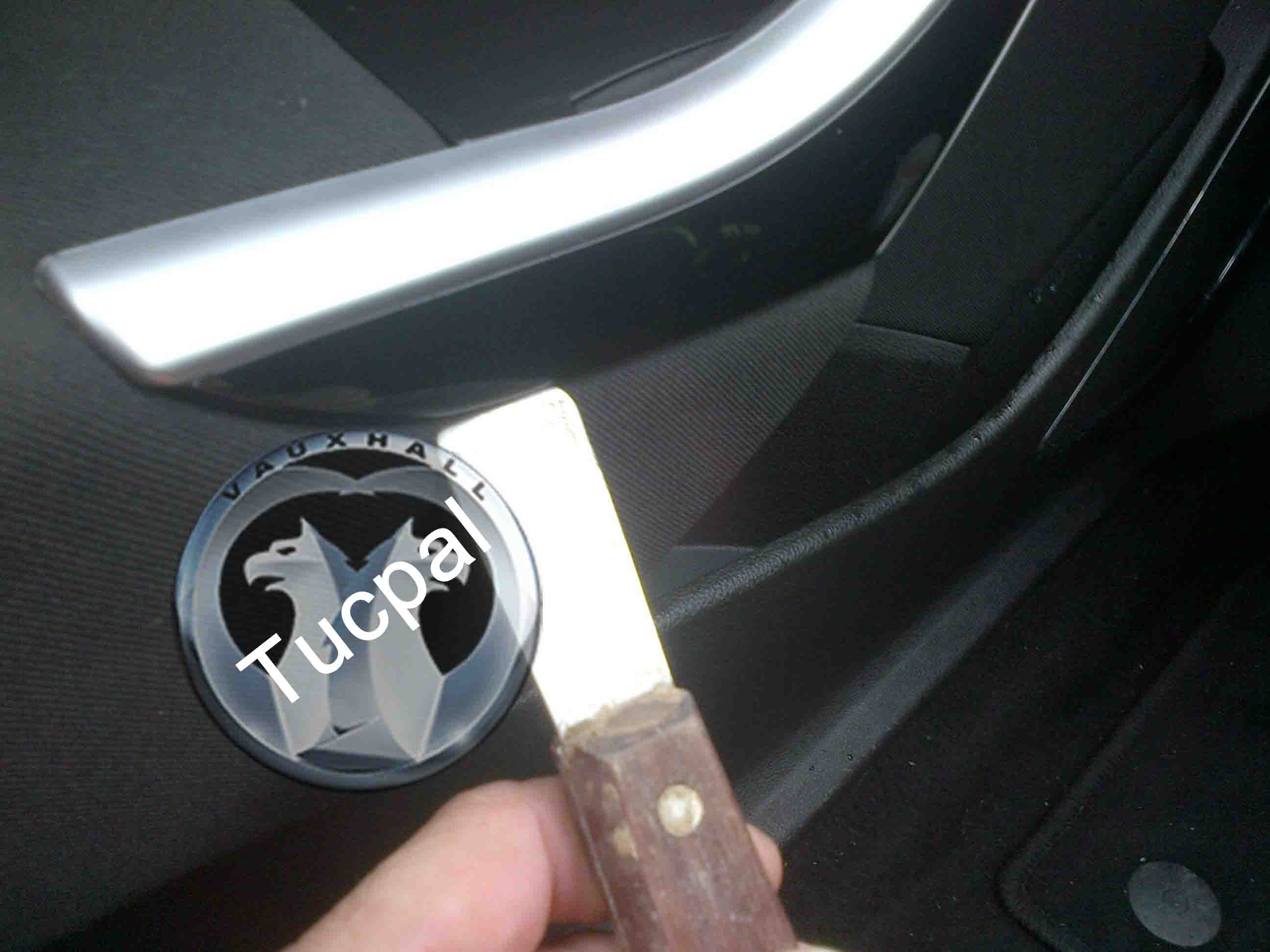

Remove the Gloss Black Trim from the Door Card.
[Image: 1.JPG]
Gently start Prizing at the Bottom and Work your way Up
to the Top just take care and take your Time it will come off.
[Image: 2.JPG]
[Image: 3.JPG]

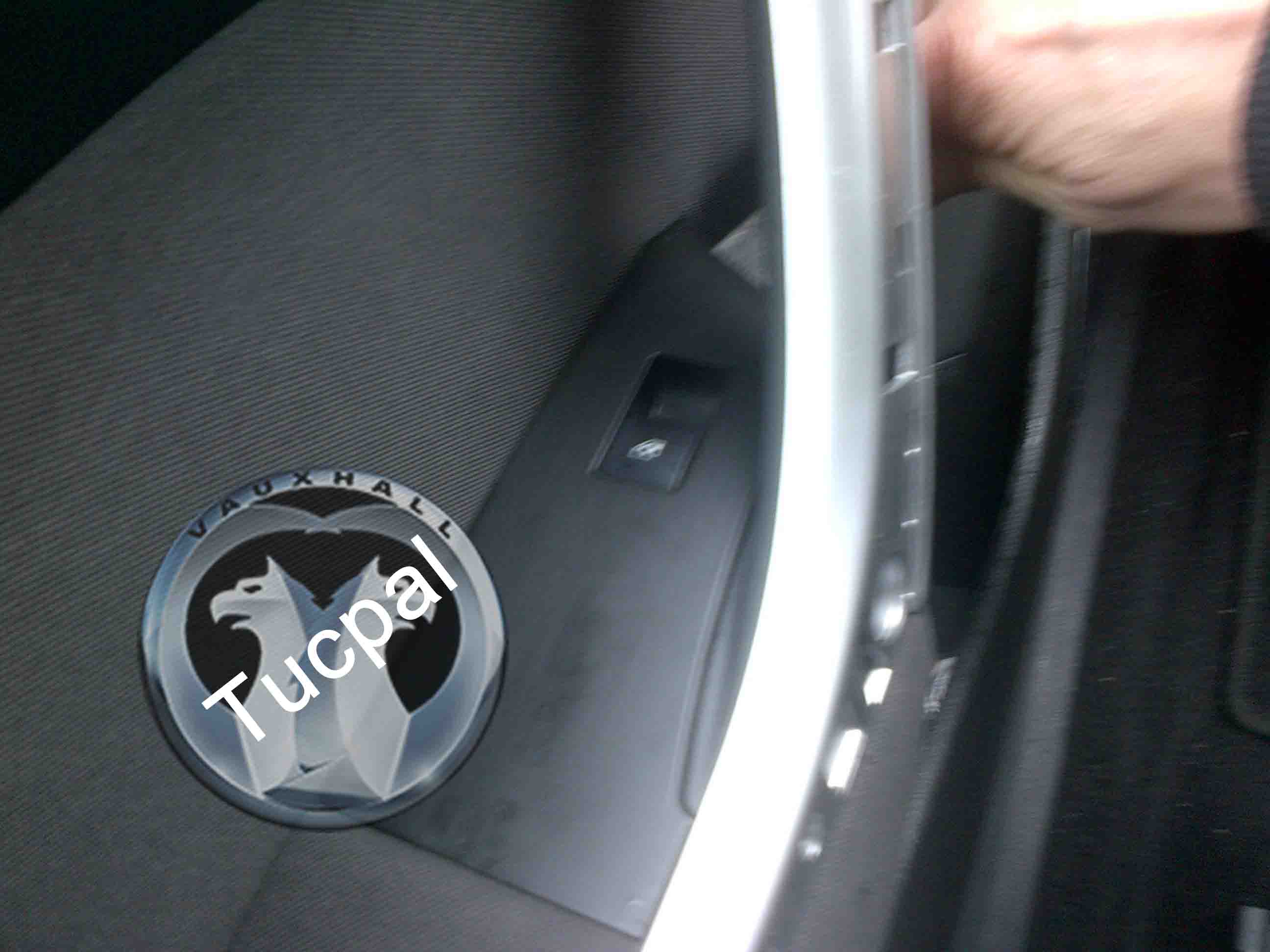

Now you have the Black Trim off the Door Card
Gently lift the Front of the Window Switch until the Switch has been Removed.
[Image: 4.JPG]
[Image: 5.JPG]
Now undo the Connector from the Window Switch
and put the Switch to one Side out off the way.

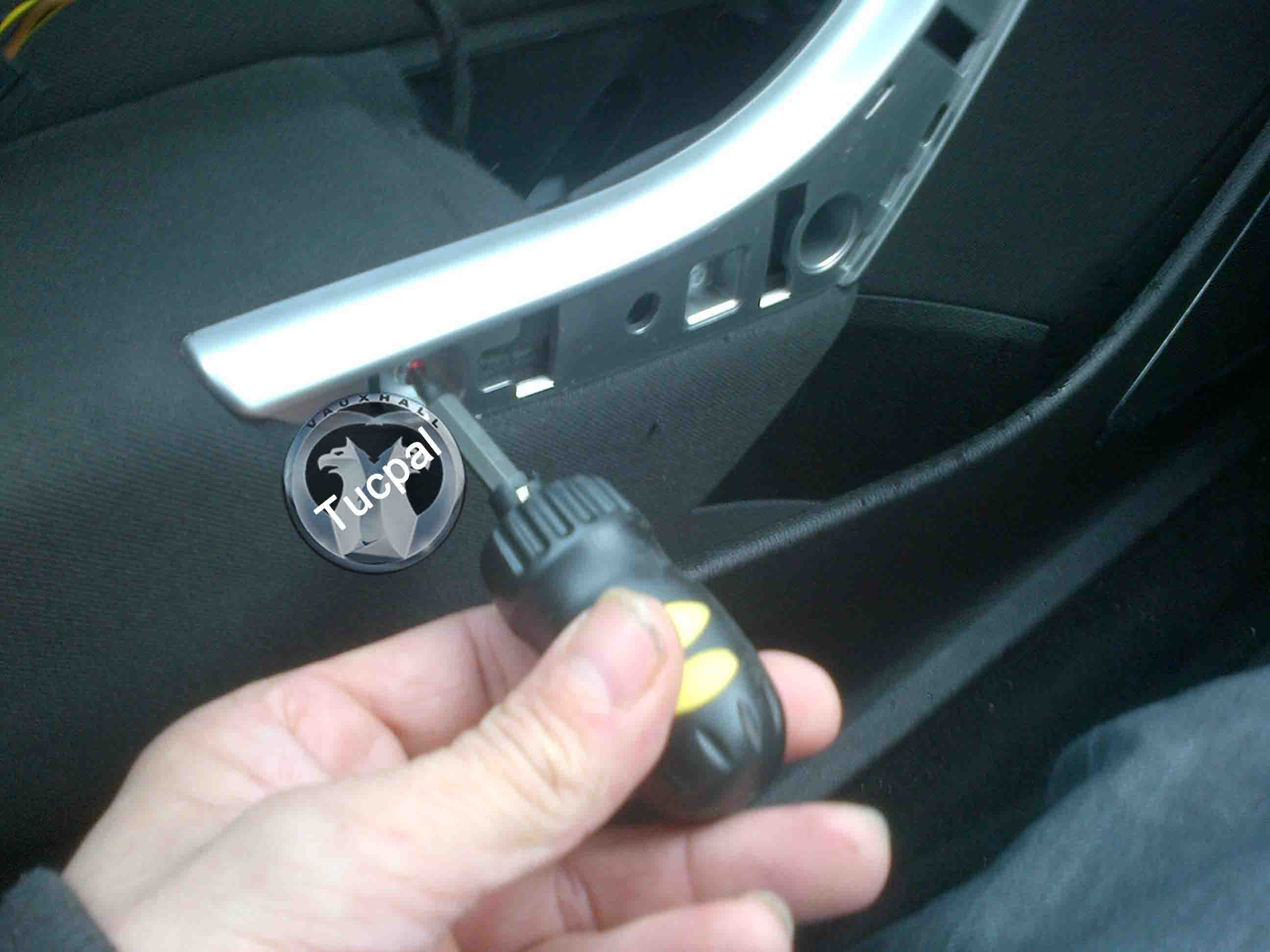

[Image: 6.JPG]

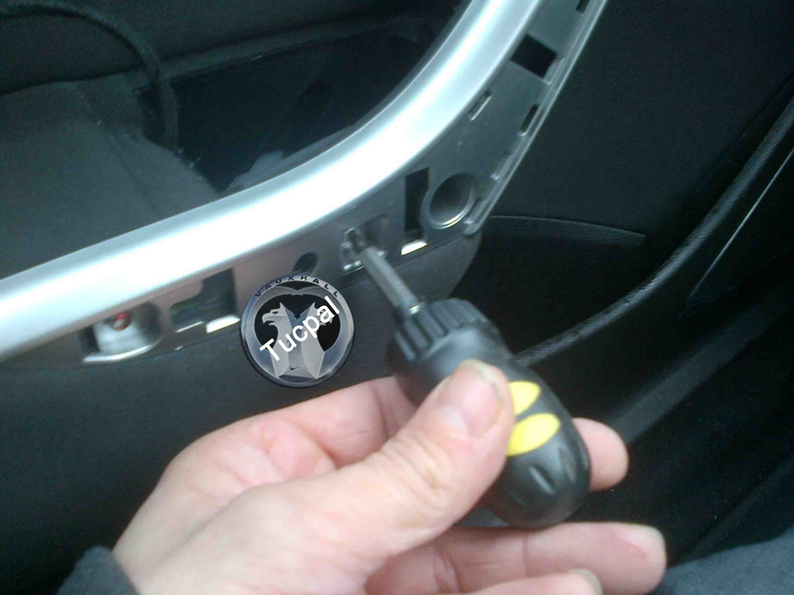

Use a Torx Screw Driver to Remove the Two screws.
[Image: 7.JPG]
[Image: 8.JPG]

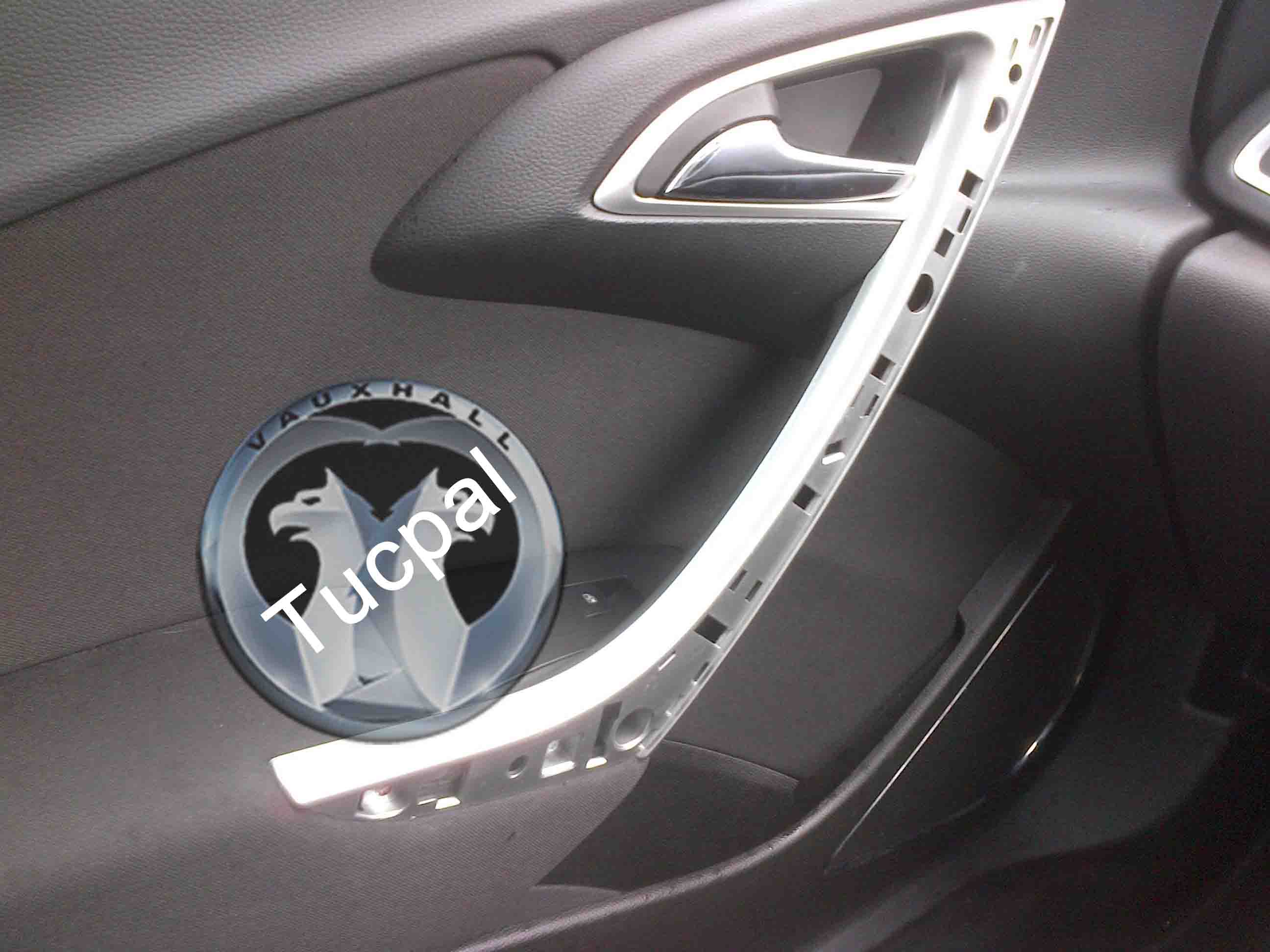

Just above the Red LED in the picture below there is a Third Screw to Remove
You can see were the LED Light goes Behind the Silver Trim
It slots into place by just pushing the LED into the slot.
[Image: 10_zps7tsy0lkq.jpg]
Gently pull back the Silver Trim from the bottom until you see the Hole for the LED
You may need to use a Screw Driver to Pop it off.
if you need to Remove the Whole Silver Trim to get access to the hole for the LED
i Recommend Removing the whole Door Card
And push the clips out around the door handle from the back
as they will brake if you pull that bit from the front.
but you should be able too Pull the silver trim back Enough to gain access to the Slot from the front
so just take your Time start at the bottom and work your way up.

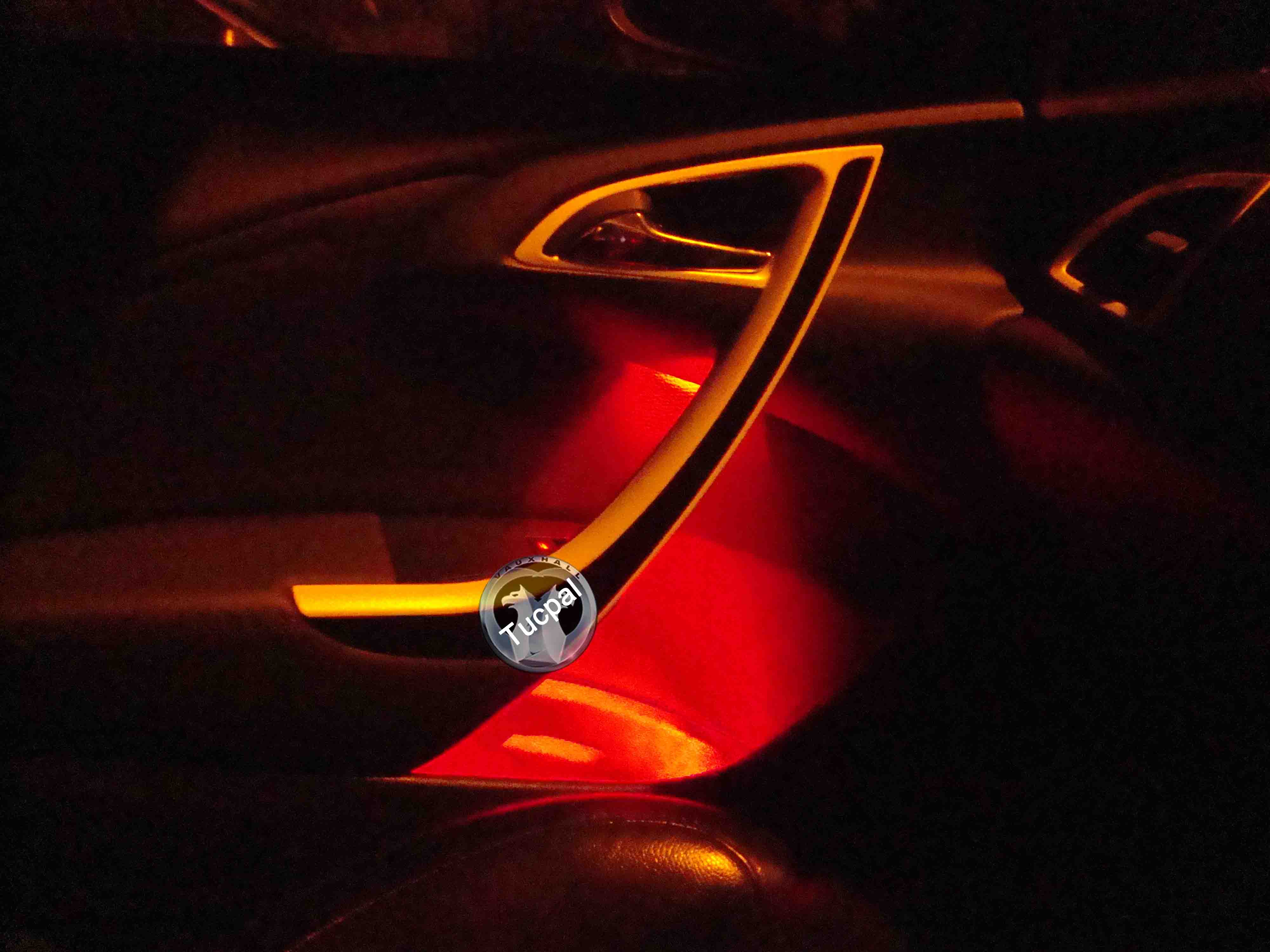

THE RESULTS.....
So you now have working Ambient Door Lights
This is Plug and Play no Programming Needed.
[Image: 14.JPG]
I also connected some Red LED strip lights to the window switch
and stuck them on the inside door pockets to to improve the Door LED even more..

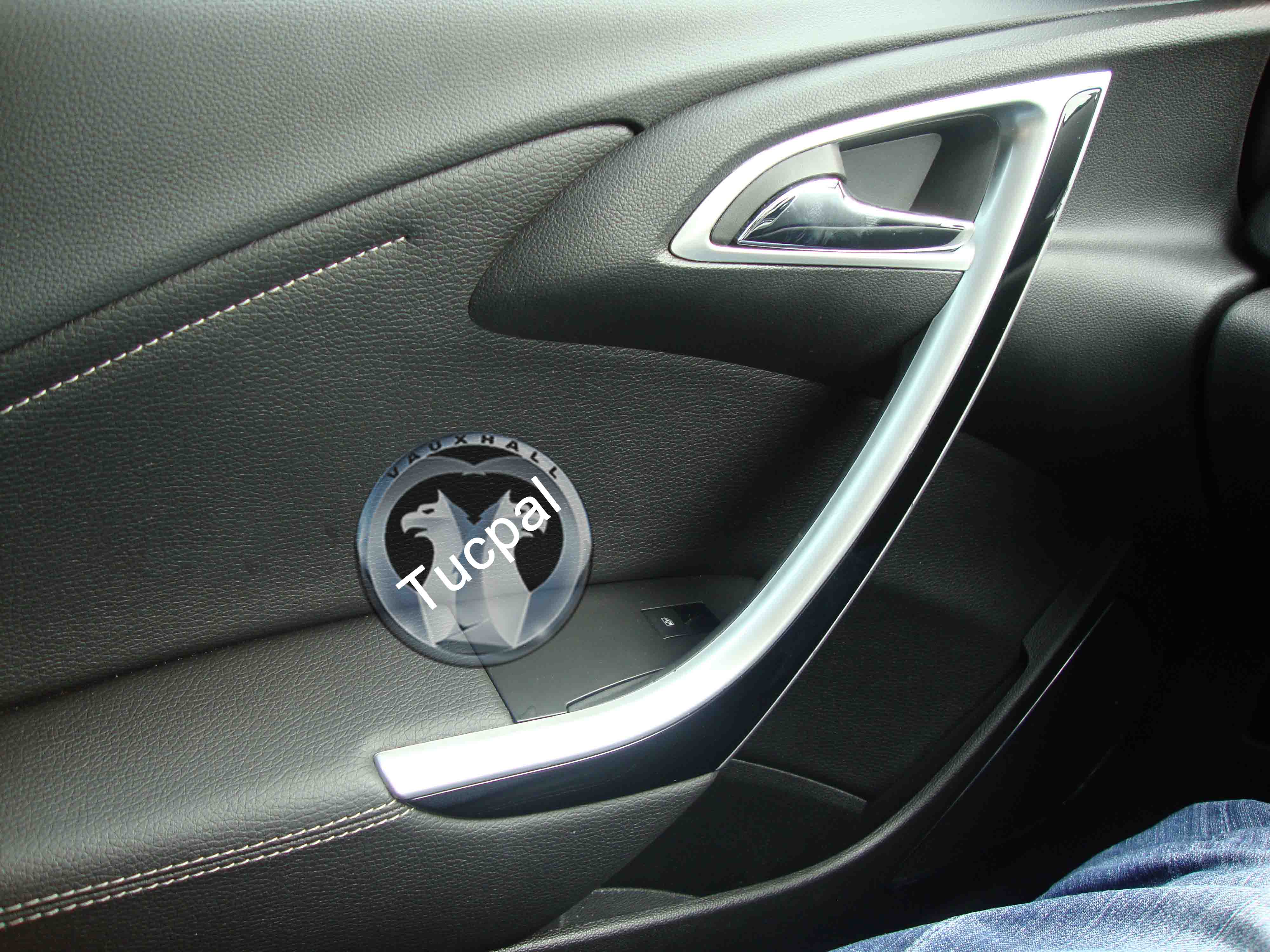

Also Pre MY11 cars may Already have the LED light in the Door Card
or if you have just brought a leather interior they will be in the door cards
The only way to check is to Remove the Door Card and have a look
you will see a small Connector on the back of the Door Card just by the Handle
if you have that then the LED is There and you just need to add power and ground to the LED
you can just snip the small connector off the LED on the Door card
And splice into the window switch if you like.
or keep the Connector on and look for the other Loom on the Harness read on for this way.
