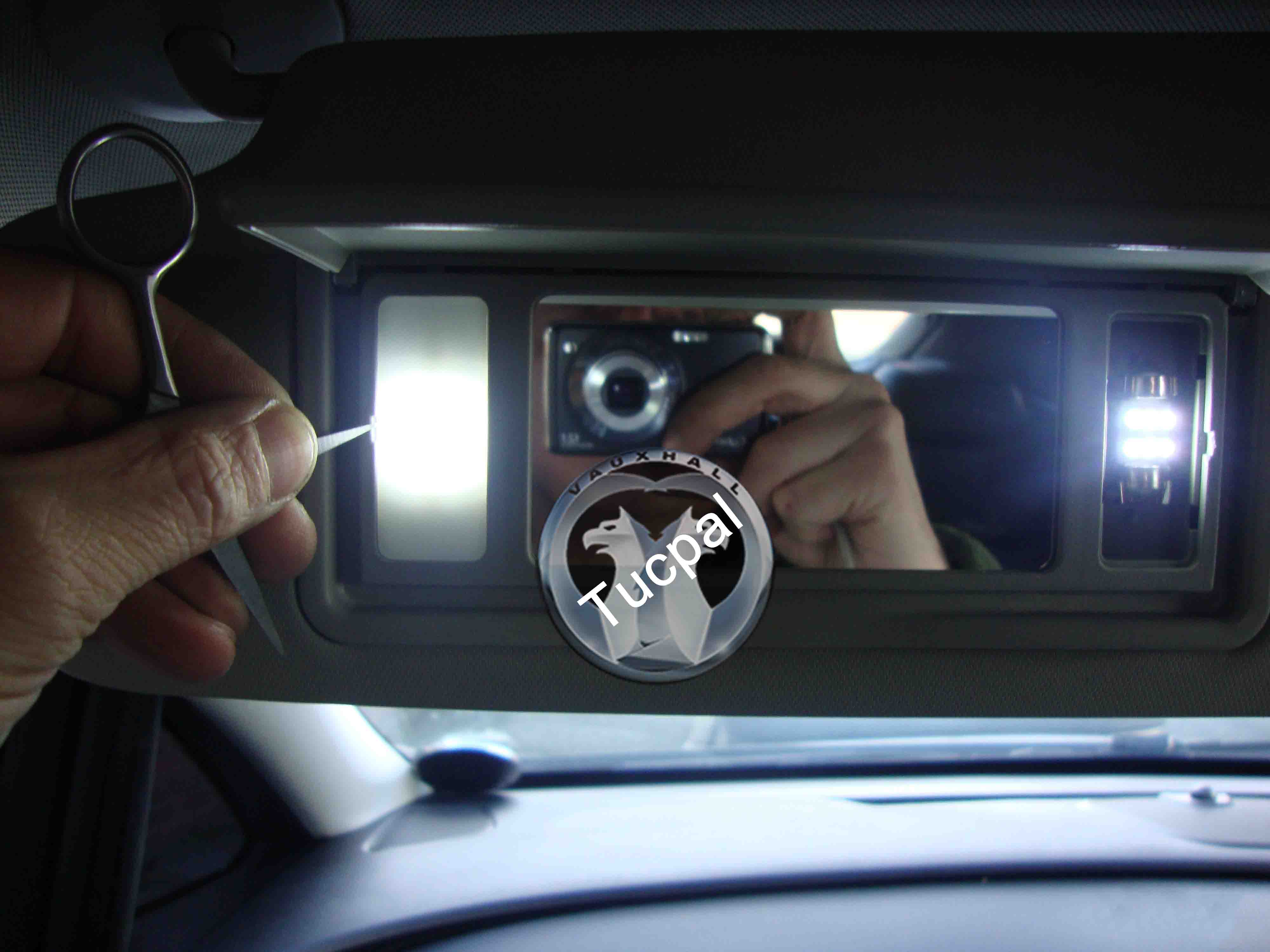

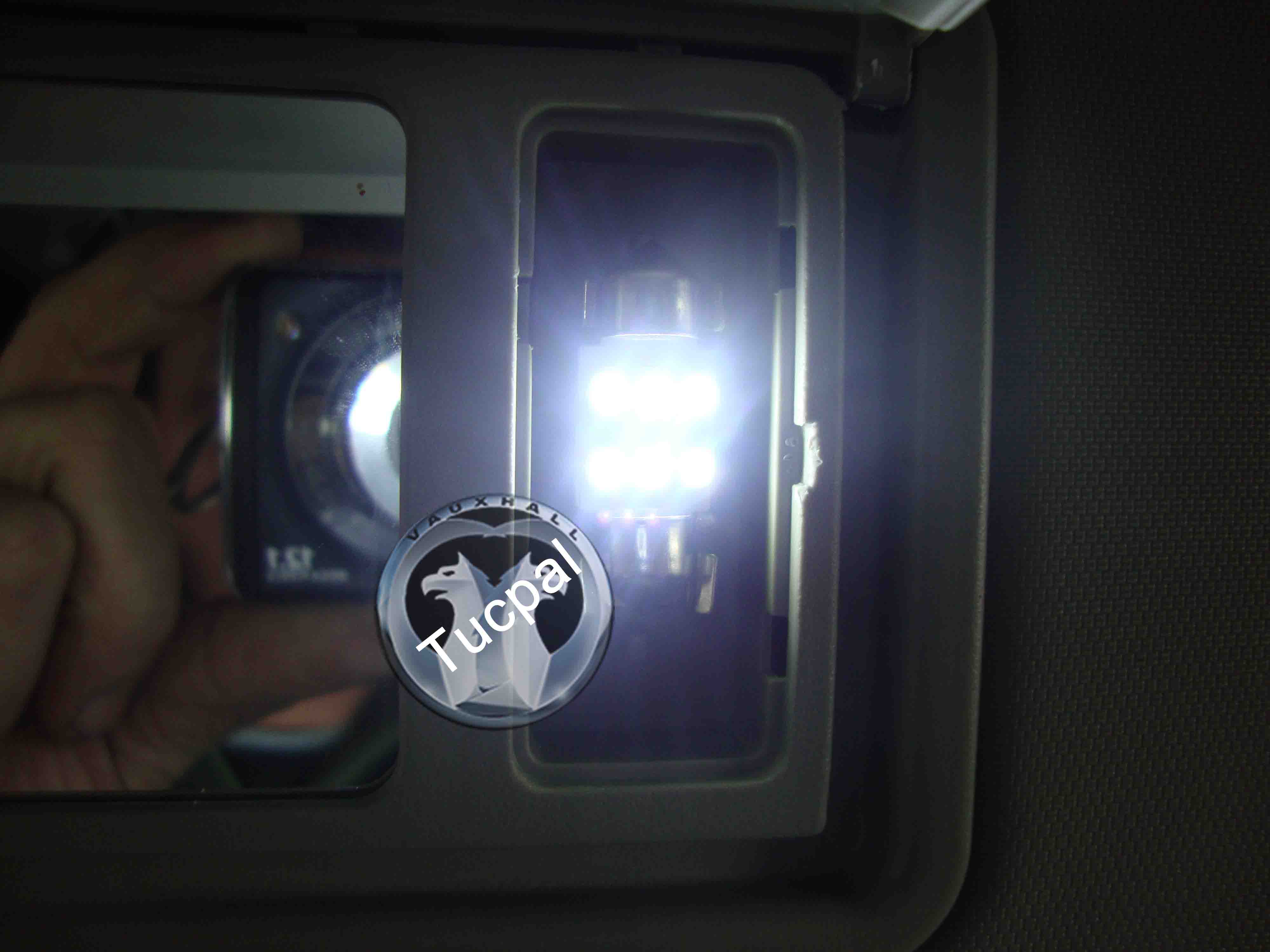

Start with the sun Visors all you need to do is to Remove
the two Plastic pieces to get Access to the Bulbs
Gently Pull from one Side
and swap the Bulbs for the New SMD LED.
Now your Girl Friend will be very Happy
as she now has Super Bright white SMD LED'S to do her Makeup.

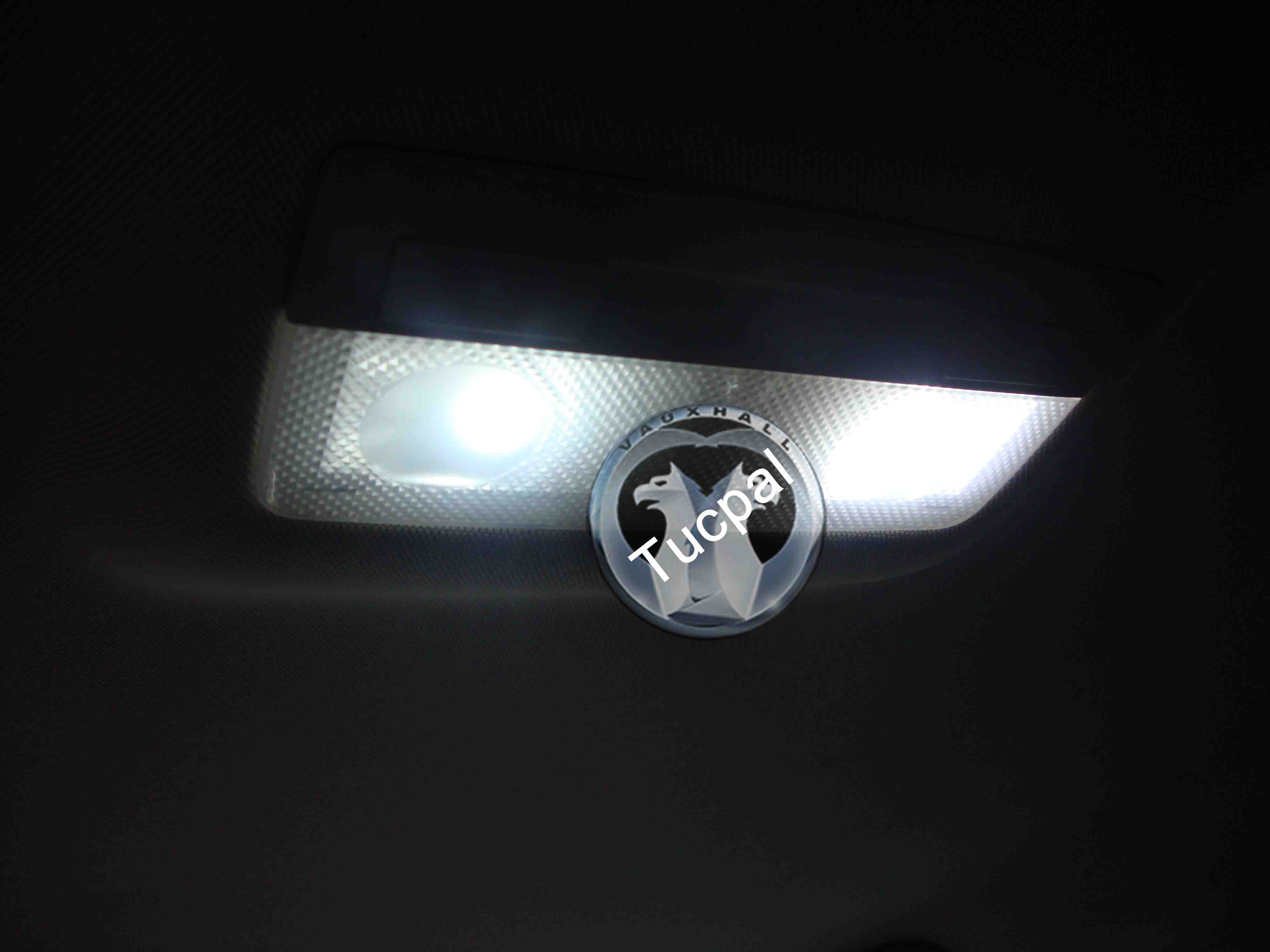

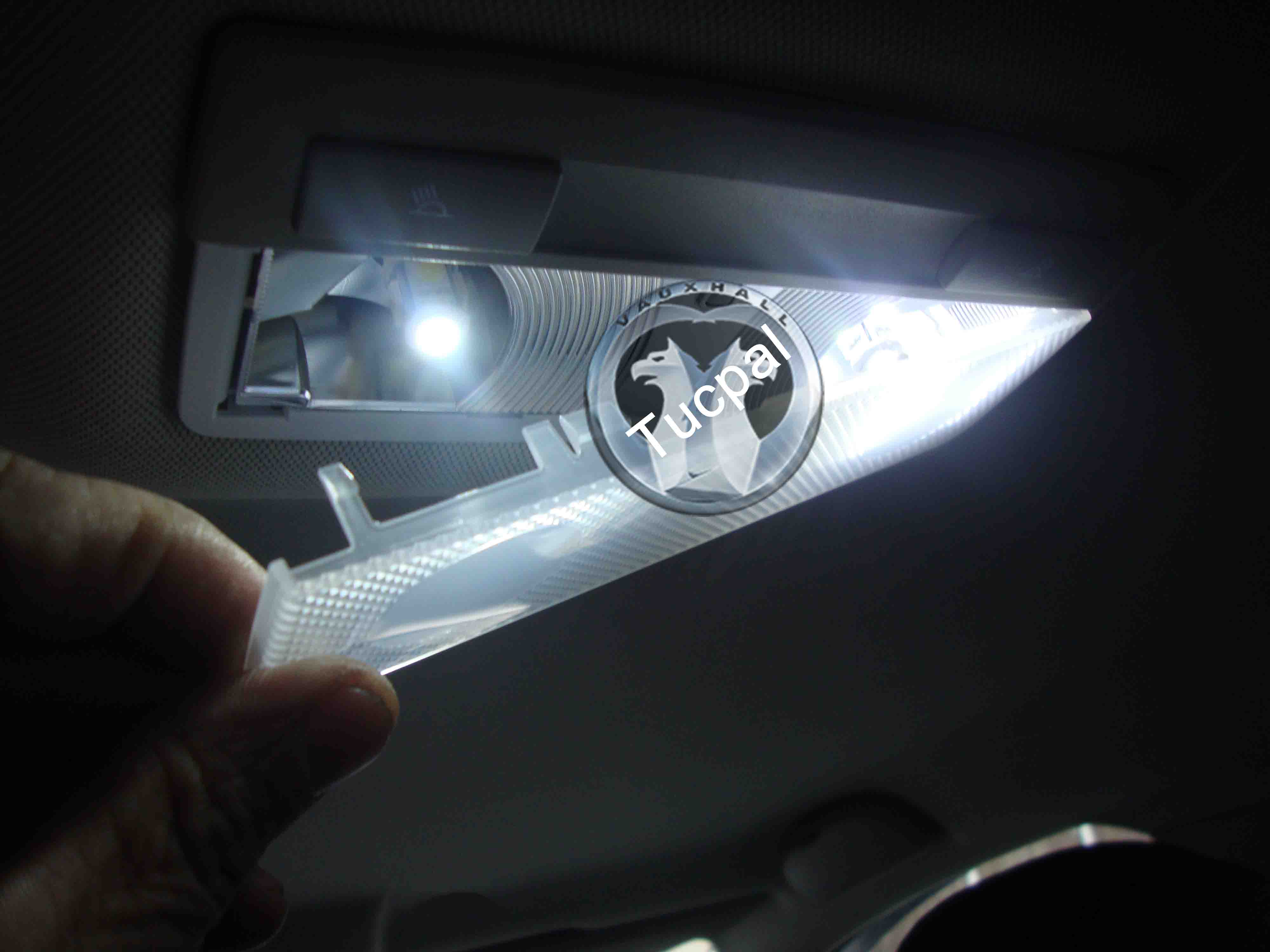

STEP TWO............

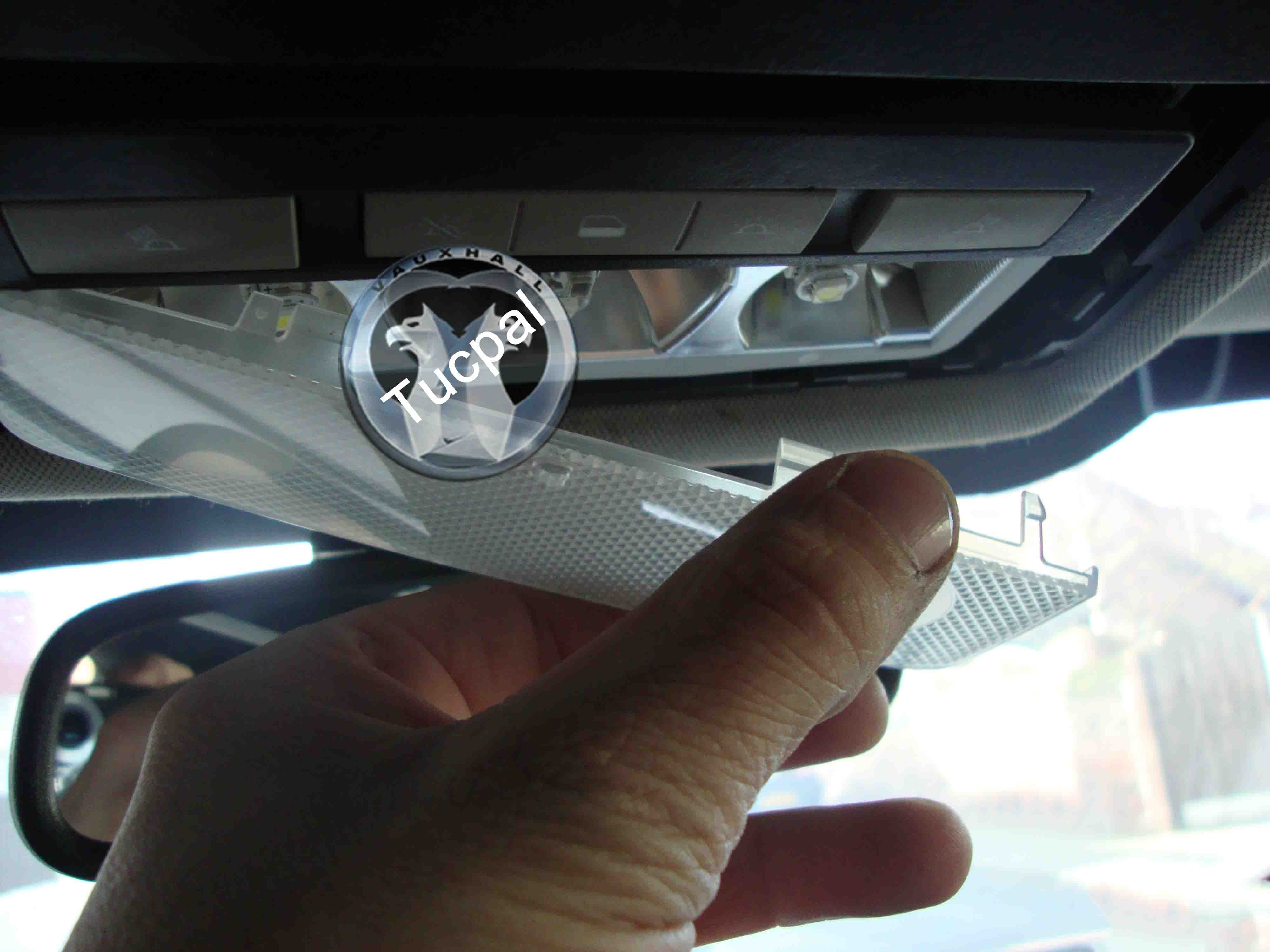

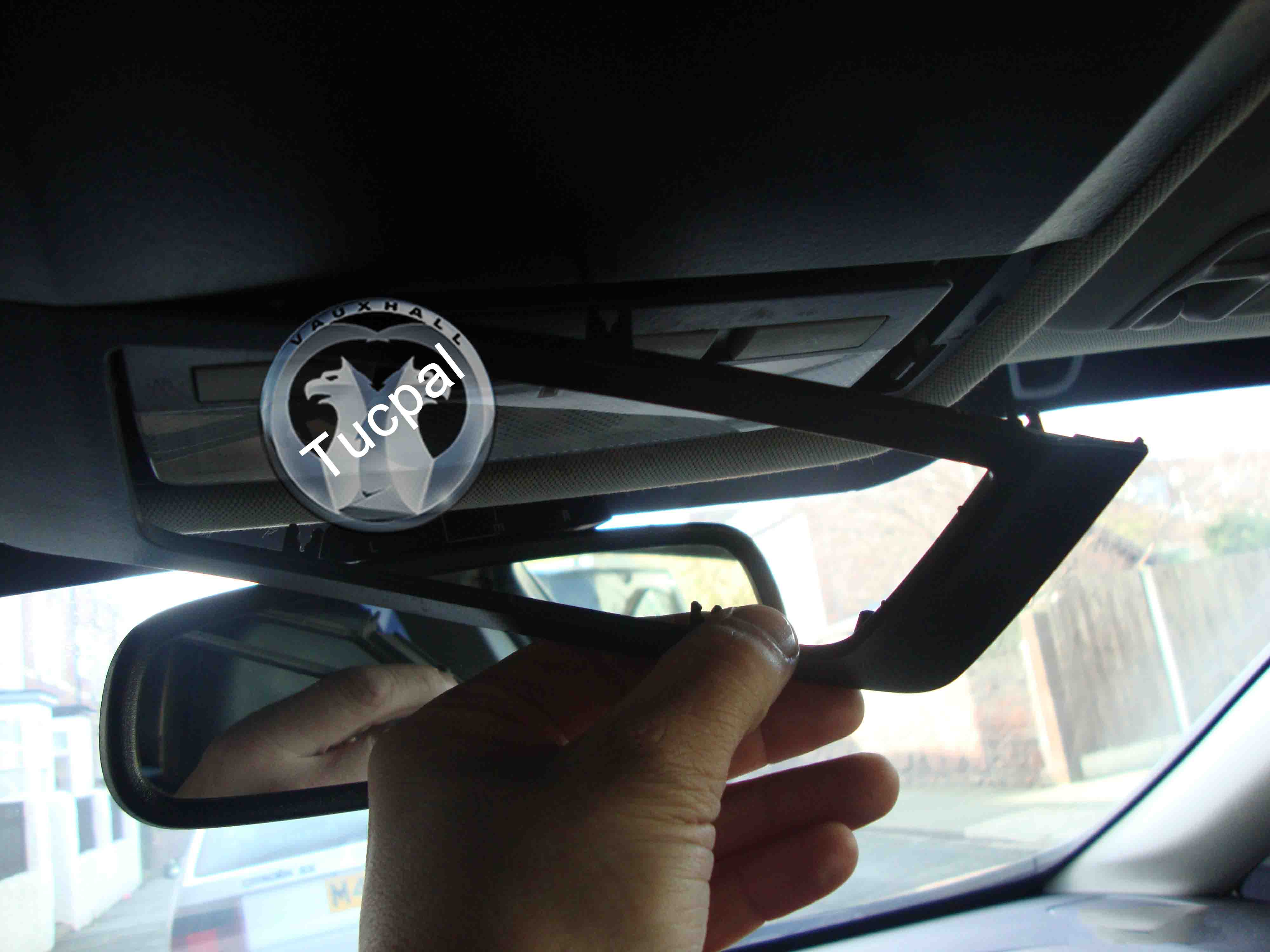

Remove the Trim from the Console in the Headliner.
Pull off the Trim around the Light Unit.
Then you need to Pull off
the Plastic light Cover.

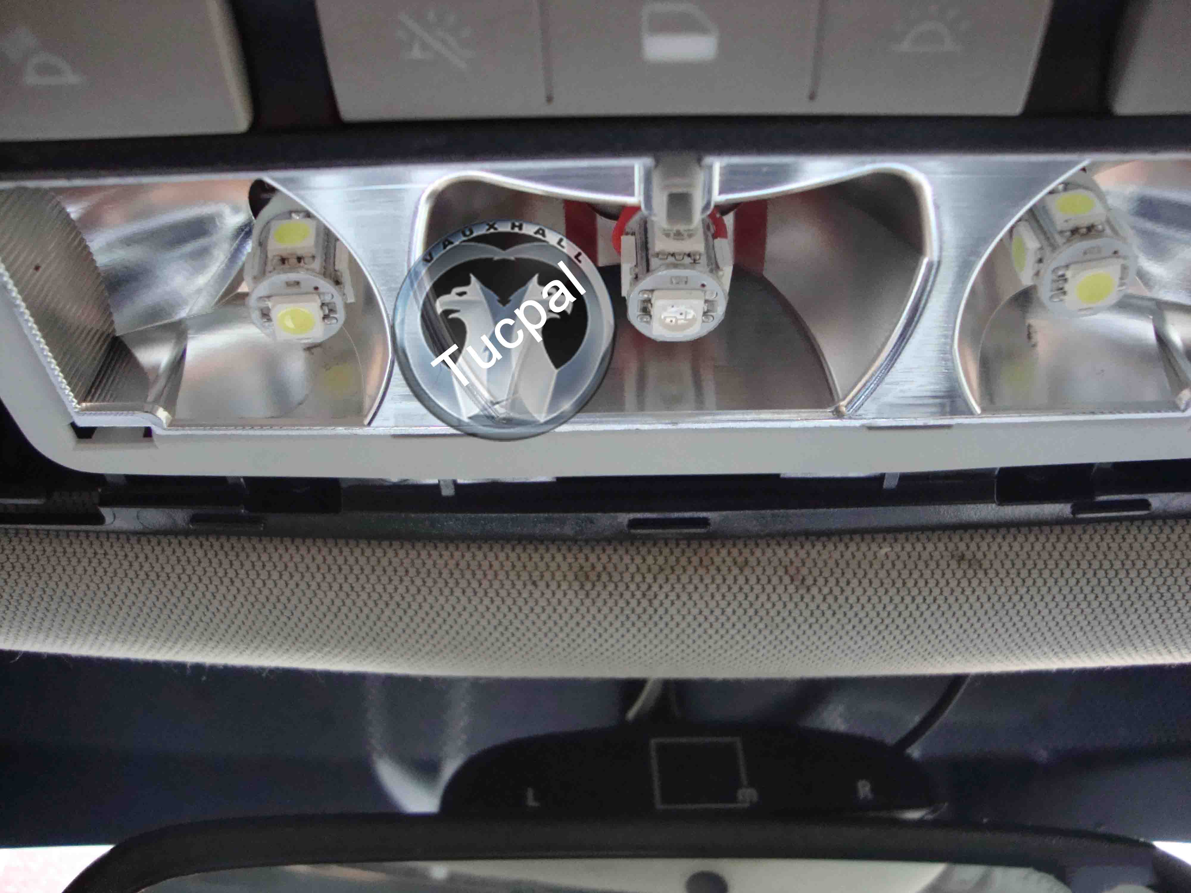

You can Add your New SMD LED Bulbs
i went for one Red in the Center
and Two white each side
but you can do what you what.
RESULTS..........
And here is the Results.

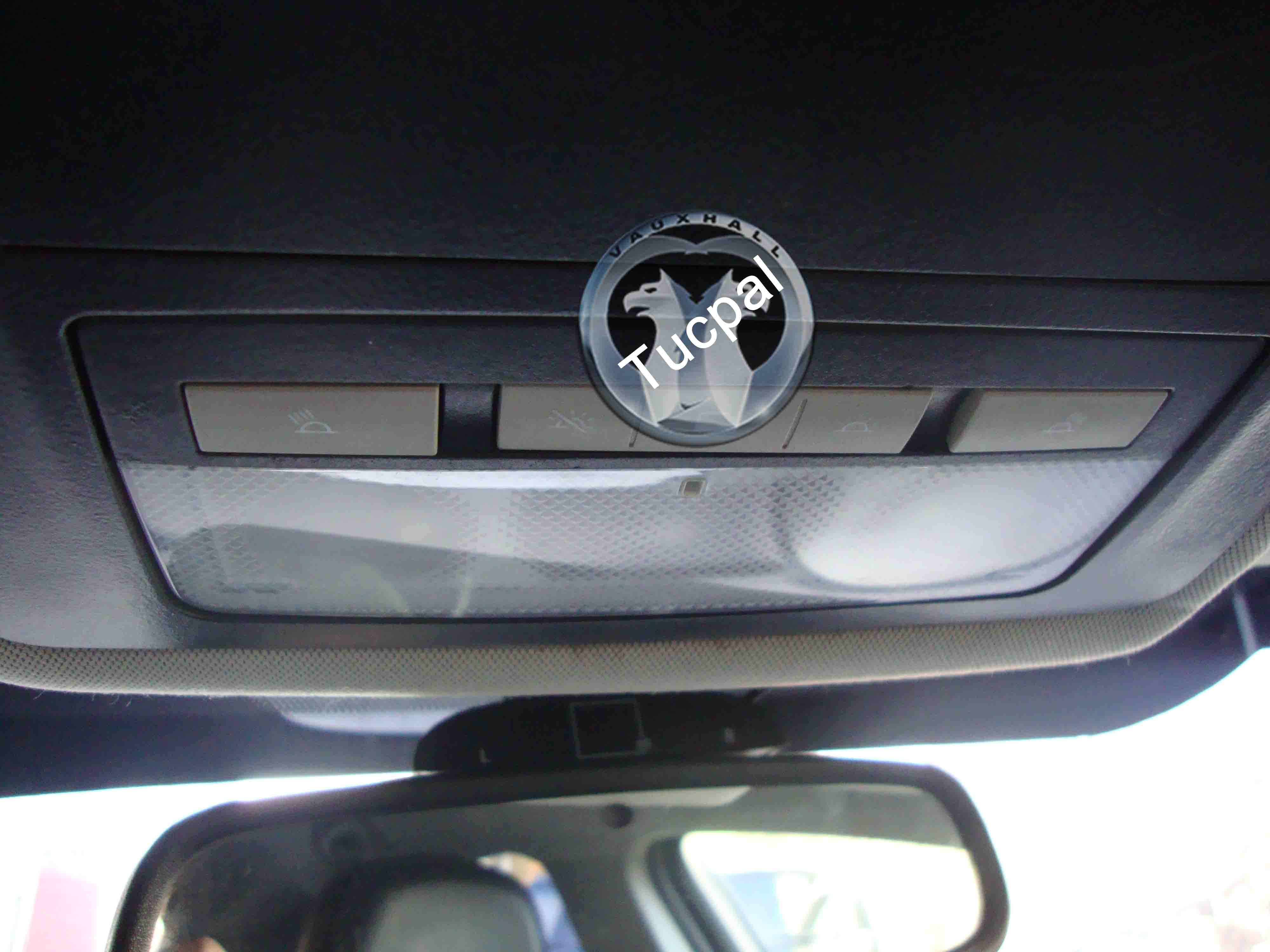

STEP THREE........
Is to Remove the Plastic Cover
from the Rear Lights in the Headliner
again this will just Pull off.
RESULTS...........
And the results..
The SMD LED,S are much Brighter
than the Standard Bulbs
and they look much Better

You are Looking for W5W/501.SMD, LED, Bulbs x 5
and 6615F are the Standard sun Visor Bulbs
you will need x4 SMD LED,S

And here are the new LED,s going in
You can see just how much brighter these LED,S are very happy with them
i will put a few pic,s up tonight in the dark for you all.
WELL HERE THEY ARE
REAR LIGHTS
SINGLE FRONT WELCOME LIGHT
AND ALL THREE COURTESY LIGHTS
very bright and A much better set of LED,S i am very happy.
