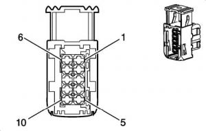

No canbus bulbs work without errors on the J DRL's.
You could try tapping a resistor onto Grey/Dark-Blue wire coming out pin 9 on the headlight plug.
Your English is very good by the way.

Yes I've attached a image showing the plug and numbers.
Ok so the wires should be
Grey/Dark Blue on left headlamp (one wire It's just has a tracer strip)
Dark Blue/Brown on right headlamp (one wire It's just has a tracer strip)
