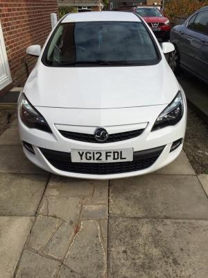

So I finally got round to doing the LEDs and I must admit the difference is subtle but one that is noticeable.
I found the passenger side DRL trickier as there was less room, I got myself so worked up that I had to walk away at one point haha. Drivers side was a doddle, just removed the air filter box like tucpal said and it was done in no time at all.
Took a couple of pictures before & afters to show the difference.
1st picture drivers side has the original factory bulb (the horrible yellow one that nobody likes) and on the passenger side is the prolarg bulb. I never got around to trying the PIAAs due to mixed reports of it melting the headlight units.
2nd & 3rd picture is of the LEDs which I must admit look amazing, although they now make my dipped beams look yellowish! So I think its time to start considering HIDs!
Thanks to tucpal for the tut and the other users for their comments, they've been a great help. Keep it up tucpal.
