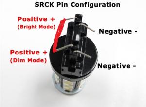

There is also another way to fit leds without errors showing up. Bridging positives like in the picture
[ATTACH=CONFIG]310[/ATTACH]
You can see how it's done here:
https://www.drive2.ru/l/3258892/
