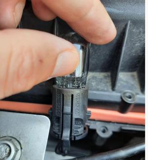

Hello,
I have a code 22 on my screen, which is pretty annoying. The right side lamp is working fine (both of them, left too).
I have already done:
- removed the bulb from the left side: (code 21 come out, which is expected)
- swap the two bulbs left and right side, both working, got error 22 back.
- bought new bulbs, still error 22
What I noticed, sometimes, I don't have error code 22, before I put the bulb with the holder into the lamp, and comes back a little later.
Also noticed the holder is a bit worn out. I tried to make sure the pins connected to the bulb well.
Has somebody come with an issue like this before?
Can somebody suggest a place (online) or in London where I can buy a replacement bulb holder? (the ones I found online looks different)
Try turning the bulb round in the holder.
You can't buy a replacement bulb holder.
You can using a tool carefully close the gap.
Also you can try cleaning the contact area.
