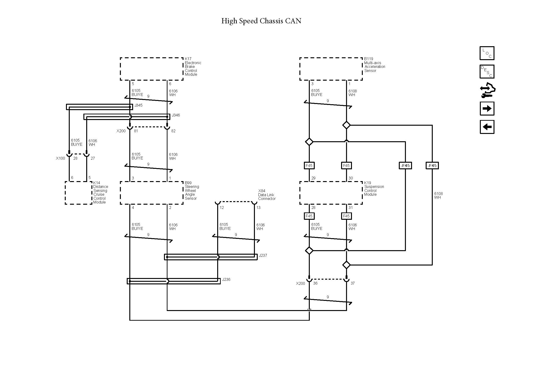

I have the 2015 Astra j NB 1.4 140 hp. I have no AFL headlights in my car. Halogen lighting. I want to make an application like the link I gave.
Using existing fog lamps I want to make steering-sensitive cornering lighting. For this purpose, the directional trigger cable for the headlamp cables I don't think so. I have it with the arduino kit to read the signal from the steering angle sensor and turn on the corresponding fog lamp I want to make a module that will allow. However, I do not know if the steering angle sensor is connected to the BCM or where it is connected. Many forums I searched but could not find. I need to know where the cable coming from the steering angle sensor goes, the position and the socket outlet find. BCM socket diagram if connected to BCM.
I am sorry for my English. I used a translation program.
Thank you in advance for your interest.
https://www.youtube.com/watch?v=xlexbzZaVUE
Does help you?
