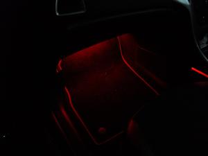

Using this guide I fitted led's to the footwells and boot, found it easier to take the feed from the roof lights, now fade with the interior lights cool, much brighter than the pics show.
