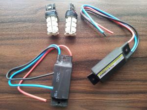

This is what you will need for the LED DRLS.
Two LED DRL bulbs. 7443. 50/50
four 50w 6,ohm Load Resisters.
some clips x8 or solder and shrink wrap optional.
and some extra 8,ohm cable red and black.
So you can have extra cable to move the resisters
somewhere safe as you dont get much on the load resisters.

However to make the LED DRL Dim Down in Side Light mode Error free
an extra set of Load Resisters and a Extra 4 clips will be needed.
[Image: 3.JPG]
[Image: 4.JPG]

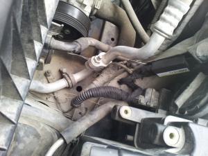

Remove the air filter box and the washer bottle etc
like you would when you change your DRL bulbs
follow this how to and remove the bits and the bulbs out of the holders.
http://www.vxoc.org.uk/forum/Thread-How-...d-h7-bulbs
Also before you start any work put a cloth down the air intake pipe
so you do not drop anything down there.

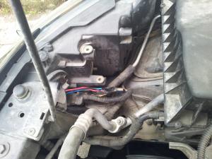

STEP TWO............
Fit the 4 Load Resisters Two Load Resisters to each DRL
placing them some where Safe and Preferably fit them to the Body of the car
to Something Metal as they do get Very Hot and may Melt Plastic
i Drilled a Pilot hole and used a self taper screw to keep them in Position
look before you Drill and make sure it is in a Safe Place.
[Image: 6.JPG]
[Image: 7.JPG]
[Image: 8.JPG]
STEP THREE.........
Make a small hole in the DRL Covers so you can get the 4 wires through from the Load Resisters
these wires will stay outside the Cover and any clips will be inside the cover
so make sure this is Threaded through Before you clip the Wires Together.

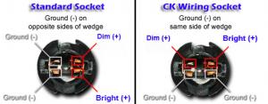

the ones from lush were that lose one fell in the headlight and took about an hour to get out
so overall not impressed with the new bulbs at all
the first ones i was sent from lush were real good and i now know why
the problem is not with the LED light it is to do with the size of the led bulb
the reflector in the headlight needs a smaller bulb if it is too long the light misses the reflector
and light output is reduced
now for the good news i got these also and they work perfect and dim like they should
also error free when the load resistors are on them

Any 7443 bulb will dim down. The bulbs that sellers sell are like this (left one):
http://2.bp.blogspot.com/-v7fbjojv_WY/T-...wiring.jpg
But our bulb holder is like this(right one): minuses at one side, positives (drl and sidelights) at the other side. You can see the difference on the picture:
[ATTACH=CONFIG]286[/ATTACH]
So all you have to do is realign the pins of the led bulb in order to fit to our bulb holder:
https://www.youtube.com/watch?v=zhYpU33TrDQ
And voila, leds work in both modes. Thats what i did with all the leds I ve tried so far and it worked like a charm
i get it thanks
i had seen the you tube clip
but i really never understood it
but now i have read this i do Doublethumbs
that will be the reason some never dimmed down for me
and some did that should help others looking for LED bulbs
that in counter this problem.
A different way to install a load resistor(not my car).
[ATTACH=CONFIG]287[/ATTACH]
[ATTACH=CONFIG]288[/ATTACH]
[ATTACH=CONFIG]289[/ATTACH]
yep you can do it that way it you like
same will apply just pick up the DRL and Side light and ground
you still would need two loads thou to be totally error free
but the second picture i am not to sure what i am looking at there
as the loom looks like it has melted Lol
or that is just taped together

tucpal Wrote:but the second picture i am not to sure what i am looking at there
Its just tape I think
tucpal Wrote:you still would need two loads thou to be totally error free
Those resistors are suitable for both modes (check wiring at first picture) plus they have that anti-thermal rubber/sleeve preventing resistors cathing fire in case they stop functioning as they were supposed to
i will show how to reline the pins on the led later on for you
also the loads will cancel the errors for the different wattage bulbs
but you will still get errors if the bulb has blown or the led pins on the led are wrong
