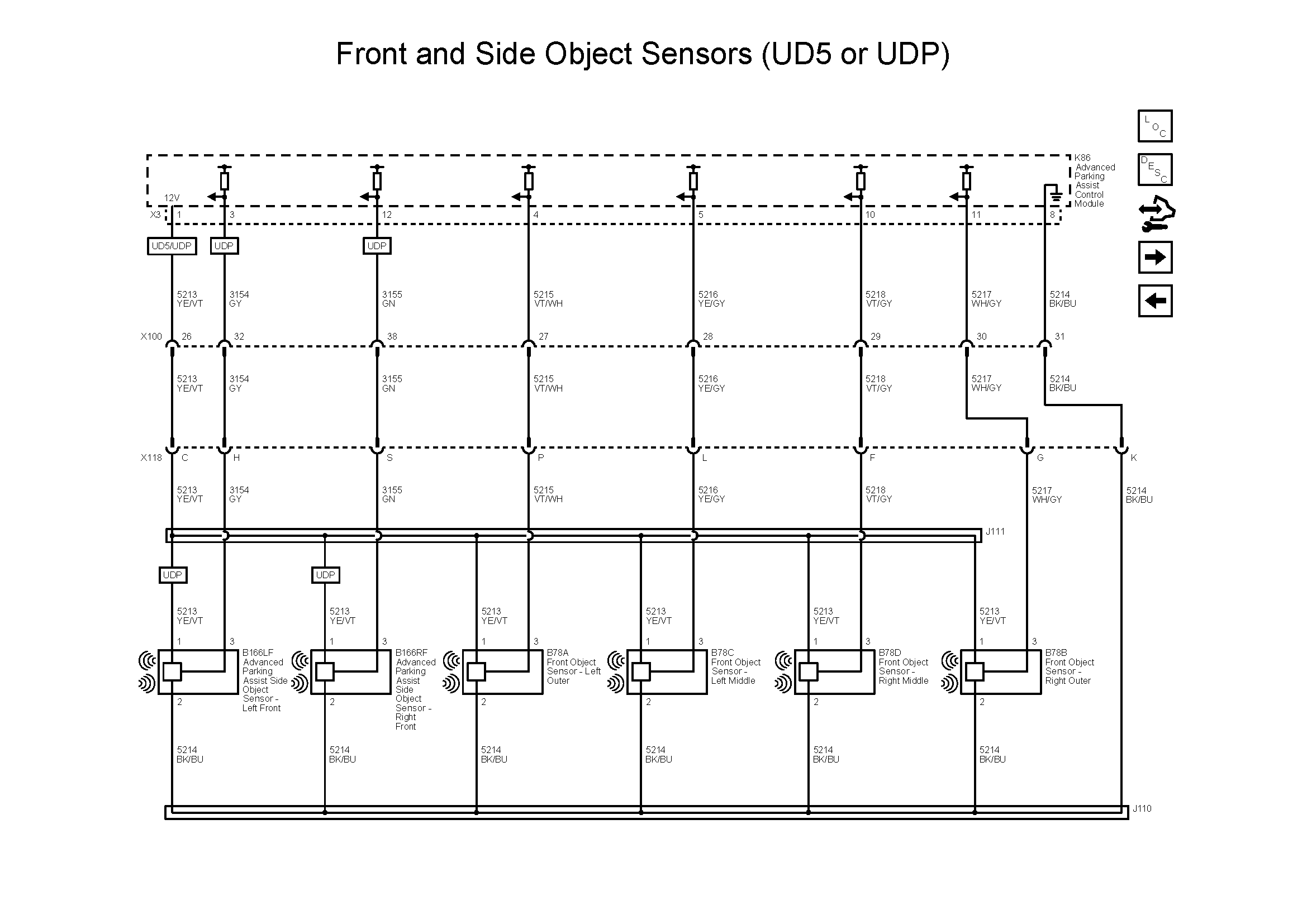

Hi. I need help. I want to retrofit front and rear PDC. I installed module, switch, rear wiring harness(bumper and loom to the module) and front bumper wiring. Now i need to make some custom loom, to connect front bumper harness to the car. I have connectors, i just need some wiring diagram, to know, where to connect wires. I know, that this loom connect under the battery to the other wirings, but anyone have some wiring diagram, to know where to connect which wire?
[attachment=1235]
[attachment=1236]
(8:th-Jan-2021, 20:03:55)milozic Wrote: Hi. I need help. I want to retrofit front and rear PDC. I installed module, switch, rear wiring harness(bumper and loom to the module) and front bumper wiring. Now i need to make some custom loom, to connect front bumper harness to the car. I have connectors, i just need some wiring diagram, to know, where to connect wires. I know, that this loom connect under the battery to the other wirings, but anyone have some wiring diagram, to know where to connect which wire?
Ignore the UDP sensors
