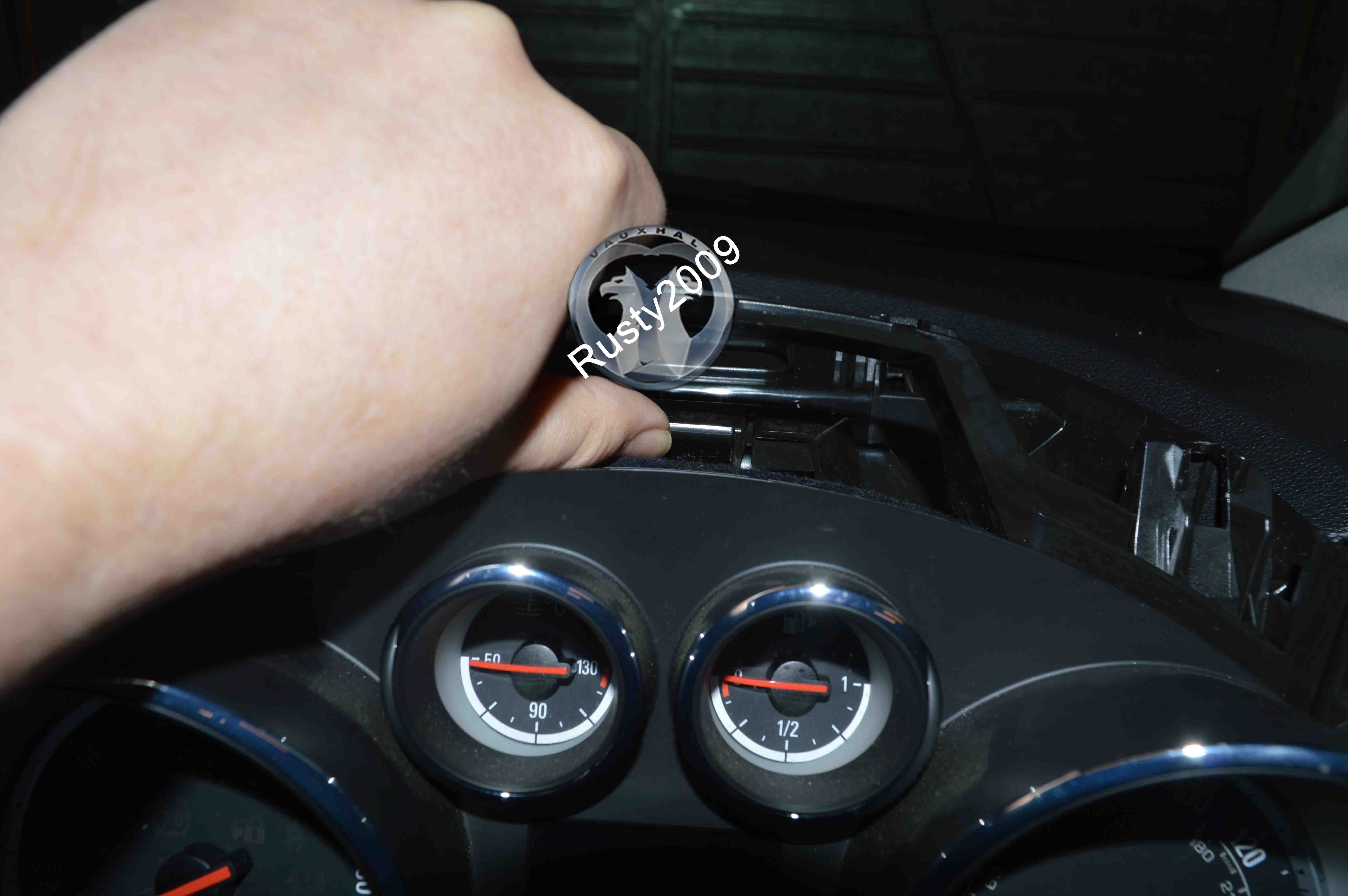

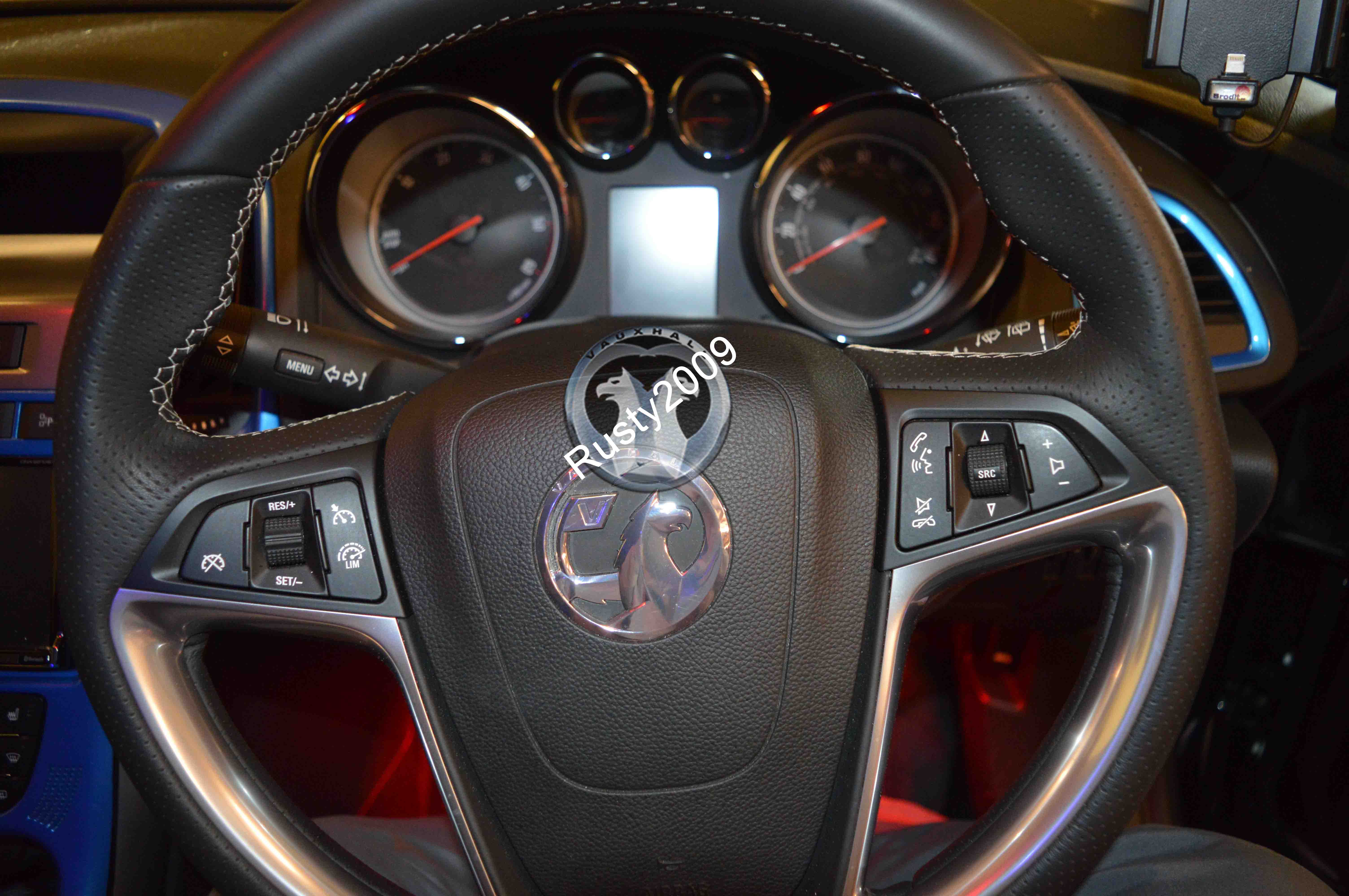

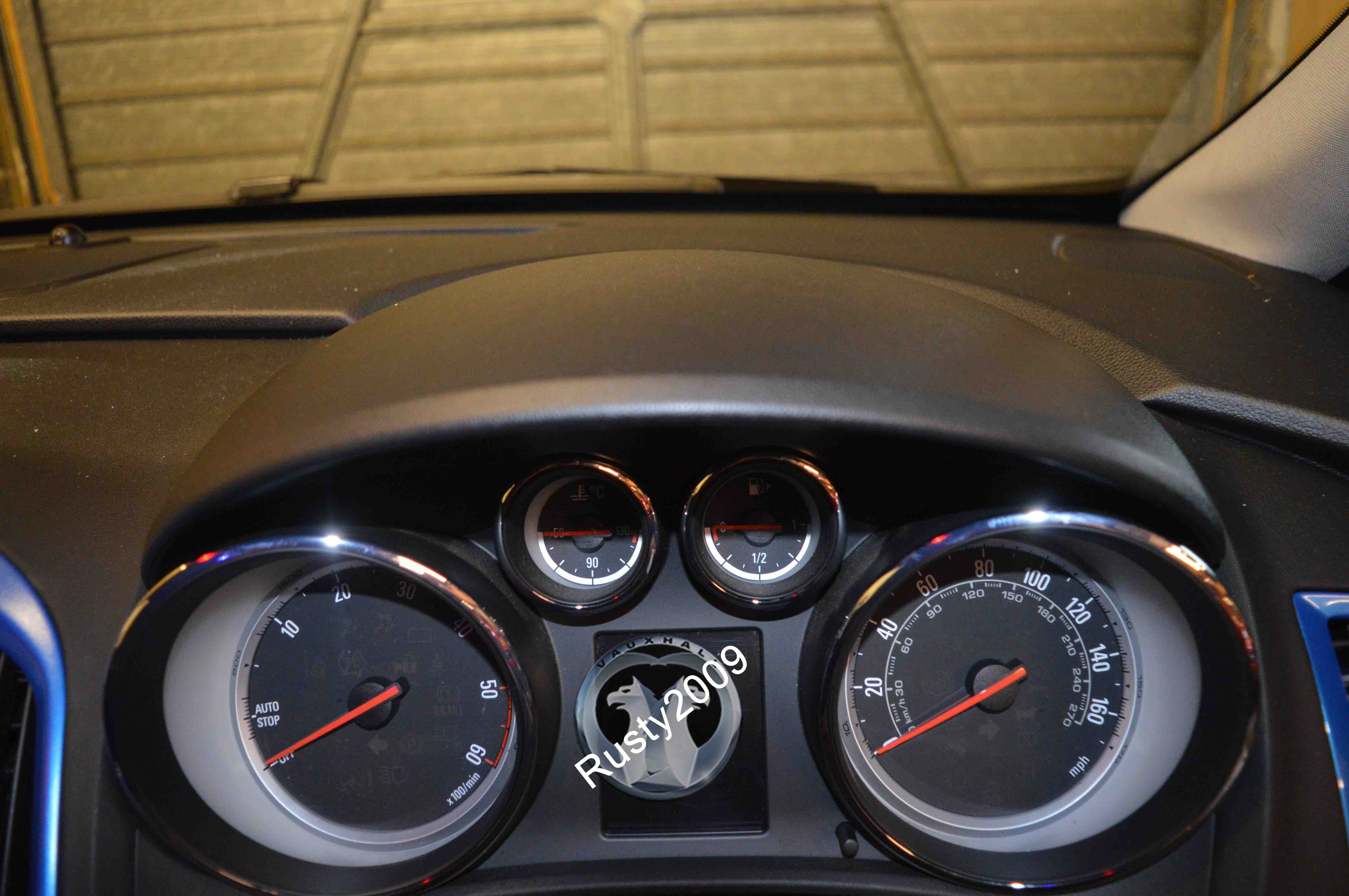

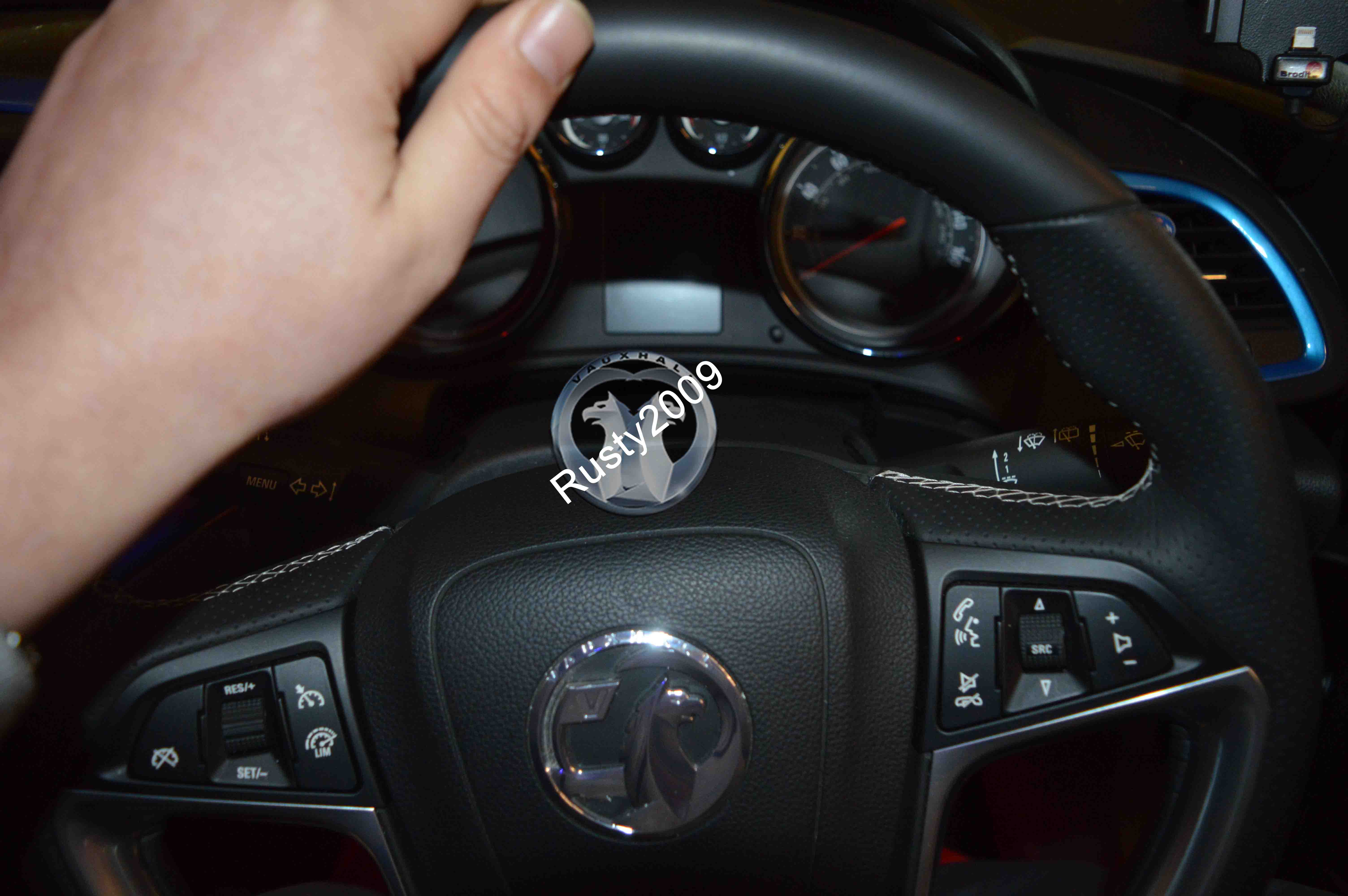

Once you have done that jump in the car and you need to lower and pull out the steering wheel using the rake adjustment
Next you need to take off the top cover, you do this pushing upwards
Then undo the 7mm bolt to undo the retainer strap & place to one side.

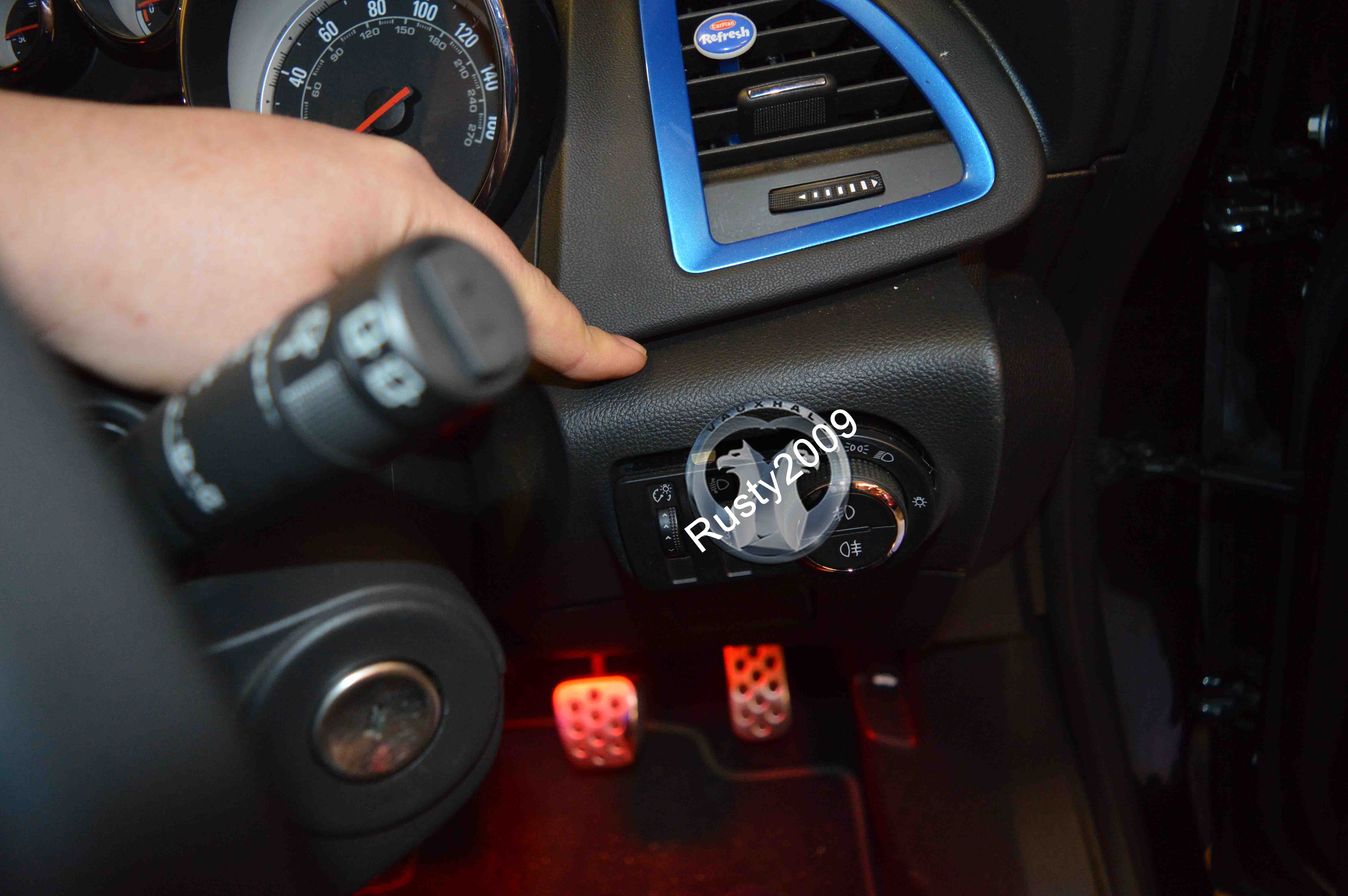

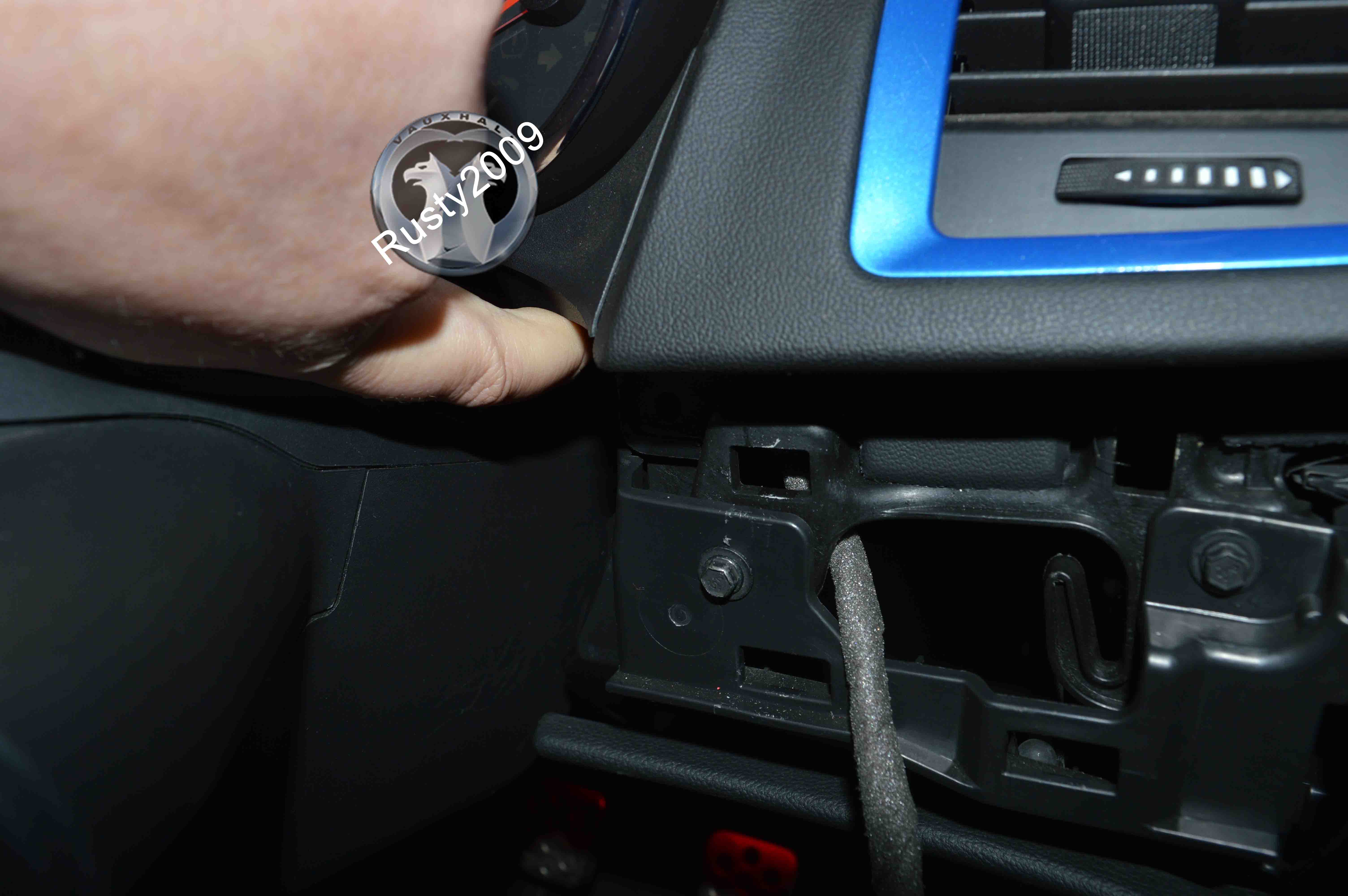

Next you need to take the headlight switch panel off this will just pull off.

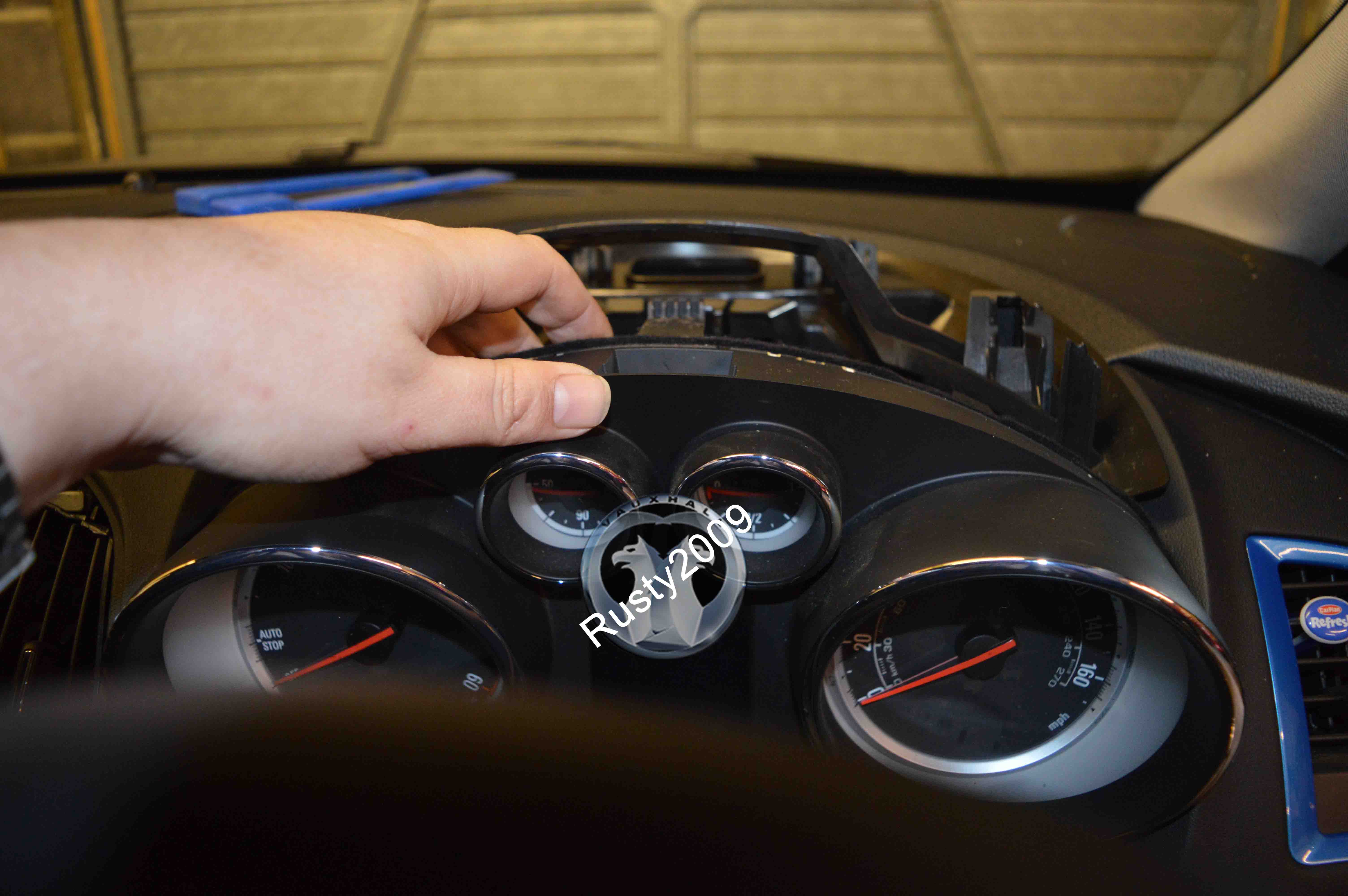

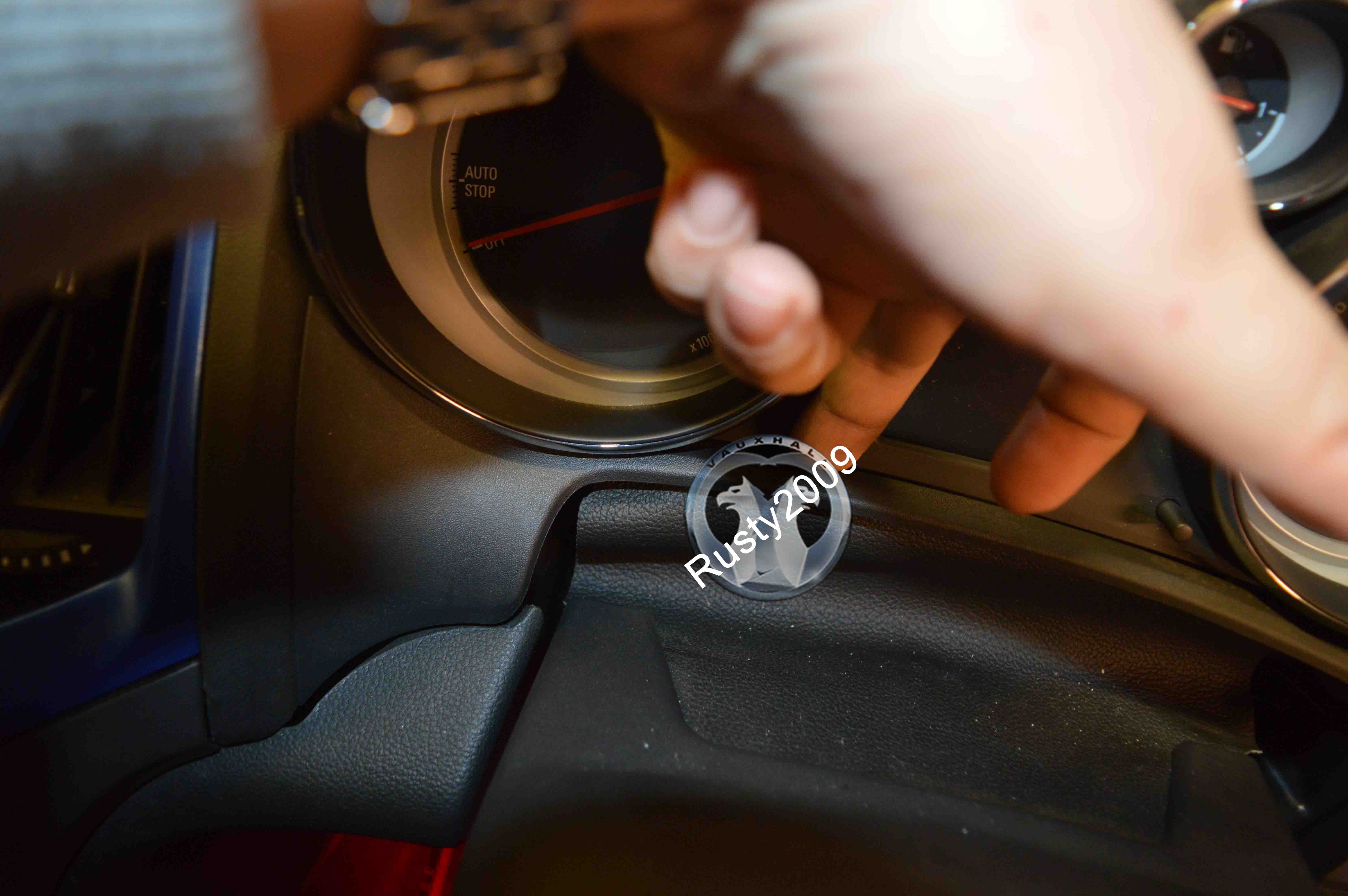

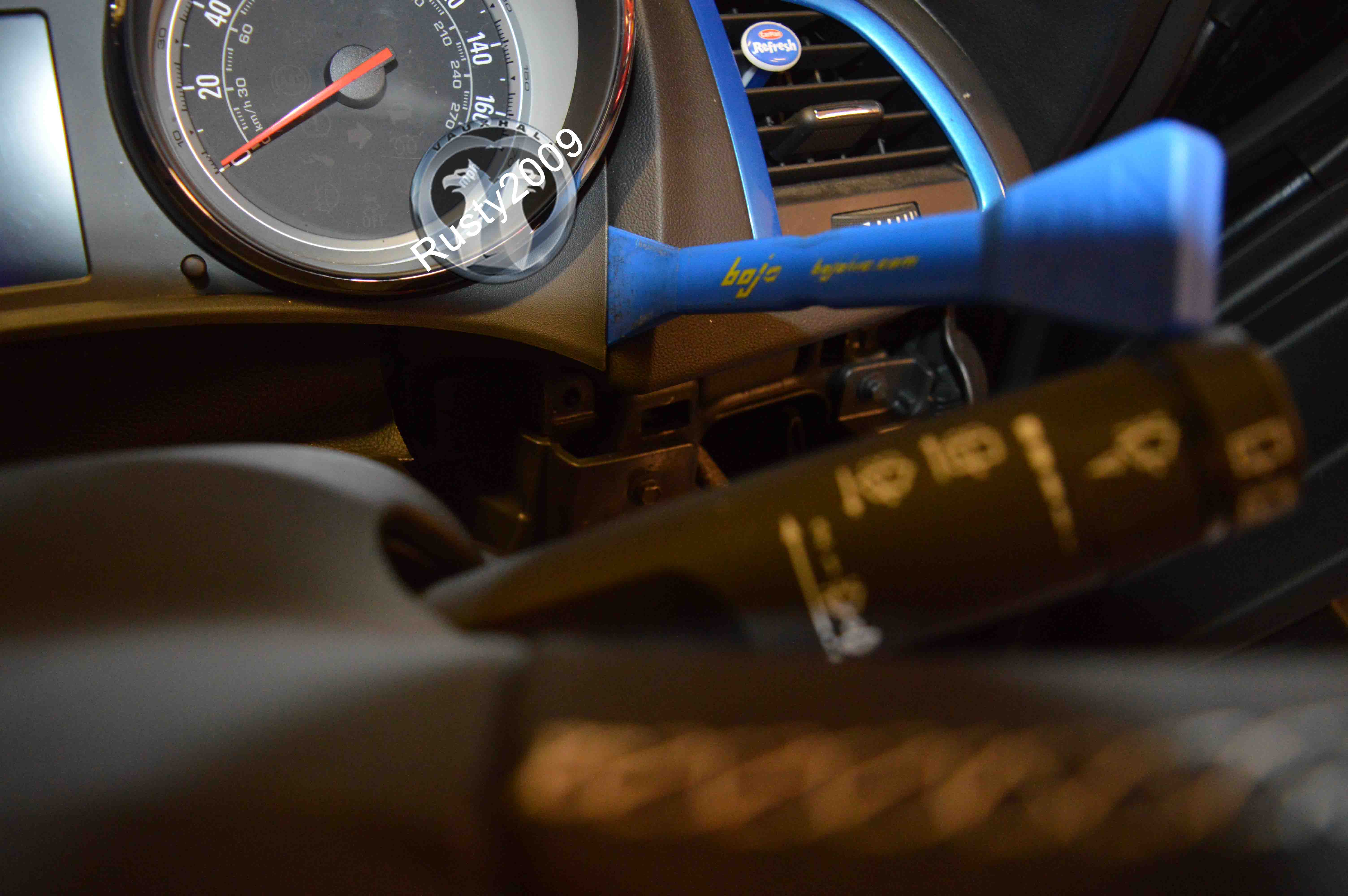

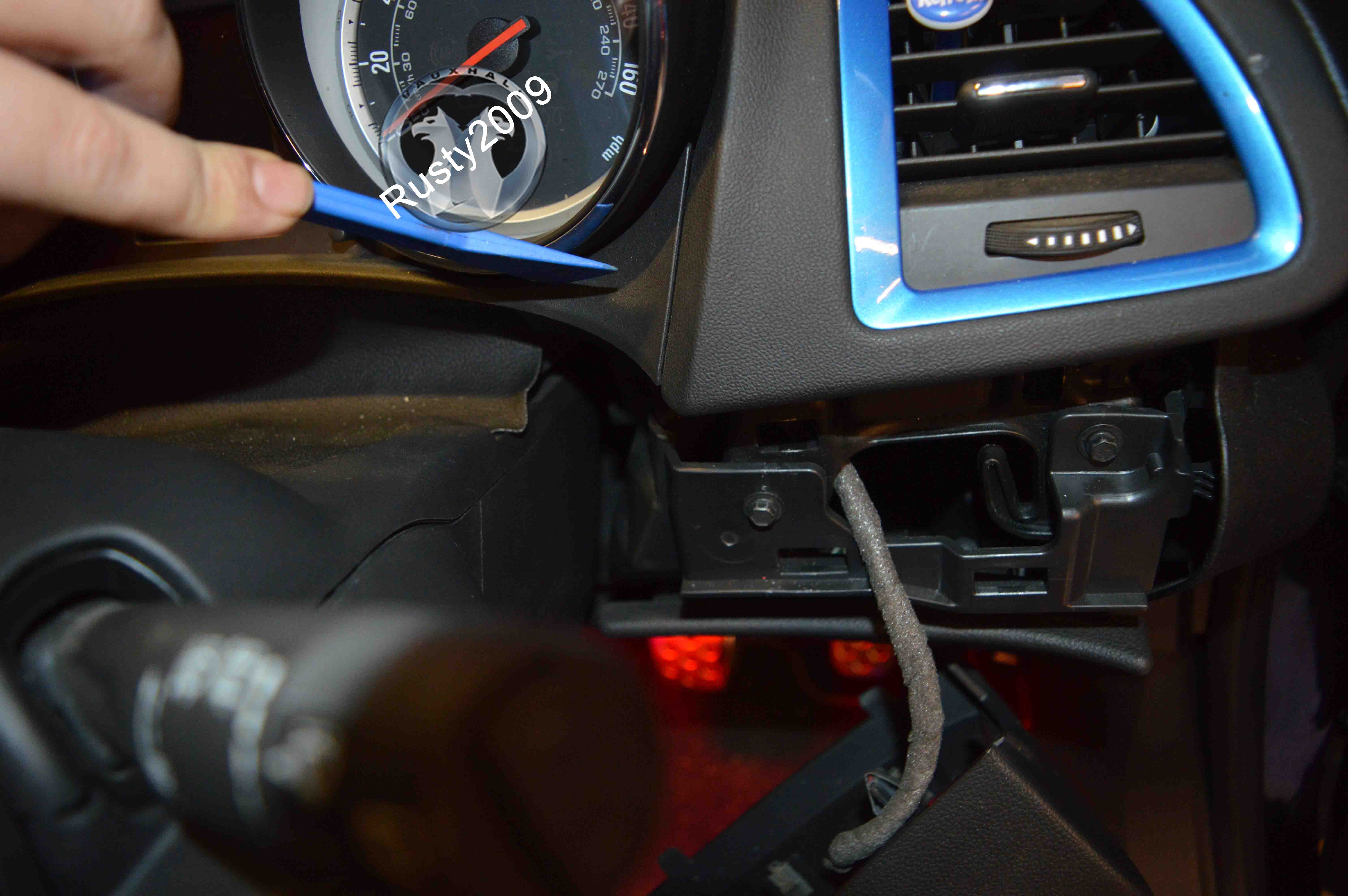

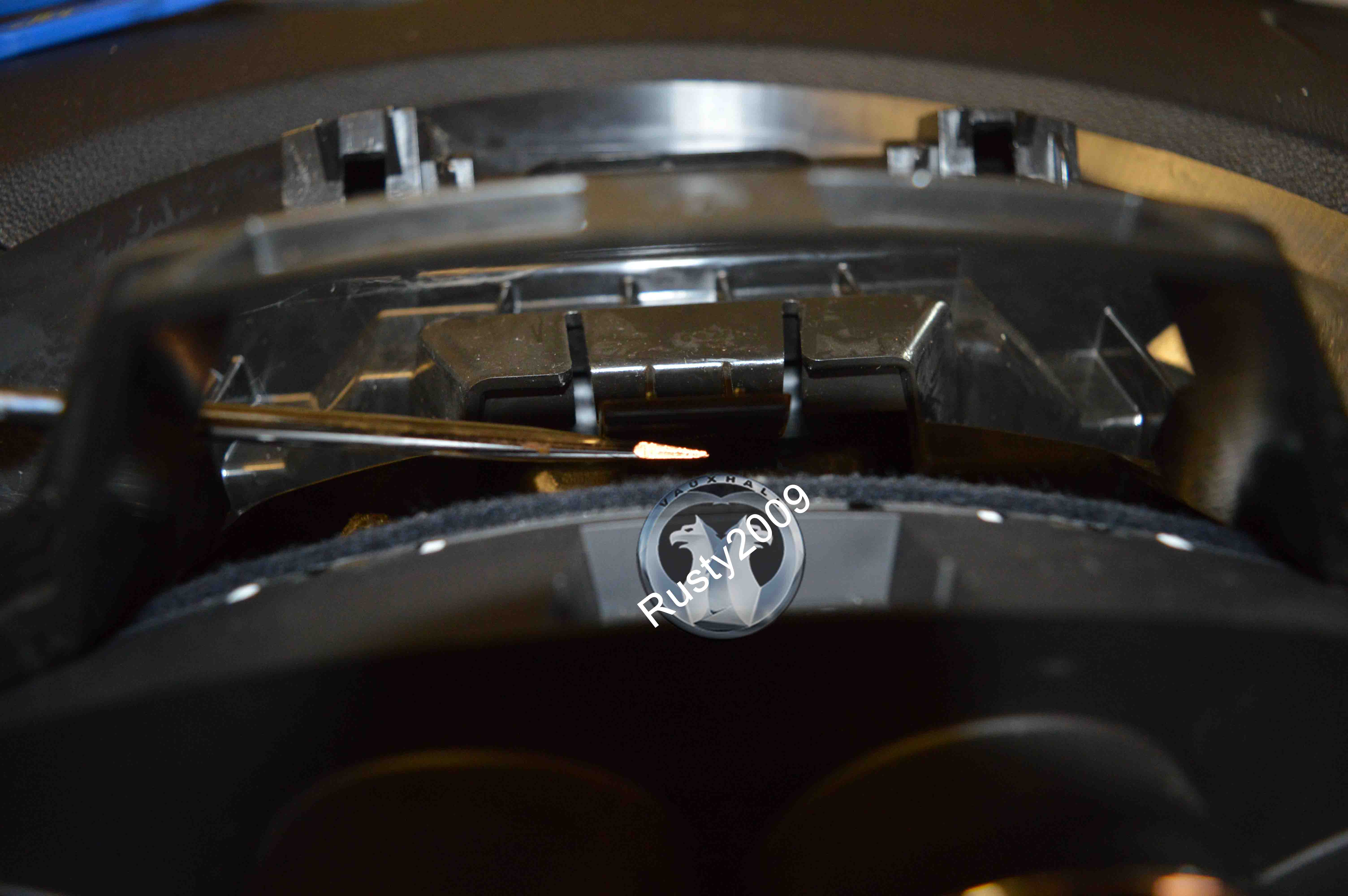

Next you need to remove the cover trim at the front of the IPC.
You could use your finger underneath it or a trim tool
Move along the trim
Then at the other use a trim tool again to pop it off

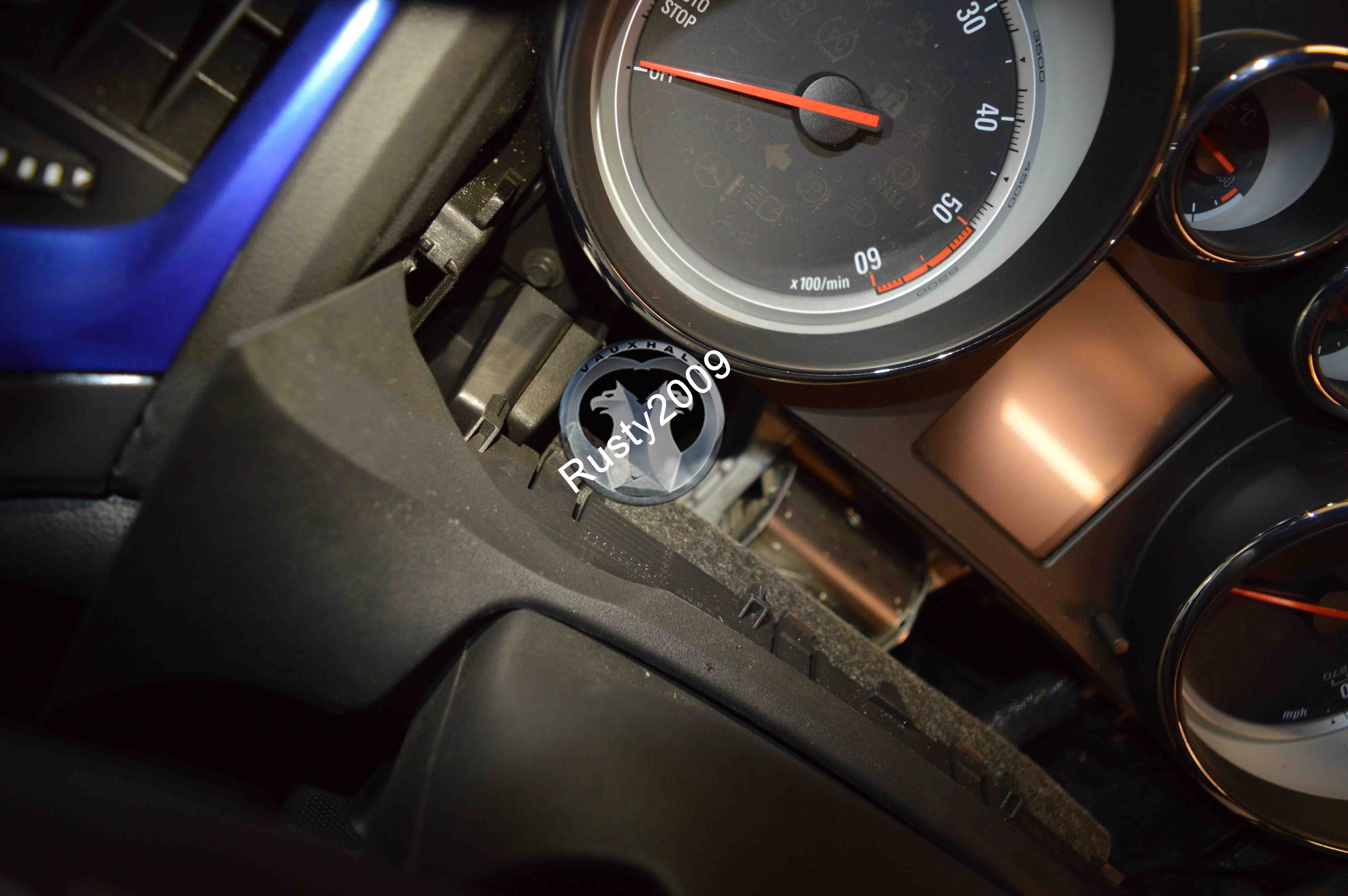

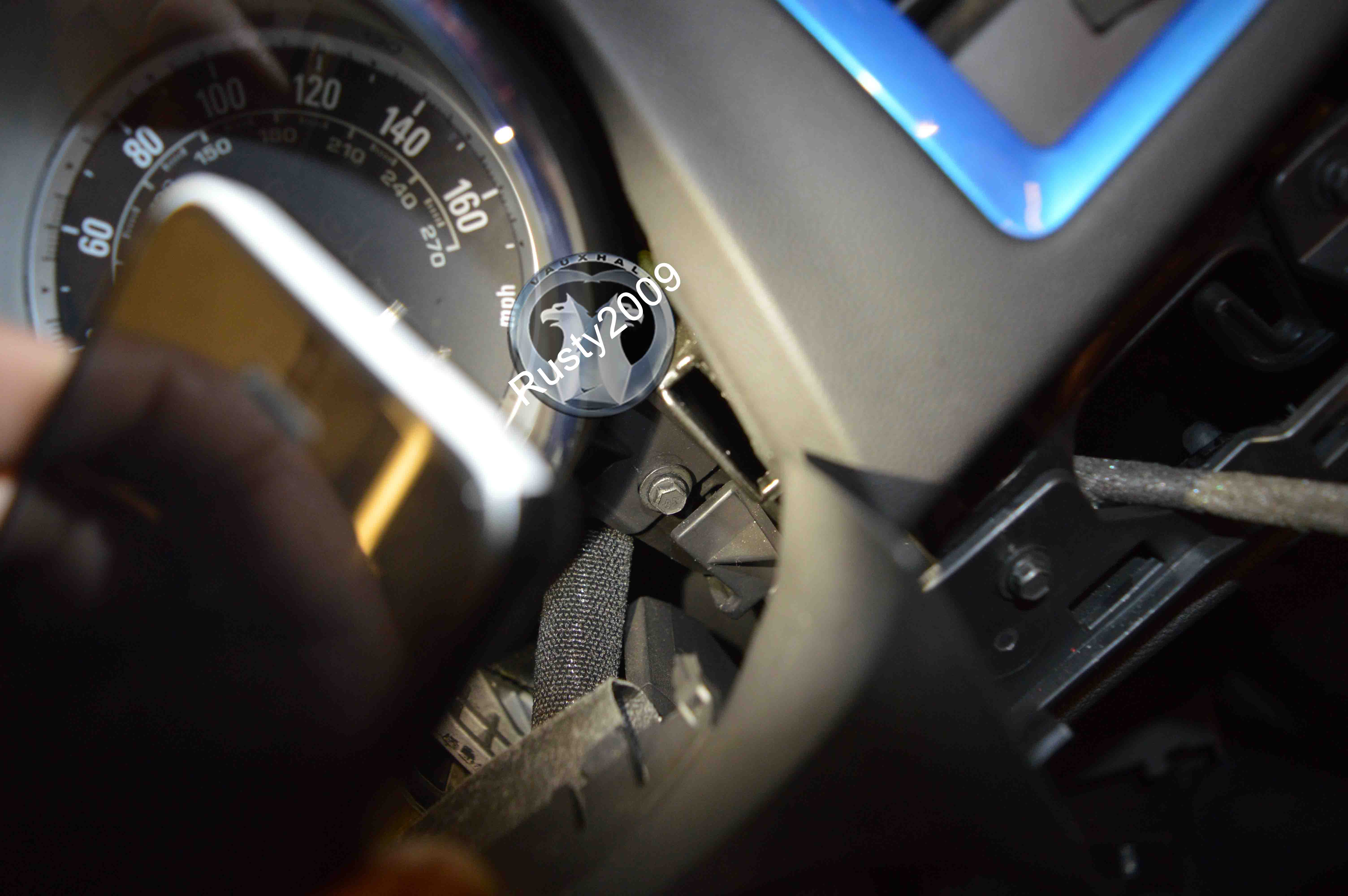

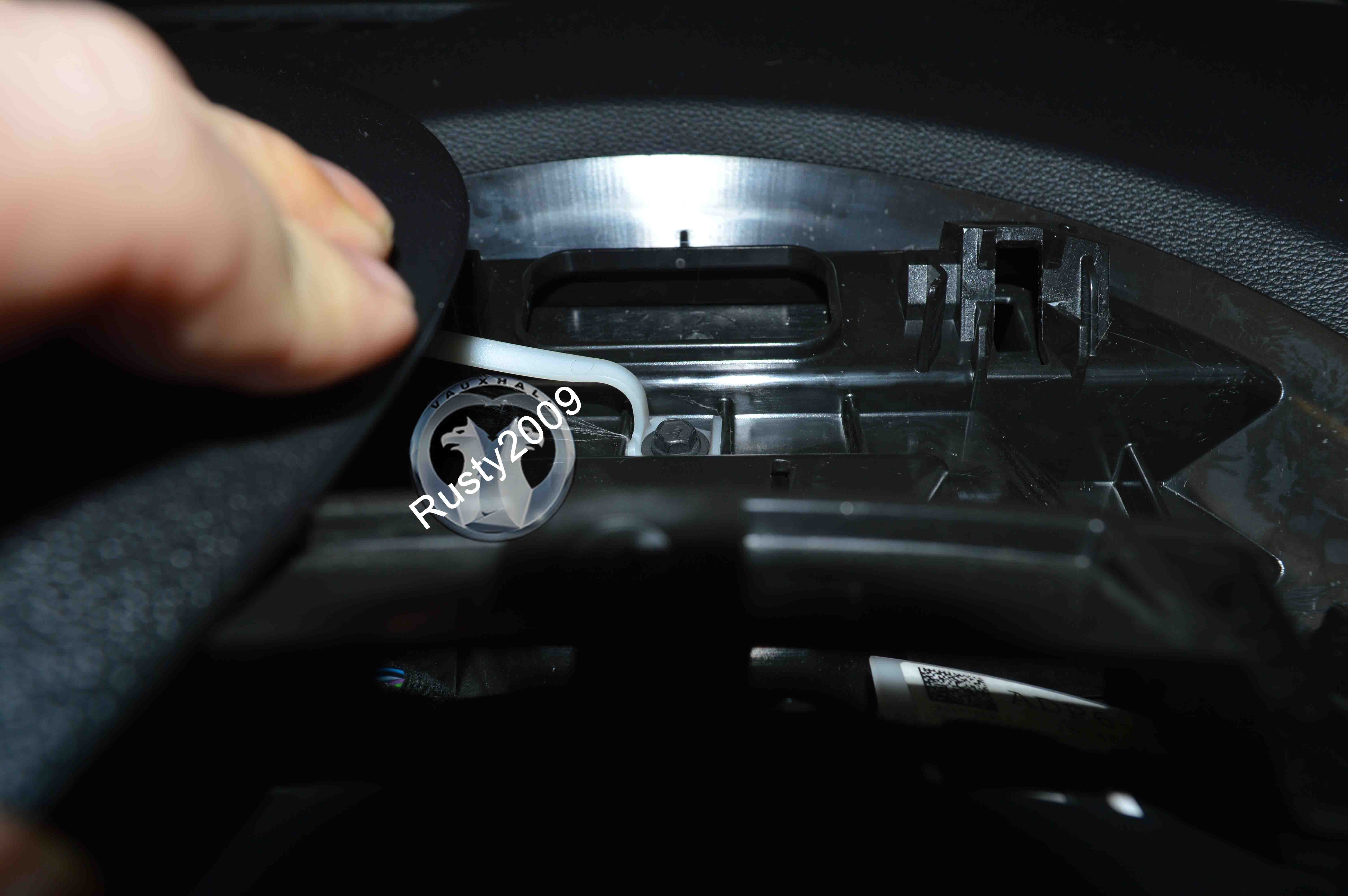

There are 2 7mm bolts that need to undone, one is a bitch to get to.

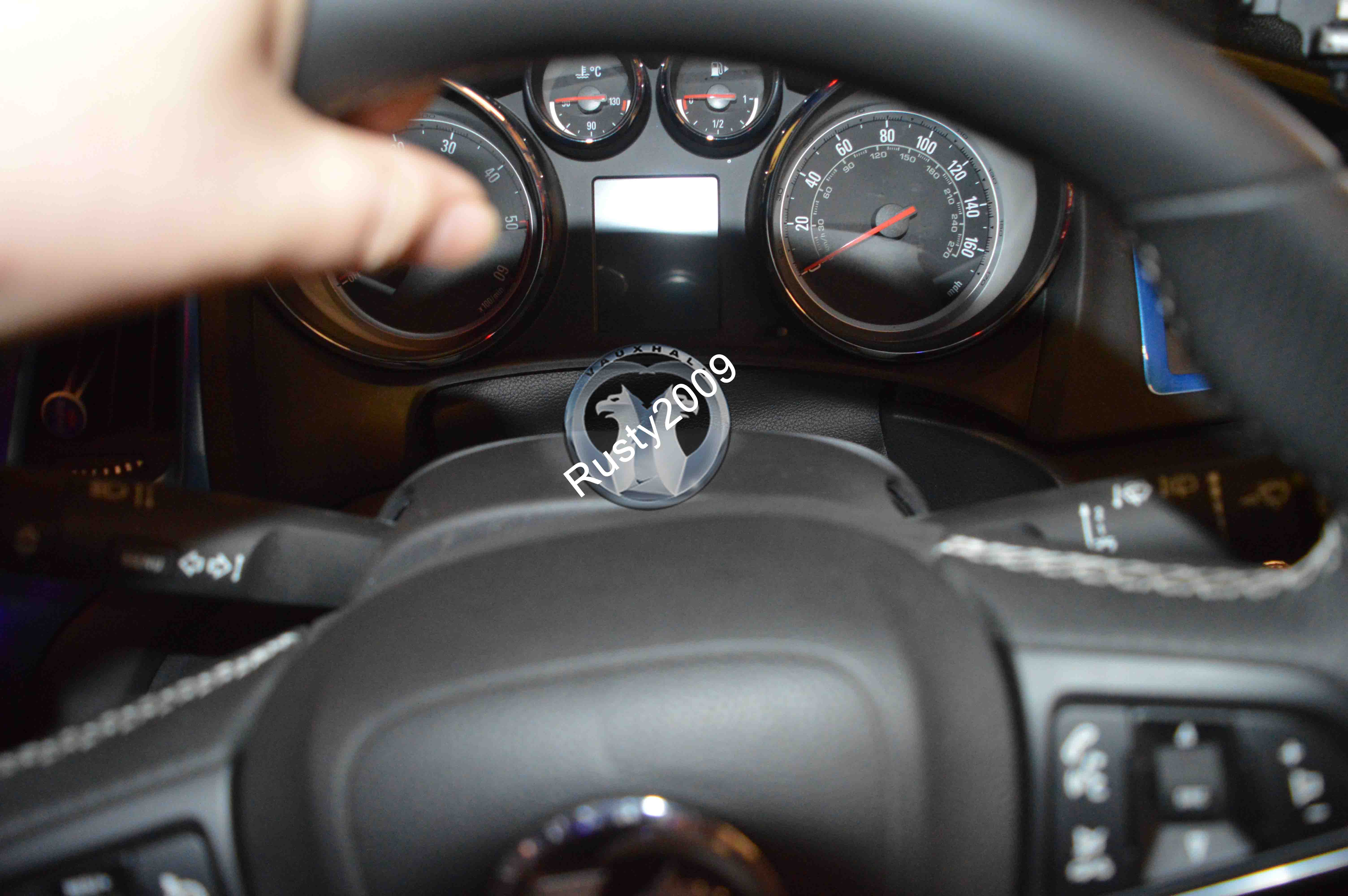

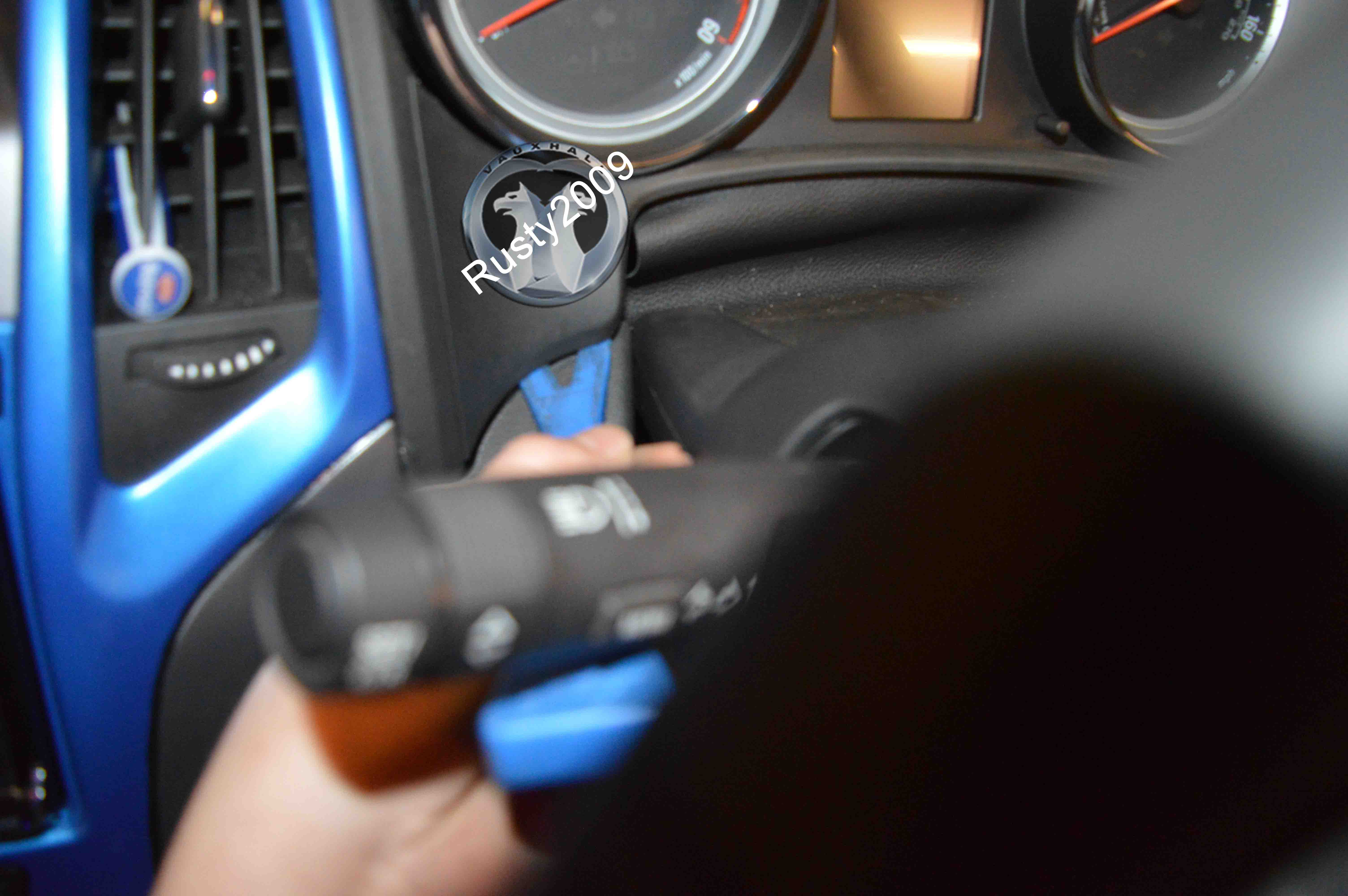

Next you need to push this tab upwards (it's very rigid)

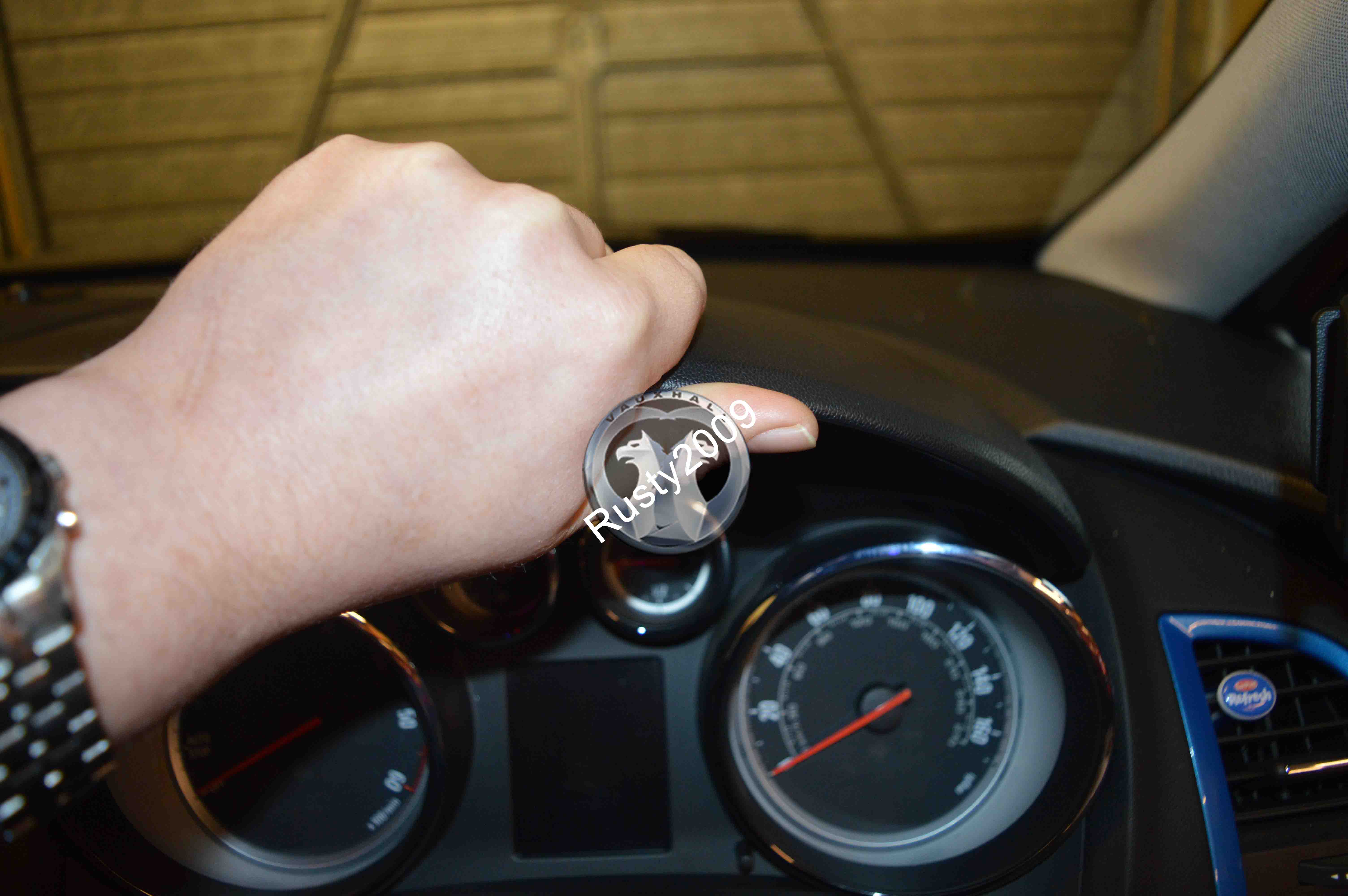

Top tip is use 2 slot head screw drives one in each side and prise down at an angle

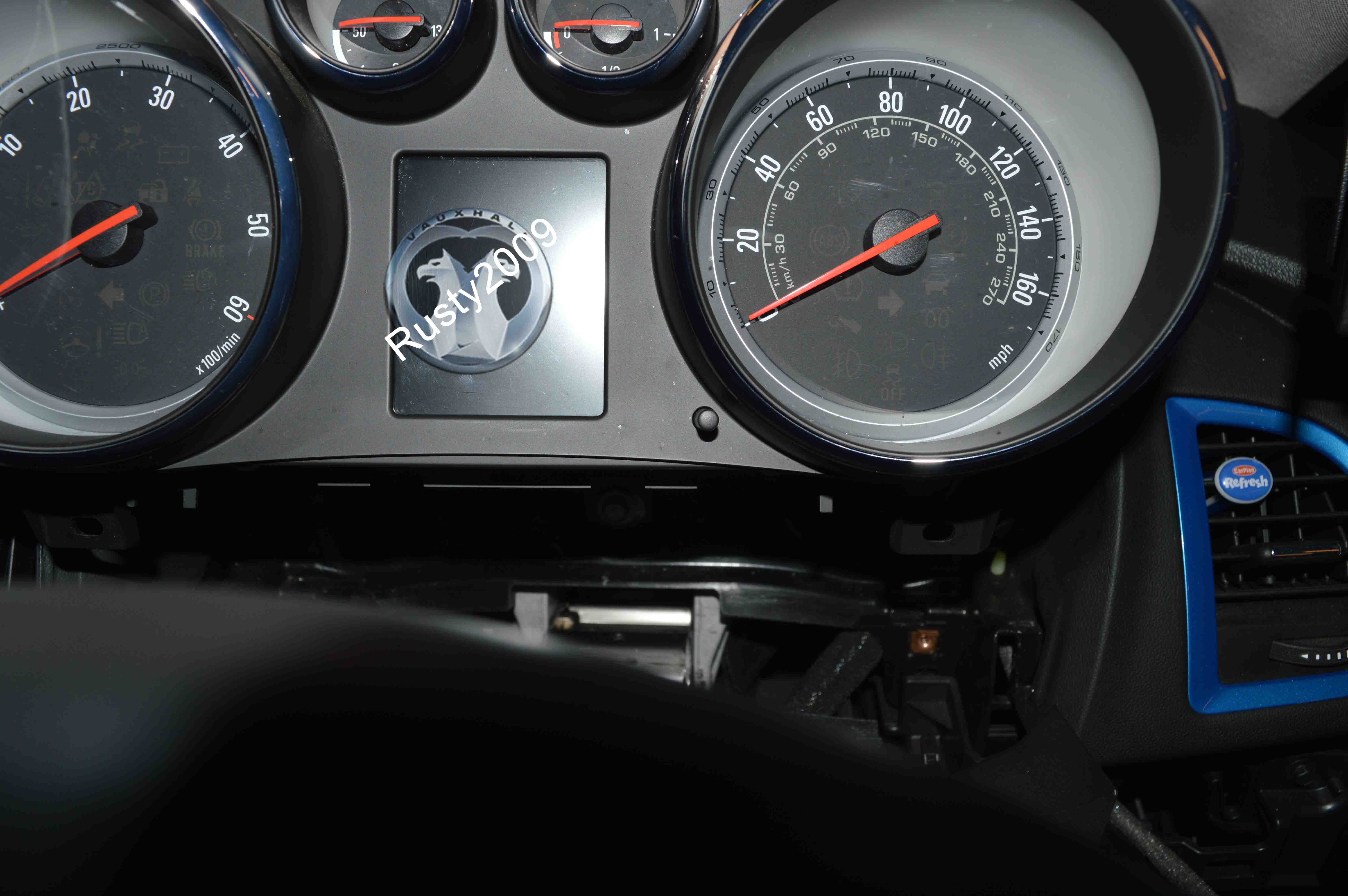

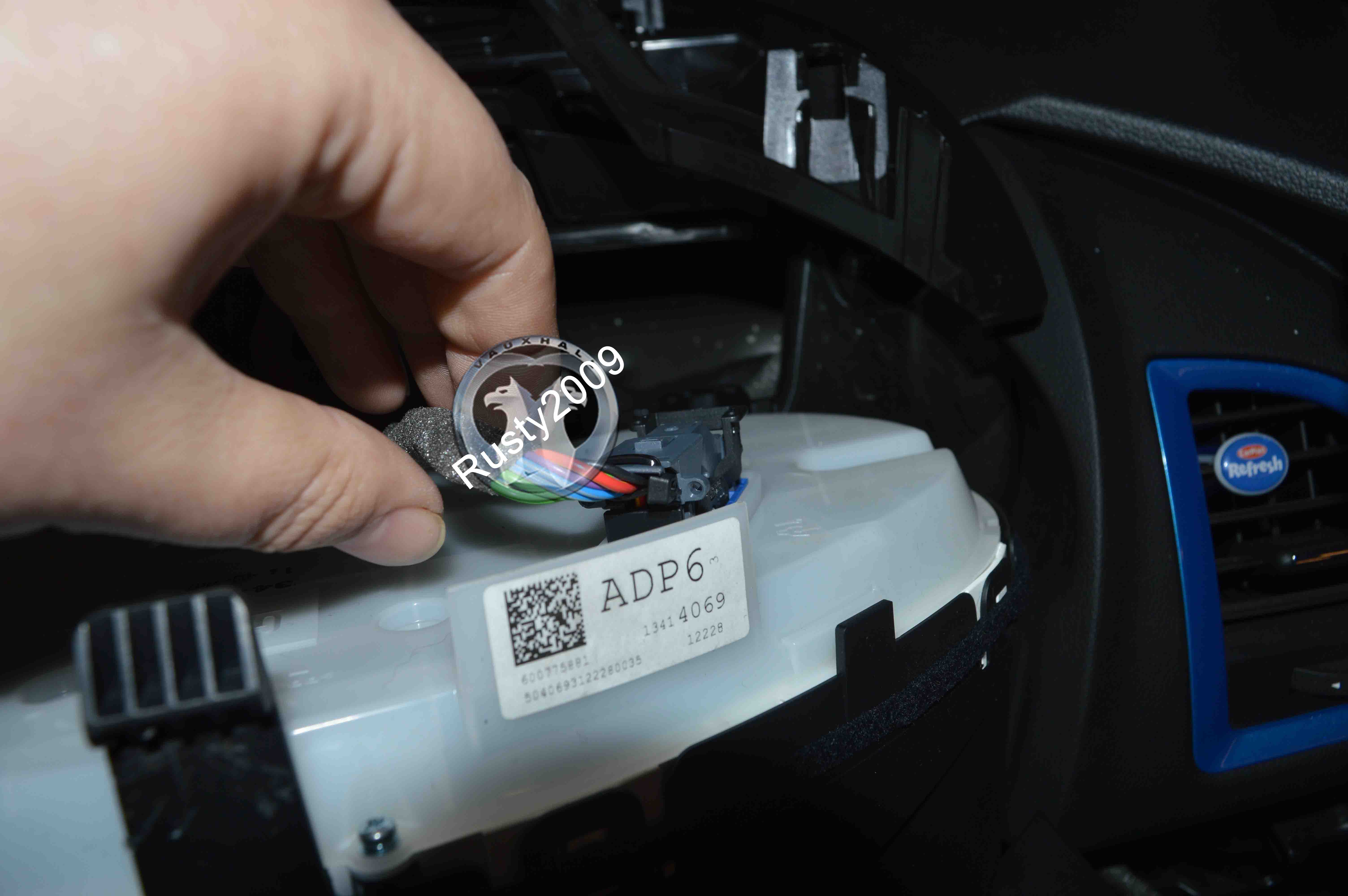

The IPC will start to come out once it does tilt it forward and pull up

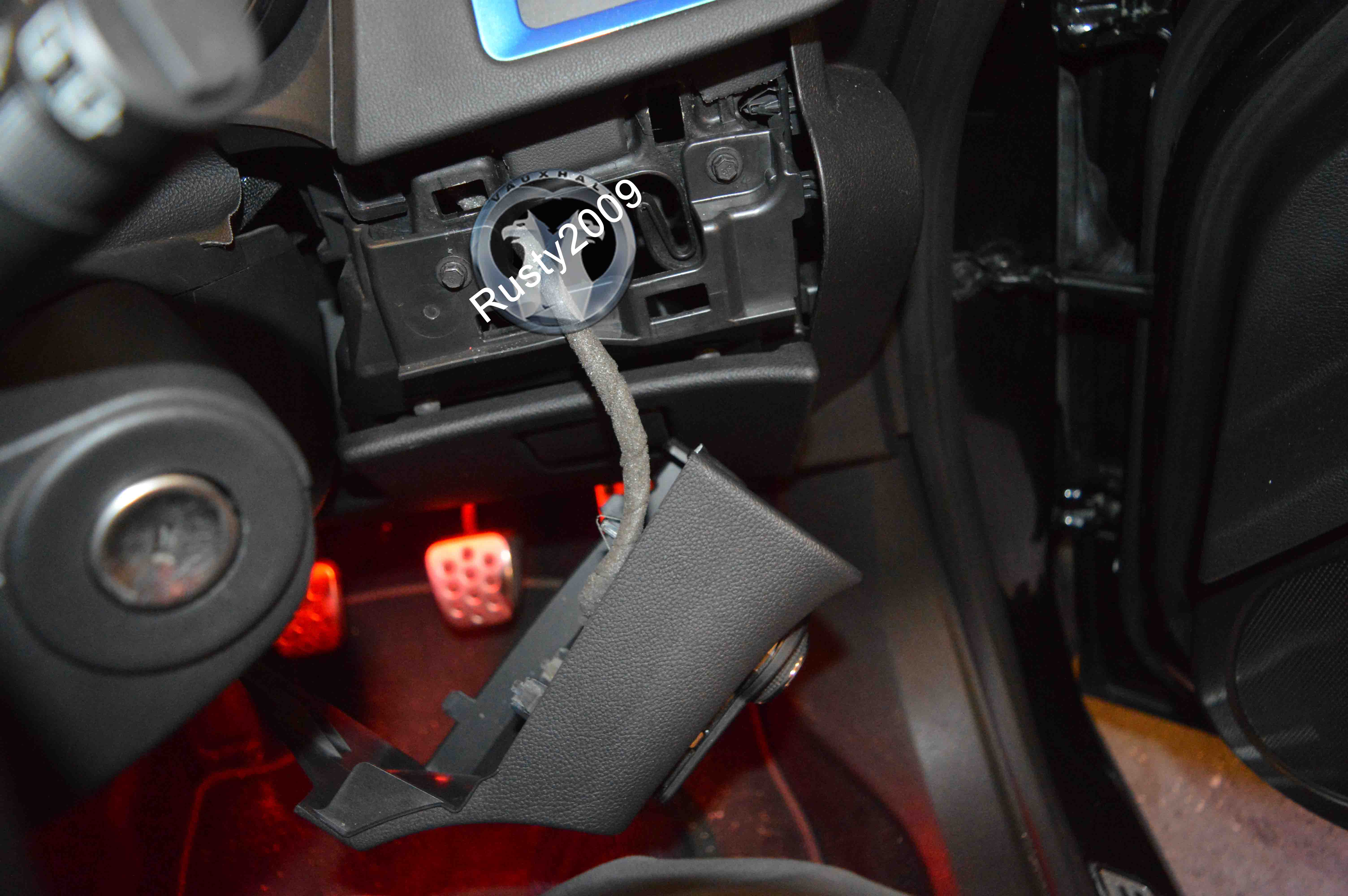

Next remove the plug (push the small tab in and pull the grey lever back)
