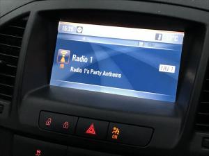

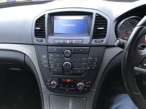

Just completed refitting a DVD800 into my 2010 Insignia.

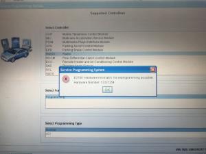

But have problem with programming. I do have a genuine  GM MDI. Although under SPS programming, there is no option to change VIN number on DVD800 ?
Only option available is programming, which fails with "E2700 : Hardware Mismatch No Programming Possible".
Anyone has any solution to for this ?

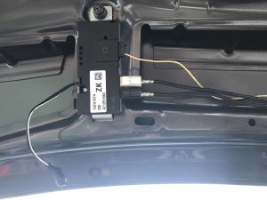

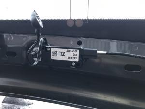

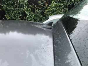

Fiitted DVD800  complete with Diversity antenna
Unfortunately, stuck on programming.

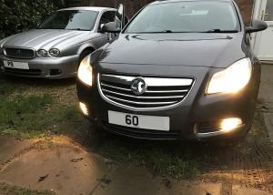

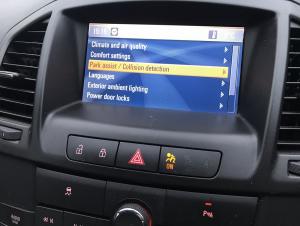

I've also fitted front fog lights, full Park assist (OEM).  Again I can find no option via SPS to enable them. ?

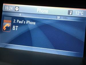

Bluetooth (UPH) was very to fit.
Fog lights needs a VCI code to enable them in the BCM,
IPC needs a setup and config and turn the option on.
Park assist doesn't require a VCI and can be done via SPS on the PDC module & setup & config on the IPC.
As to the radio it can be done but as I said no one is going to tell you their secret on doing it, you will have to pay someone who knows how to do, to do it. As your Norfolk VXMODS in Cheshire is your closet.
I've completed programming. Now everything works as it should do.
