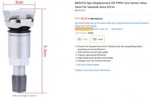

I have attached images of
1. Mine in place
2. Version A available on internet looks like mine
3. Version B on internet. Is this the same as A but with the securing nut removed?
4. Valve only, with no tpms, is this designed for my car?
A large reputable local tyre fitter, Micheldever Tyres, have a universal tpms device called an i-smart, does anyone know anything about this brand?

Vauxhall had 2 different sensors at the time a brown https://smile.amazon.co.uk/Schrader-3026...-chr-uk-21
These were succeeded with the one's you have in the 3rd pic
https://www.vxoc.org.uk/forum/attachment.php?aid=1177
If you have the black one you need these
https://www.ebay.co.uk/itm/Replacement-T...SwF3BeXh-A
If it's just the Nut you can replace just that part, part number is 24455308
In the end local Kwik Fit said they could replace just the valve stems for £20 per wheel, job done, but will wait until I am sure the slow punctures are fixed
