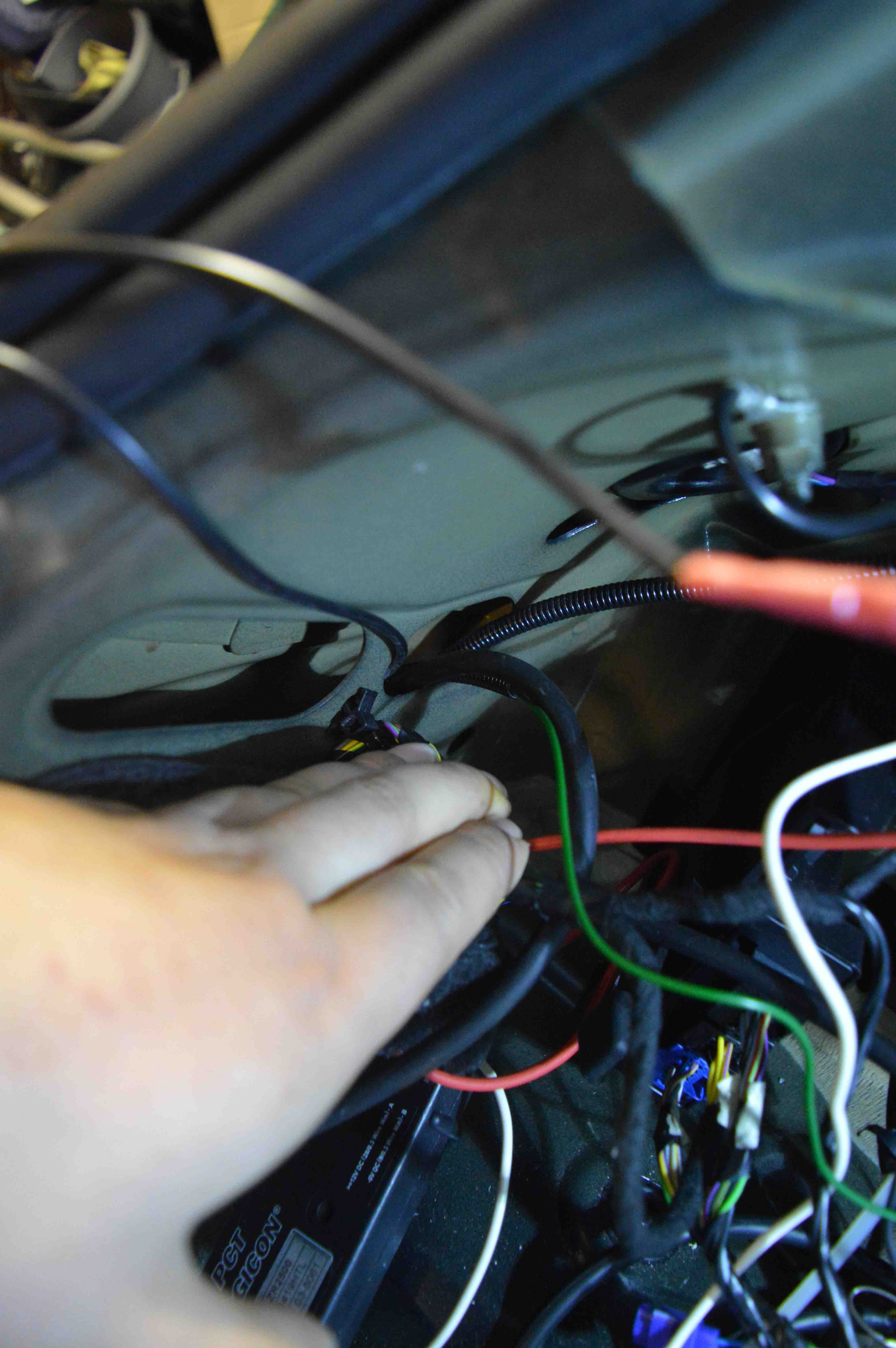

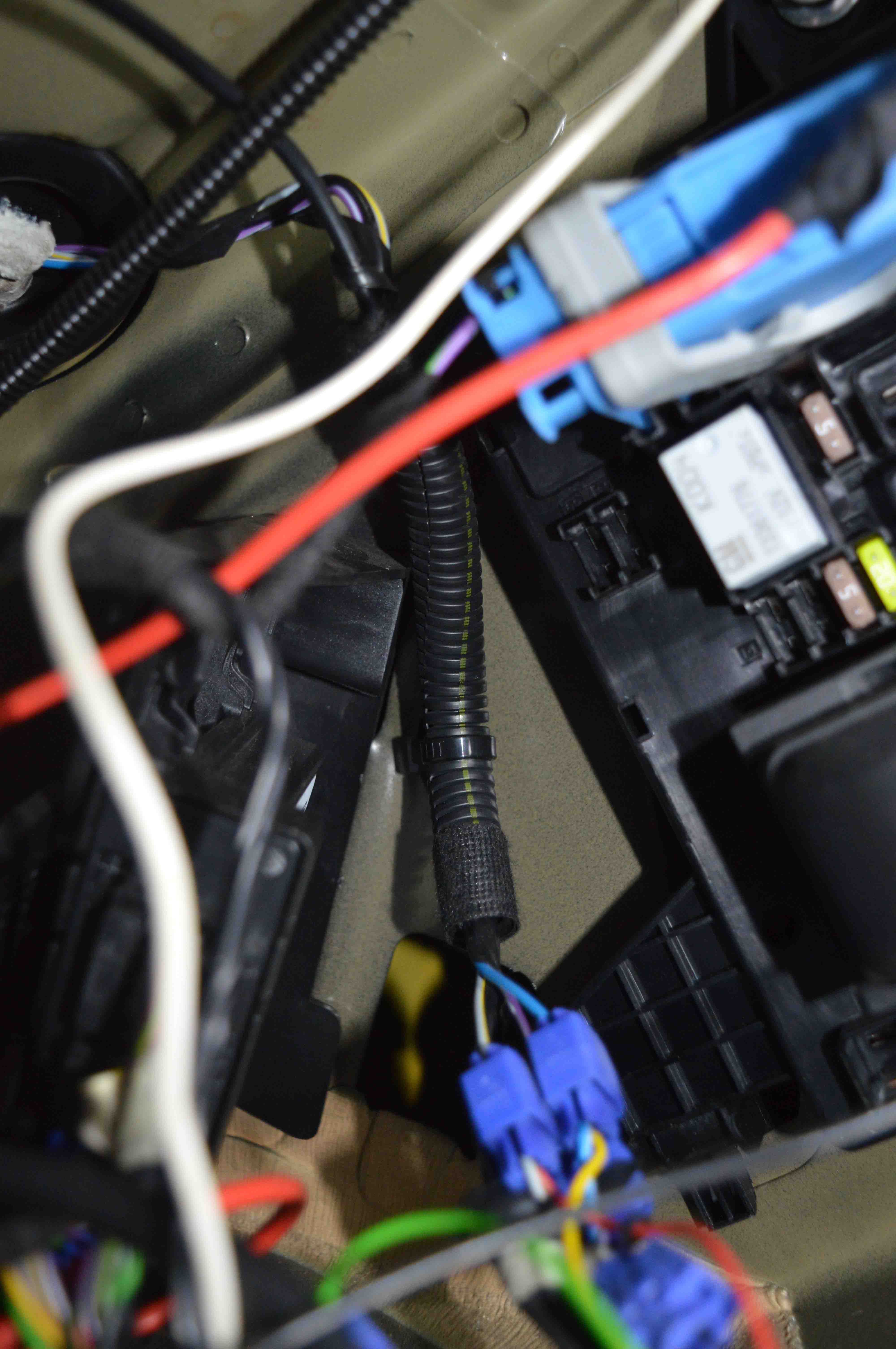

I'm just going to start taking the side trim off so I can get you pics and details for the Towbar wiring.
Right mate here you go.
runs in the car here

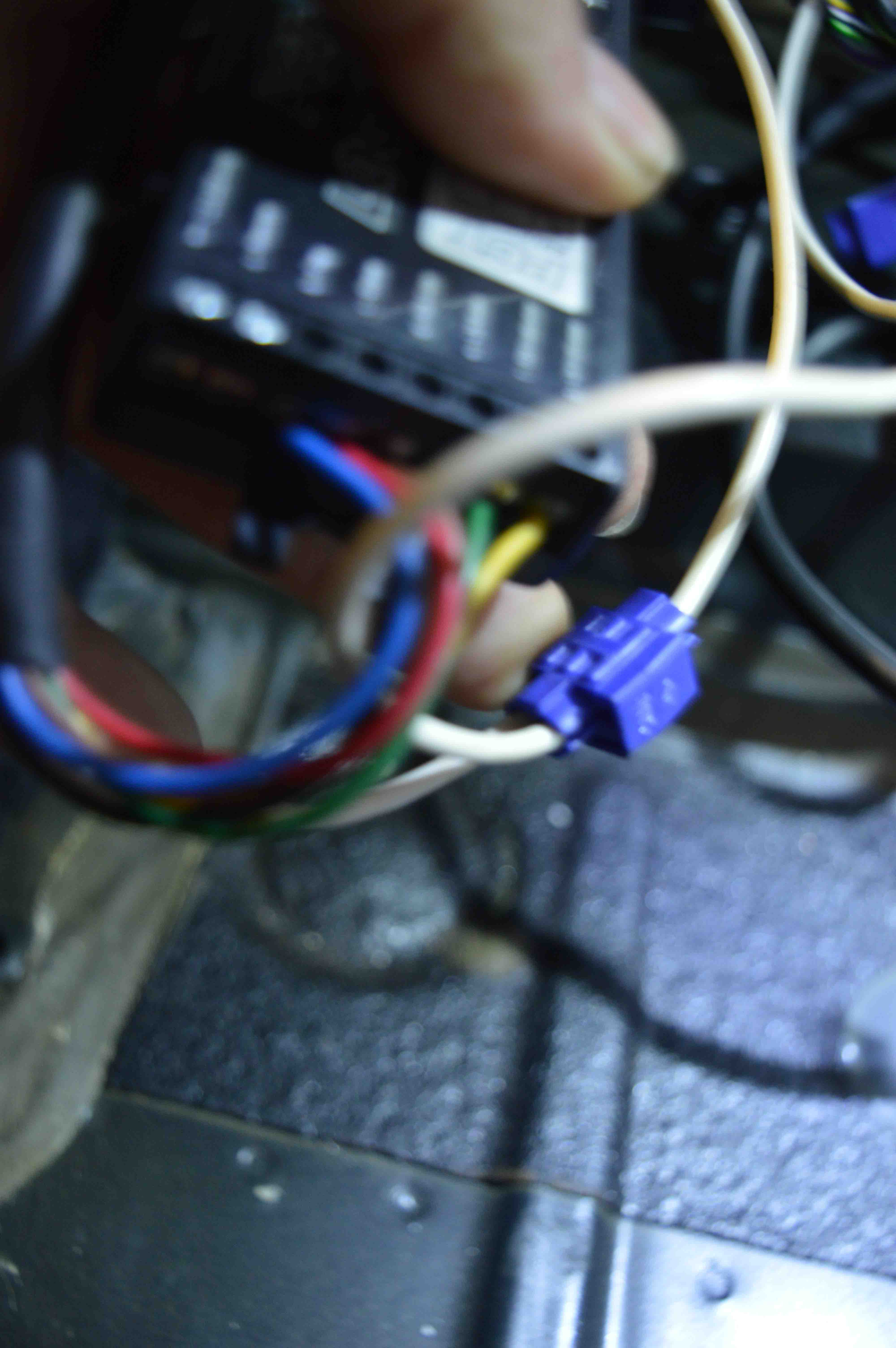

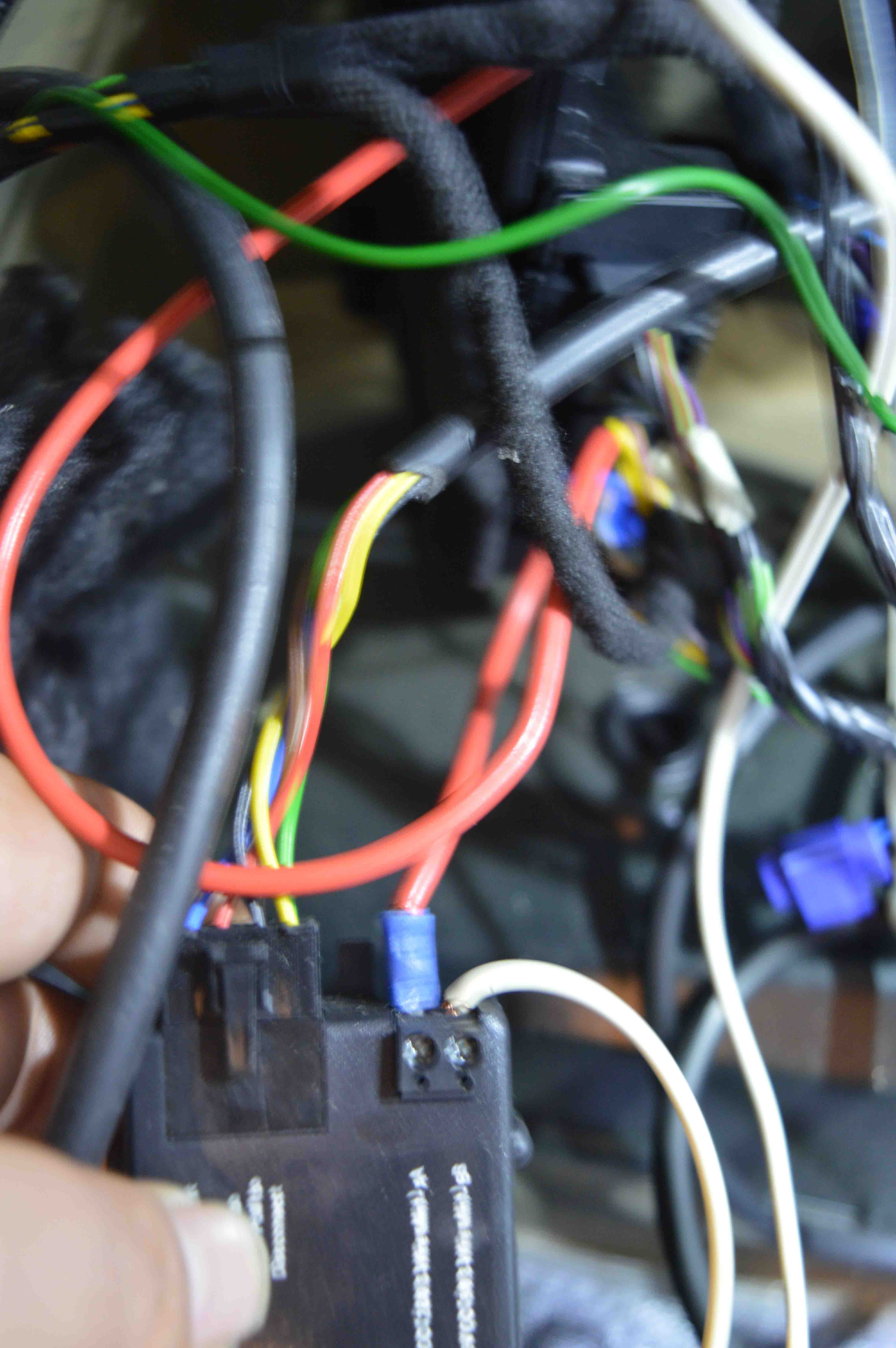

connects into the relay module

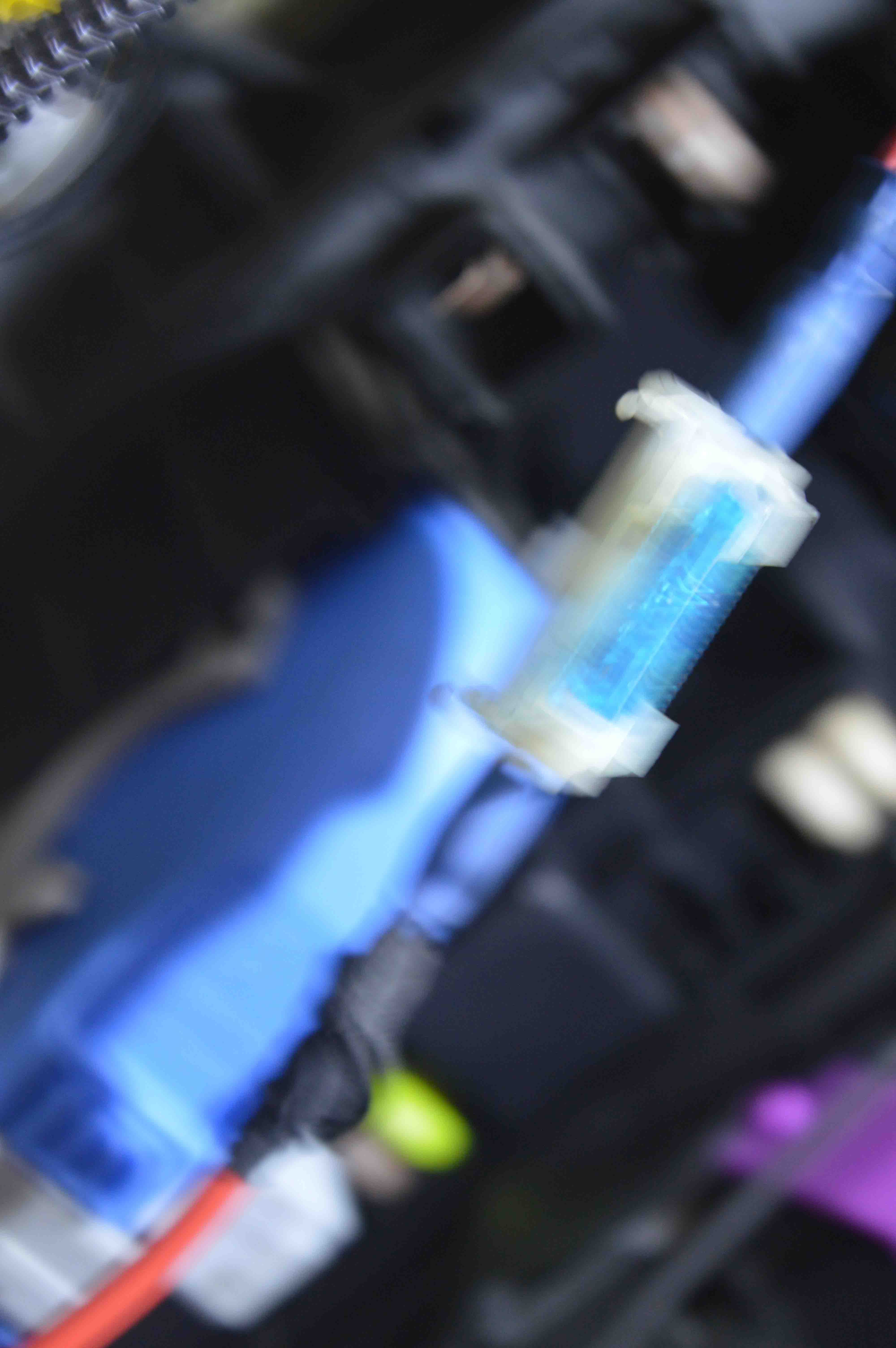

Power is comes here on the fuse board 05 has an inline 15A fuse then into the module

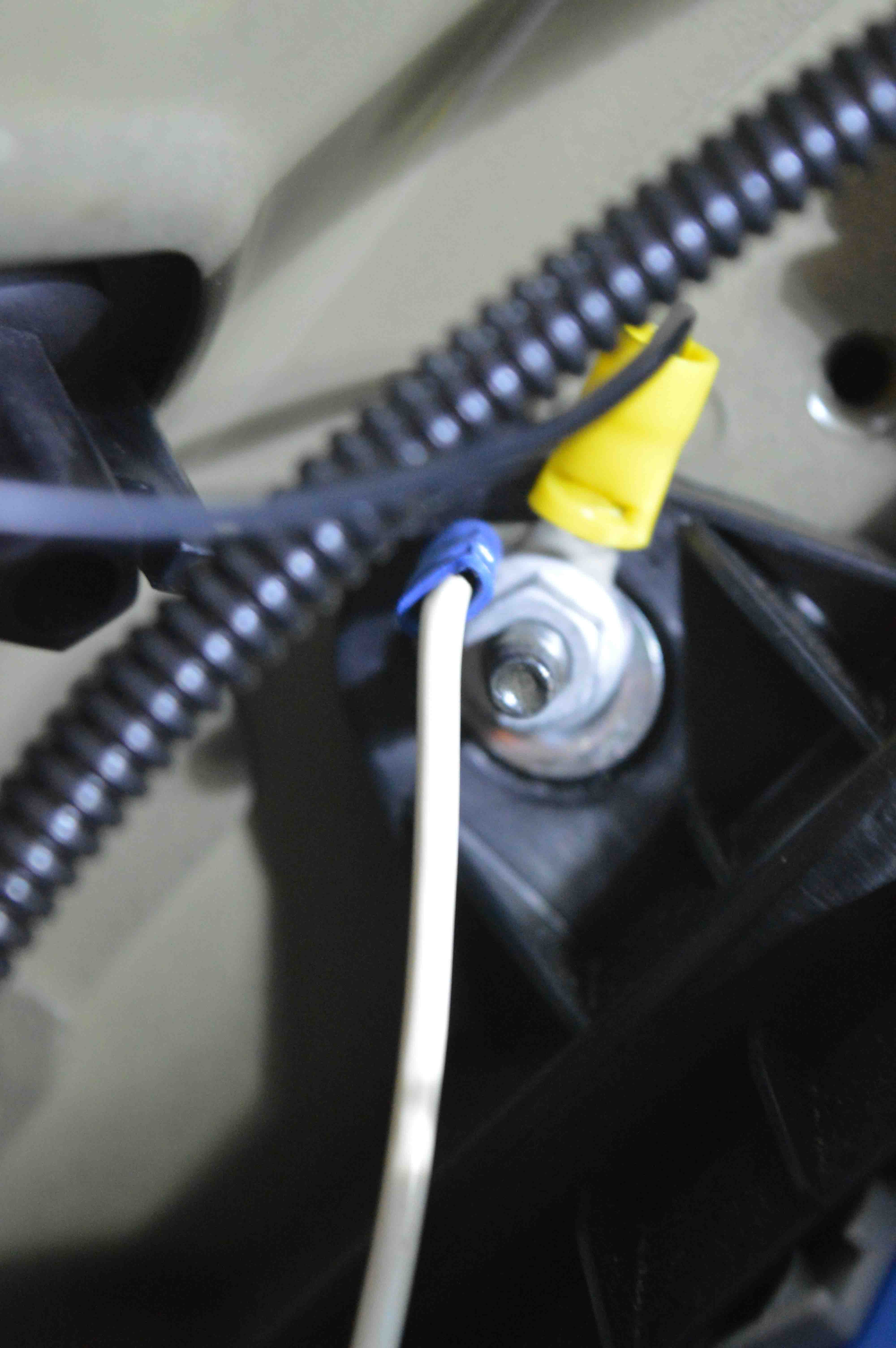

The White wire that come into the car is spliced the wire goes to a ground (they used the nut on the fuse board) the spliced wire goes into the module.

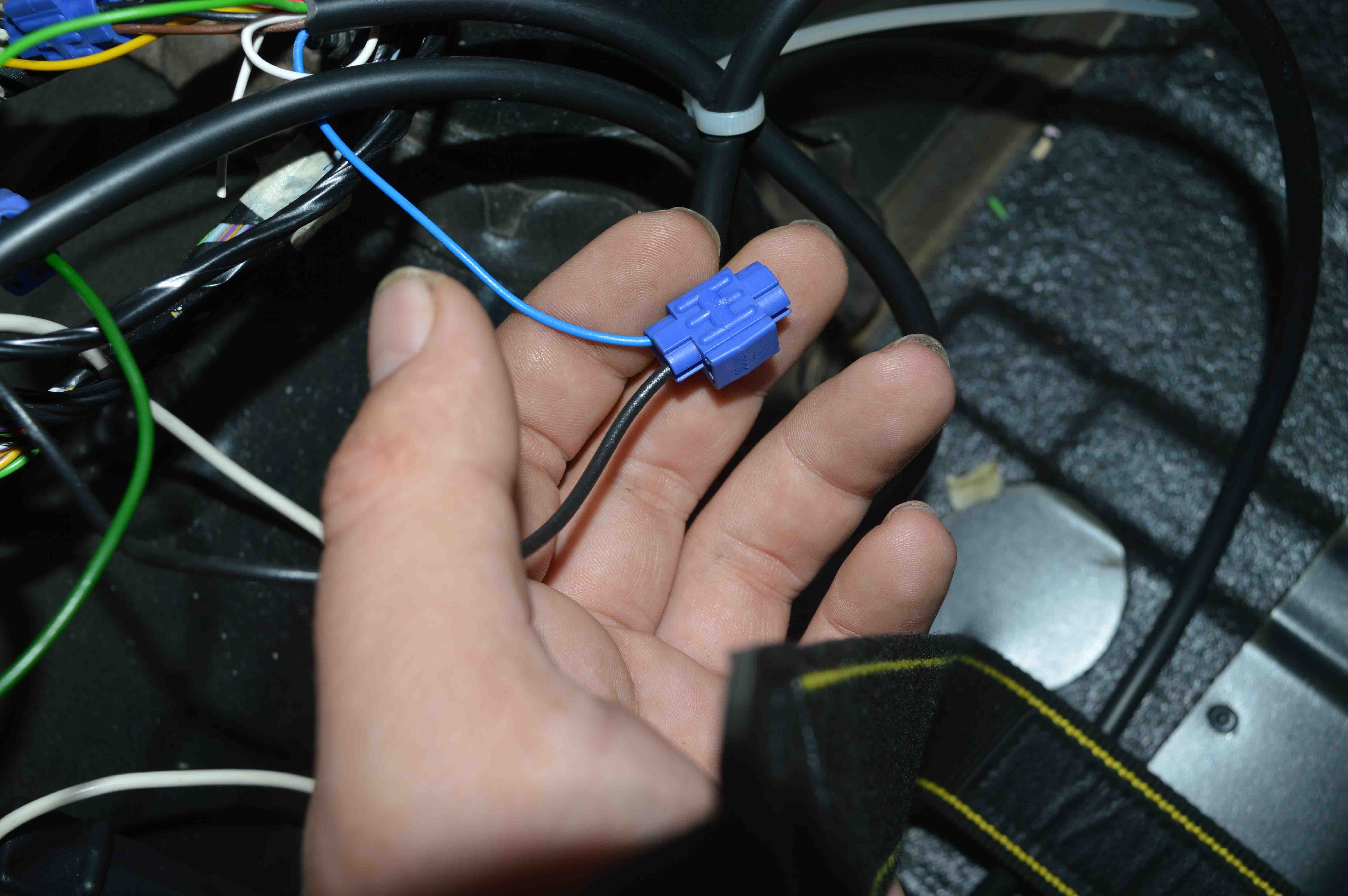

Then there is a plug which comes out the module and these are tapped into the rear lights.
the Green goes off to the drivers side rear fog light it's tapped into the Blue wire
The Blue wire is tapped into a yellow wire above the rear fuse board
The rest are tapped into wire here

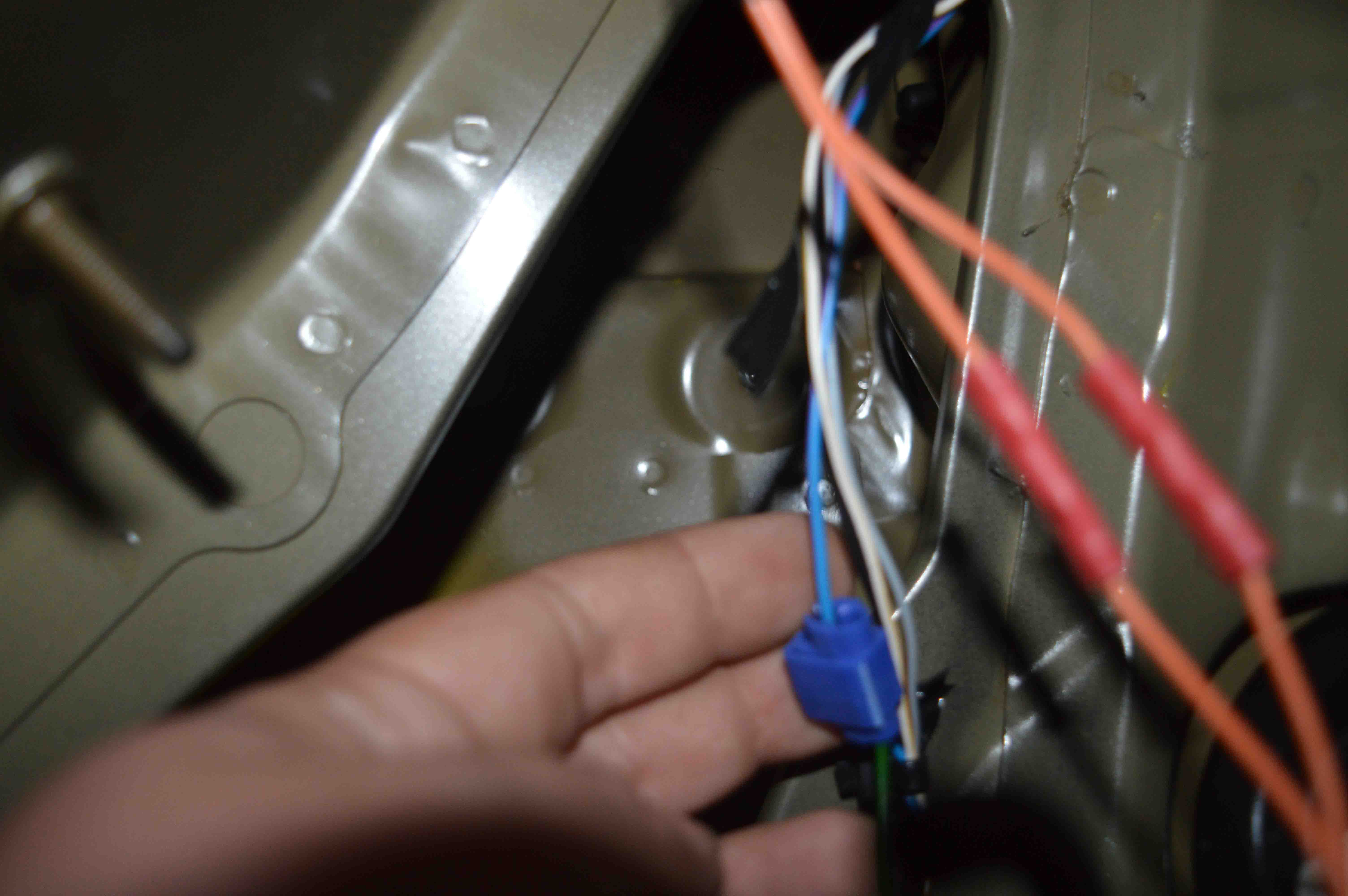

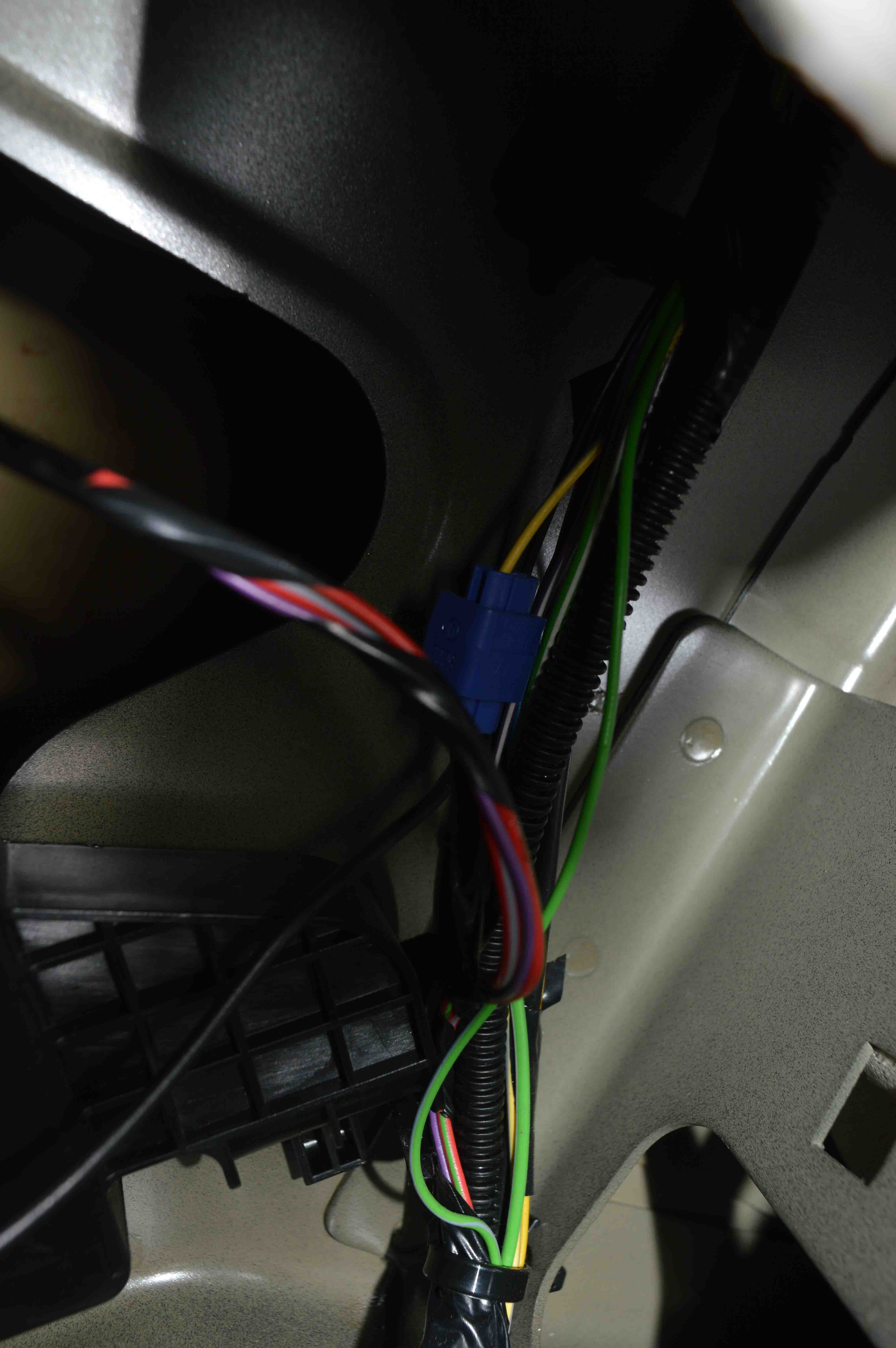

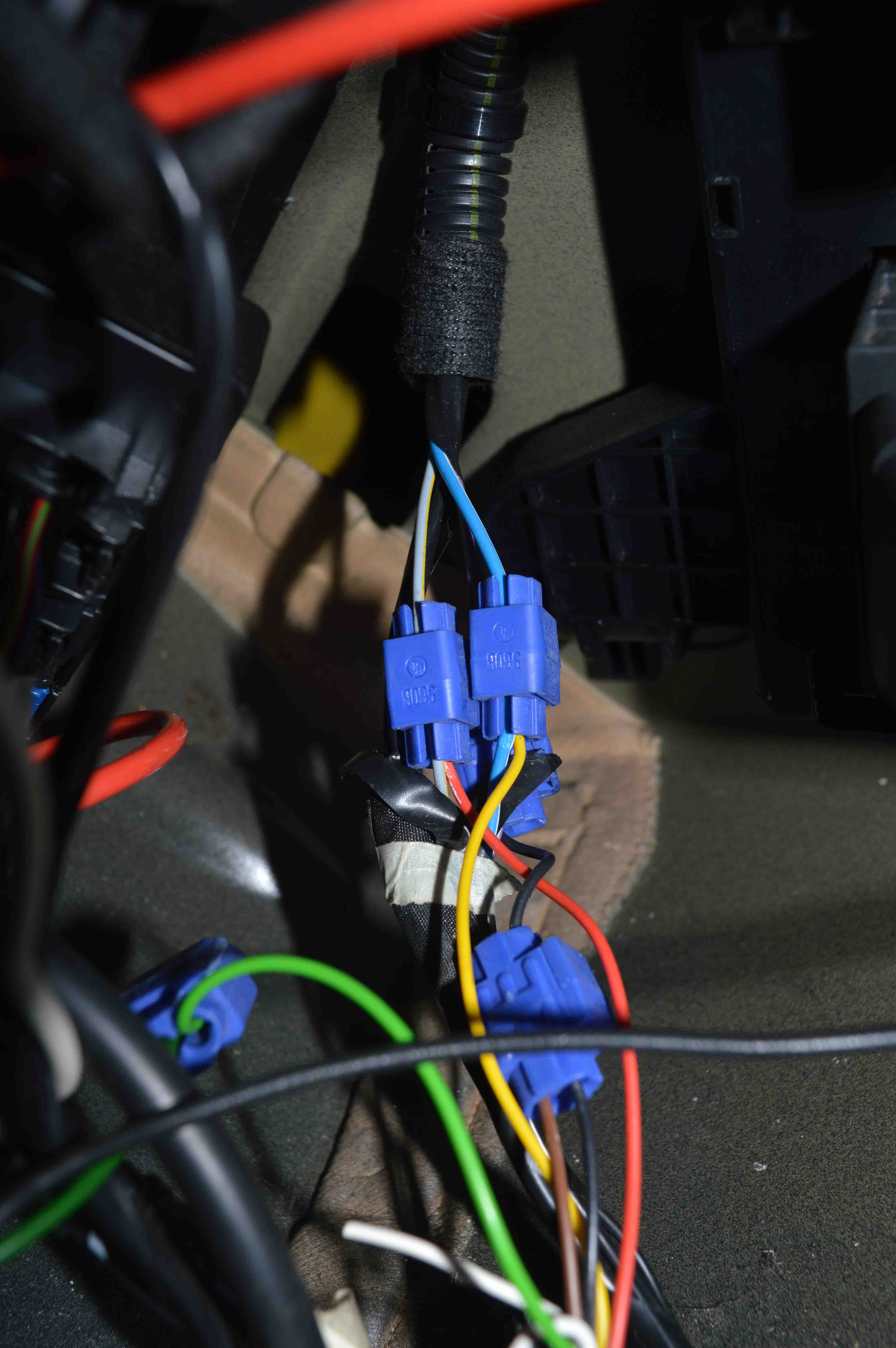

In my above post I got the wire wrong please disregard the GREEN GOING TO FOG IT DOESN'T.
Wiring.
From module to car wiring.
Green runs to drivers side taps into Blue wire = RH Indicator
Blue taps into Yellow/Grey above the fuse board = Fog Light
Red taps into Grey/Yellow below fuse board = brake light
Yellow taps into Blue/White below fuse board = LH Indicator
Brown & Black Join and taps into Purple/Grey below fuse board = Side lights
White taps into reverse light but I don't have that connected.

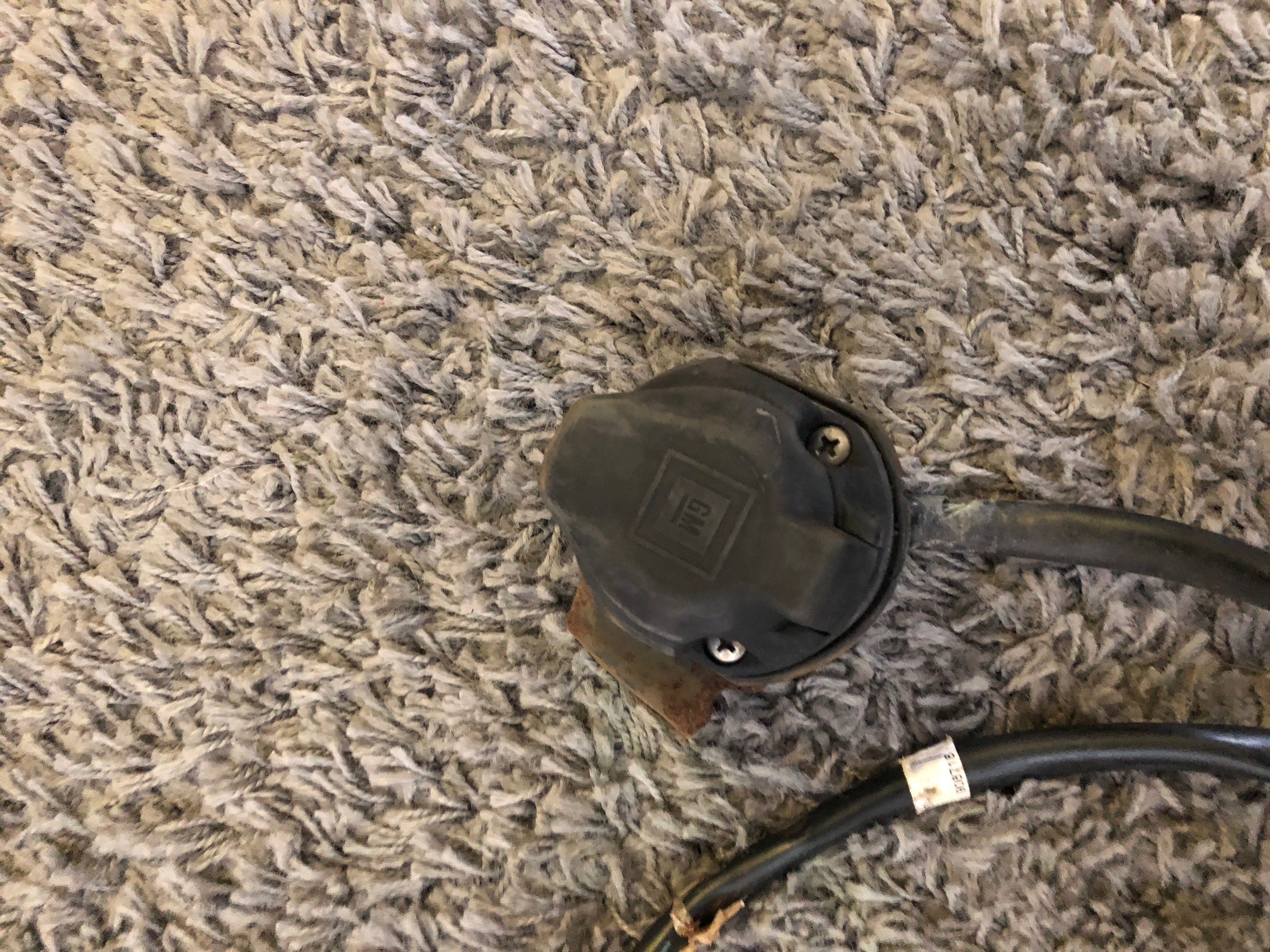

I've just picked up what appears to be factory fitted towbar & electrics.
I'm pretty handy with rewiring the car but i can seem to find any reference guides online for how to fit the wiring i've had sent with the towbar.
so just looking for some advice on how i either fit what i have
or
am i better going with an aftermarket module like the one further up the thread,
as i say electrics dont bother me so fitting an aftermarket one & splicing into the loom would be fie for me & i'm not going to be towing a lot so having integration with the CANBUS system isn't a must either
Here is the loom i've been sent with the towbar
While that is a factory module it's not a factory loom, it's a kit made by a 3rd party.
So you you would need to contact them.
