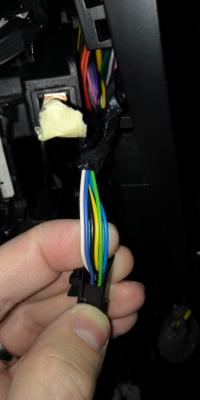

Hello,
is here anyone how knows which cable is signal, plus and negativ for Start/stop system on this ECO button and connector?
Is there any existing diagram please?  Buried
Many thanks !
There is no power wire.
You have ground pin2
Pin7 Auto Stop Start Switch Signal (KL9)
Pin8 Auto Stop Start Indicator Control (KL9)
