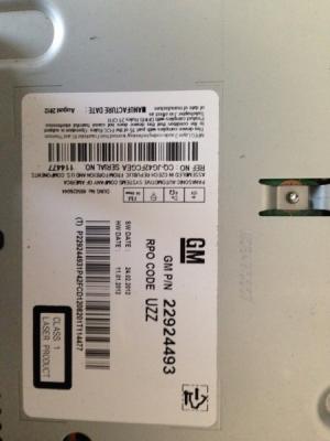

Model year from 2013 (13 plate) that has cd400 will not support
any factory retrofits unless the radio has an ident of - UZZ
if usb is already fitted then the radio will support the aditional
Retrofits provididing the radio again is ident- UZZ

I have a 2014 plate how do I find out what my radio ident is?
pop the radio out and have a look on it mate
RPO need to be as below pic,
[ATTACH]392[/ATTACH]
WhelanUK Wrote:I have a 2014 plate how do I find out what my radio ident is?
If you havent got any factory options like bluetooth,usb,dab then
id say your Cd400 wont support any of them.
