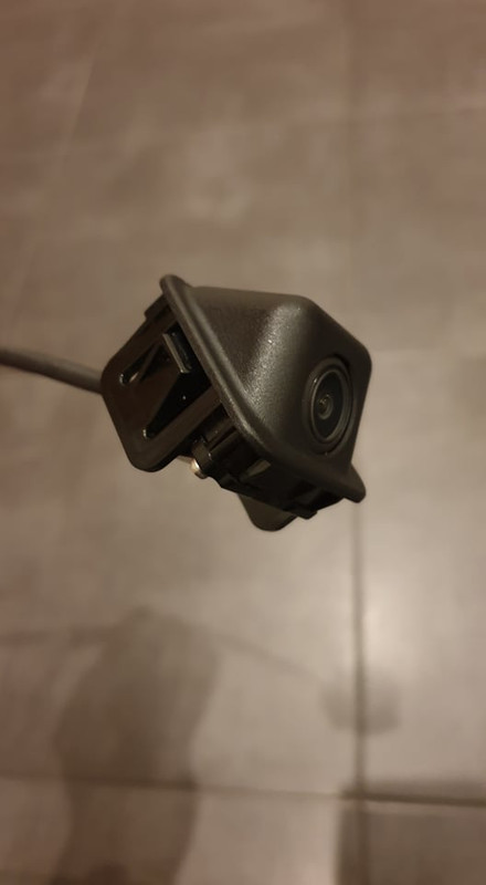

Then I wired the reverse camera in i used a astra k or face-lift insignia interlink rear reverse camera as the picture is just much better
than the older type camera that the astra j uses i did try that one and the picture was pants near black and white picture not the best
and also on the plus side i can centre mount the astra k / face-lift insignia camera on the insignia rear bumper for the factory look.

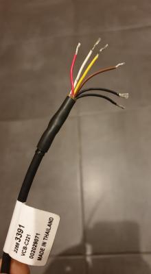

Hello! I have a question about 2015 Insignia Hatchback with all factory INTELLILINK RF900 Navi, rear parking sensors and rear view camera but missing rear bumper and harness. I`m trying to wire the following OEM camera:
https://i.postimg.cc/Fzr9qKym/83766011-6...4704-n.jpg
https://i.postimg.cc/fWCWdxsb/83802194-8...0096-n.jpg

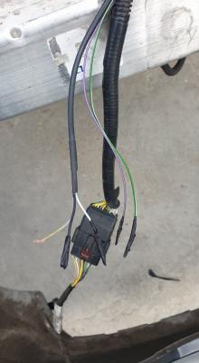

And there is the body harness:
https://i.postimg.cc/rFzTt3gh/83855005-9...3936-n.jpg
So, i wire it as following:
1. Red from camera to violet-green
2. The two black wires have short connection in the camera and i wire it to the green-white (it shows ground)
3. Yellow from the camera to yellow-gray
4. White from the camera to white-blue
5. Brown from camera is empty on its circuit board so not connected anywhere
On ignition when i put reverse gear it switches to show the rear view but no picture available.
Some opinions if i do something wrong?

Yellow Cam sig 2+
White Cam sig 2
Black heat shrink Cam Drain
Black Ground
Red Run Crank
Brown Rev lights

(3:rd-Feb-2020, 07:40:15)Rusty2009 Wrote: Yellow Cam sig 2+
White Cam sig 2
Black Ground
Red Run Crank
Brown Rev lights
Rusty, how do you tell the difference between the two black wires or do they both go to earth?  which camera signal goes to pin 5 and  pin 15?
What loom are you using?

I am using the insignia camera with a navi600, the navi600 was installed by Andy at vxmods. I am going to make up my own harness from the camera to the radio.
Drain is run with the video signal wires and runs all the way to the radio (it's then bent back over the sheave and heat-shrunk.
Yellow goes 5 white goes 15.
Cheers Rusty,
Does it matter which black is used for earth and the drain as they both look the same coming from the camera?
The camera I have has the grey plug on it if that is any help.
(20:th-Aug-2020, 06:26:51)MarkAP68 Wrote: Cheers Rusty,
Yes it does drain goes down cable with the video signal wires.

so i finally gathered everything for oem retrofit, i just need to connect it now. i have navi950 and this camera - gm 13412487 https://www.ebay.com/itm/134565271306
can you help with wire colors, which is which?
there is red, pink, blue, green, black, white
i was looking into this doc since its the same connector https://vxoc.org.uk/forum/attachment.php?aid=789
but those are different wire colors and looks like a different arrangement
They are different because the camera side is not listed.
You need to match up the info from the document you linked to to the camera.
ooh i see it now, thats the "male" side in the doc, so if i just follow by numbers it will match up. thanks Rusty!
