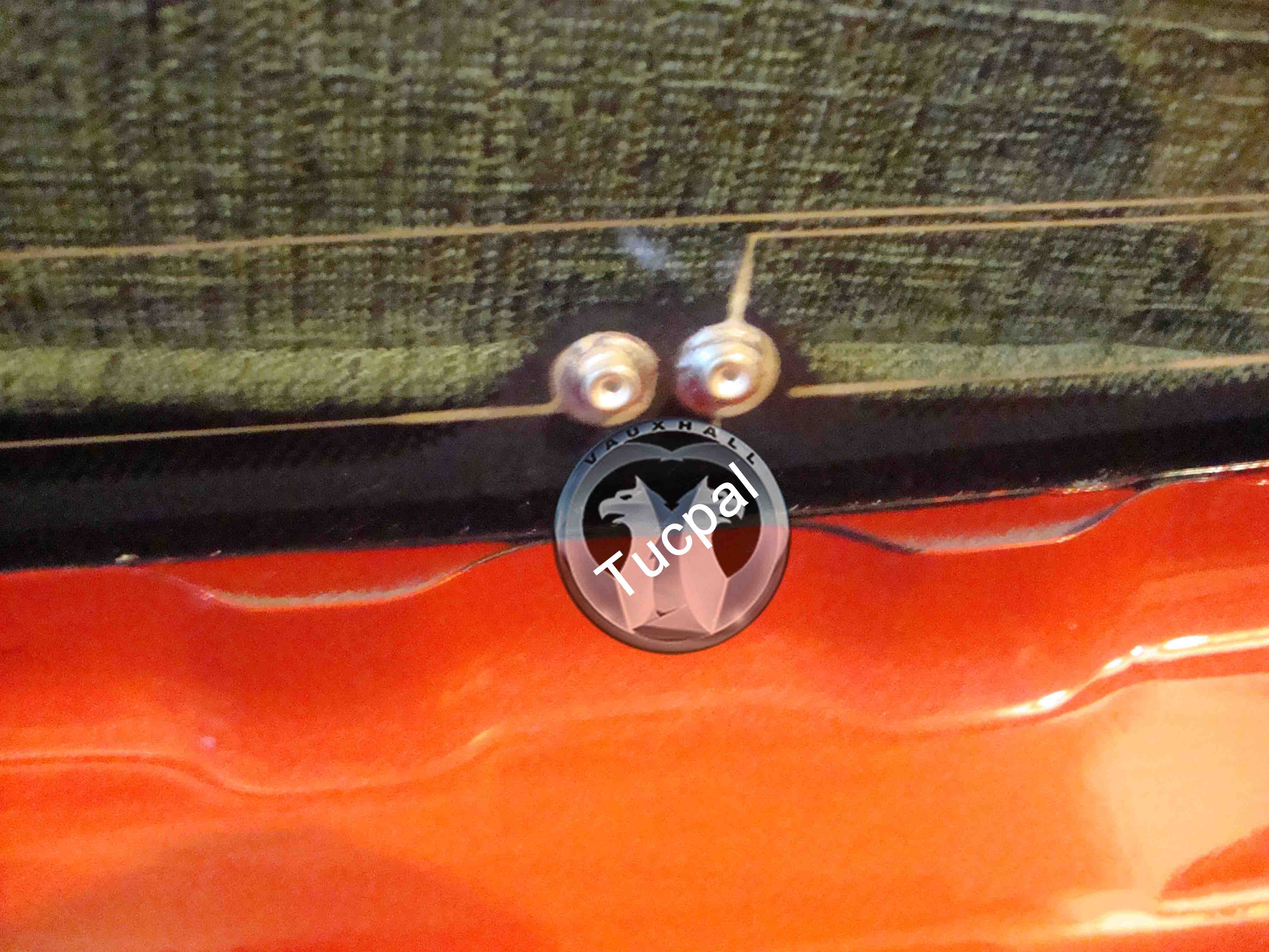

These are the Tabs you will need on the New Glass for the FM and DAB Receivers.

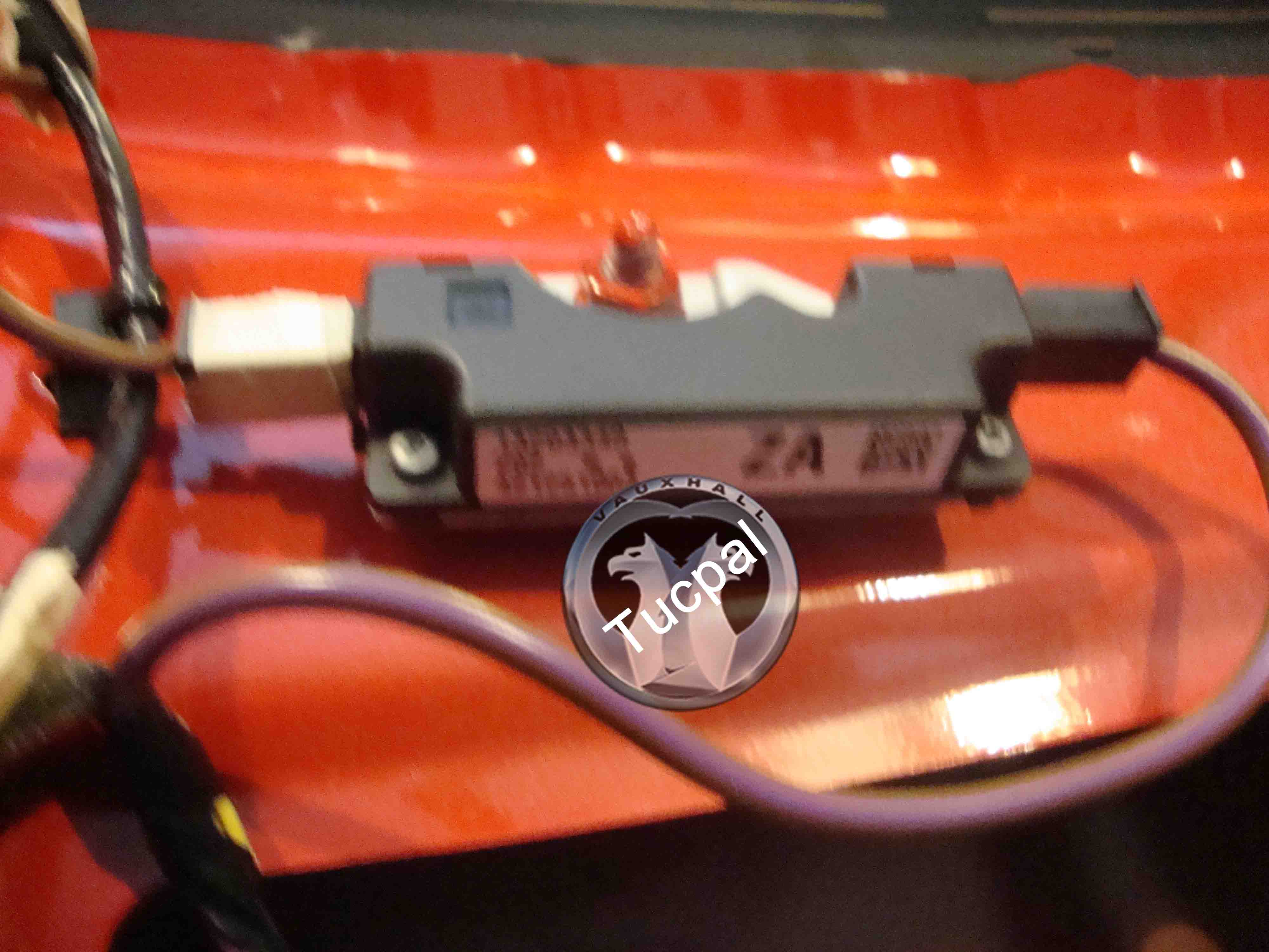

This is the (FM Suppressor ZA) and Connects up in between the Heater Matrix.

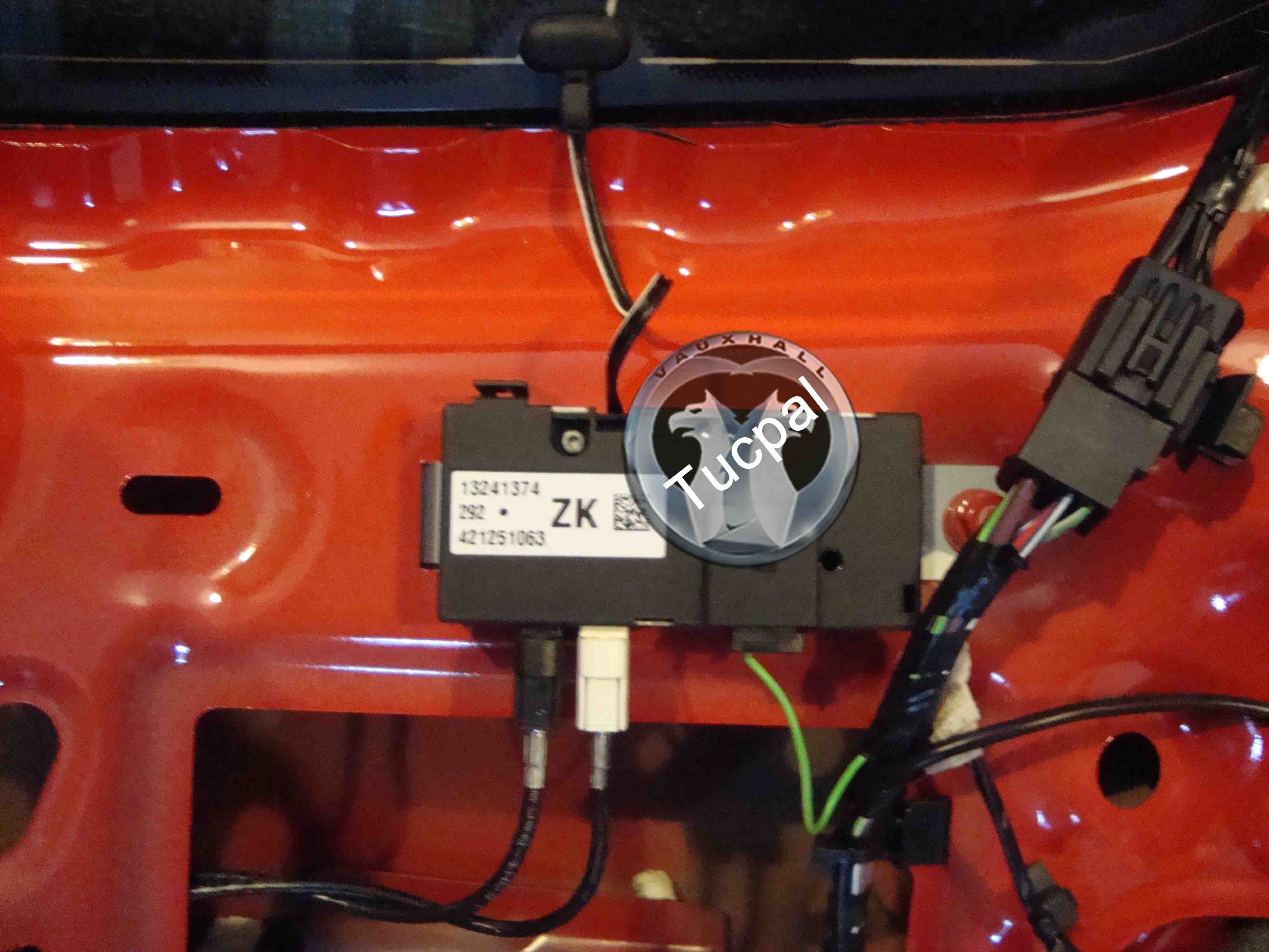

This is the (FM Module ZK) the Black Fakra Z Cable 1 meter
And goes to the (FM Receiver MA) at the Top of the Glass
The white Fakra z Cable 2 meters will go too the
Existing Female End of the FM Ariel Cable in the roof
that you unplug from the old Roof Mast Ariel.

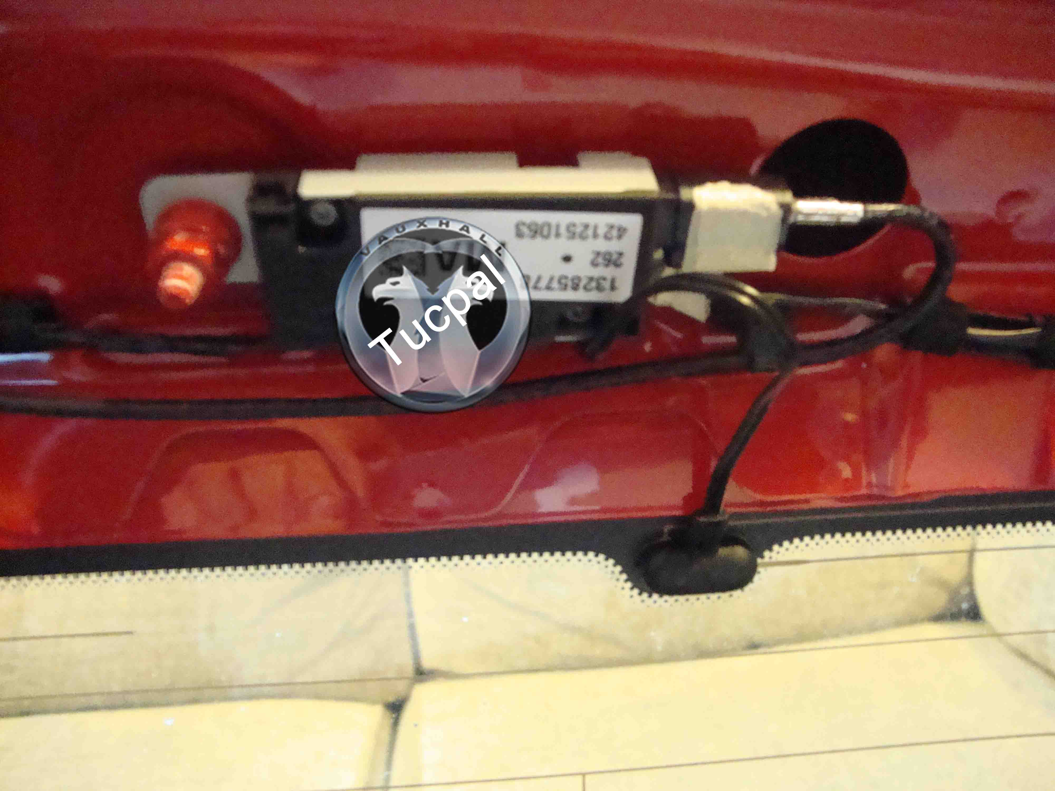

This is the (FM Rreceiver MA).
STEP SIX.........

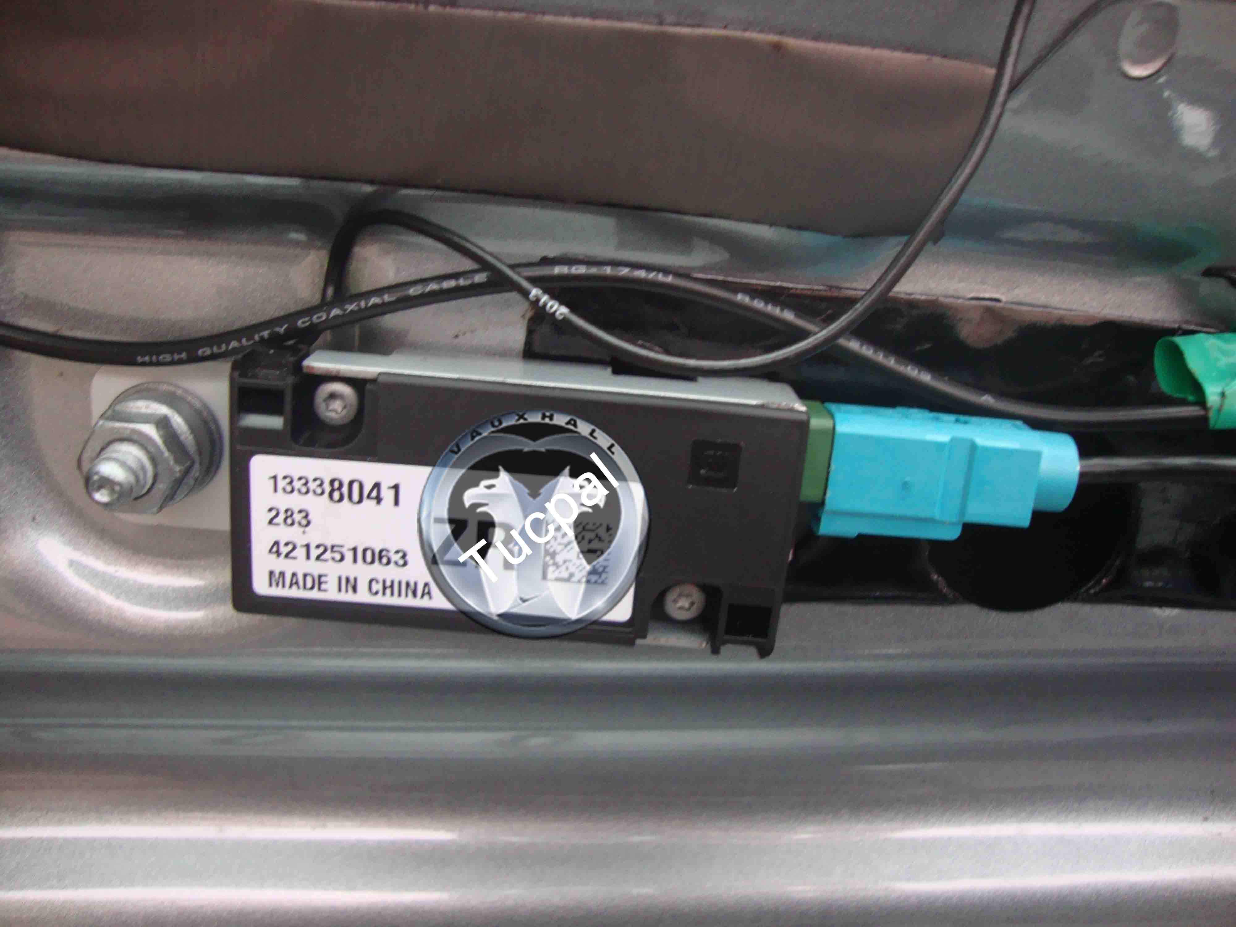

This is the (DAB Receiver ZR)
A 5 meter fakra z Cable Female to Female
will run from here to the front Module.

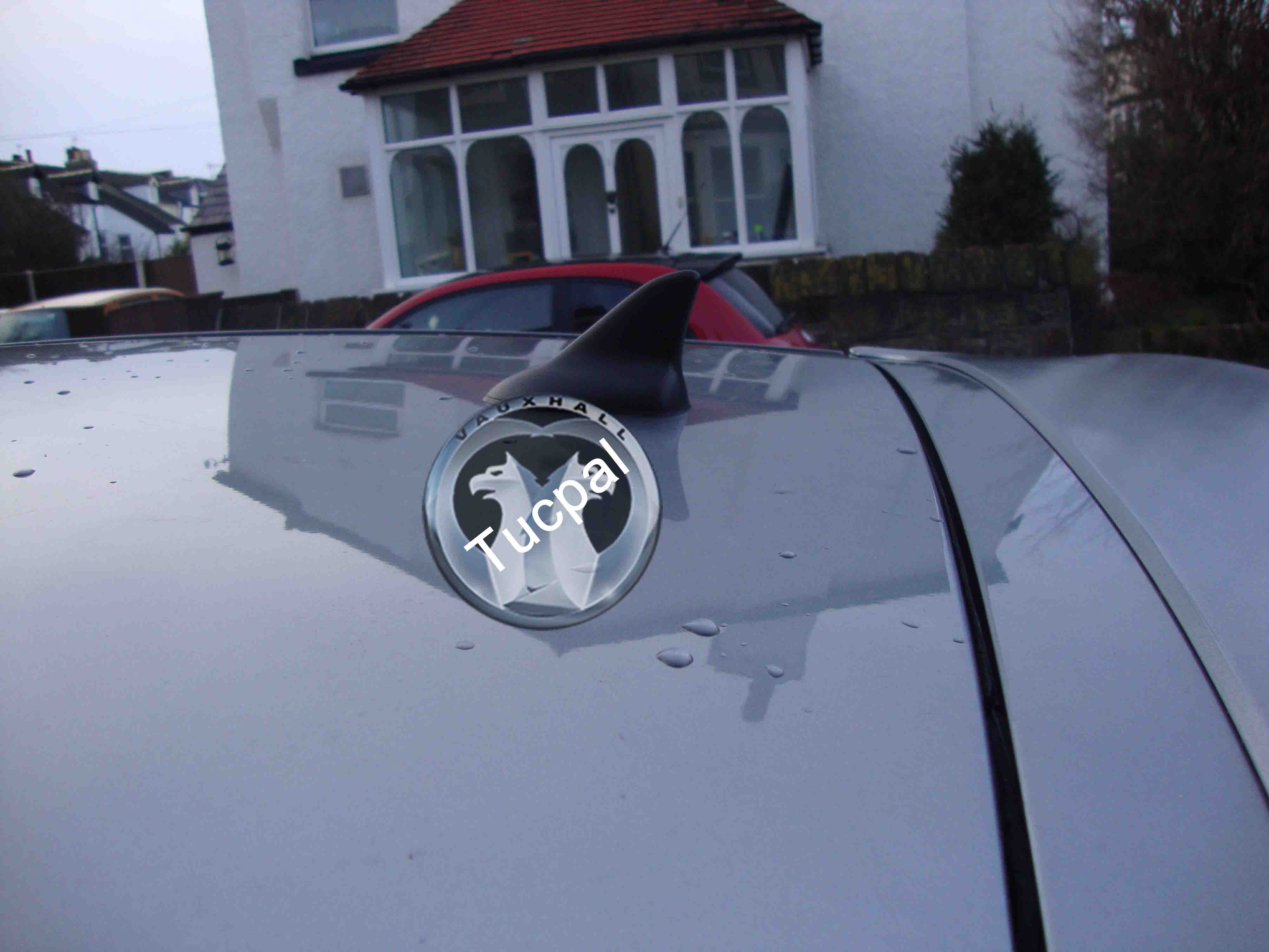

You can now Remove the old Roof Rast Ariel
And Throw it away as this now has no use
the FM will now work from the Rear Glass
so you can now put the Shark Fin on top
this has no Function apart from Looking Good.

Or the (ZA receiver) on the Rear Glass

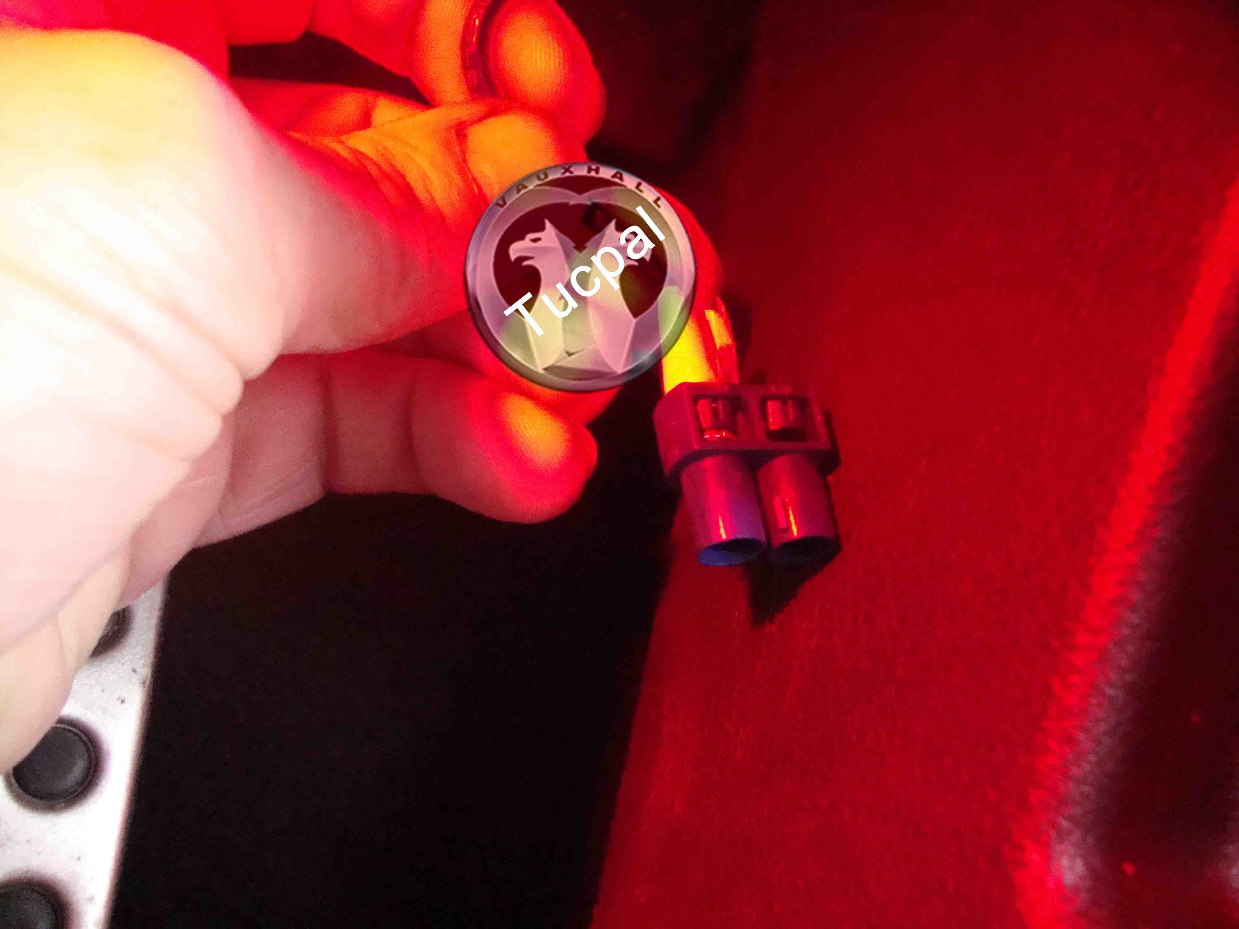

you will Find a Blue Male Double fakra Connector.
One side will go to the DAB Module and one side is Blank
Join the Double Female End to the Double Male.

You will find the Green Connector and the Black Connector
just above the Accelerator Peddle
Connect both too the Module
the Module is held in Place by a Bracket and one Screw
Your are now Ready for Programming and VCI codes.

first do you have all the tabs in place on the rear glass
and also check to see if the FM Ariel on the roof is attached to a cable

I have the two tabs on the rear
[ATTACH=CONFIG]44[/ATTACH]
[ATTACH=CONFIG]43[/ATTACH]
However it would appear my FM signal is coming from the Ariel on the roof.
Quickly unscrewing this proved it
looking at that you have the bottom FM receiver there
so now you are going to have to remove the trim
and see what is behind there
you may just be missing the top receiver and a farkra cable
if that is that case it will be very cheep for you do to this
you may be missing the receiver marked MA.

How easy is it to switch to a shark fin?
I've found a non functional one on eBay.
Just want it for looks really but want to be able to swap it back if I sell it down the line.
Also thinking of painting the Ariel same colour as the car before fitting.

3 minutes max disconnect the farkra cable remove 1 10mm bolt from Ariel base and that's it

Has anyone else looked near their pedals for the black and green connectors and not found them? If so what can I do?
Every car I've come across has them.
I have head of one that did not but most do have them
Right I have had my car in bits today lads in an effort to find these cables!
http://i.imgur.com/Keba5b4.jpg
http://i.imgur.com/LQs58HT.jpg
Can anyone trace theirs and tell me what direction they go? Perhaps mine have slipped behind somewhere over the years?
If not what are my options here, is it possible to buy the cable as a part#? Or am I looking at after market unit setup?
If its the latter, I;m going to have a DAB unit and bracket for sale shortly.... :(
it looks like you dont have the two connectors needed the are taped up behind the accelerator pedal
one green and one black the cable runs to the bonnet catch
got a pic for you but not the best
if they are not there you can not do it as they go to the back of the cd400
but if you ask andy from vx mods he will be able to make a loom for sure
let him know i sent you and i will tell him what you need
by the way what year and model is your car as you are the second i know of now
who have not had them there but they are there on nearly all cars
The wires can be added.
