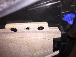

Okay looking to start attempt 2 tomorrow! ha. problem is that one of the plastic things that holds one of the blue clips is snapped (was like that when i got them) so not sure if this will cause problems...I've managed to glue it back on a bit but its not very strong.
Also does this look damaged? Not sure if there should be such a big gap or if it should be flush with the other piece like in the second photo:

#55
Should be flush mate
#56
bond it back together from the inside with silicone and glue it should hold

The guy is such an idiot thay he even removed the screws for the handle trim too!
[ATTACH]427[/ATTACH]
Also are we sure that this should sit flush even when not installed? Just that when I make it go flush, this piece of plastic looks like it's bending:
[ATTACH]428[/ATTACH]
[ATTACH]429[/ATTACH]
#61
yep it should be flush can i see the back

Not sure what you wanted to see so I took a load lol. There was some weird cloth/cotton wool behind the panels that covered the whole thing, sort of like a sheet of it. I pulled it off though as it was loose anyway and wasn't on my other door cards

The weird thing is that when I make it go flush, these bits if plastic seem to move away from where they should be:

I'm thinking now that it's supposed to be like that when it's not attached to the car and that when attached to the car, the blue clip on the other side of the panel will pull this bit towards the car and get rid of that gap...They are both identical in the way that they have that gap and both flex backward removing the gap when i push it toward where the clip would fasten into the car.
By bigger issue is the clip I had to repair with blu tack:

Should be flush at all off or on, I know what they they pulled it there instead of using a trim tool from the bottom

Fair enough, guess you guys know best! just that when I do pull where the rear blue plug is, it pulls that exact section inwards and makes it flush...so I'm thinking installing it on the car will do the same thing. I don't have any glue strong enough to hold it there anyway so I have no other option
#66
thanks sheppy i was looking at the rivets and there ok also you have the top blue clip that will pull that bit in when it is back on the door
so it may well just pull it all back together when it is all fitted back together
as for the snapped clip just get some silicone and let it set over night that will sort that out i have a broken one and this did fix it
i would just wire it up and fit it and see what happens you have it so it is wroth ago
