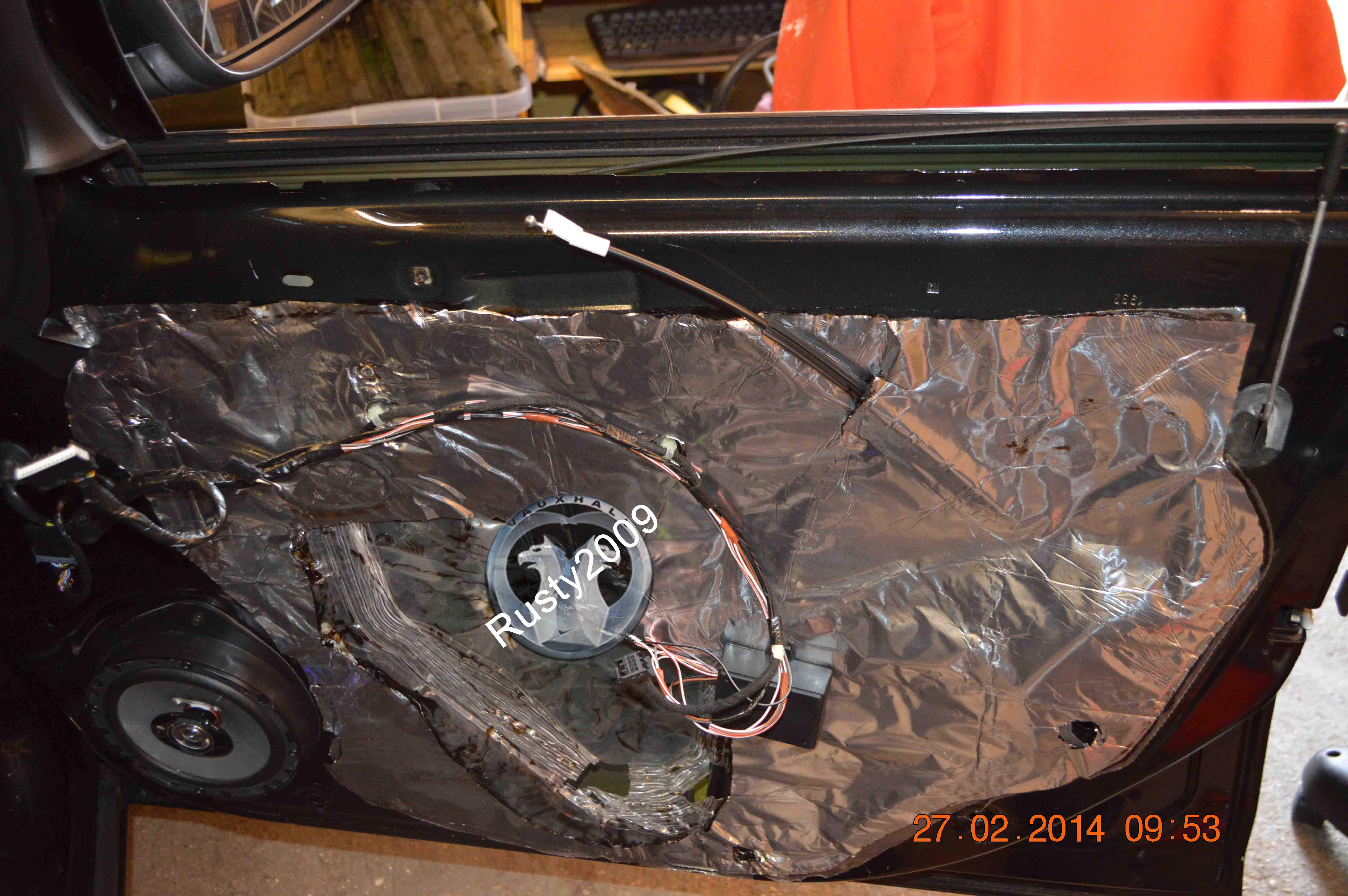

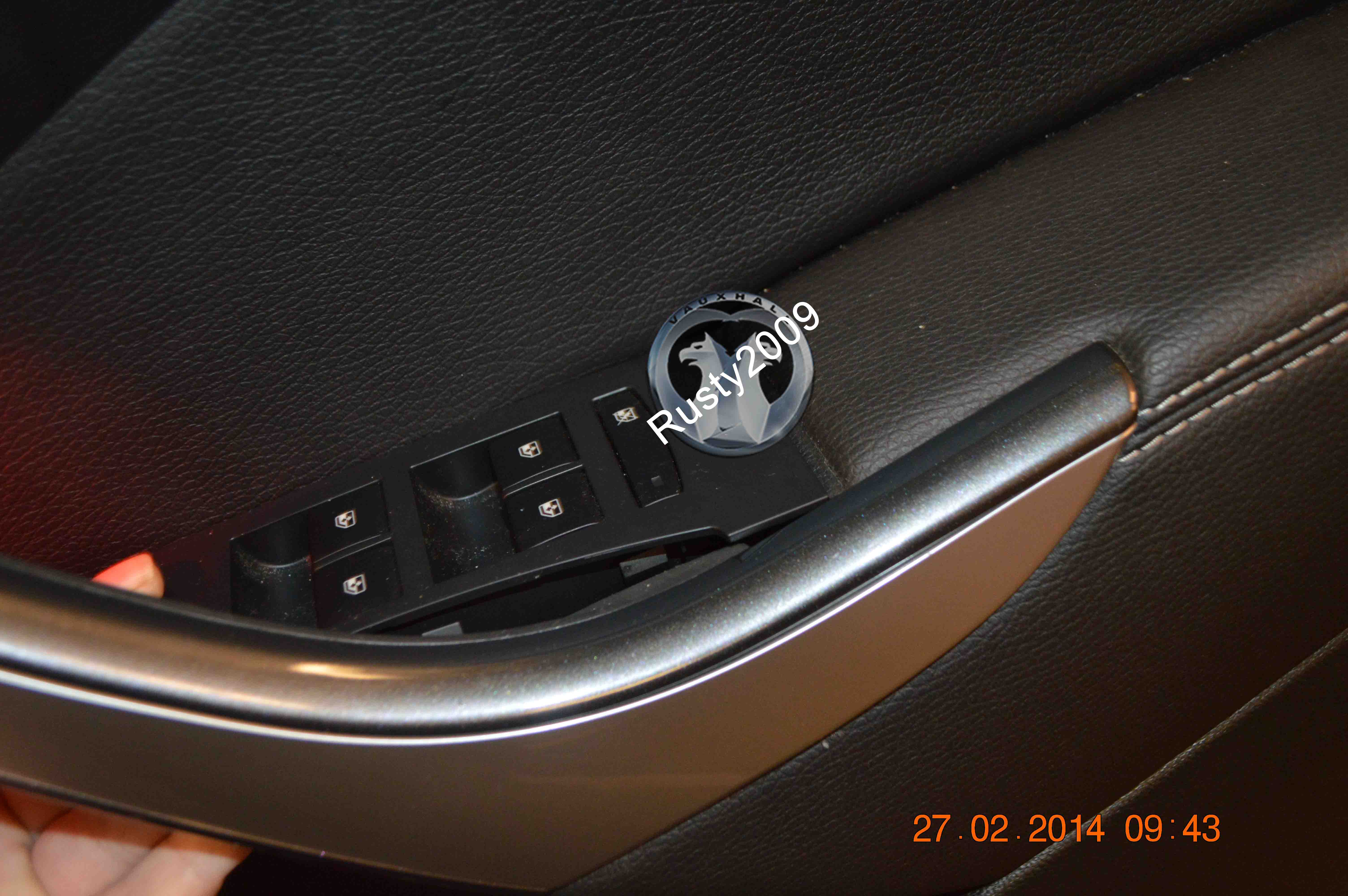

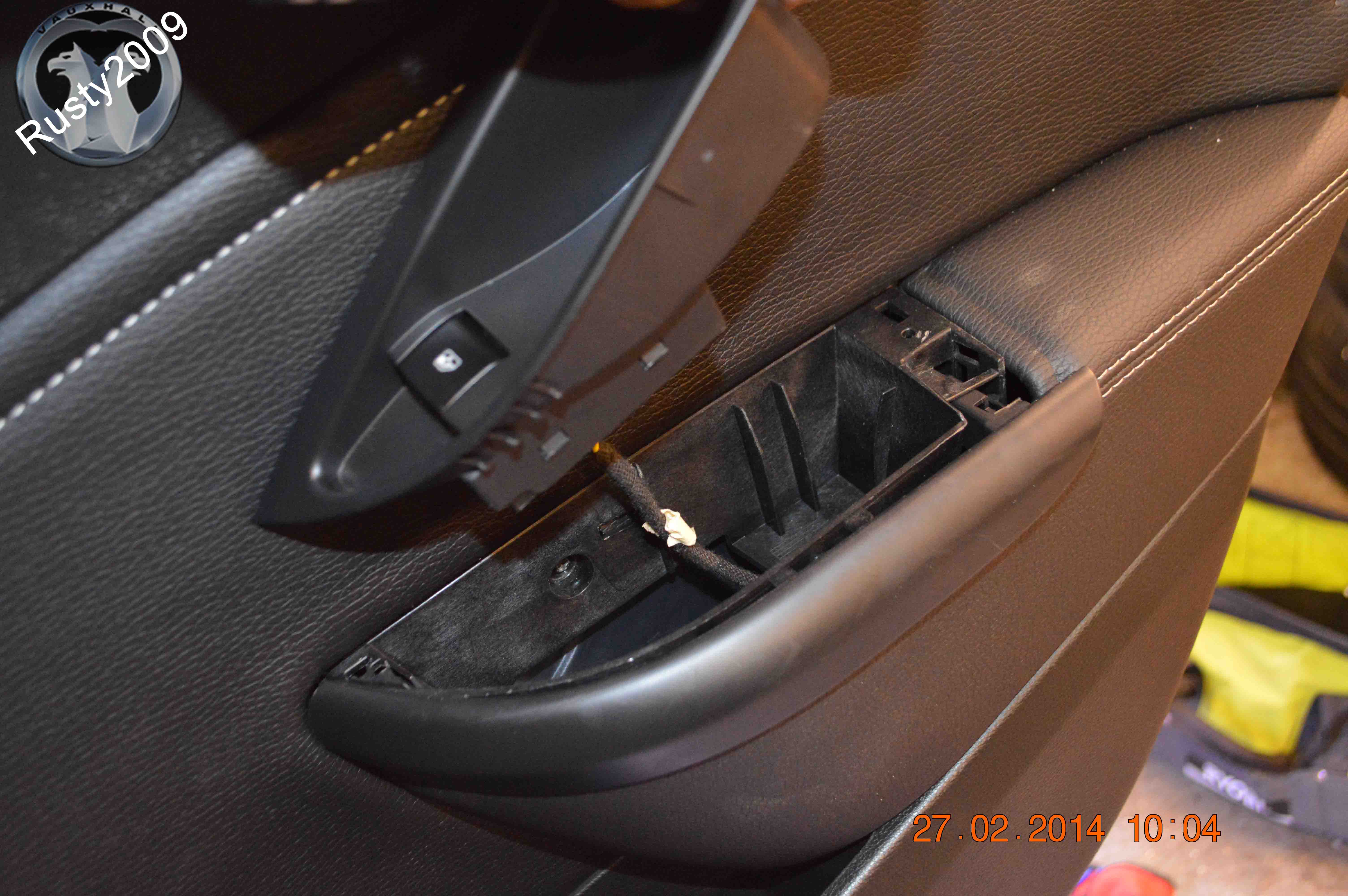

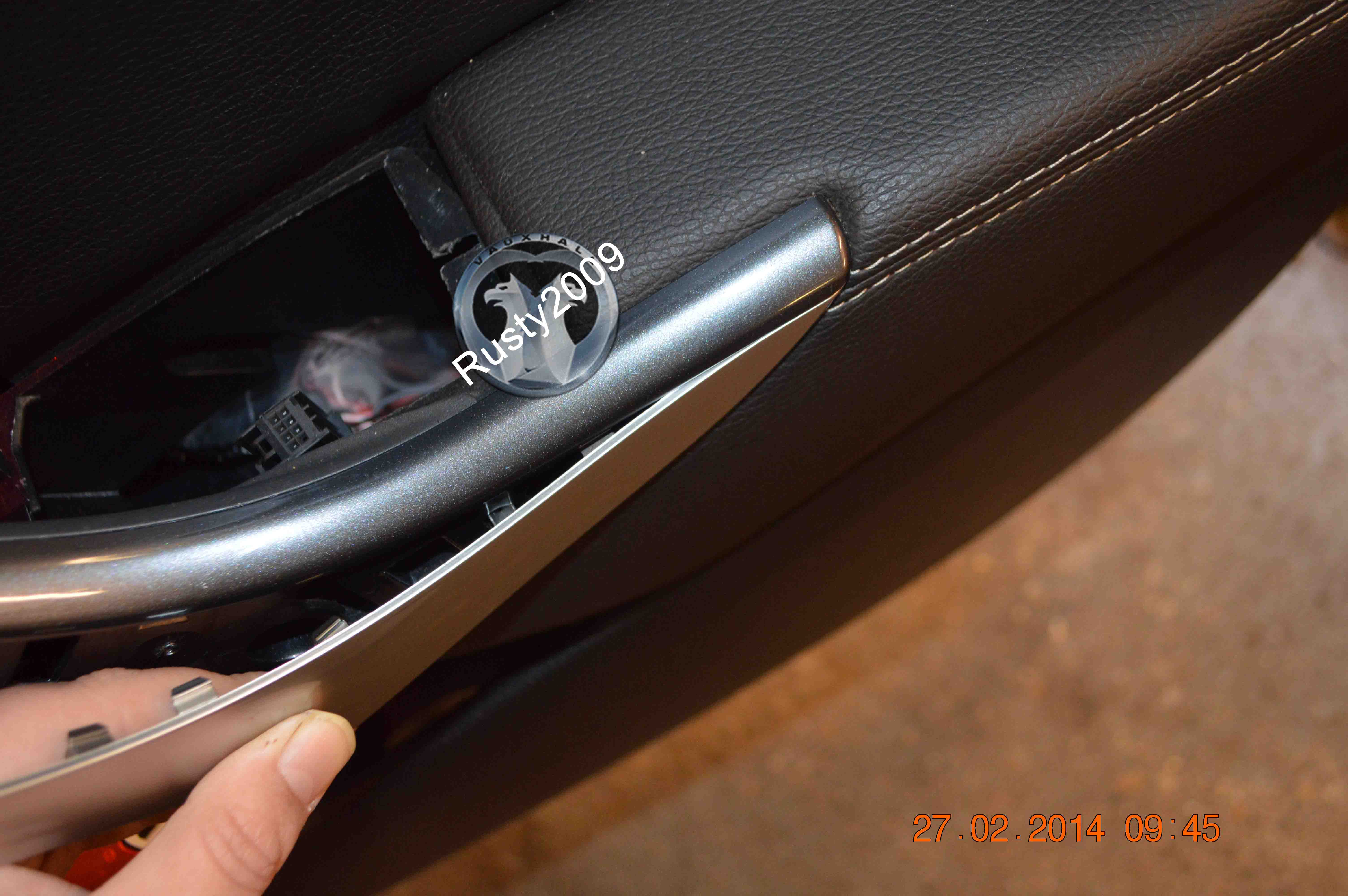

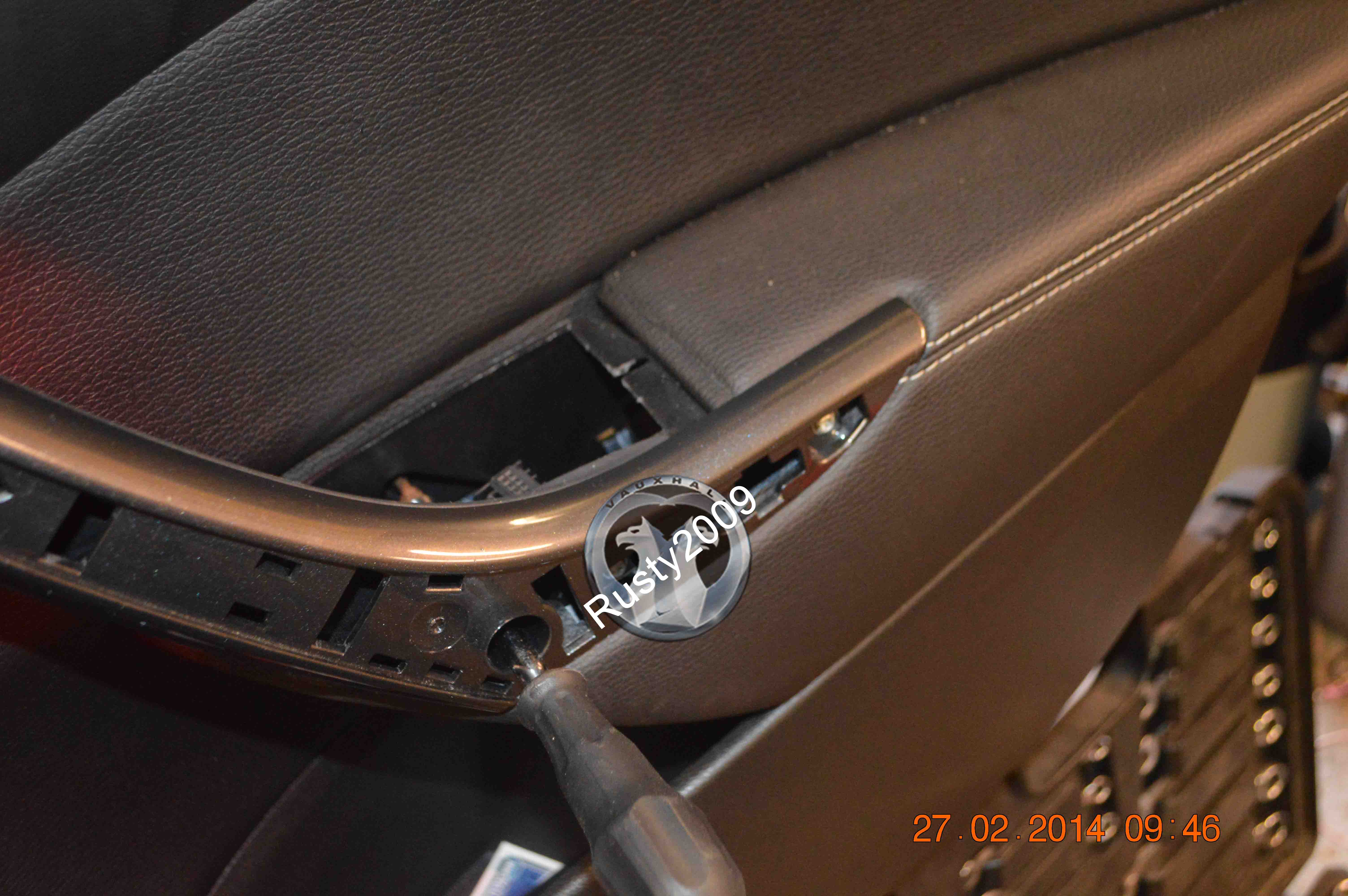

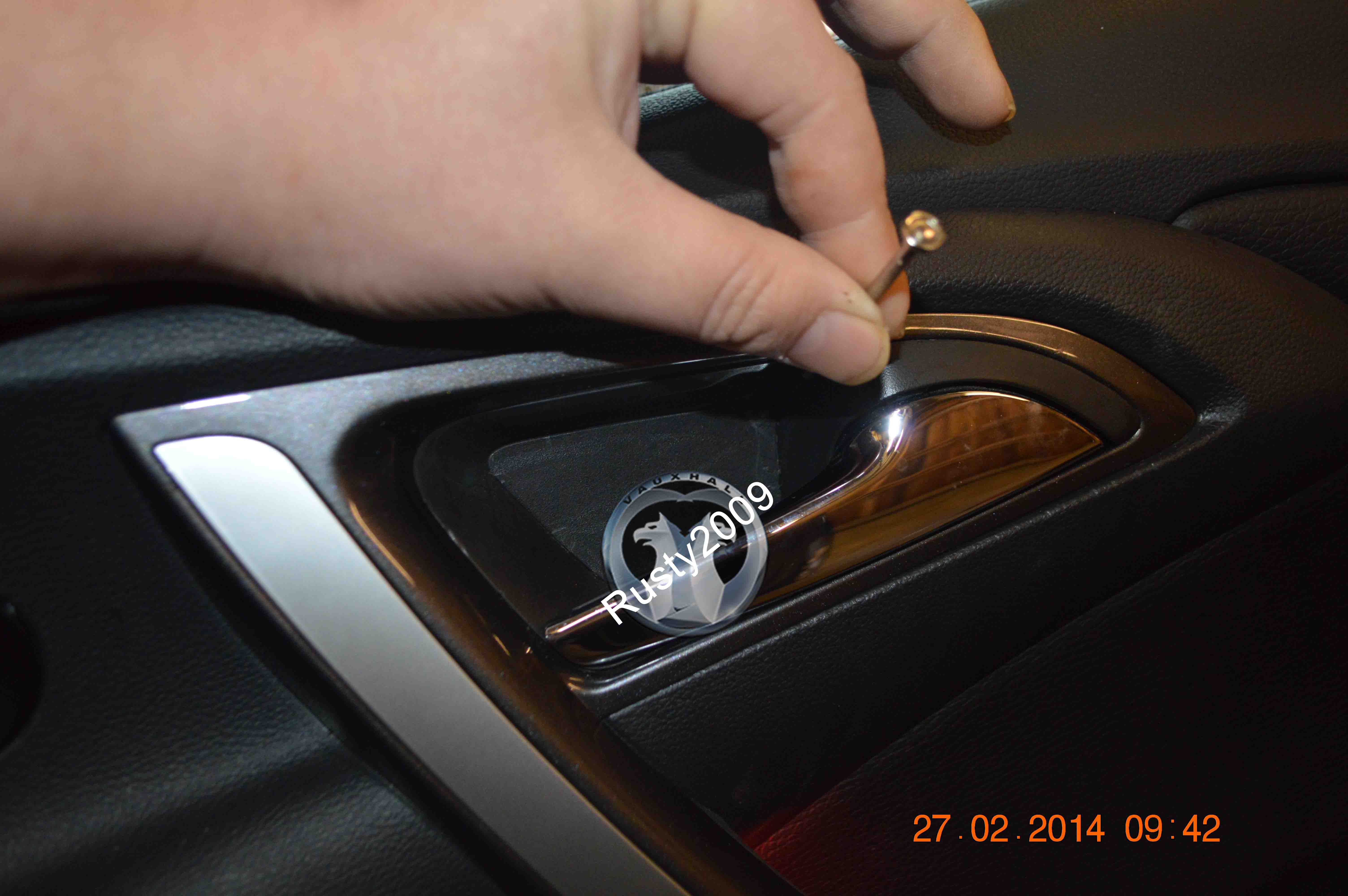

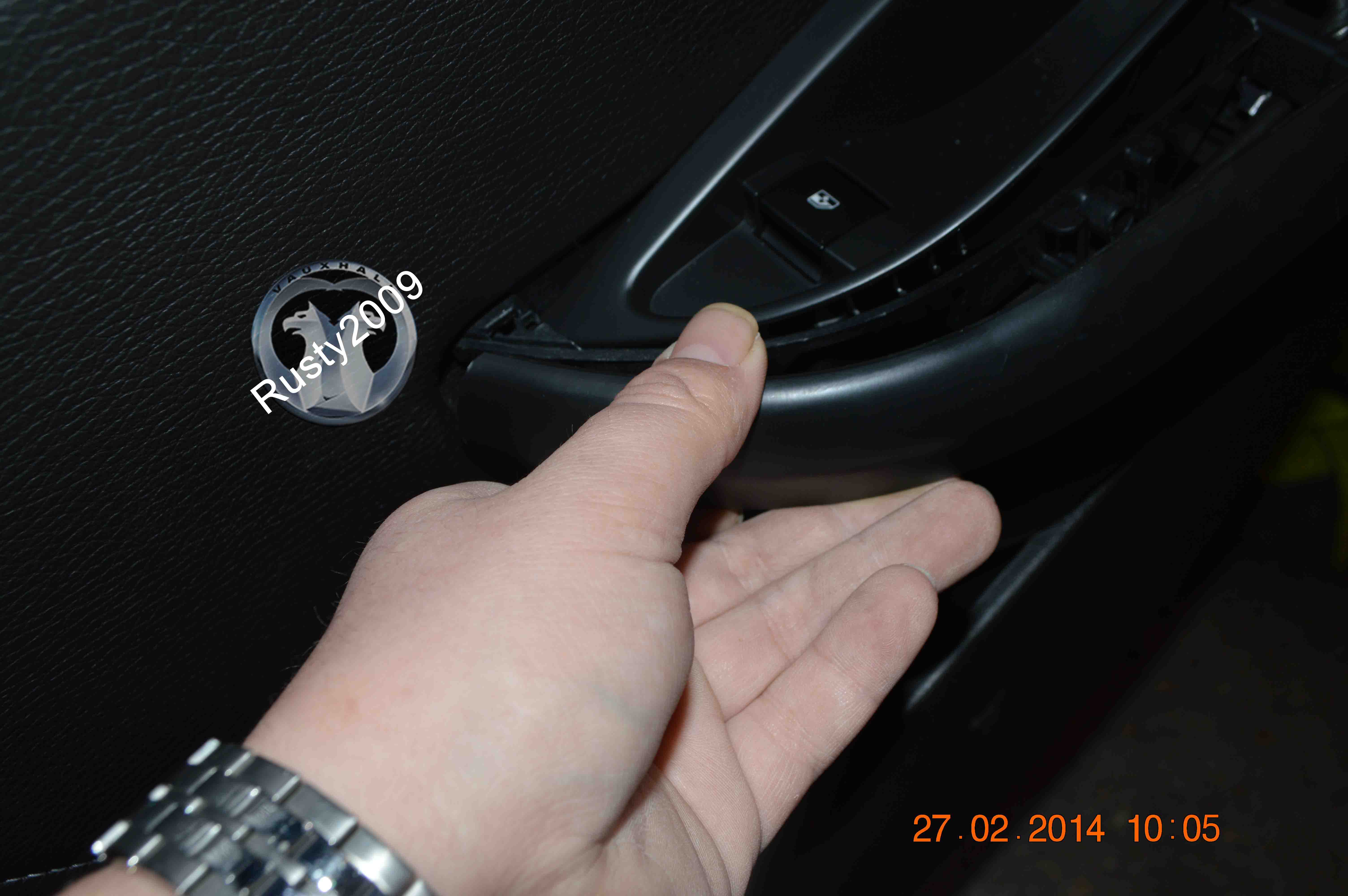

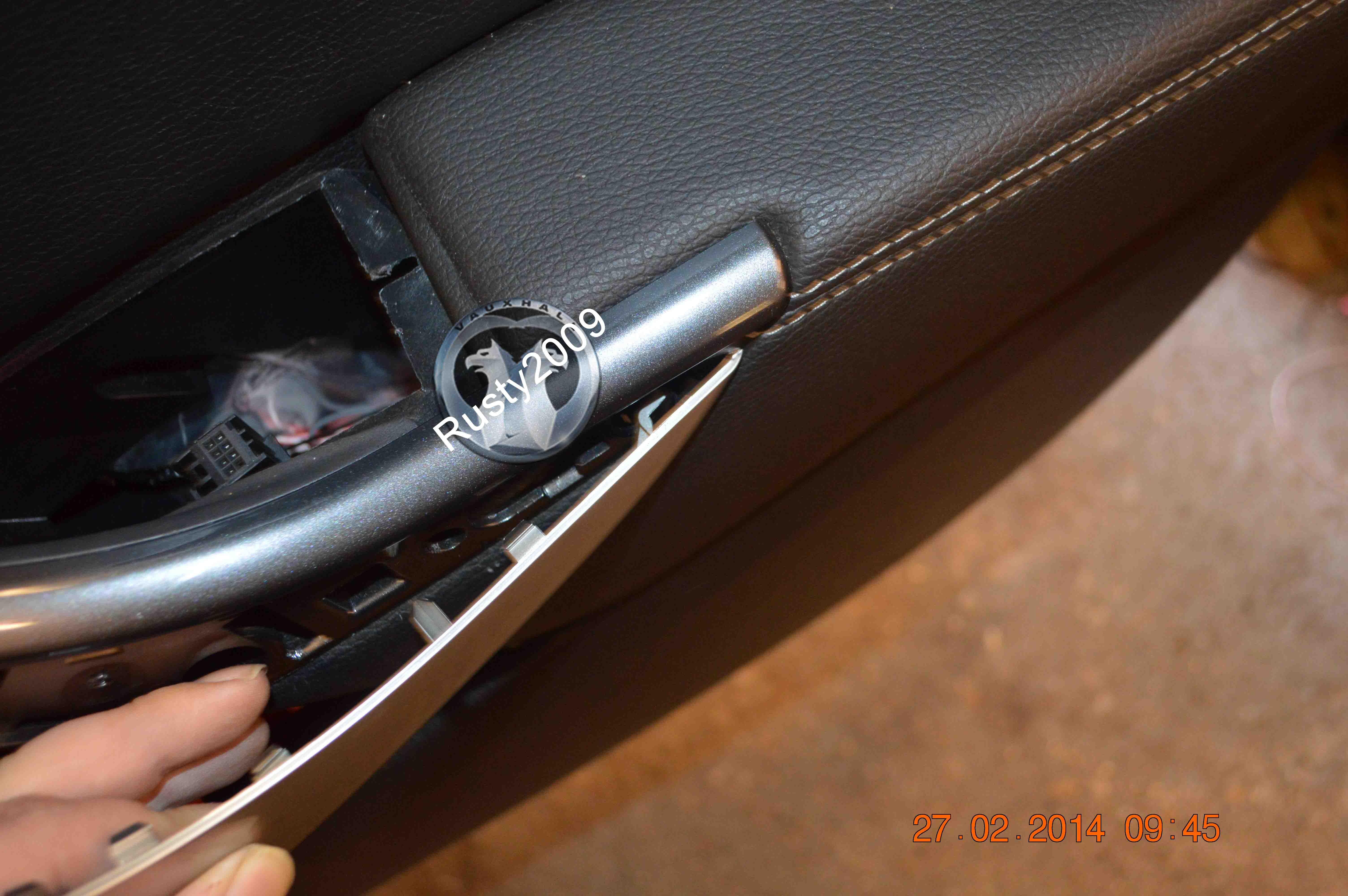

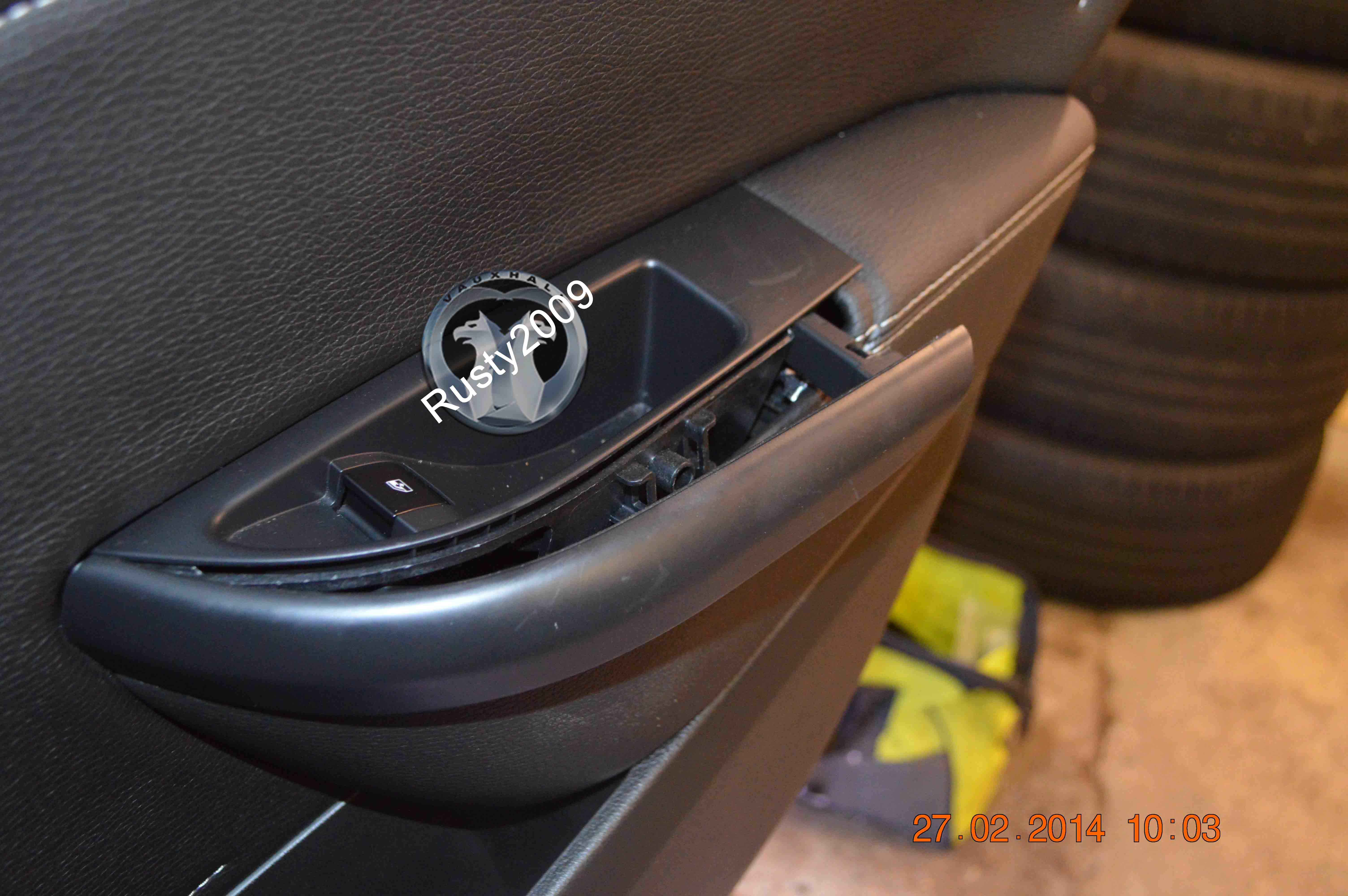

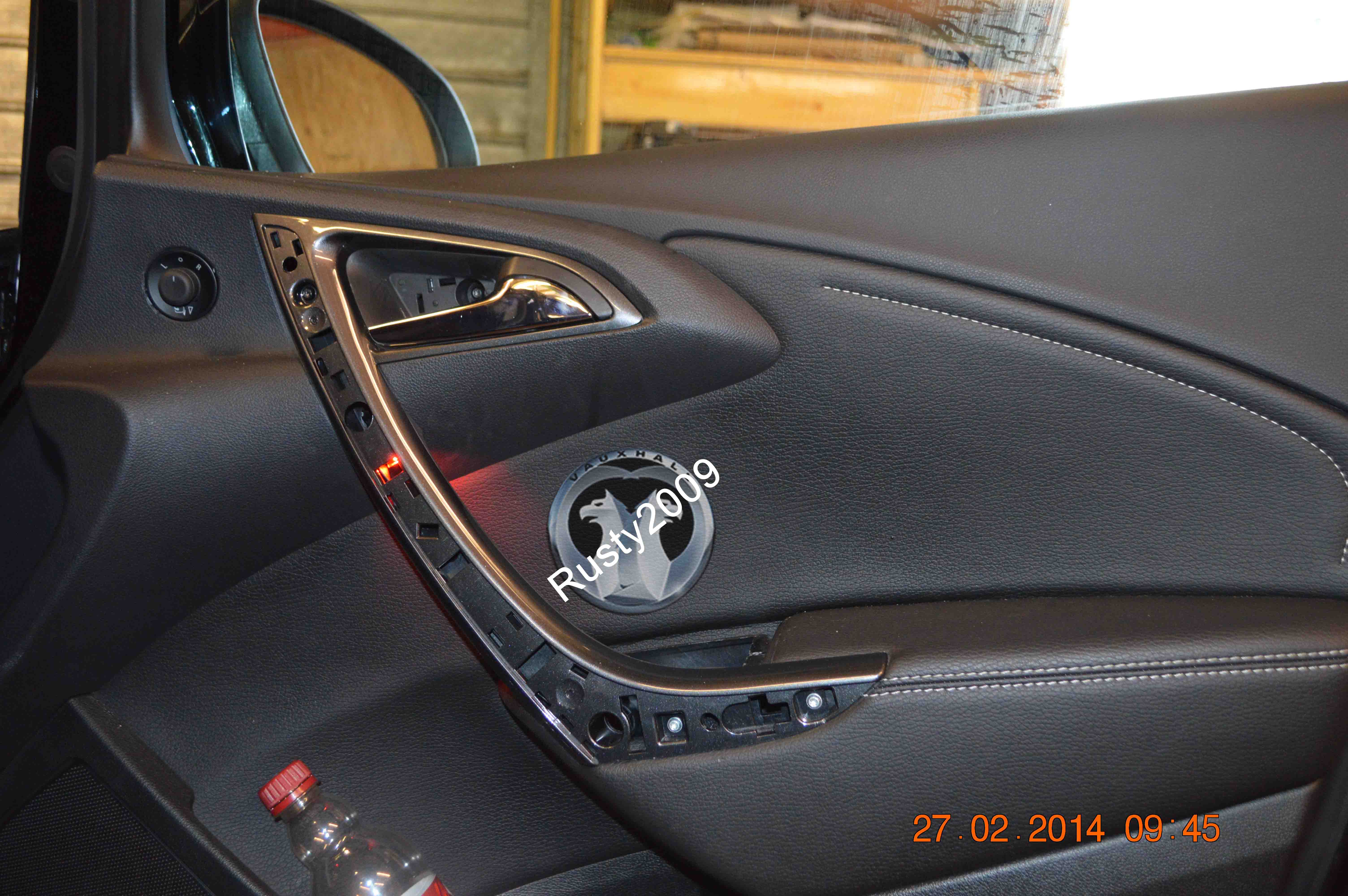

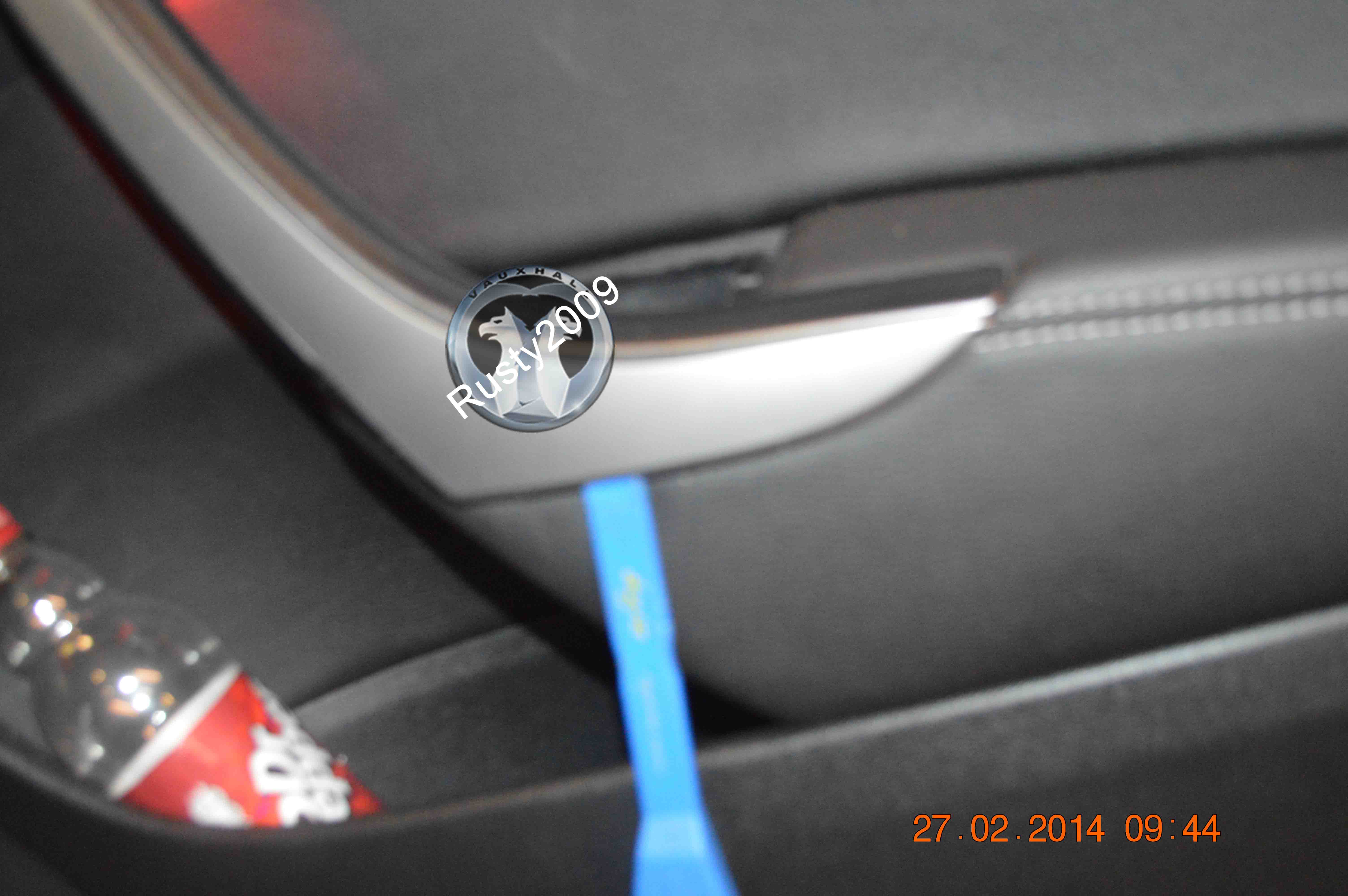

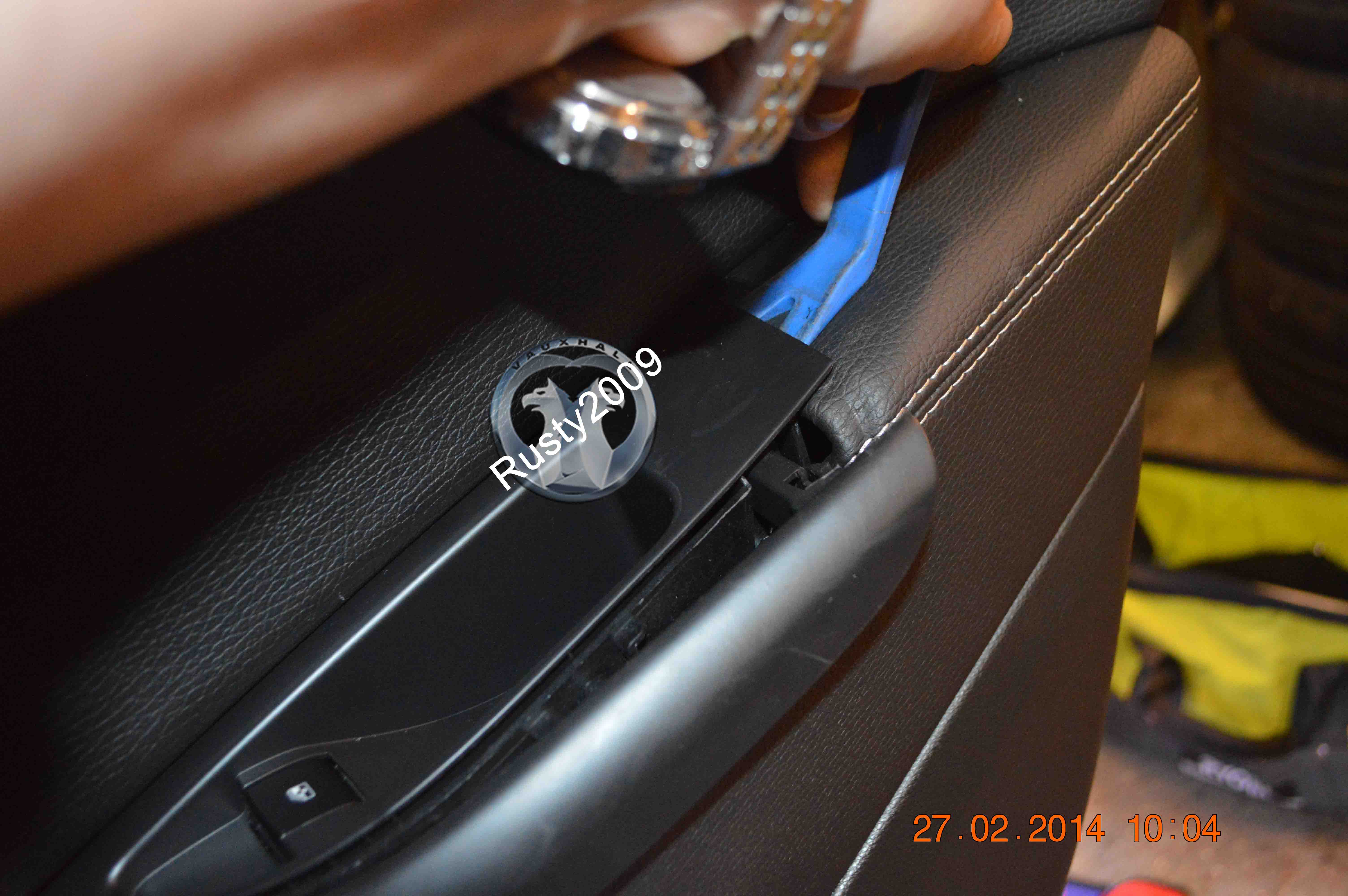

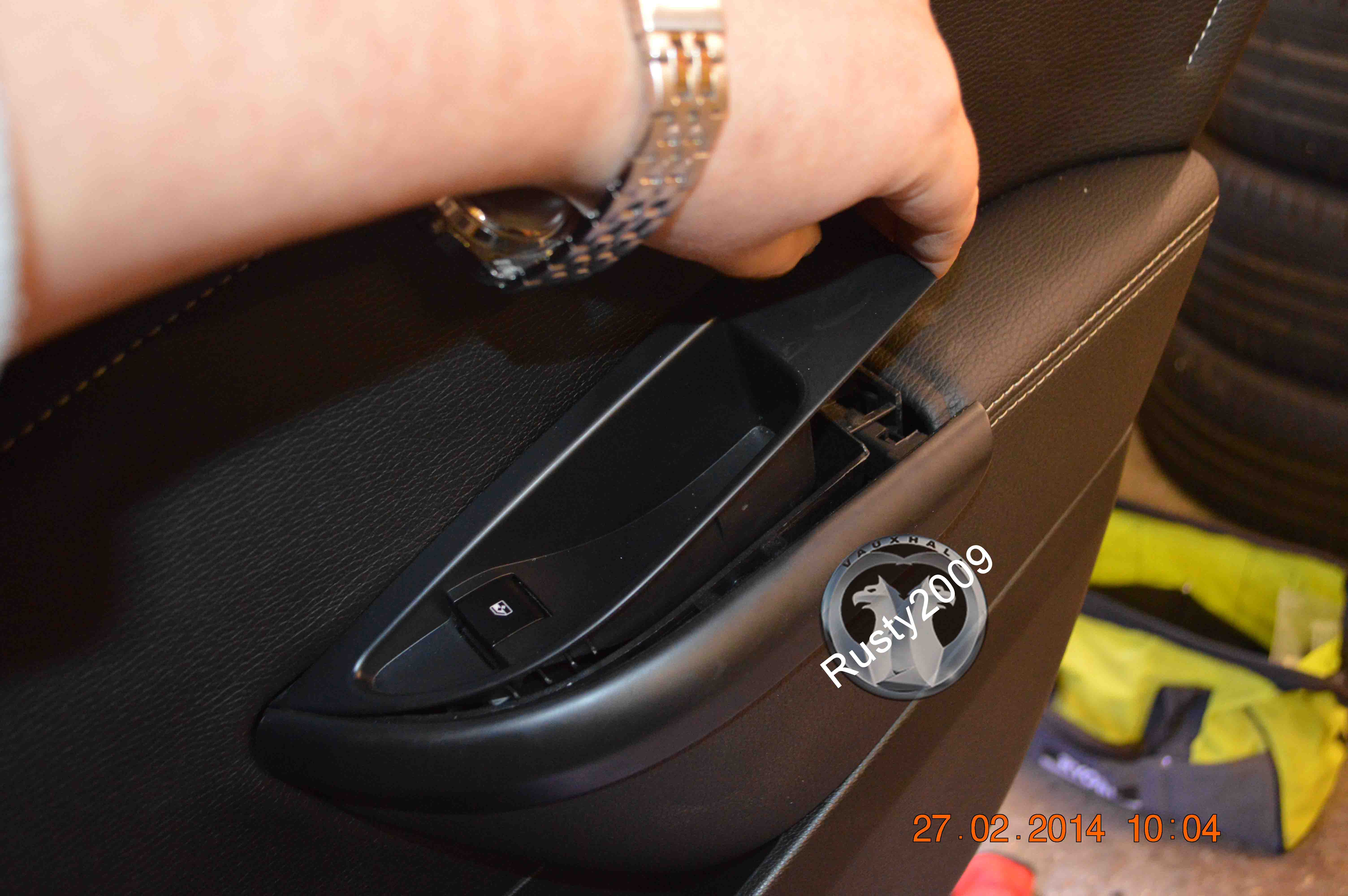

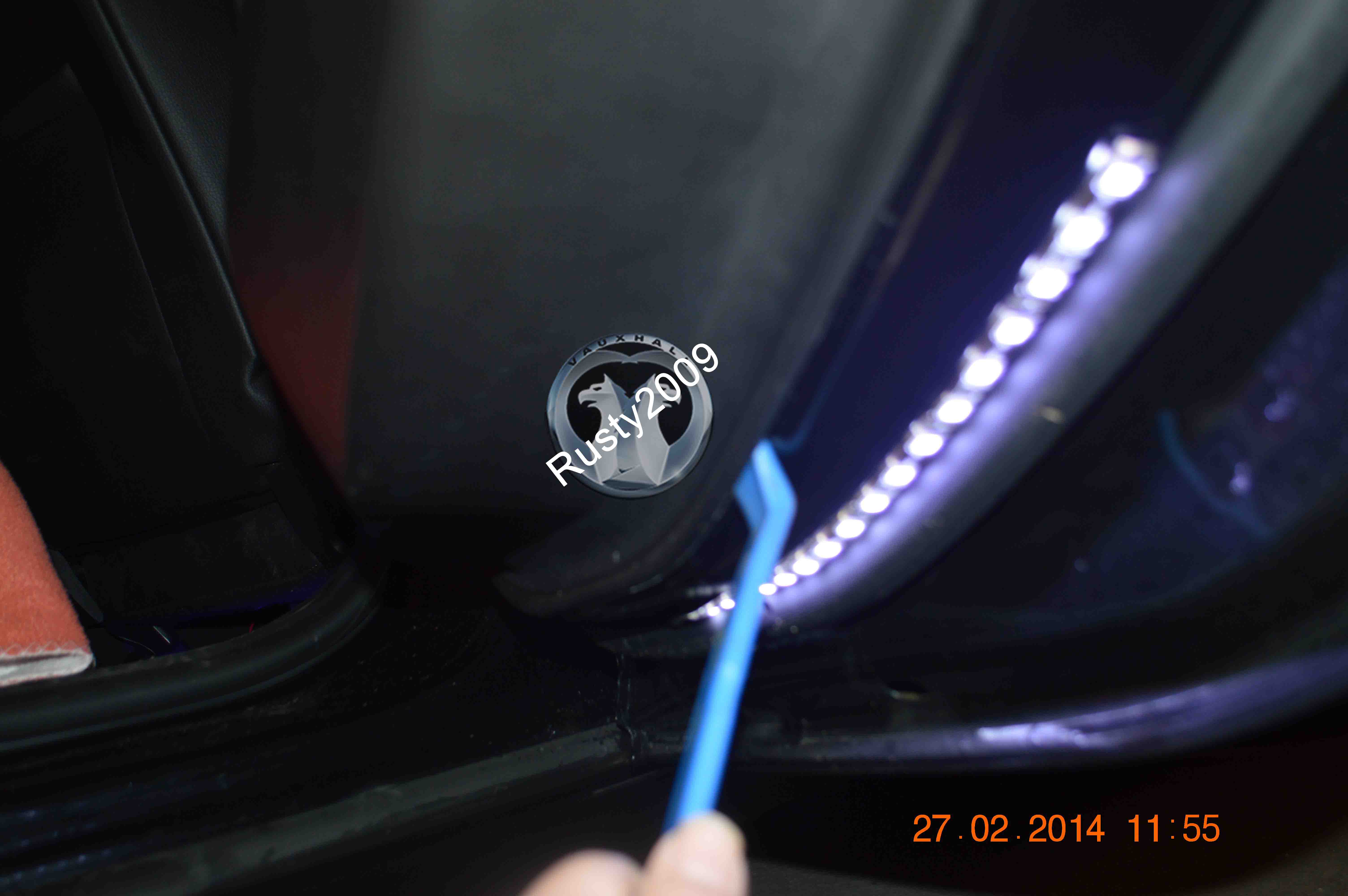

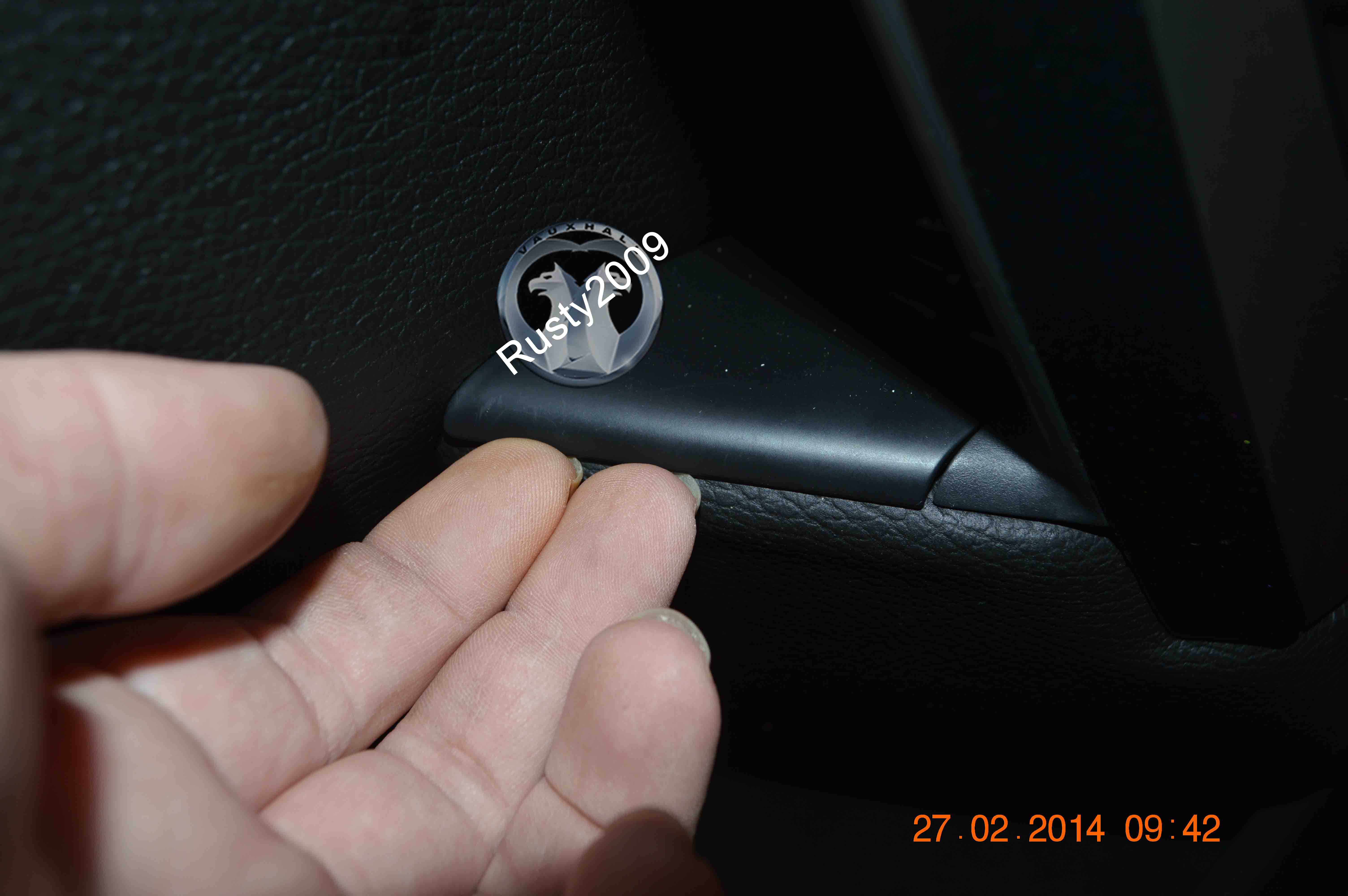

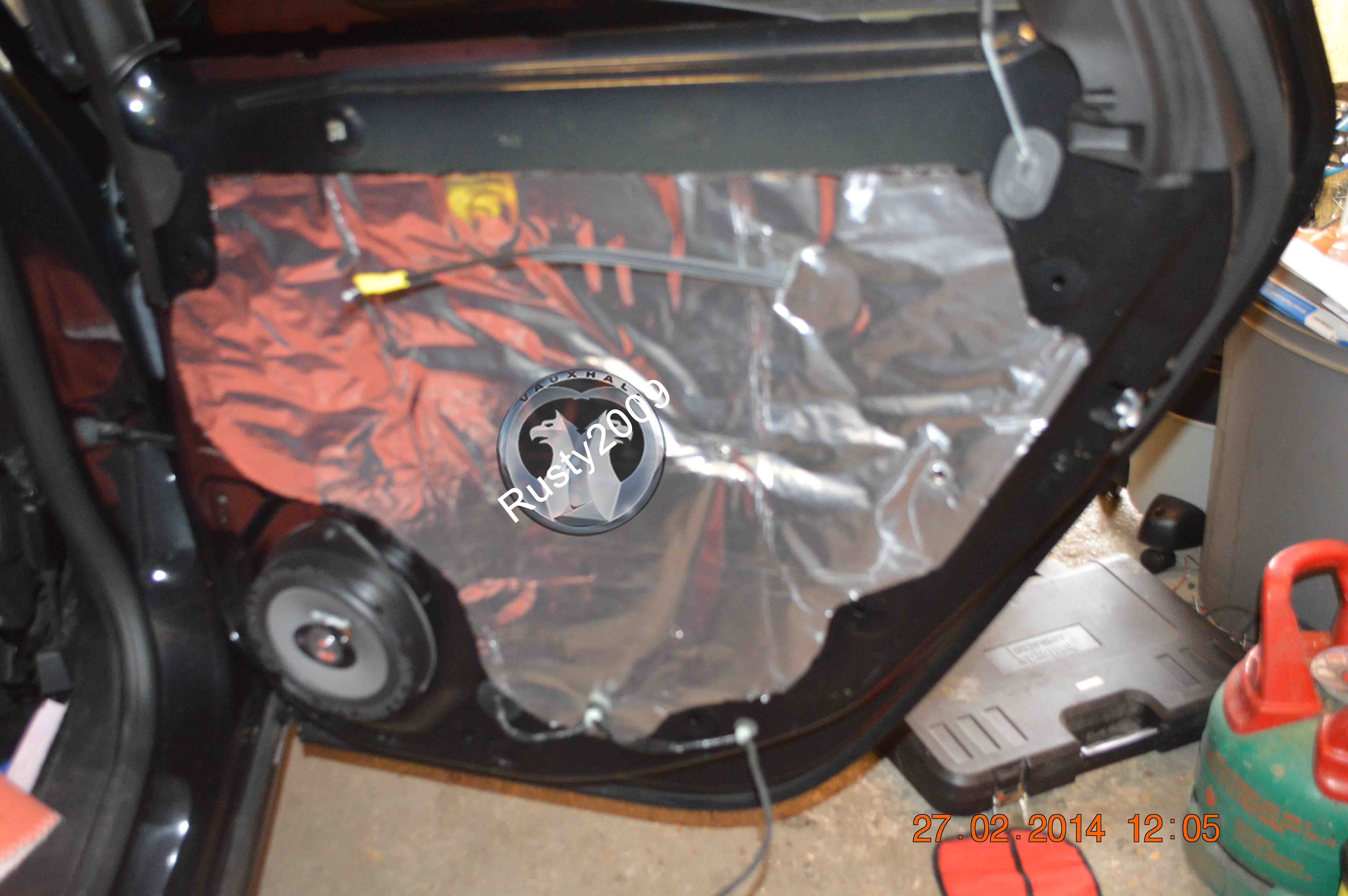

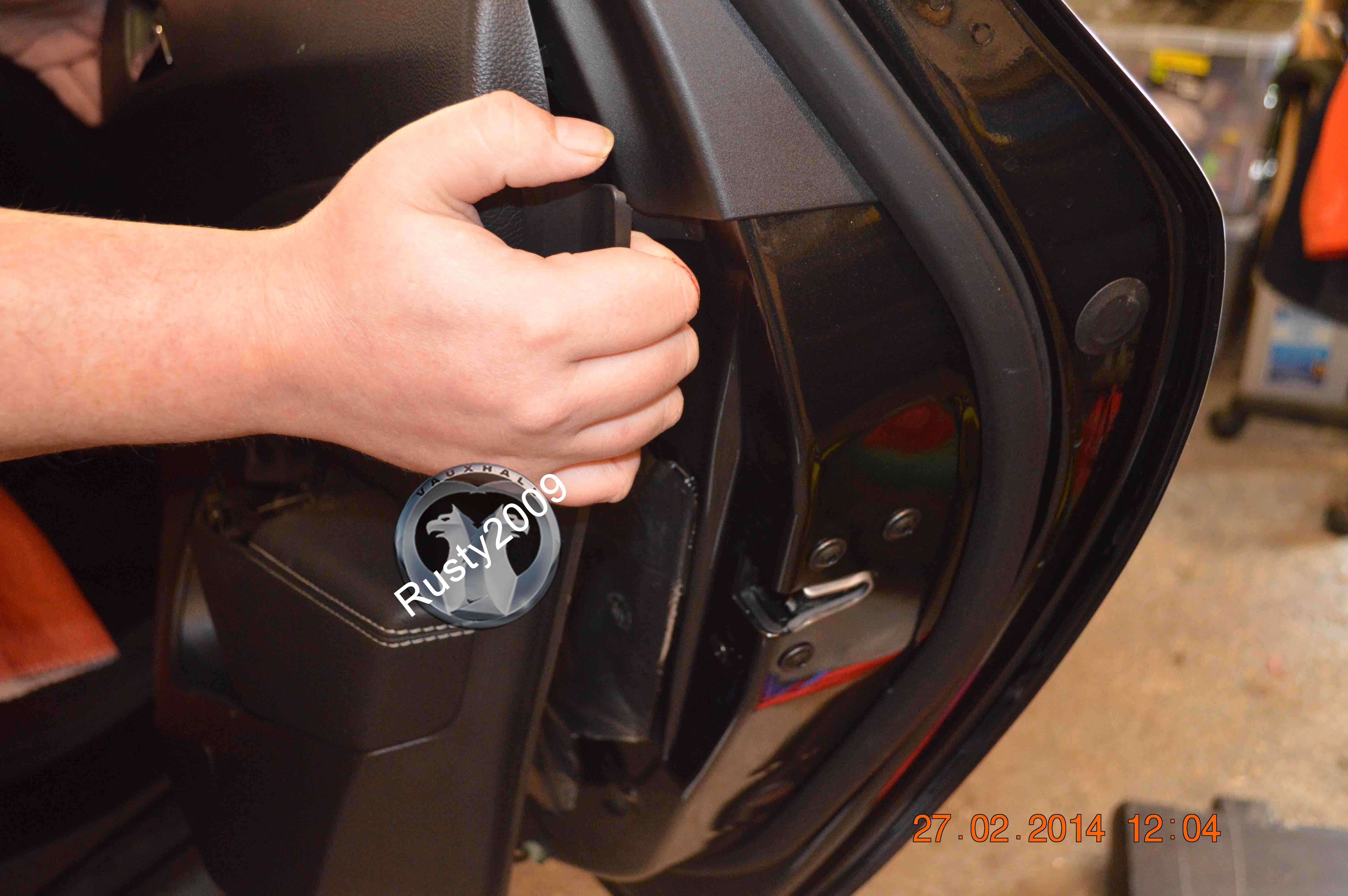

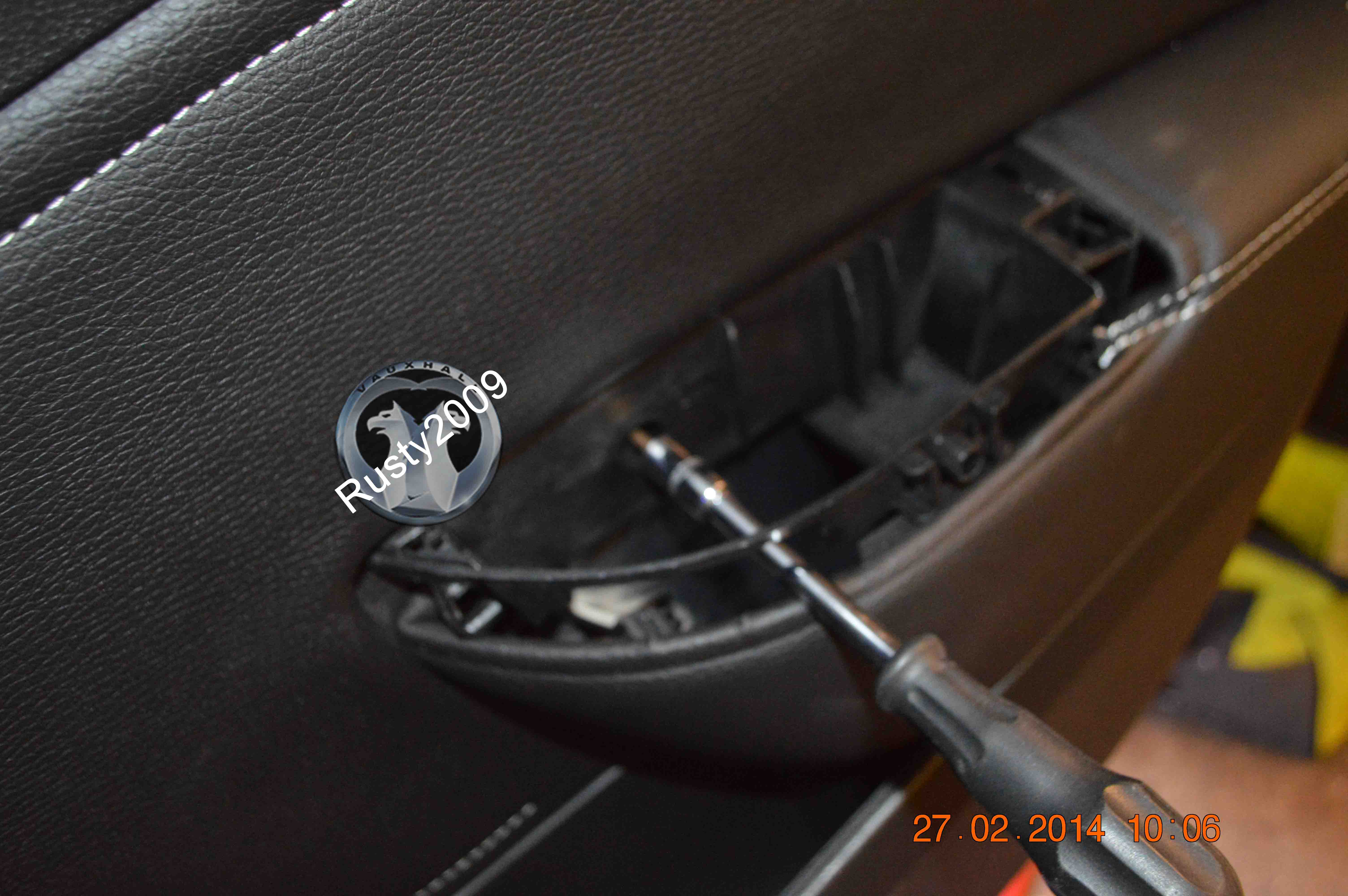

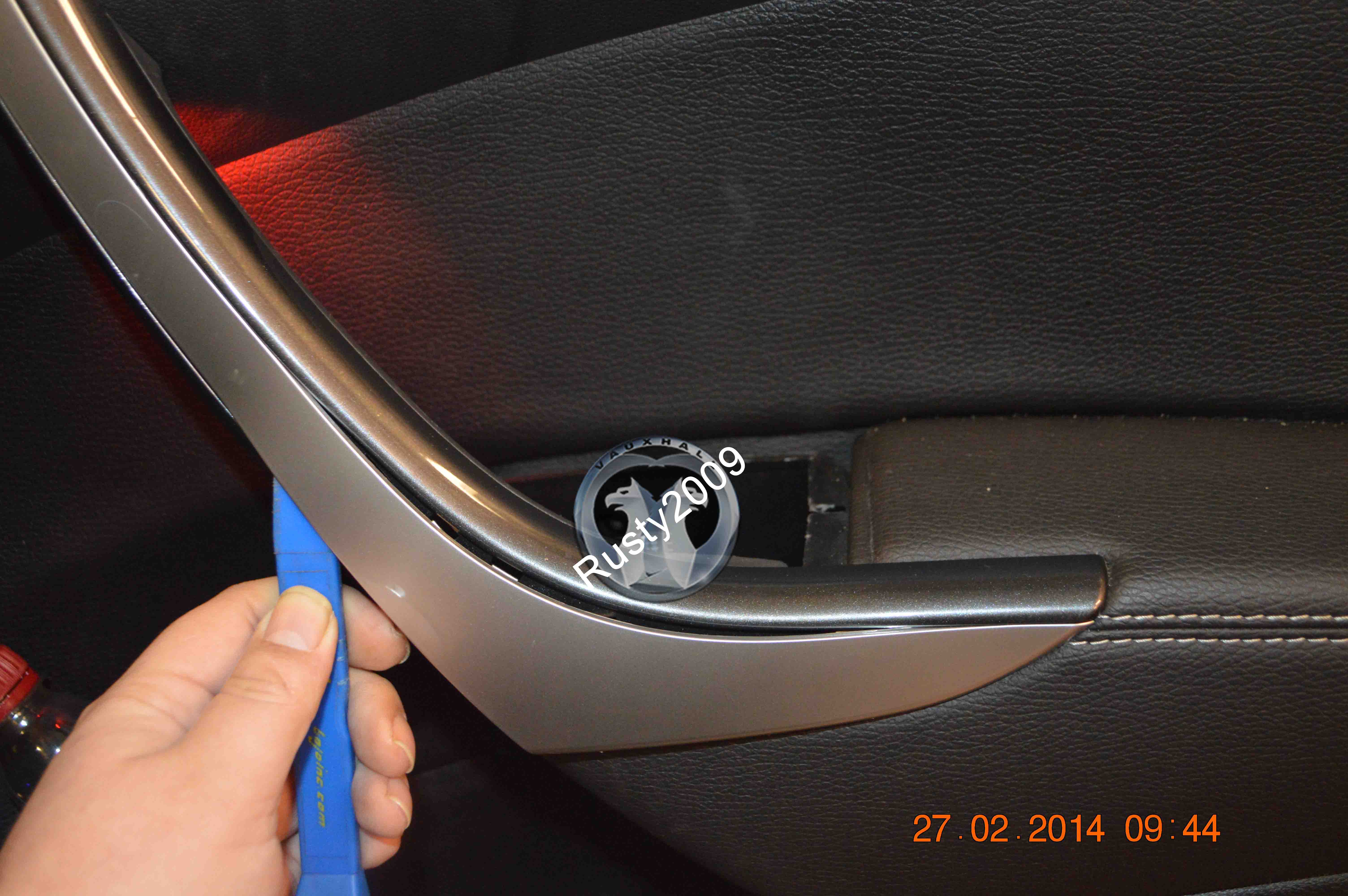

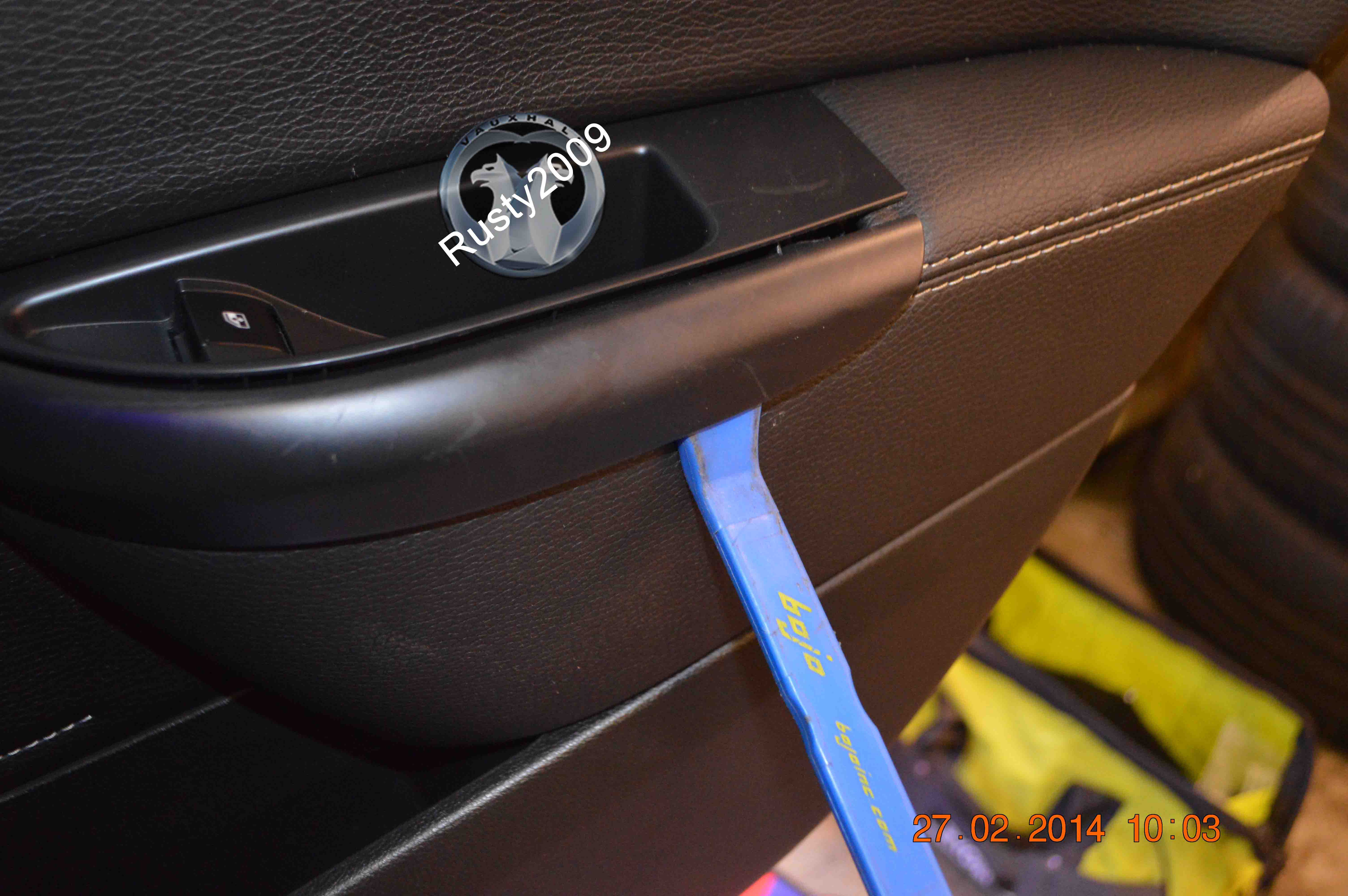

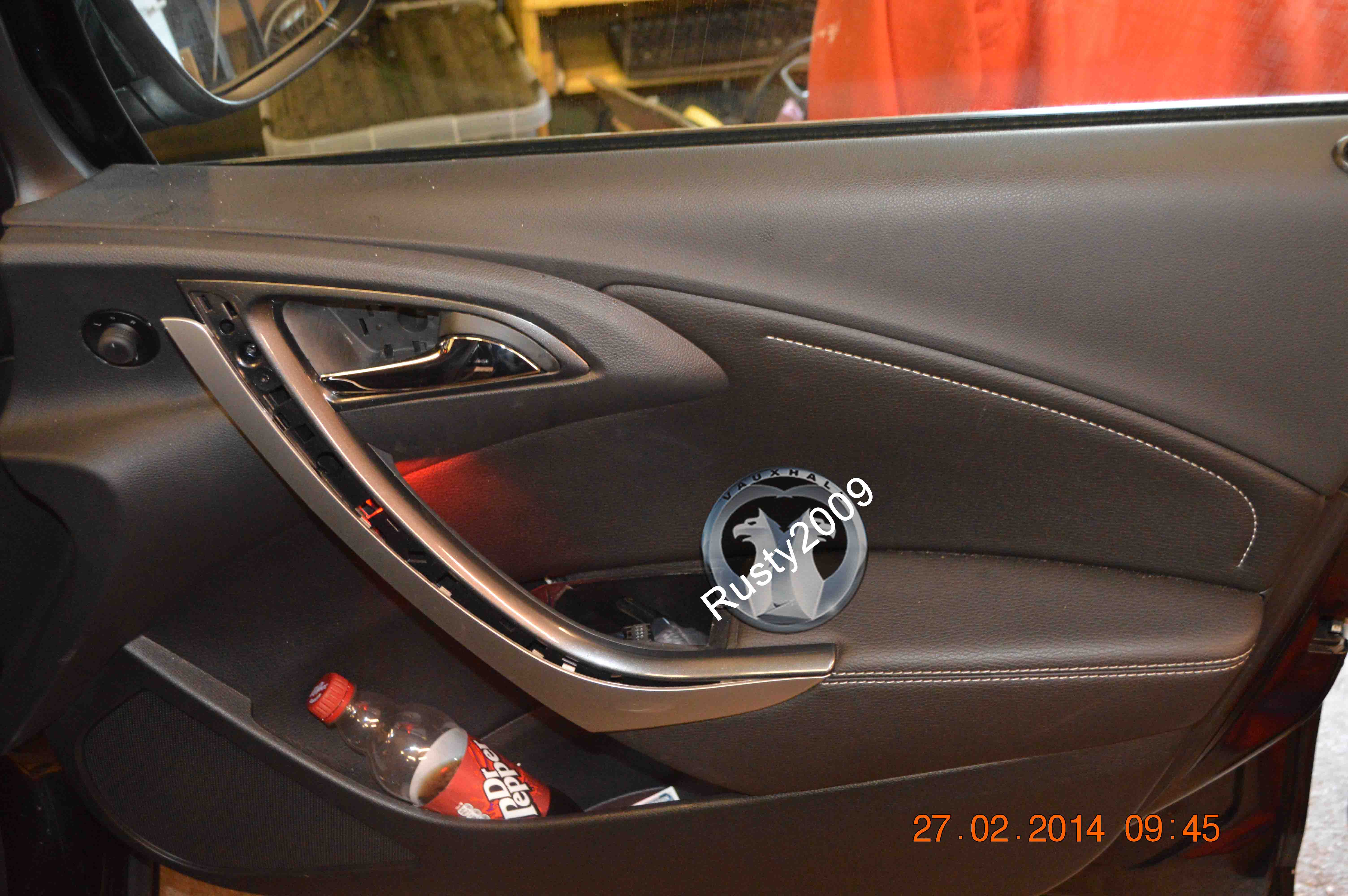

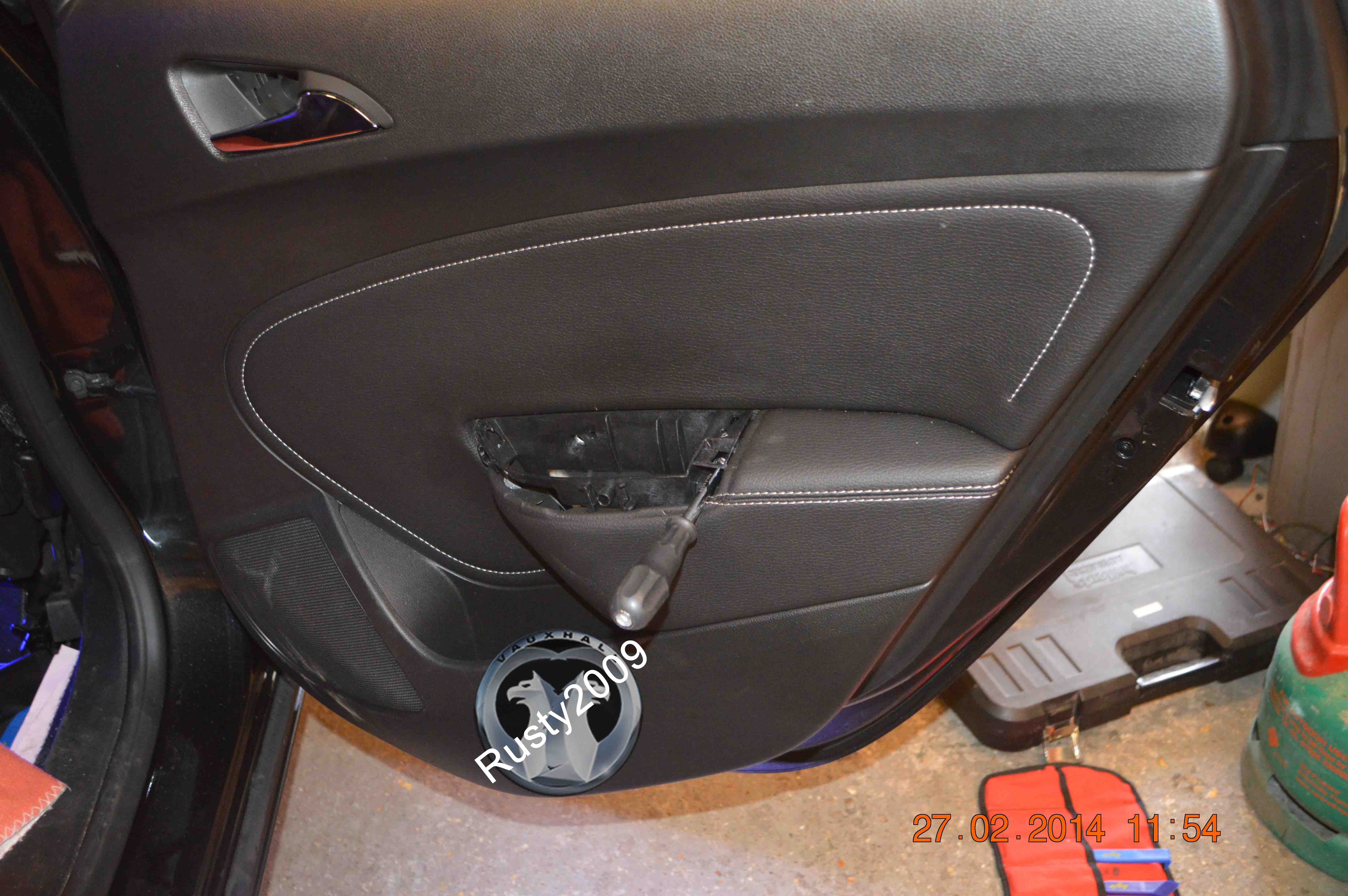

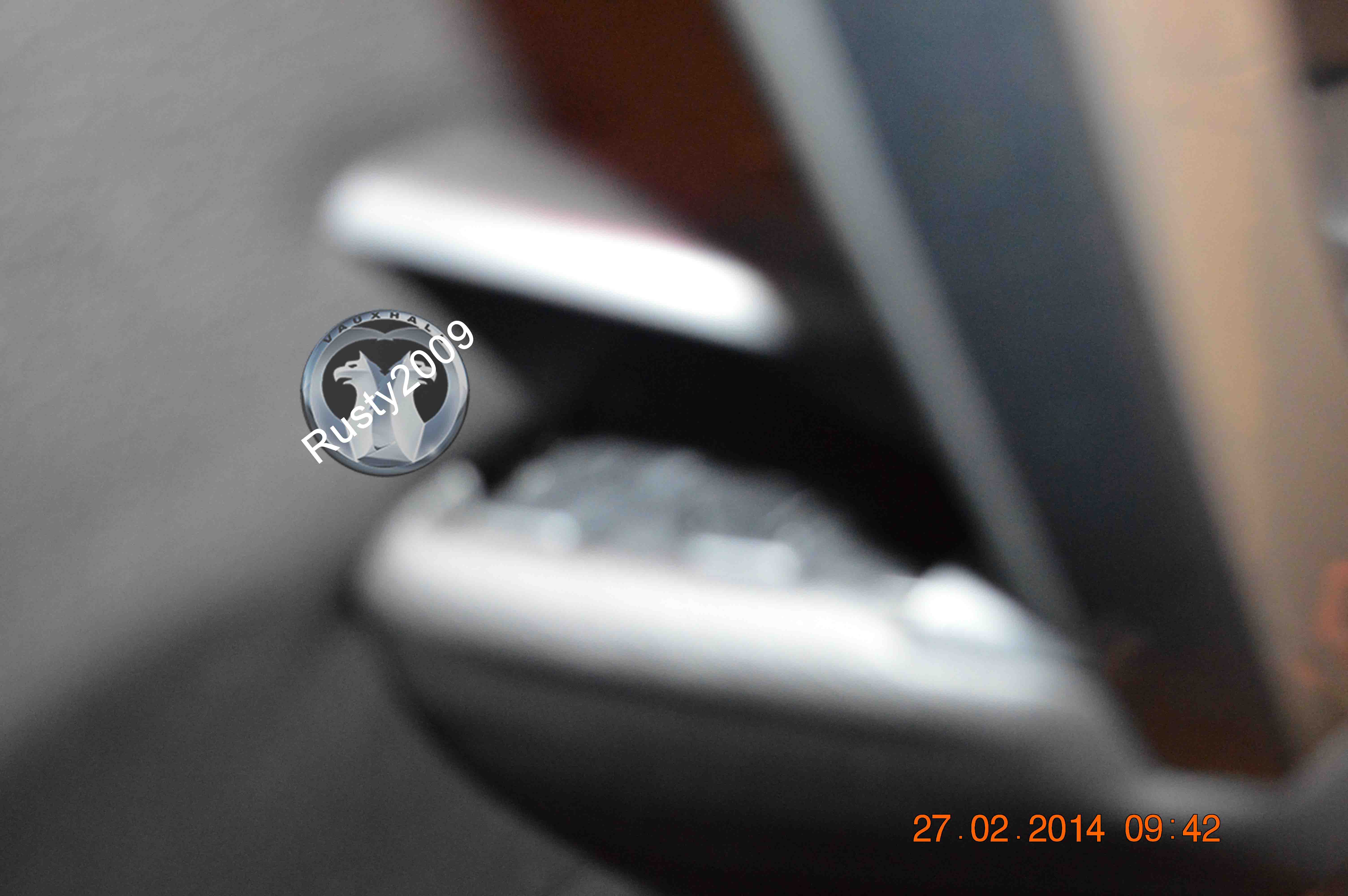

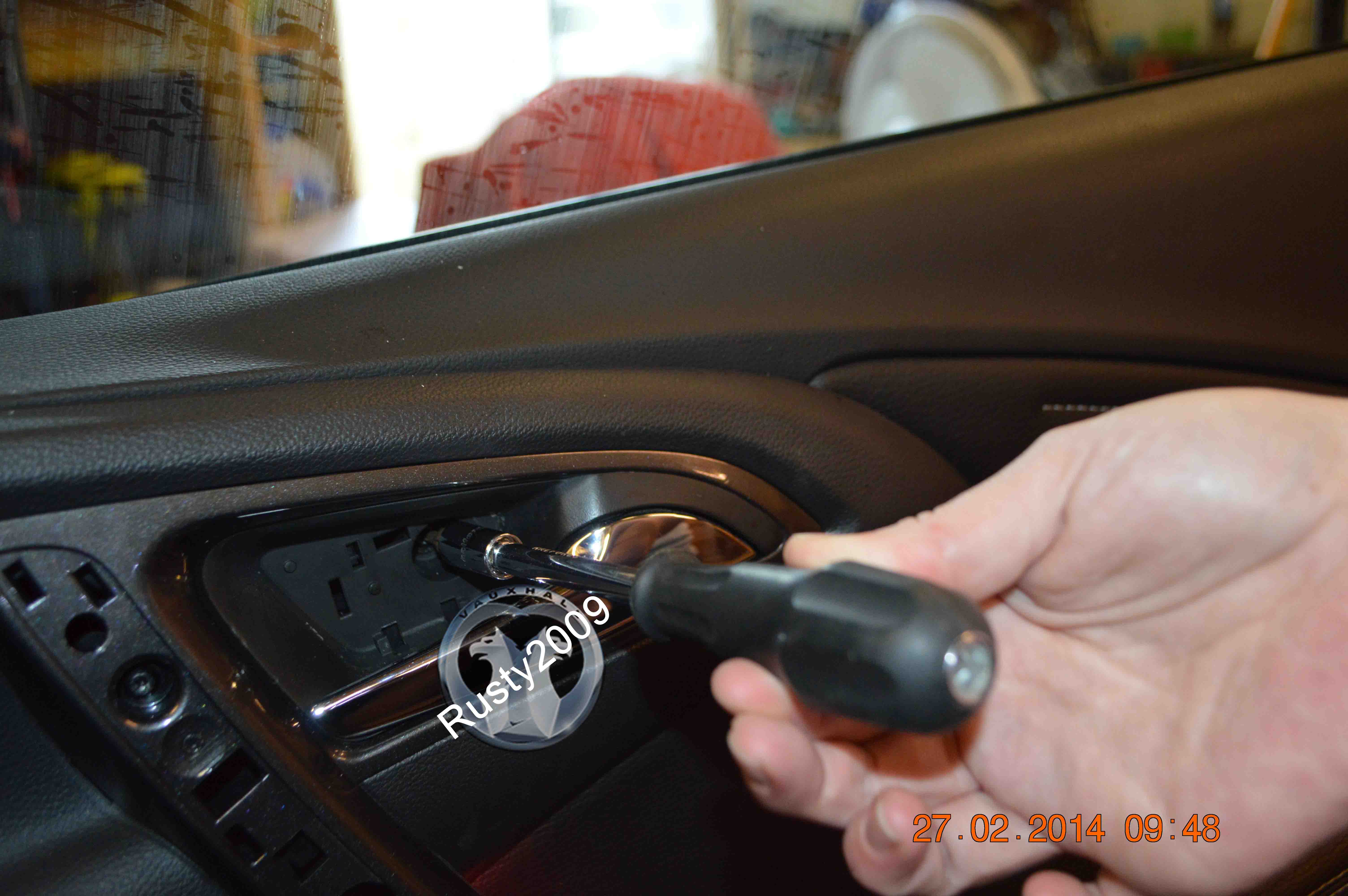

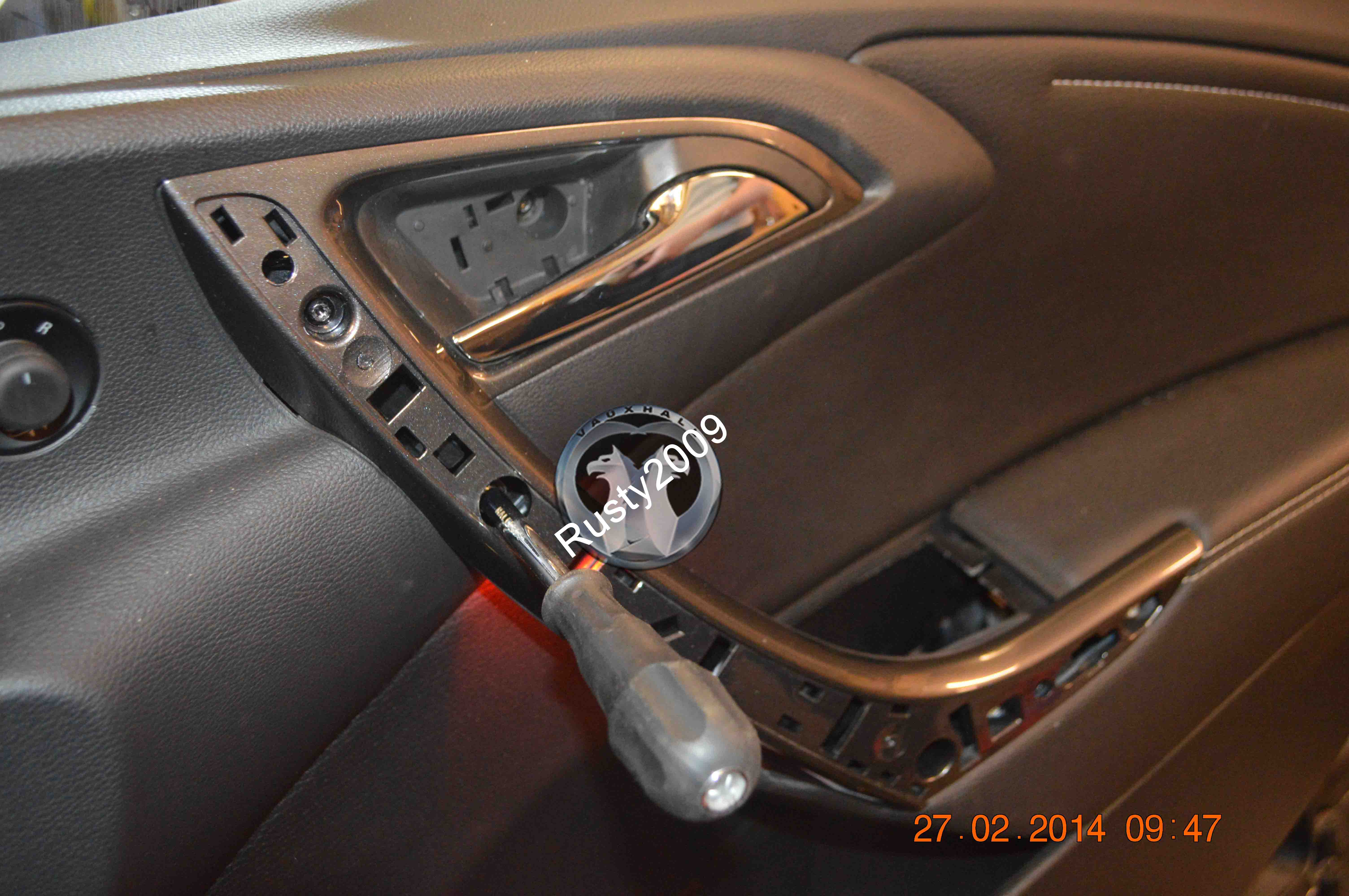

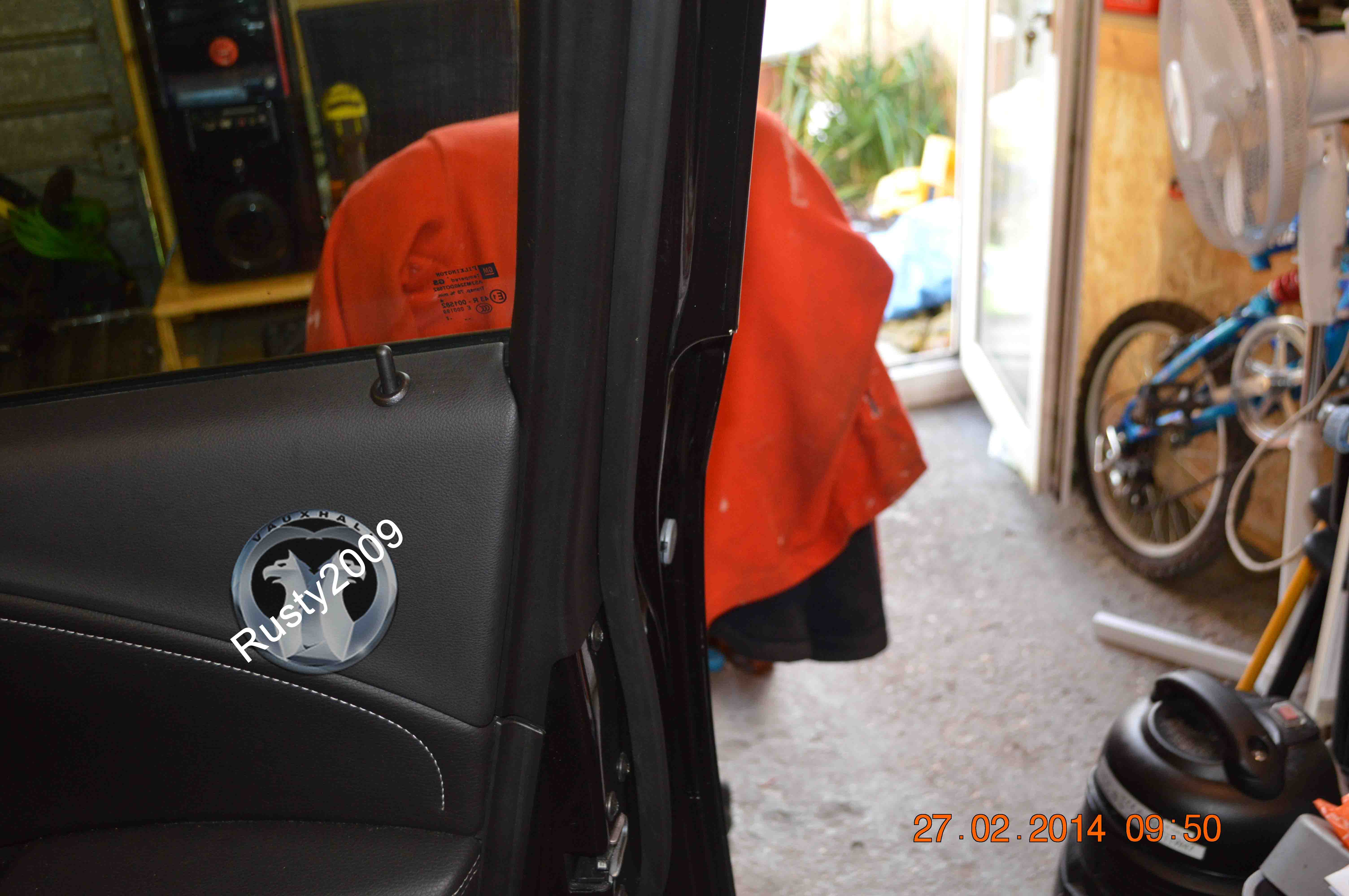

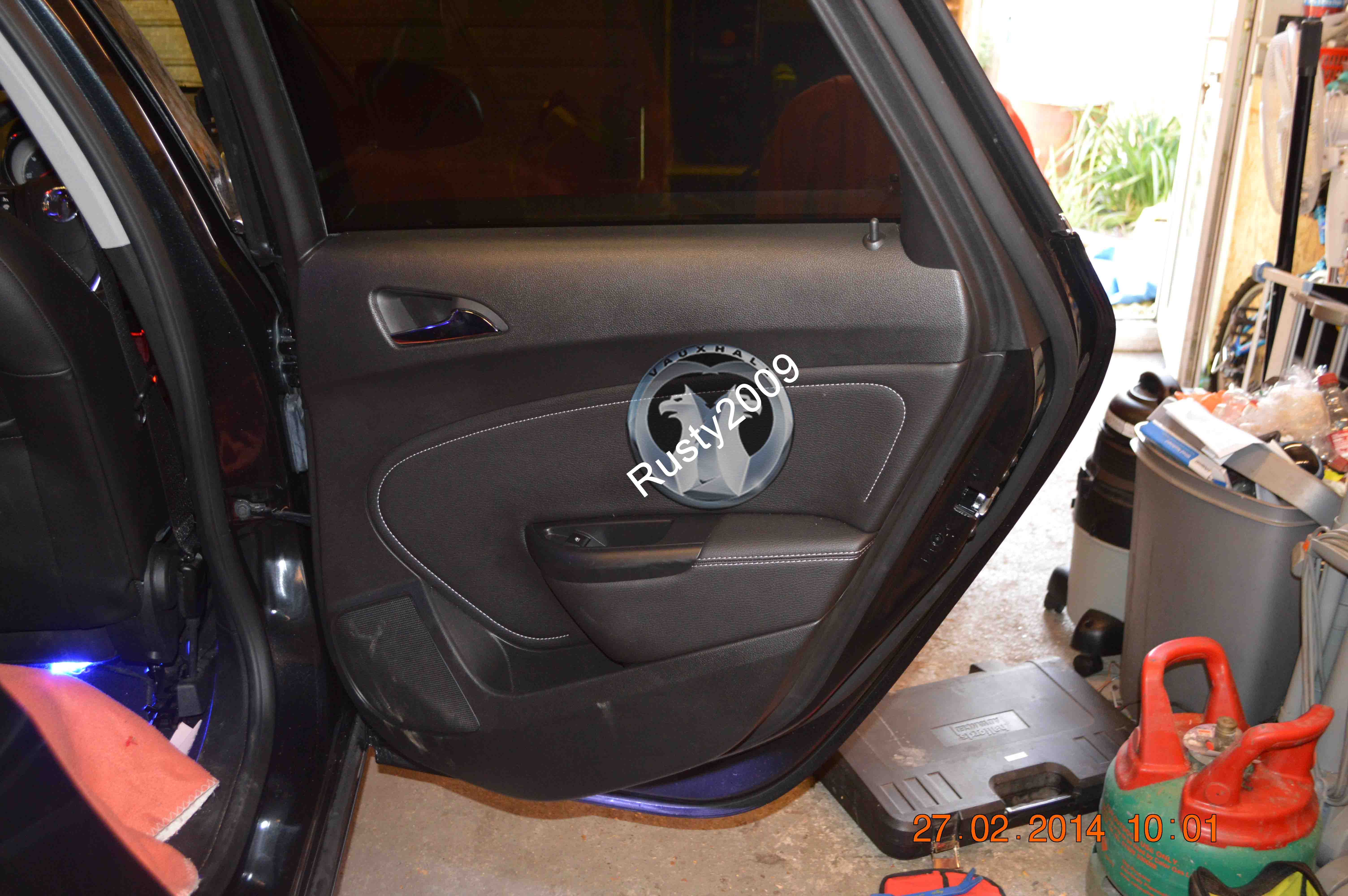

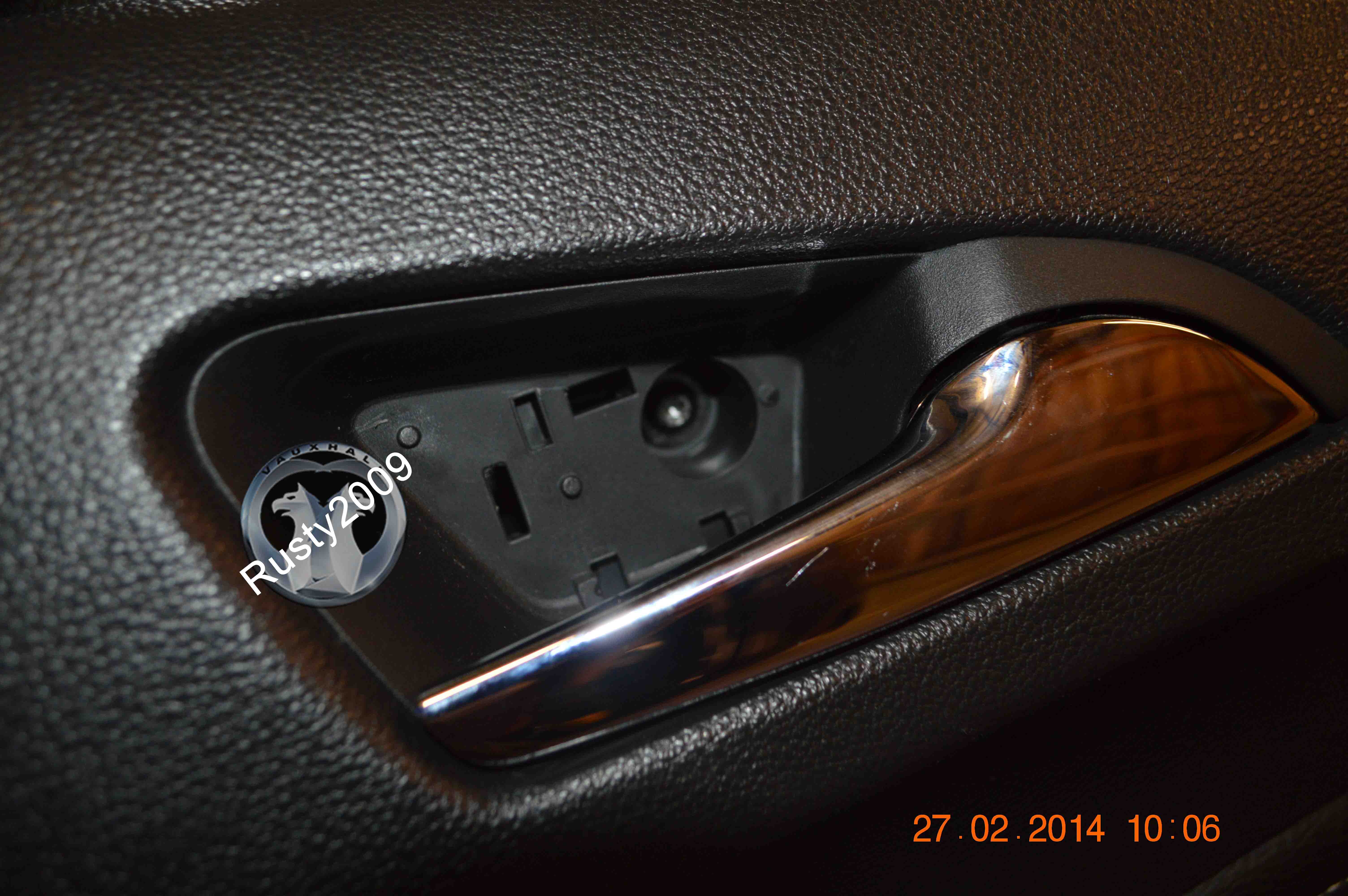

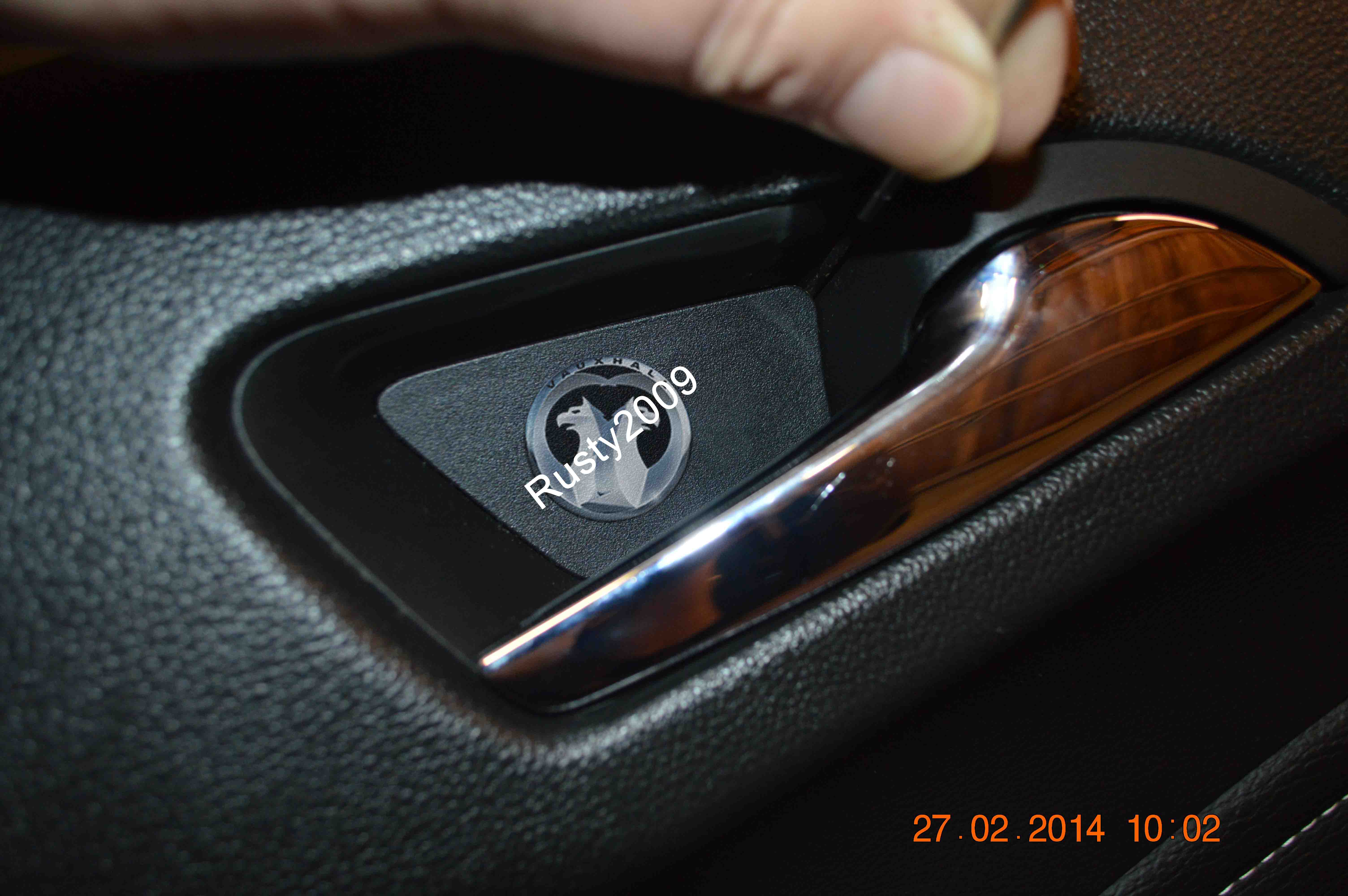

How to remove door cards - Rusty2009 - 27:th-Feb-2014 ![]() How To Remove Door cards. Front The first thing you need to do is open the window/s and remove key. Then you can start removing the door cards, So get a small precision screwdriver and remove the cover on behind the door handle Then lift up the window control switch, and then pull it towards the car. Next you need to remove the trim running up the door handle, start where I have and work your way up (Follow the pictures), Take you time as it is easy to break some clips. Next job is to remove the 3 screws Next you need to pull the door card from the door, be careful the clips can break here Once you've unclipped the door card you need to lift it up on the right edge then pull it back to the right, Unclip all the connections and remove that's it done. Refitting is the reversal of removal. Rear. Again really simple and straightforward, For thoses with the manual winder please see the below clip for a quick and cheap way of getting the clip off with a rag. To start we need to use a small precision screwdriver to remove the cover behind the handle Next we need to remove the back end of the trim around the window switch Next we need to remove the window switch so simply pull up from the rear and unclip from the front Next we can remove the front end of the trim Undo the 3 screws Next we need to pop the door card off starting at the bottom Once you've unclipped the door card you need to lift it up on the right edge then pull it back to the right Undo connections and that's it. Please note if you want to buy extra clips before you remove the door cards then you will need the following per door.
