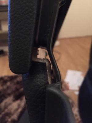

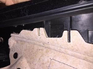

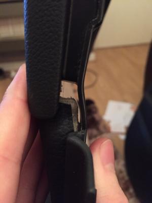

Okay looking to start attempt 2 tomorrow! ha. problem is that one of the plastic things that holds one of the blue clips is snapped (was like that when i got them) so not sure if this will cause problems...I've managed to glue it back on a bit but its not very strong.
Also does this look damaged? Not sure if there should be such a big gap or if it should be flush with the other piece like in the second photo:

#55
Should be flush mate
#56
bond it back together from the inside with silicone and glue it should hold

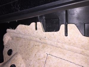

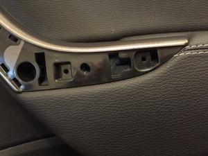

The guy is such an idiot thay he even removed the screws for the handle trim too!
[ATTACH]427[/ATTACH]

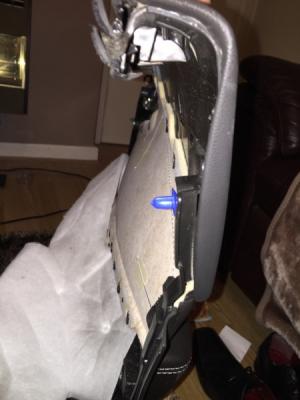

Also are we sure that this should sit flush even when not installed? Just that when I make it go flush, this piece of plastic looks like it's bending:
[ATTACH]428[/ATTACH]
[ATTACH]429[/ATTACH]
#61

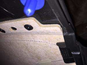

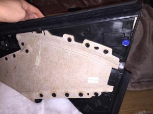

yep it should be flush can i see the back
#62
[ATTACH]430[/ATTACH]
[ATTACH]431[/ATTACH]
[ATTACH]432[/ATTACH]
[ATTACH]433[/ATTACH]
Not sure what you wanted to see so I took a load lol. There was some weird cloth/cotton wool behind the panels that covered the whole thing, sort of like a sheet of it. I pulled it off though as it was loose anyway and wasn't on my other door cards

#64
Should be flush at all off or on, I know what they they pulled it there instead of using a trim tool from the bottom

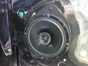

I was planning to remove my door cards in order to install new speakers. But after reading your last posts I am terrified! I doubt I will make it without destroying those door cards.Shocked

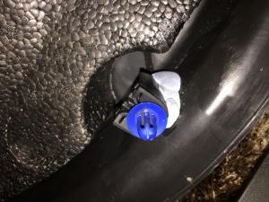

Part number Description Quantity
13252119 CLIP, 14MM OD., FRONT DOOR TRIM TO DOOR 2
13252118 CLIP, 12MM OD., FRONT DOOR TRIM TO DOOR 5
13252119 CLIP, 14MM OD., REAR DOOR TRIM TO DOOR 2
13252118 CLIP, 12MM OD., REAR DOOR TRIM TO DOOR 5
It seems that I cant find them at any store around here. Any ideas wether I can find them online? ebay has millions of clips but whats the correct size? 12mm OD means 12mm top head diameter?
#84
Try Autovaux mate or ring your local dealer and they can order them in for you if they don't have any in
#85
the dealers sell them there not that expensive and at lest you will know they are correct

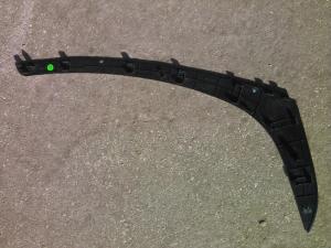

Oh my! I finally removed the door panel after 3 hours of trying. Removing door handle trim was by far the worst part. I broke 1 clip from that trim and 1 clip from the door card. Anyway, installed new speakers (Pioneer TSG1723i) but I think the original speakers sounded louder with more bass. I m not happy at all. Maybe an amp would make those new speakers sing. For those who will attempt to remove door cards for the 1st time, I took some pictures at the back of the door cards in order to know where are the clips located so you should know where to pull

I was the same as you! First attempt took me like 3 hours too but the next time it took me about 40 mins...you start to learn the quick ways of doing things and how hard you can pull certain parts of the door cards without breaking them but which allow you to get them off fast lol

i had the same problem when i fitted the speakers but when they are all done the sound changes for the better
basically the new speakers are clashing with the old it will sound better when there all done
