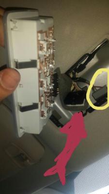

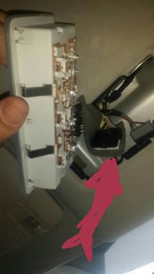

What is it this socket
Socket
Where are you based @stigeye?
No the grey one
I'm based in Loughborough mate, about 10 miles from Leicester.

This socket friends still do not understand how it works
How long does it usually take to hear back from GM regarding whether the request has been successful?
(16:th-May-2016, 19:25:43)Kado1111 Wrote: This socket friends still do not understand how it works
There is a loom that plugs into it I'll look all the part numbers up later.

(15:th-May-2016, 21:20:29)Kado1111 Wrote: What is it this socket
Socket
I wonder sanruff of a socket

I have just had a look to see if I have the required connector block above the comfort lighting, I believe (hope) this is the one I require...
Any idea what this connector is, partially wrapped in grey foam, near my finger...
Yes that's the right connector mate.
The one wrapped in foam is just another light one quite where there is 2 I don't know and I've not been able to find out why there is 2
