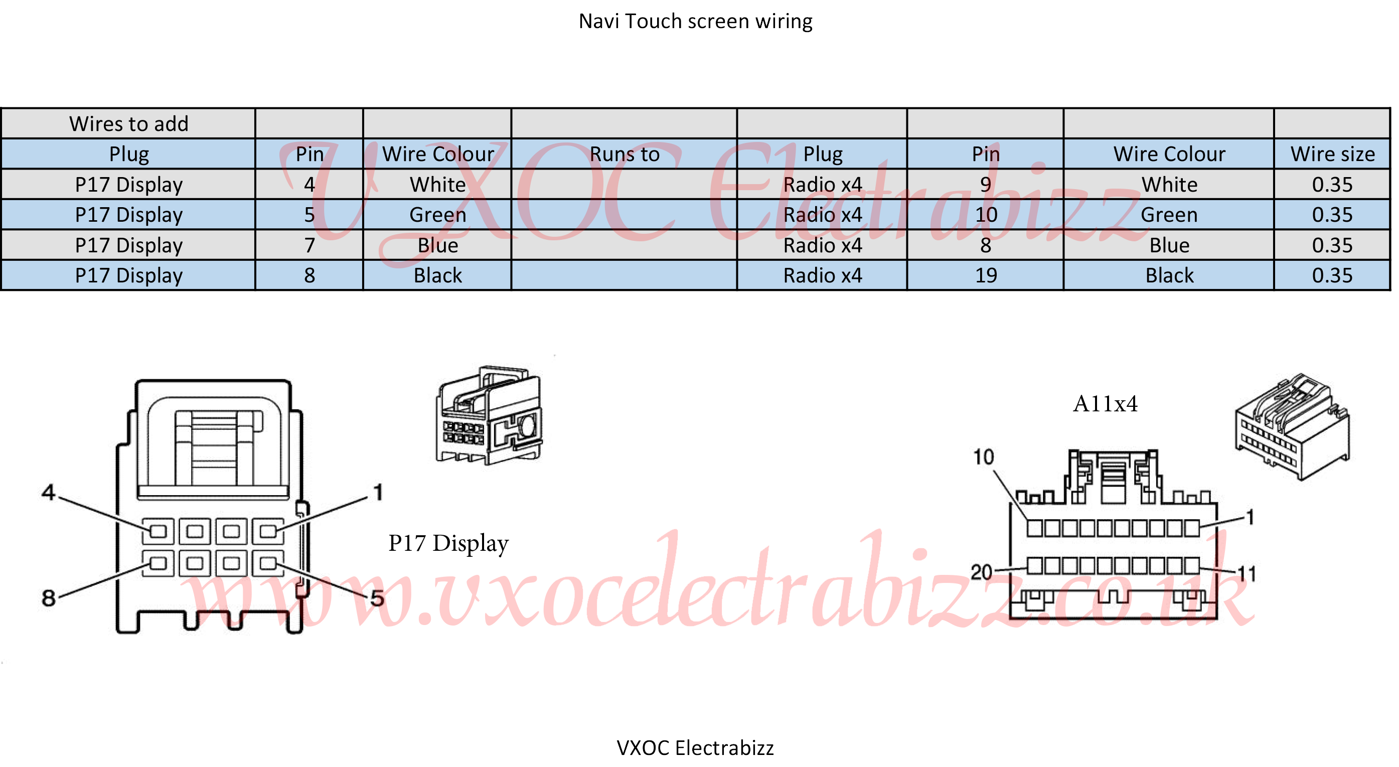

We can enable touch screen rear camera and DAB+ with a Chevy theme quite nicely.
For this you need a screen with the following part number 22851302
There are 4 extra wires needed for touchscreen as detailed below, The white & blue are shielded with the black being the drain.

The radio needs to be programmed with the calibration files for touch screen.
I had to get a custom VCI code made for mine (NOT BY GM AS GM won't support it) but going down the custom VCI code route it leaves you able to select the following options.
Chevy / Vauxhall or Opel theme (VXR/OPC)
Rear camera with or without guide lines
DAB+ or no DAB+
Infinity sound or standard.
Control type IE Astra, Insignia, Mokka, Zafira or Meriva.

Your 950 can be reprogrammed for touch then you need touch screen and a little bit of wiring plus the module.
@rusty2009 is you man for all the programming
