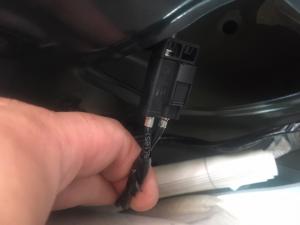

In terms of wiring it depends some cars have the wiring already others don't, you can look in your footwell drivers side see image below.
You would the Dab aerial for rear window and a cable to join up as you will most likely find it's a dummy cover.

Ah OK Starting to make sense.
I've had a look and I do indeed have the multiway connector and DAB aerial in the footwell.
I've also had a look in the tailgate and found the cable from the rear window is indeed a dummy.
I've also located a 2 way connector which has a spare position.
So I need a cable to replace the dummy on the rear window which will connect to the spare position on the double connector under the roof liner?
Are there any module inbetween?  I notice the FM aerial goes through a 'ZK' module.
So you will need the ZR DAB aerial (I sent a link in the PM).
You will need a short cable than the one I sent one in the PM & a male to female.
1M version https://www.ebay.co.uk/itm/Fakra-Z-Plug-...Swn8pc8DiM
2M version https://www.ebay.co.uk/itm/Cable-Male-to...SwddpciG1d
There are no other modules.
