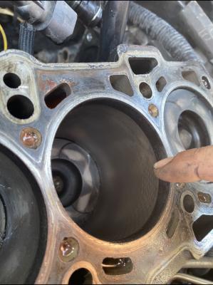

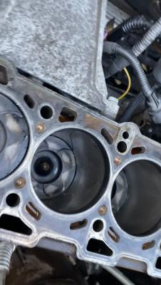

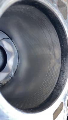

As you can see here, the pistons are in a good shape so I won't change them

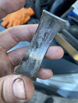

And now those are the crankshaft bearings, some of them are in bad shape and one of them is broken as you can see it's on my hand, we found it like that in the oil :O
