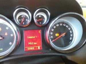

Because i`m trying for long time to fix the parking issue, i have only the sound but no visual on cluster, today i used opcom to see what modules i have installed in the car :
cluster - 13355676 ( big screen )
parking module  - 13344459
Right now my cluster looks like this

Have a word with Russell he knows all things about clusters and upgrades
I saw a similar article on facebook, Rusty 2009 swapped over my basic IPC for an uprated s/s IPC which had more menu information, there are several members on this site that do the retrofit, however Rusty have done all my retrofits on my previous Astra J & now the GTC & his workmanship is top quailty.
also i saw many of them but nobody is telling the part number. i don`t wanna buy something that it will not fit my desires ). at the last recall from vauxhall i ask them to take a look at my parking module and see if they can activate the visual notification, they let me know that my module do not have that..only audio
The parking module is nothing to do with the display so forget about the parking sensor module.
as for the speedo it's not as simple as someone giving you a part number there is far more to it.
PM your reg & I'll check your spec and look for a suitable match, but again you can't just buy one and fit it it needs programming and configuring to your car not many people can do it.
In terms of having front and rear sensors displayed in the screen it isn't always possible as it's all done via the config files which come from GM there is no user control over this.
