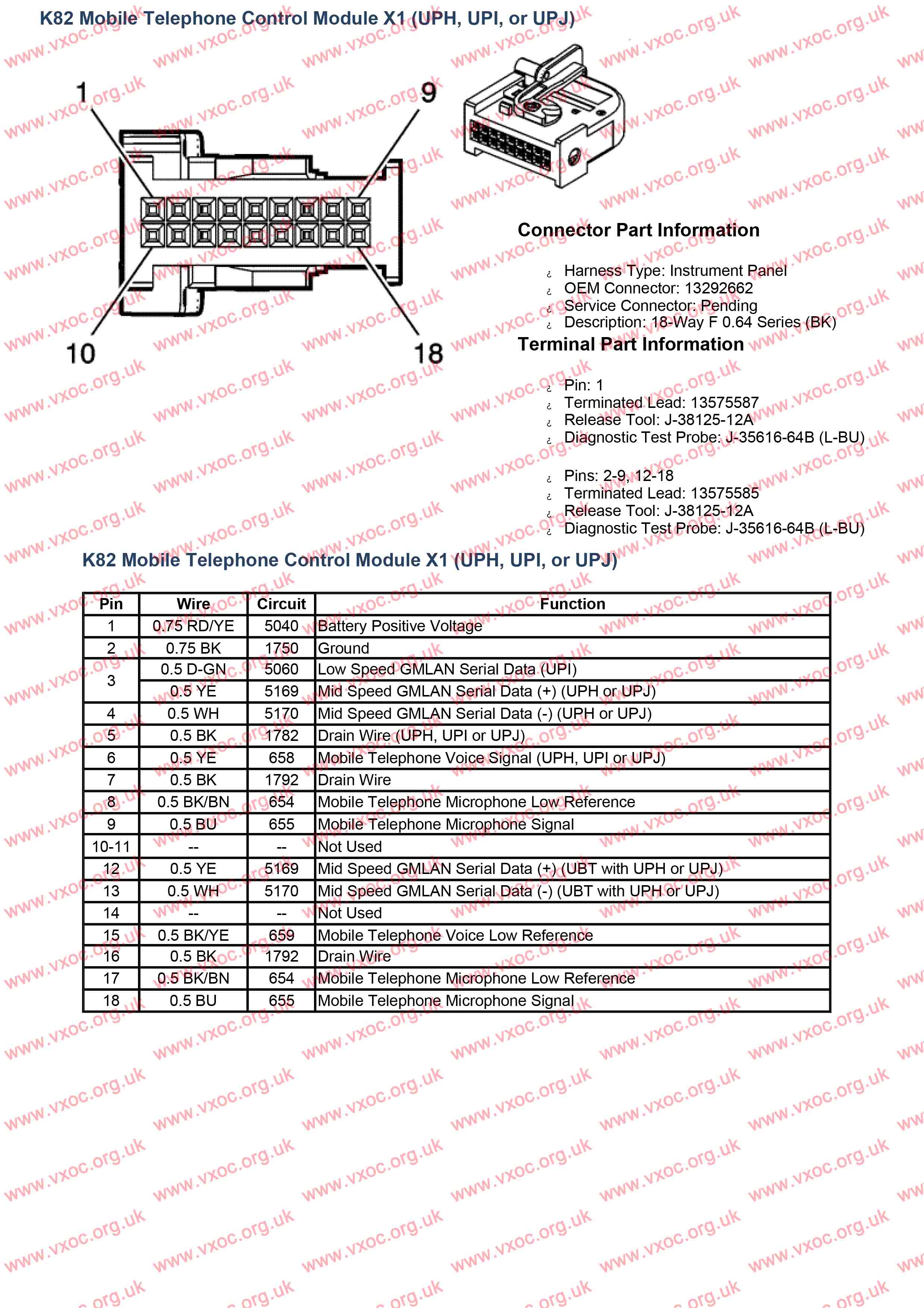

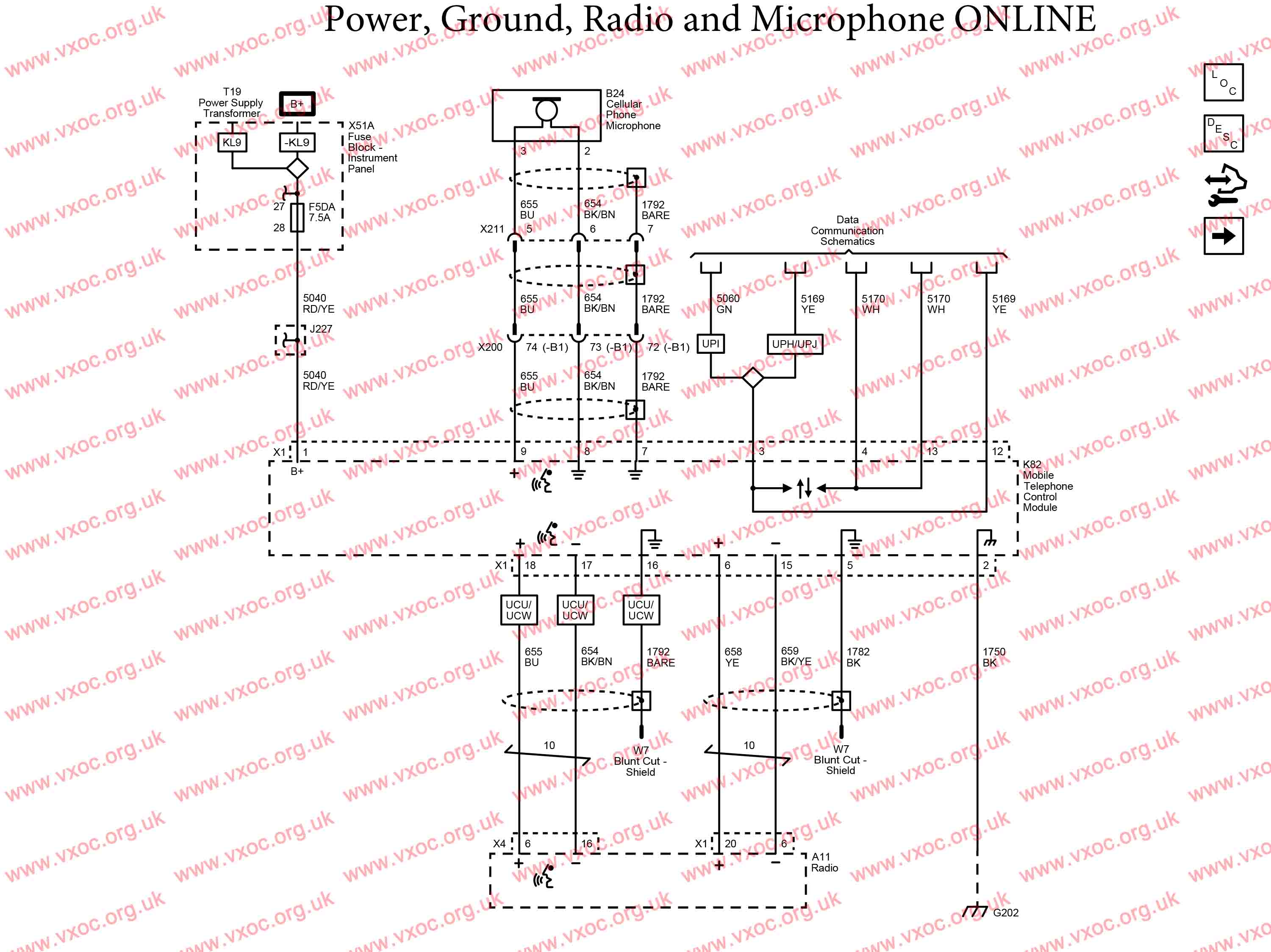

Hi can anyone help me make the retrofit bluetooth wiring that goes between head unit and wiring block please like the pic here
I never do it like that, that just makes the job harder as you need fit the extra block.
How do you do it??? I just thought you had to do it that way
By splicing into the factory loom.
