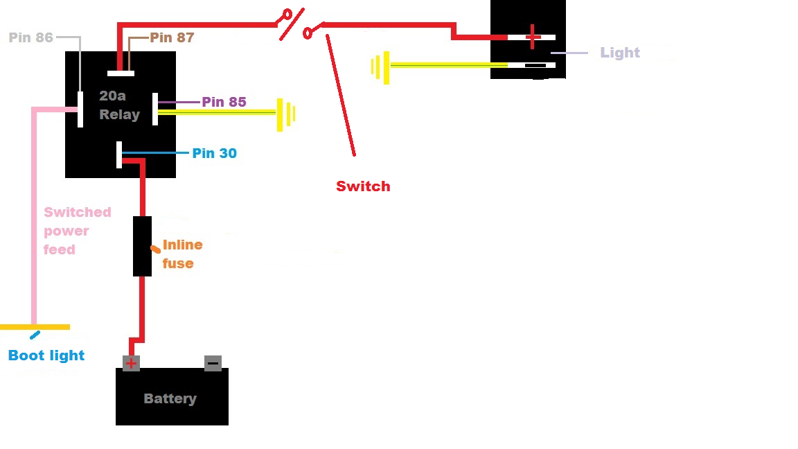

Via a relay would be a good way then.
Wired up something like this
Looking good. Will be scouting the trim tomorrow for good potential sites for the LED clusters themselves, then looking for the right units across the usual websites.

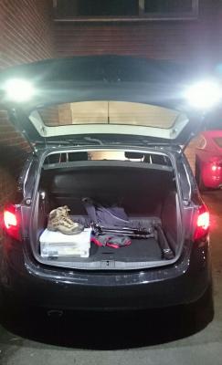

Sorry for updating an old thread, But a few weeks ago i bought these little white panels from AutoBeam i think and they are supposed to be footwell LED's but i fitted two in the boot lid on the Meriva wired straight into the boot light, and they are great in the dark, nice spread of light around the rear of the back but also into the boot itself.
Wire went through the gator thing between the boot lid and the body and straight down the side into the boot.
Is that the 48 smd led panels?
