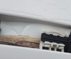

My drivers A pilar is wet and it looks like the sealant has cracked under the roof rail, I planned to sort it today but typically the rain started just as I did.
No way would I be taking my car to a dealer to put some tiger seal on it, like already said trial and error. Start at the top and work your way down.
That does look like a crack in the sealant, it doesn't need a very big gap for water to get in through
