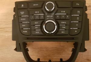

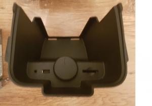

hi there! I'm new on this forum, living in the Netherlands and searching for info for replacing my CD400 system for a
NAVI600 system. My Astra J Sports Tourer already has the bluetooth module; Besides this it only has the AUX
input for 3.5mm audio plugs. I already have the complete NAVI600 system (UCU unit, display unit, control unit,
USB - SD card module - see pictures). The UCU unit is already unlocked so it should be accepted after installation.
Problem which I have now are:
1 - not having GVIF cable which is the video cable which connects the display to the UCU unit (blue connectors)
2 - not having the USB cable to connect USB module to UCU unit
3 - not having cable to connect SC card / 3.5 input jack to UCU unit
Could somebody tell me where I can get these cables?? Other question I have is about wiring: the guy who
unlocked my UCU control unit told me that I have to make some small changes in the wiring system; does
anyone knows if thats correct and if yes could you tell me what I need to change in the wiring?? Hope one of
you can help me out with these questions; really appriciated!!
BR Bas

The GVIF cable is part number 95353437
The USB connect into the SD port mini-b to mini-b link
SD to Radio Mini-A to Mini-B
Yes there are wiring changes needed.

Thx Rusty for explaining which cables I need! One question left: at the back of the USB-AUX-SD Card console there are two pins next to the connector for USB cable which goes to radio unit. Do you know where those pins are needed for; do I need to connect something on these pins ore will SD card work when USB cable between console and radio is connected?
BR Bas
I think the one you are talking about it the power supply, this is needed for the sd card side of things to work.
(12:th-Jan-2021, 08:02:24)Jpbroad1970 Wrote: I think the one you are talking about it the power supply, this is needed for the sd card side of things to work.
Hi JP,
thanks for reply. Guess you are wright and connections are needed for 12v power supply. Any idea how to find out
which pin is for +12v and which one is for ground??
BR Bas
Black is ground, the other is red and yellow which is power.
Think I have a photo somewhere
Pin 1 is black
Pin 2 is red/yellow
Sent from my SM-G780F using Tapatalk
(13:th-Jan-2021, 19:07:55)Jpbroad1970 Wrote: Black is ground, the other is red and yellow which is power.
Pin 1 is black
Pin 2 is red/yellow
Thx JP; done; succesfully swapped CD400 to NAVI600 in my Astra J!! Took me some time but it works ...
BR Bas
