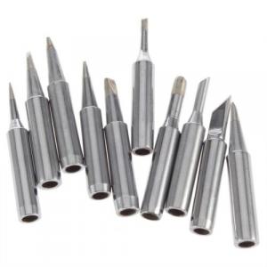

when you say fine tip how fine?
These are what I have.
Looking at your pic I'd say the best would be 4th from left as you don't want a large heat area or too a small heat area
