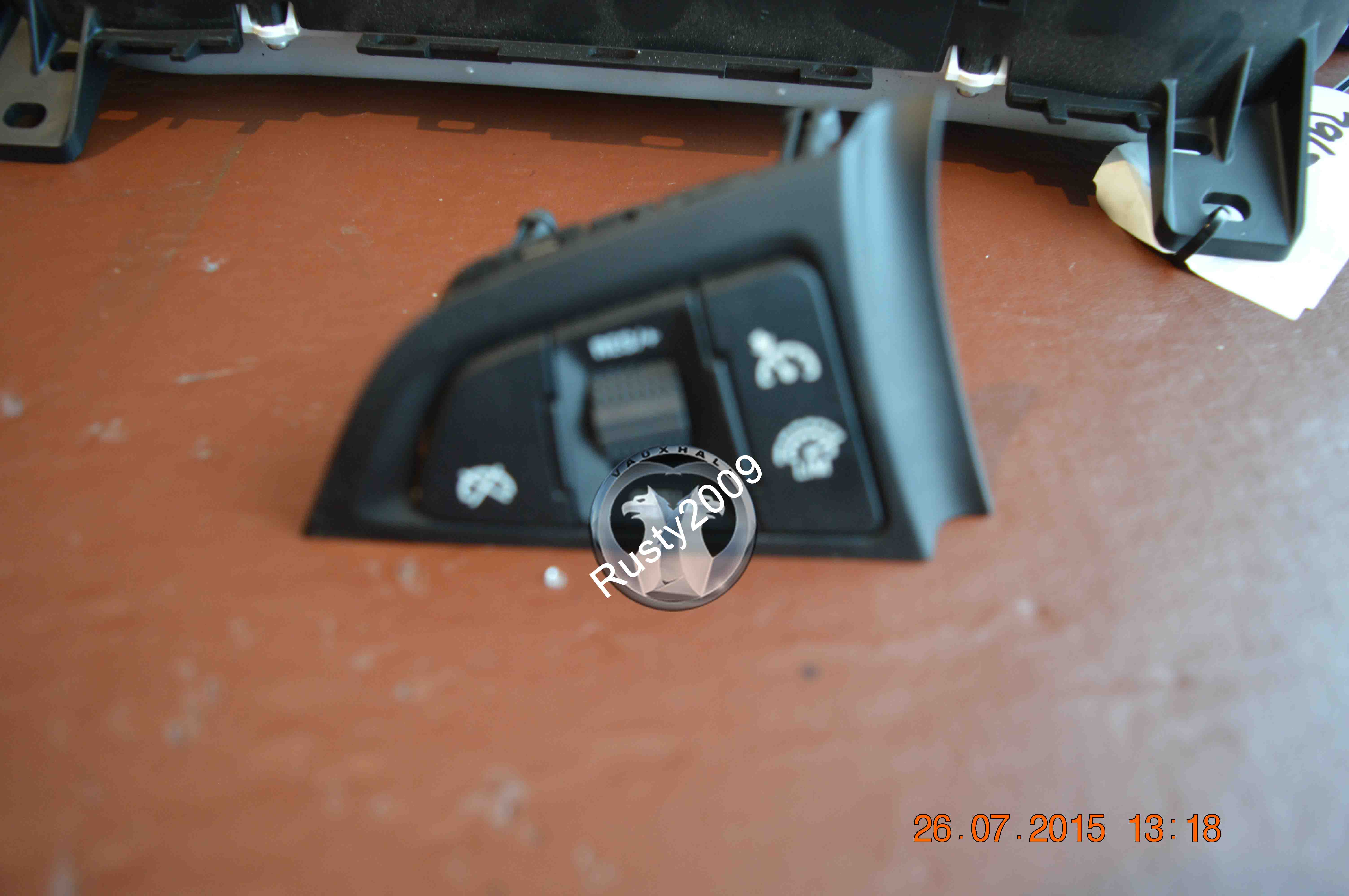

So you have the switch
[Image: 1.JPG]

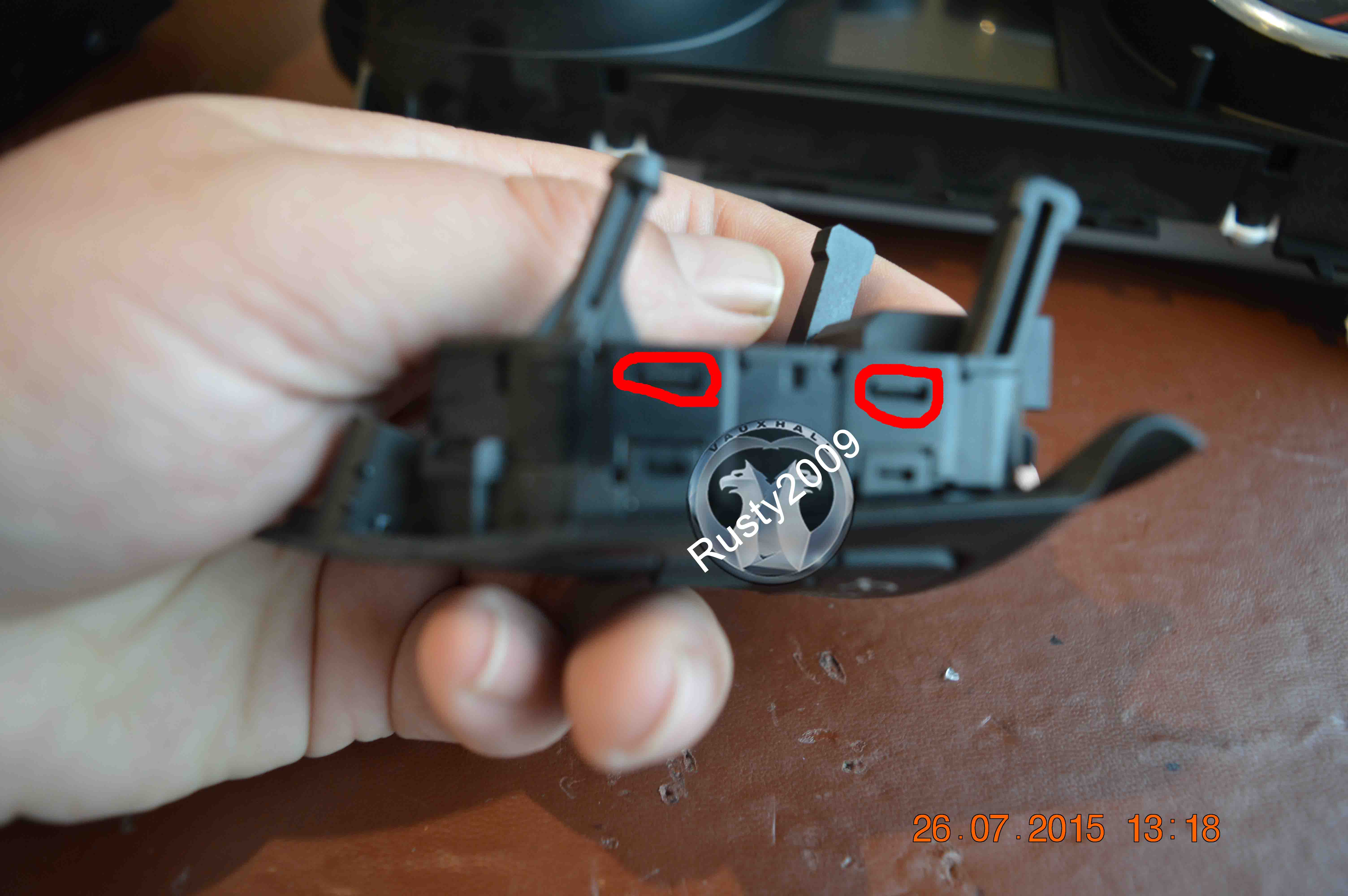

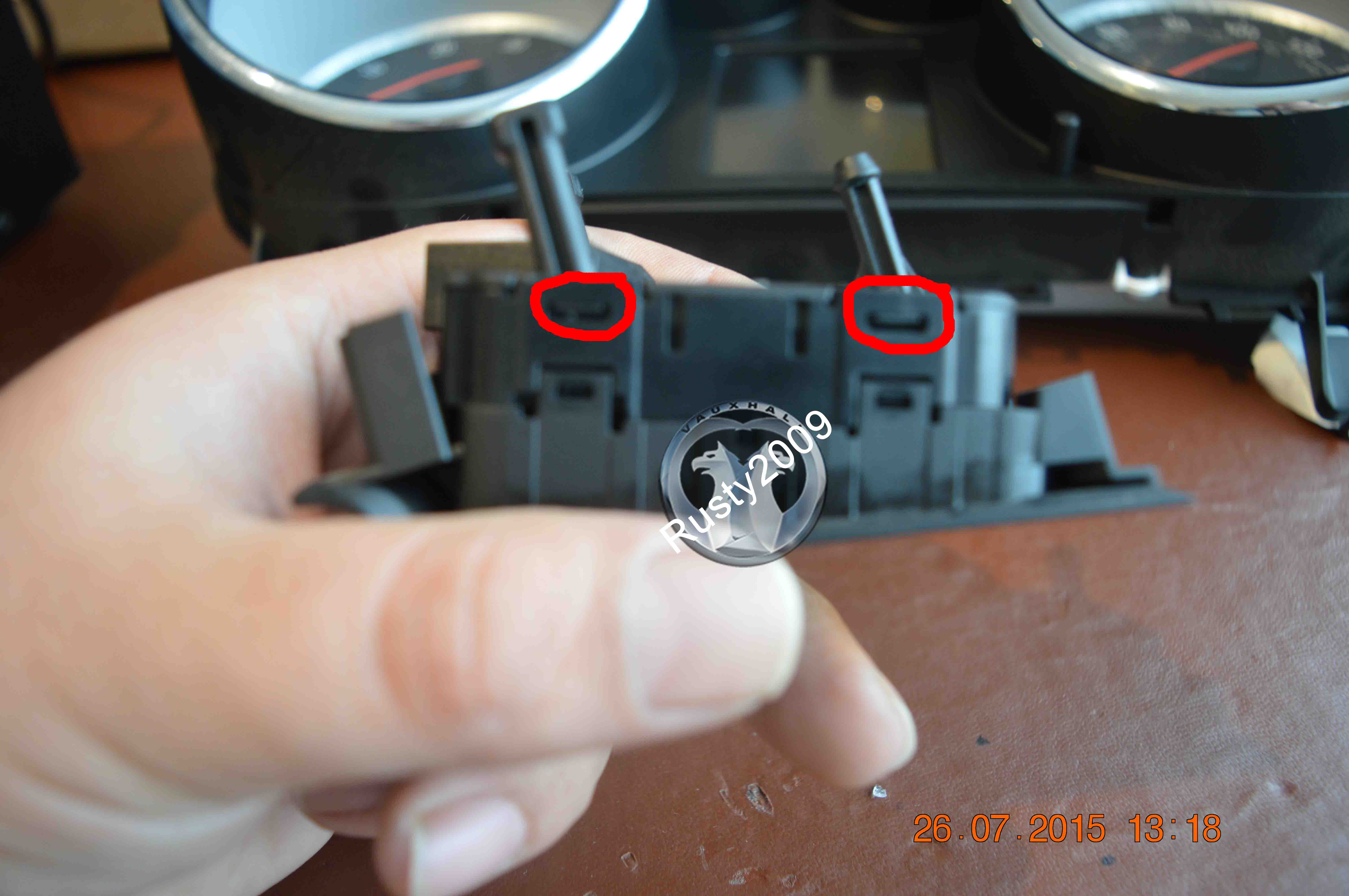

First thing we need to do is open it up, there are 4 clips 2 each side un-clip them with a small screwdriver.
[Image: 2.JPG]

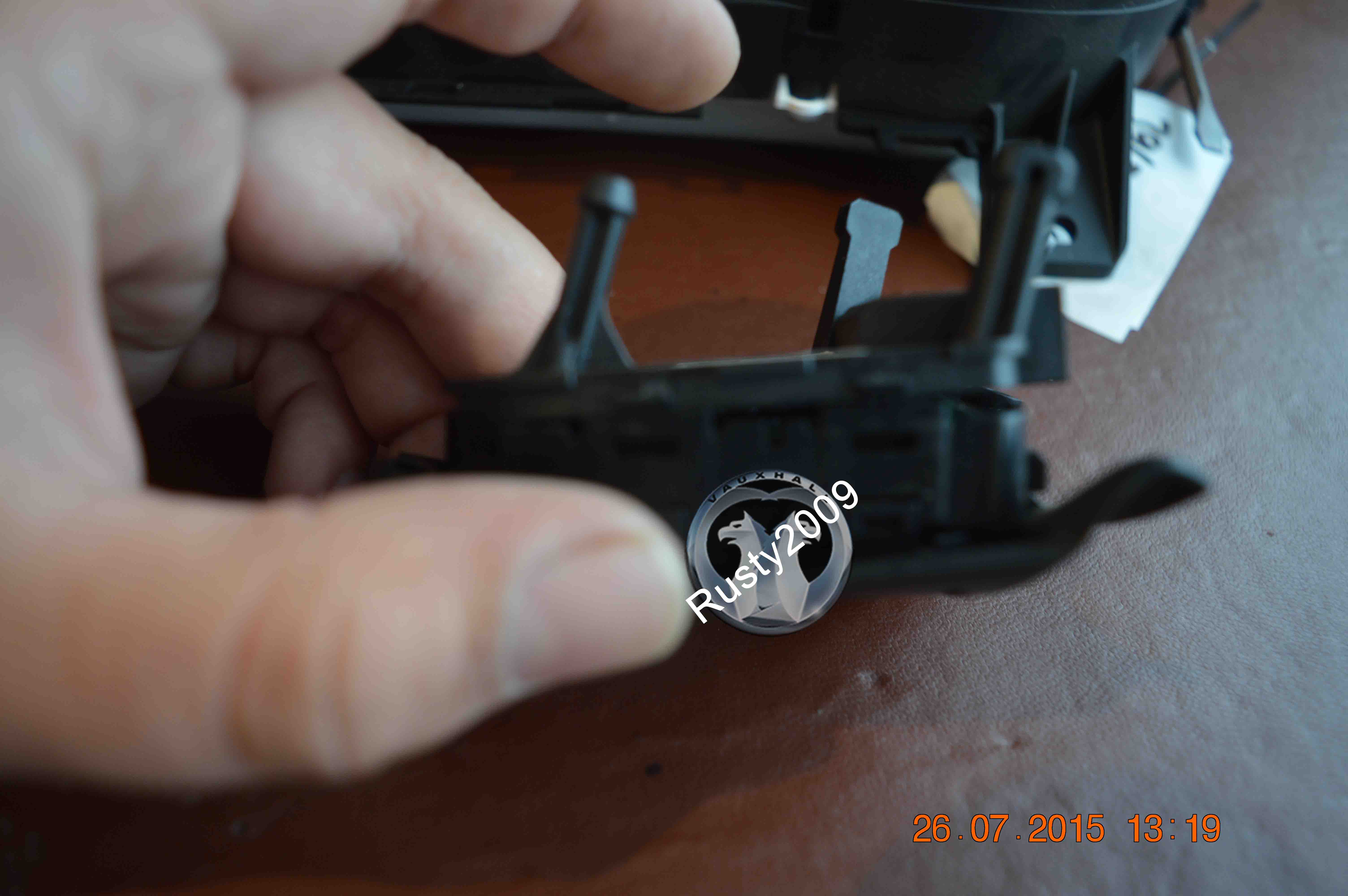

Once you've un-clipped one side you should be able to lift the backing off.
[Image: 4.JPG]

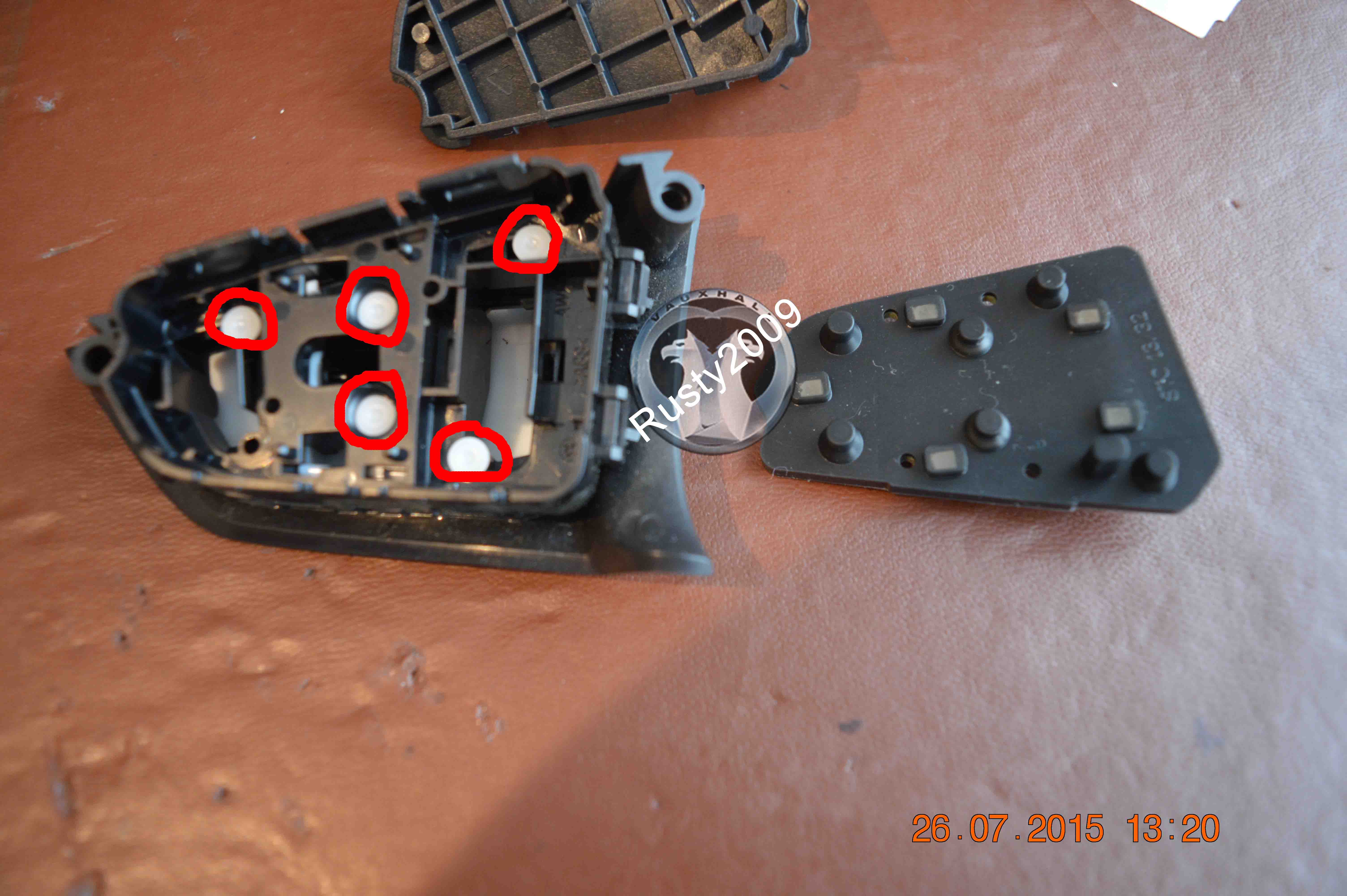

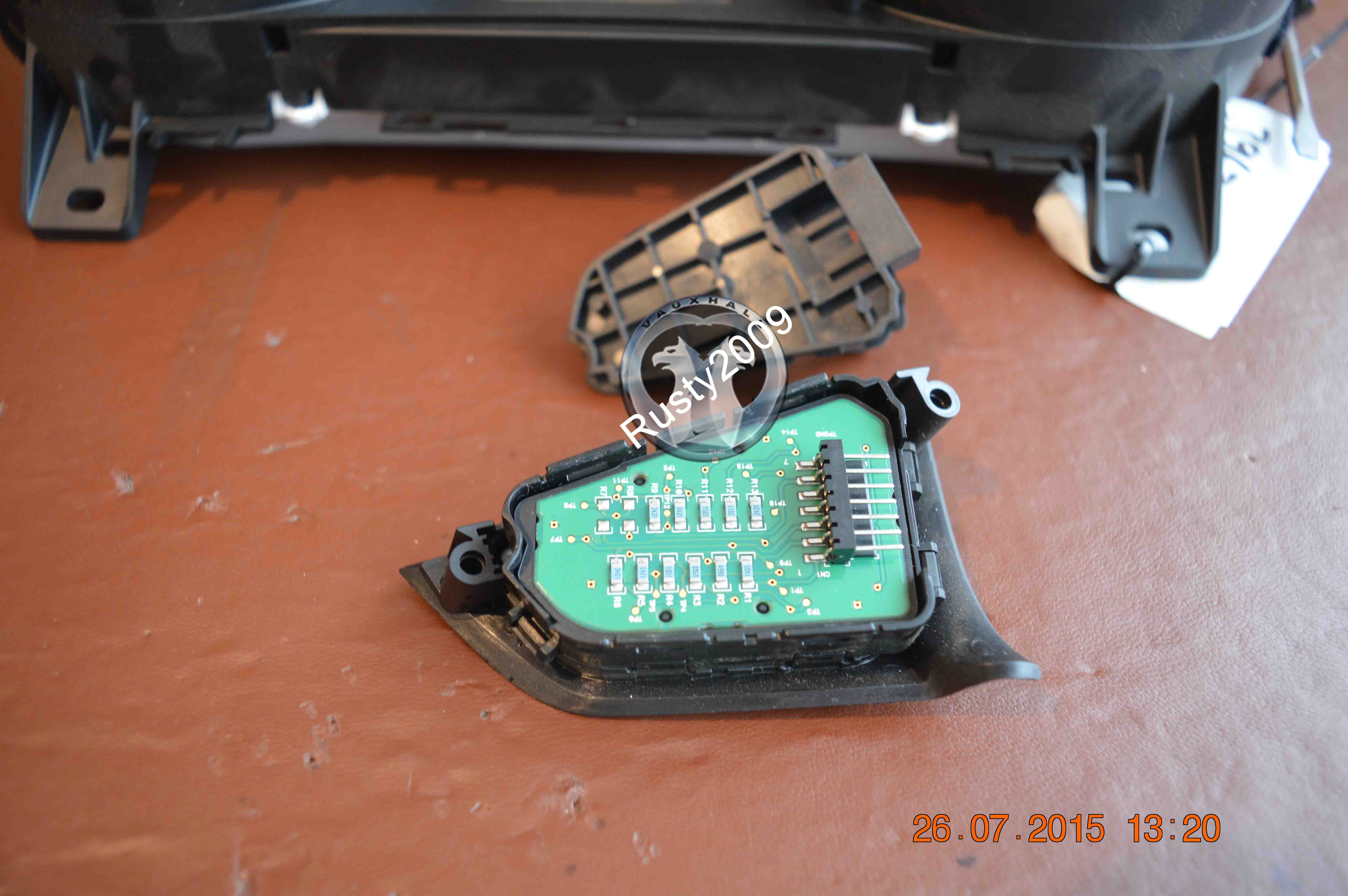

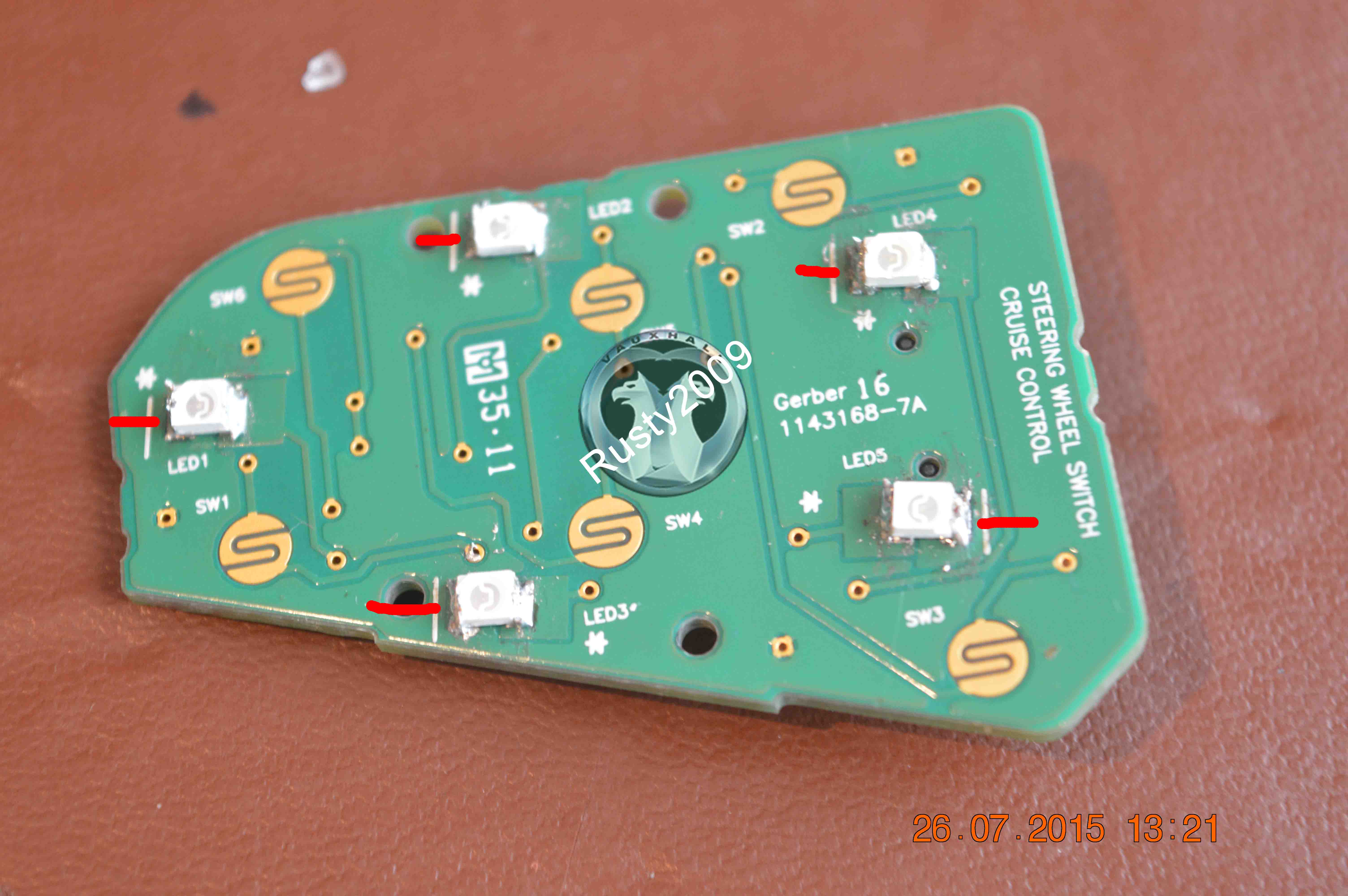

Now carefully you need to remove the PCB board and rubber cover (Not under this are little white plastic lugs which can fall out).
[Image: 6.JPG]
Next step remove the rubber and start your LED conversion. I've marked with a red line which is negative for you.
[Image: 7.JPG]
To get the correct polarity of the new LED you will see the corner is cut this is the negative end, see image below.
[Image: 21.JPG]
