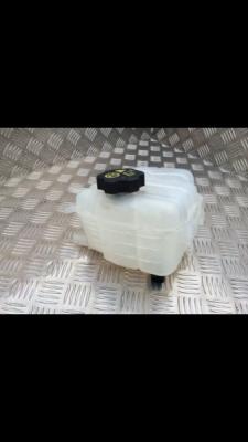

Balls :( ha. I've found the coolant tank (small clear/white tank)
[ATTACH]524[/ATTACH]
But can't find a washer tank with the sensor...
