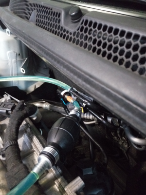

I've just changed my filter and now the car won't start, is there a way of priming the fuel through
i would say there is air in the fuel filter
graham will know but there should be a small bleed hole on the nut
I looked up on Internet, supposedly 2 solutions, either a vacuum pump to pull fuel through to the engine, or tow the car to jump start it, I don't have a pump and I was very sceptical about towing it but away me n my dad went towing my car, ridiculous that it had to come to that after just a filter change, but hooray it worked
A tow start won't work as you need the clutch in to start the car.

If you stalled after changing filter cause of air in system I really recommend to do in the next way (see attachment) so you need pump all air until fuel come on ramp. Then all steps like followed.
I primed fuel 5 times (turned ignition on but not engine) and it turned over first time!
