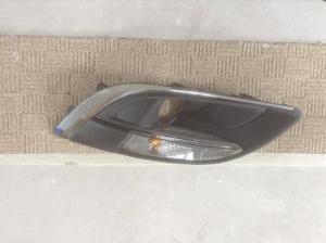

That's what I like to hear! This is something I completely want to do!!! Not sure if I'd want to just buy the bulbs that you have listed tucpal or if I'd want to go for a whole new set like these:
[ATTACH]470[/ATTACH]
If I did these ones would I need to have all the programming done before even the indicators would work?
i have the face lift fogs the ones you pictured are the the older type
Hmmmm I thought the ones I linked were just the better ones...I was after the whole thing ya see along with the chrome to go around them.
These are the ones I want actually! :
[ATTACH]471[/ATTACH]
Mine are currently like those but without the chrome
They are the ones rusty will confirm if the surrounds need to be replaced
Okay cool! Thanks mate you're not selling that surround though are you? Just the fog Light bulb ?
If you have no fog lights the surrounds will need to be replaced as they won't have the holes for the fog lights.
