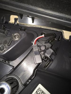

Just got my new door cards and saw this cable behind one of them...is this the LED WITH door loom that can be plugged into my door if it has the loom connector?
[ATTACH=CONFIG]325[/ATTACH]
Very impressed with the door panels though! They look the shiz! Ha, didn't realise the speaker grills had chrome surrounds too! Love that touch! Big grin
[ATTACH=CONFIG]326[/ATTACH]
yes that is it mate it is cheerer just to cut the connector off
add some wire and splice into the window switch like in the how too.
http://www.vxoc.org.uk/forum/Thread-How-...oor-lights
Oh okay, if my car has the connector built in though then why wouldn't I just connect them both up (plug them in) and have done?
you may not have the other connector on the door harness
and even if you have there will be no loom between that plug and the plug on the harness
it is and will be missing all is explained in the how to.
Ahhhh got ya! Okay thanks, will have a good read over the guide Smile

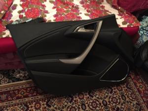

Mine are the leather ones from the elite with sort of a grey/black trim. Will take some pics later as I'm out atm. Where are you based btw?
Here's a picture I have of the front ones already...will take more later of the back ones as I say Smile
[ATTACH]334[/ATTACH]

Here you go mate, here's a photo of one of them, the other is identical. They have a few minor scratches on the bottom but that's the bit that you never see.
[ATTACH]335[/ATTACH]

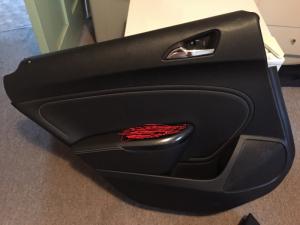

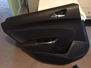

No mate the bit I colored in red is where you have just a handle (pocket) this is where the button sits too.
[ATTACH=CONFIG]338[/ATTACH]
This is the part fitted for elec rear windows
[ATTACH]339[/ATTACH]
If you check your door you see what I mean.
Ahhhh I'm with you! I was thinking it would be a completely different arm rest design to make way for the buttons! But I know what you mean now Smile so you literally just made a hole for the winder then?
