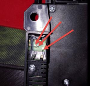

Here's the cd400/navi control pinout. the CD400 is (UAG).
(23:rd-Jul-2016, 07:14:30)Rusty2009 Wrote: Here's the cd400/navi control pinout. the CD400 is (UAG).
Thank you Rusty now I have to see were the pin connector 2 goes to the ISO connector. I believe that on a CD500 model the ISO pin number is also different. Now I know that nr 2 needs to go to my CANBUS and need to find out were it goes on my ISO. You might have that info for me also and really thank you so far almost getting there :-).

Your issue is you are going to a unit that is built to work from a CD400 unit set-up.
You will not be able to make the cd500 controls work with a cd400 setup the same way you wouldn't be able to make cd400 controls work with a cd500 setup.
CD400 control panel only has 3 pins on it Power, Ground and Network Bus.
CD500 control panel has 7 pins on it Power, Ground, Wake-up, Reset, Data High, Data Low and Data Shield.
The screen is also wired different
cd400 screen has 8 wires Power, Ground, Network Bus, Wake-up, Reset, Data High, Data Low & Data Shield.
Cd500 screen only has 4 Power, Ground, Dimming & Remote Enable.
