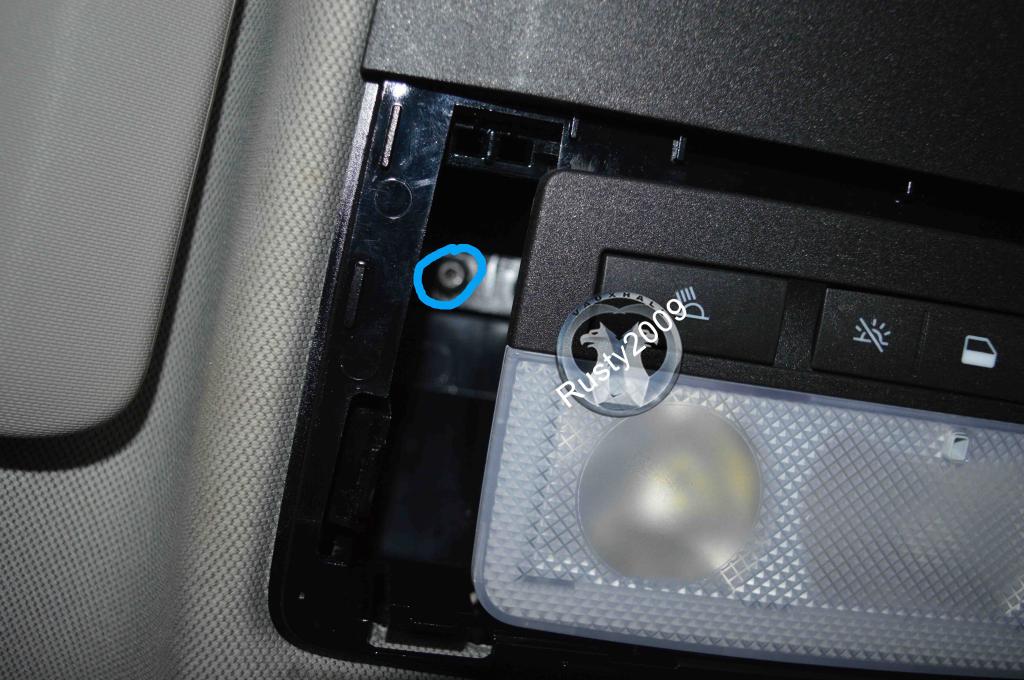

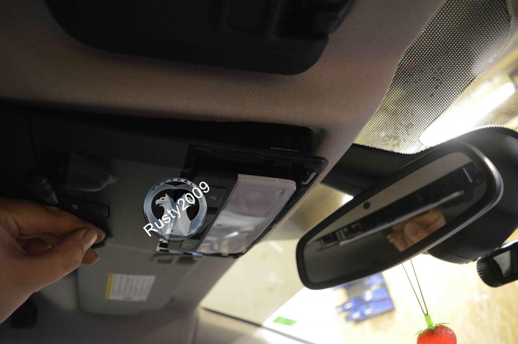

1. remove the trim from around the light
2. Then undo the trox screw on each side
3. allow the console to lower slowly,

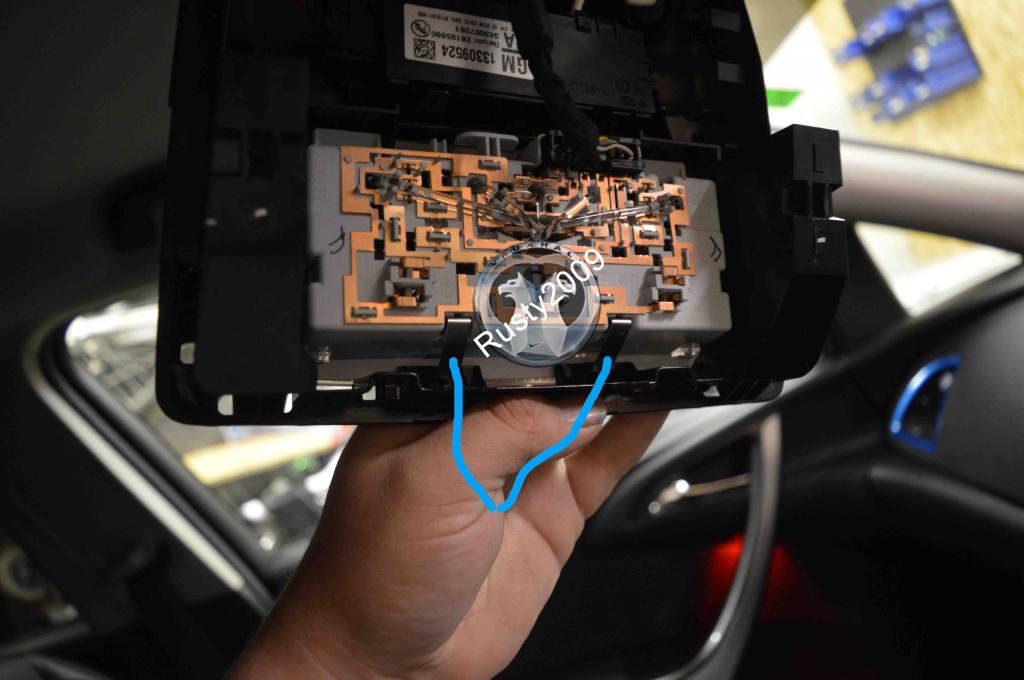

4. Then push the two metal tabs in and the light will pop out (you may need to push it downwards a little).
