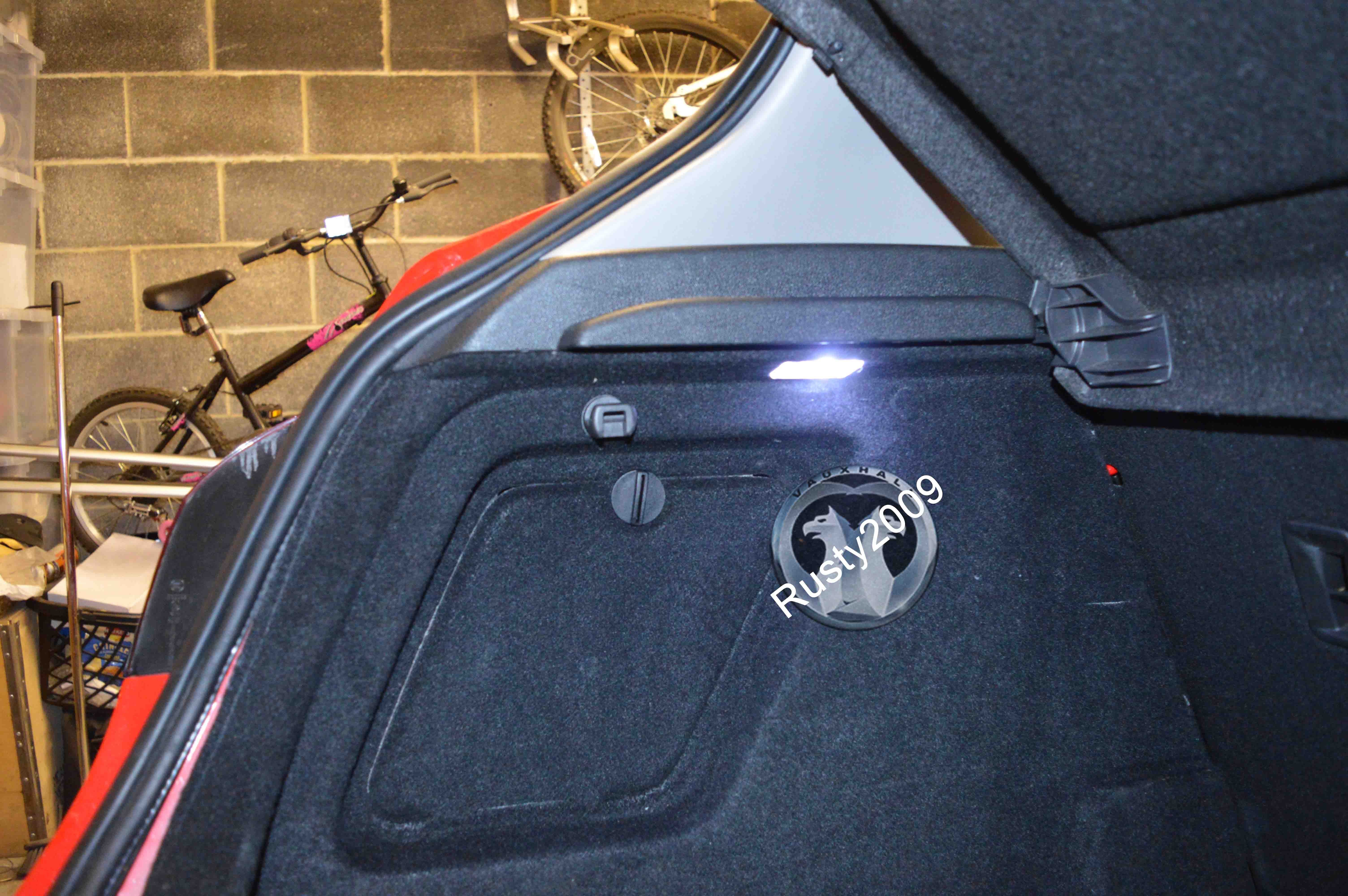

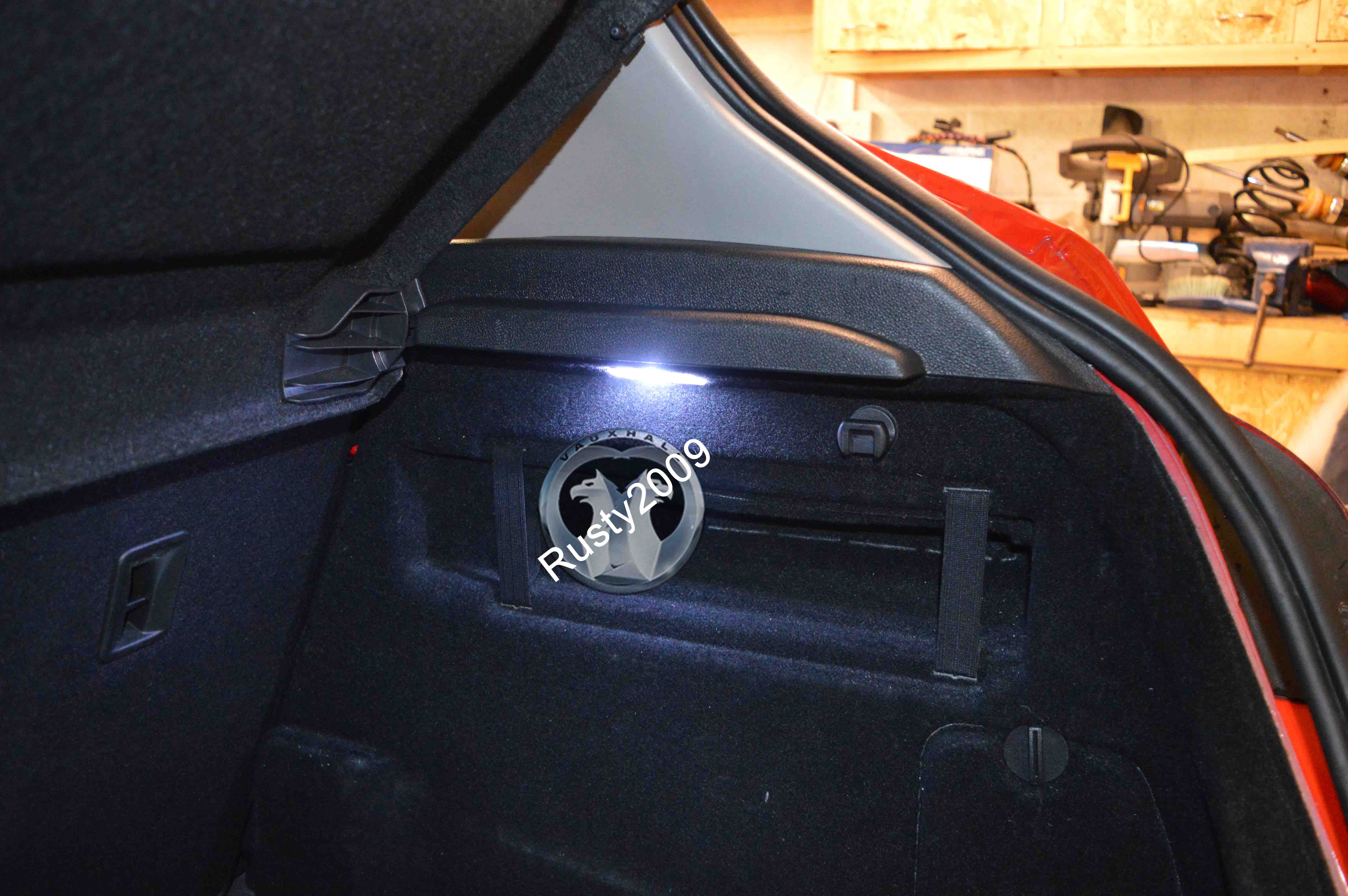

How-to Extra Boot light.
Ok so first of all you need to feel along the top of the side trim, you will fell there is plastic behind it but as you move along you will feel there is a bit you can push in.
[Image: 1.JPG]

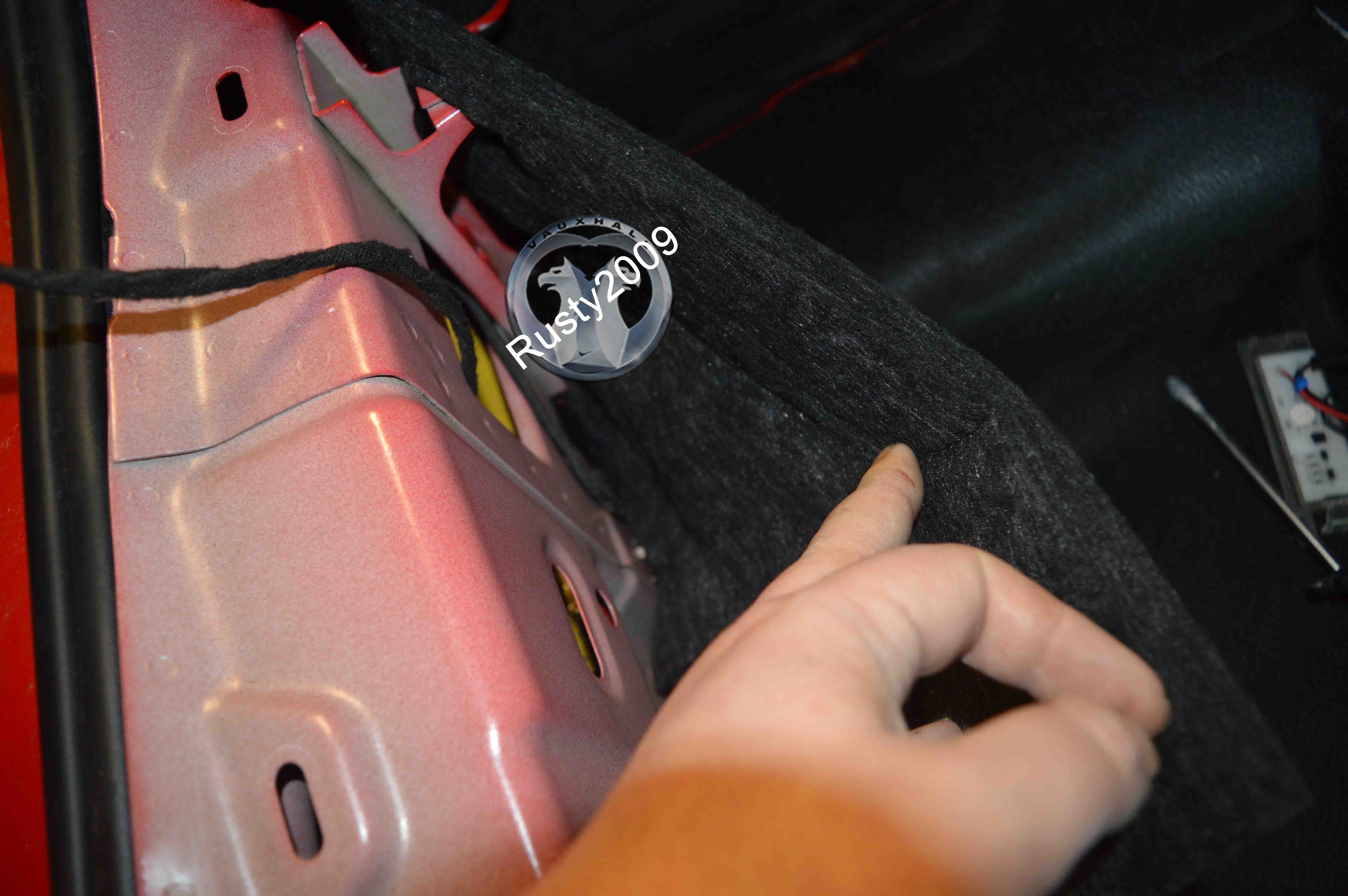

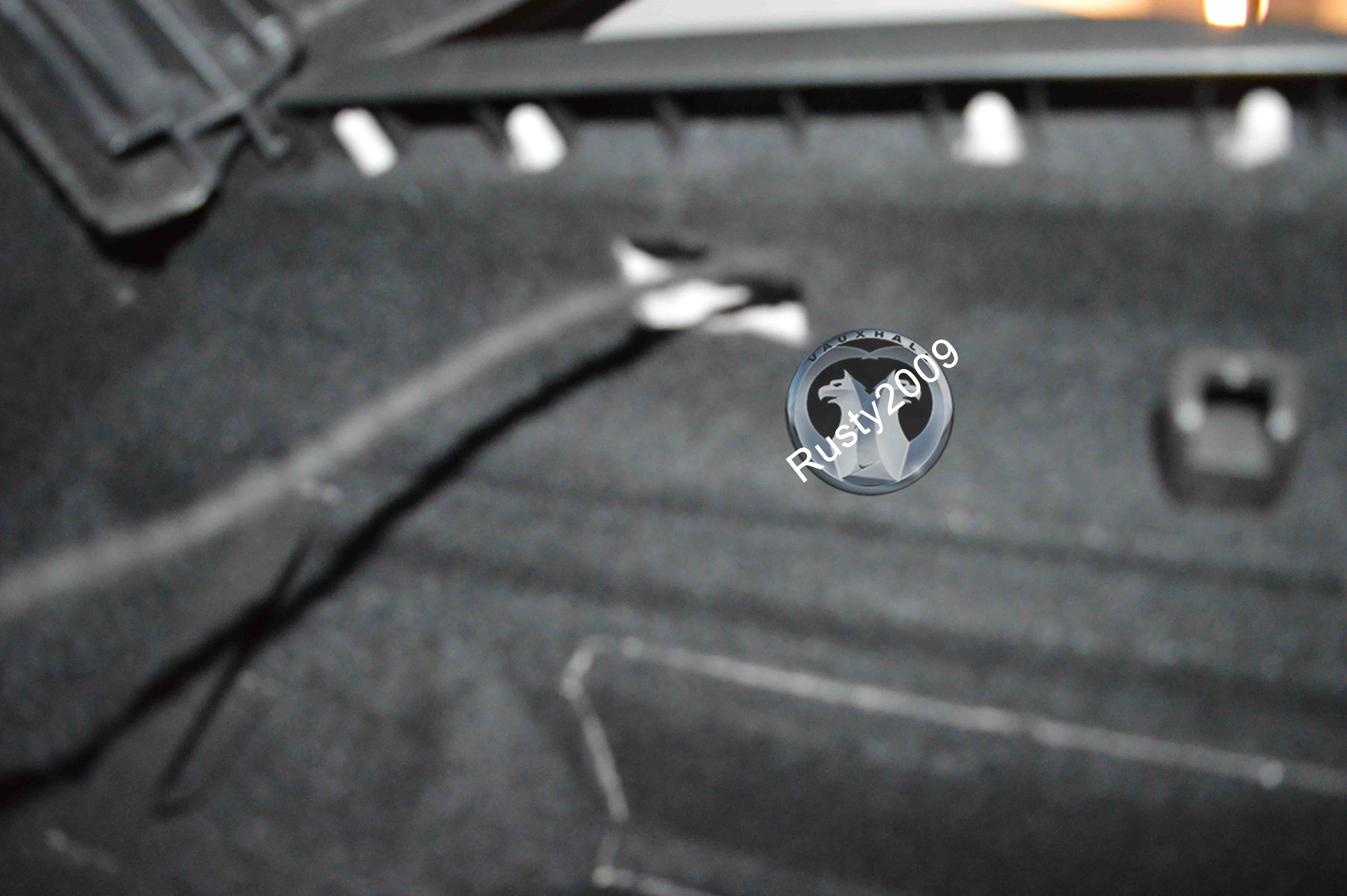

Once you found that area you can start to cut (DO NOT CUT IT ALL WAY) do a small bit to begin with and then slowly make the hole bigger as you go just use try the lamp as you go.
[Image: 2.JPG]

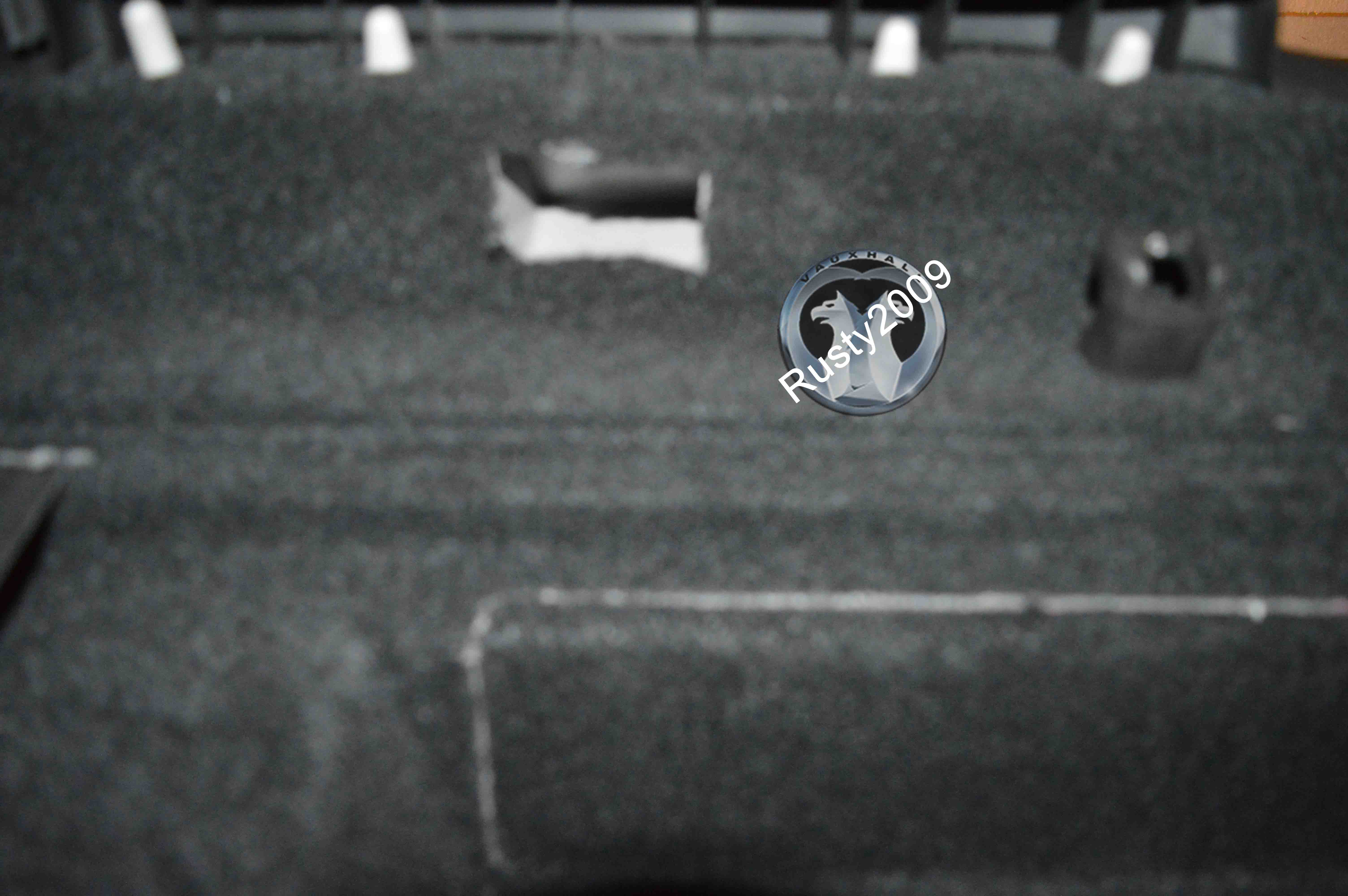

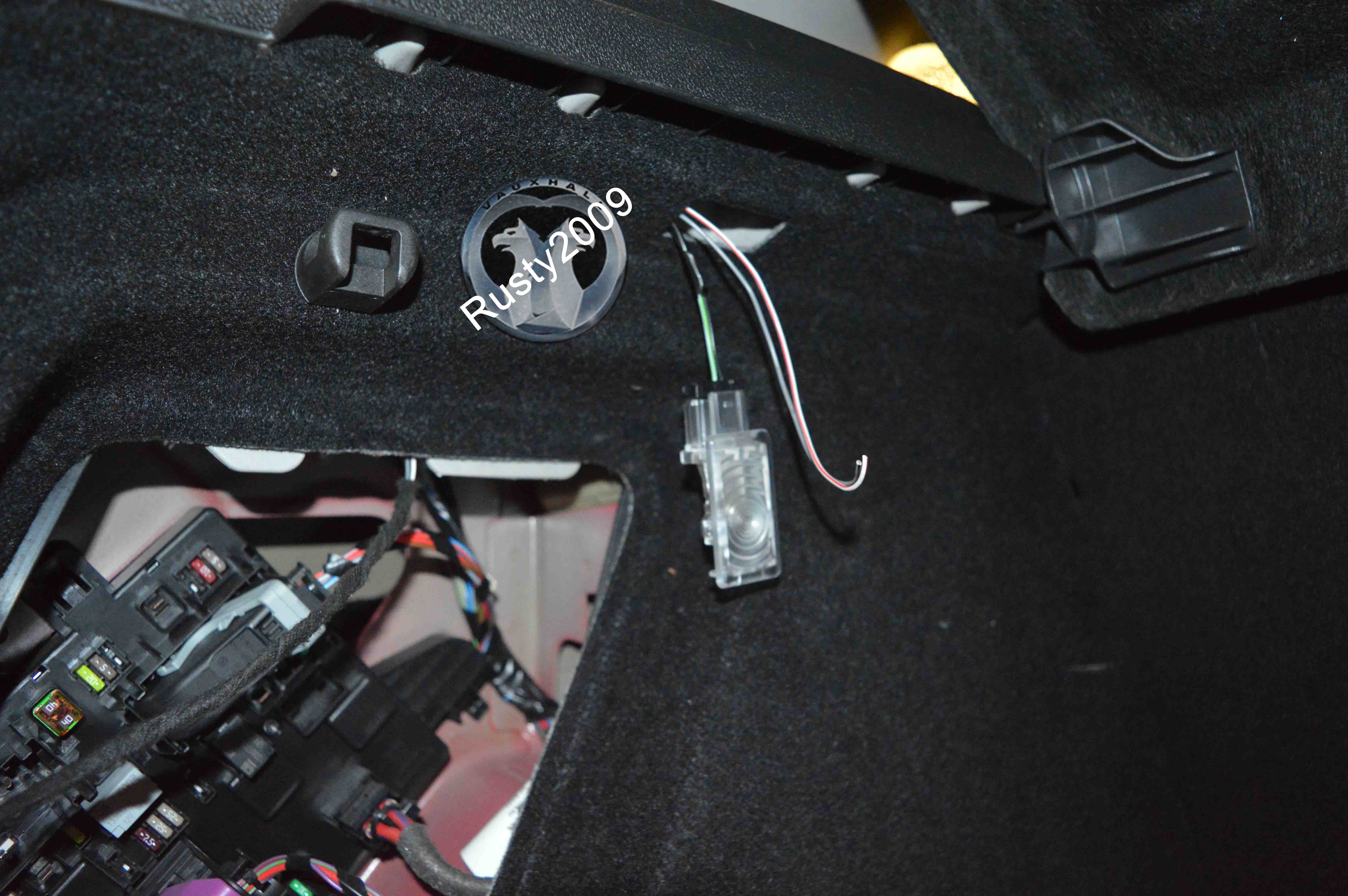

Then make a loom up and feed it through the hole down and down into the hidey hole.
[Image: 3.JPG]
[Image: 4.JPG]

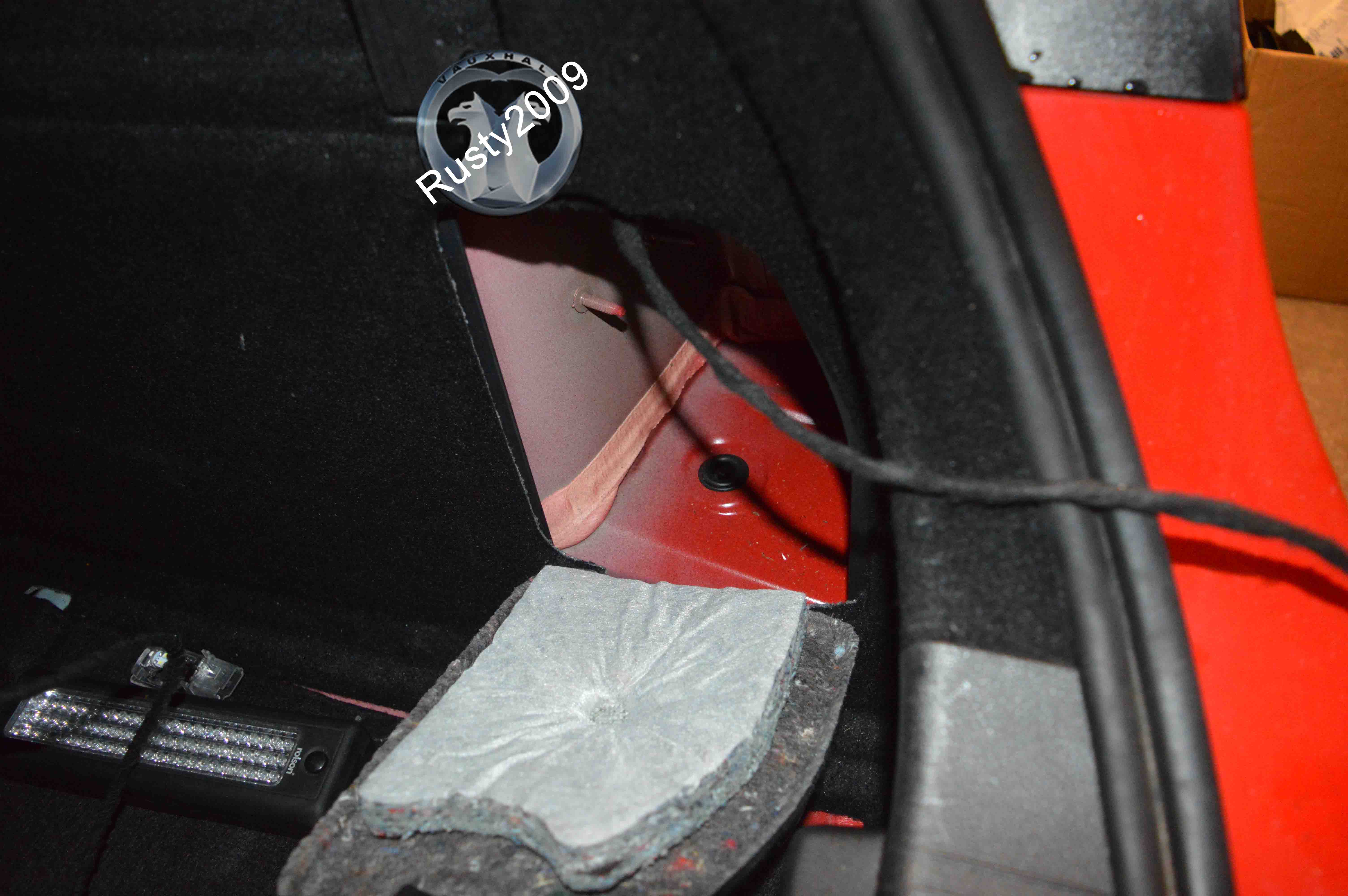

Next remove the rear boot trim, To do this pull the rubber off and then pull the bottom of the trim in towards the front of the car, then using a trim tool lever the top off.

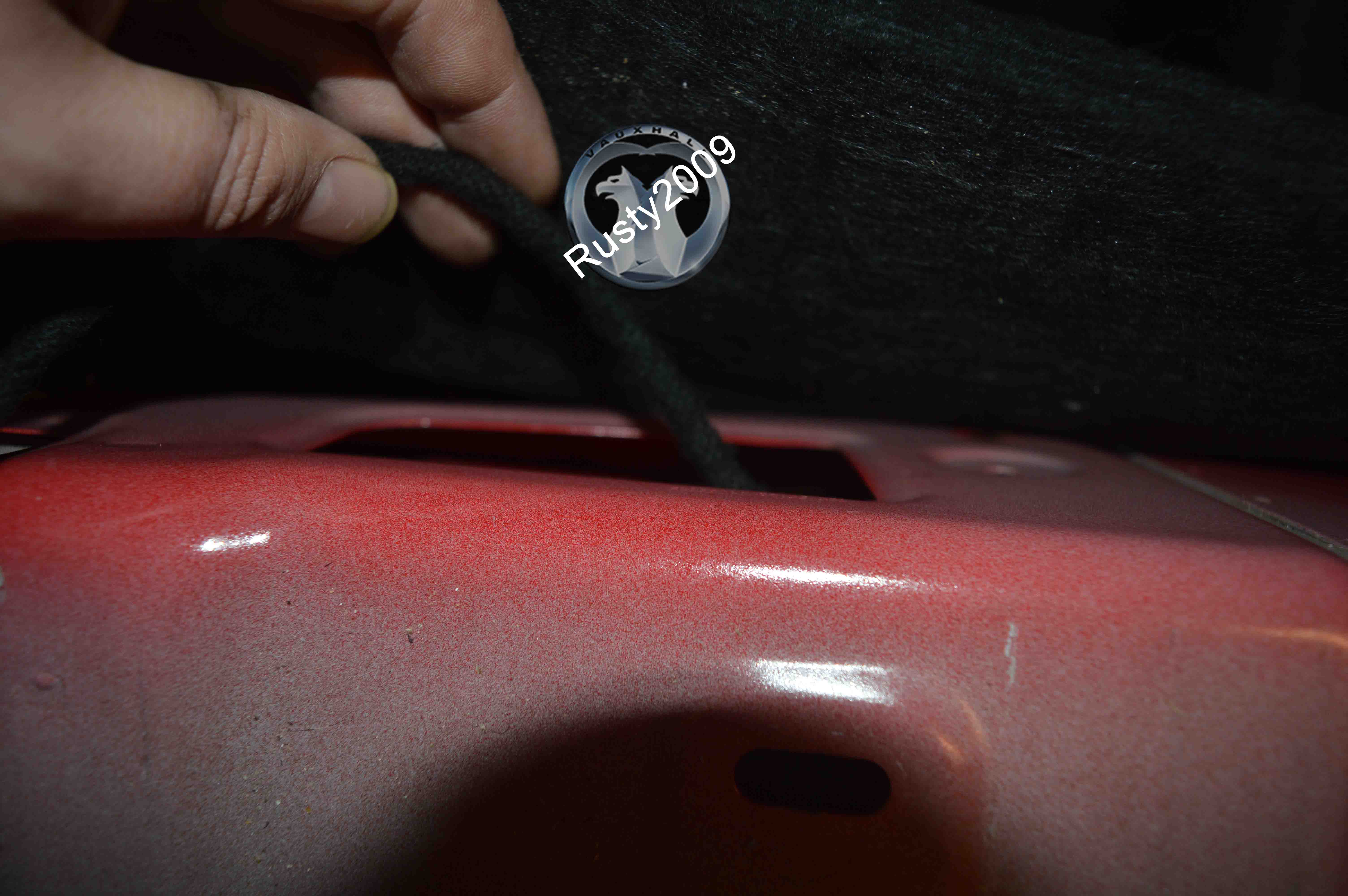

Then feed the loom behind the side trim and work your way along (Sorry not many pics here as some bits you can't get pics of).
[Image: 5.JPG]
[Image: 6.JPG]

Pop your lights back in and hey pesto extra boot light is installed.

Nice tutorial mate! Smile gonna try and tackle this tomorrow I think if the weather is still nice! With the first bit though when you say to feel at the top of the trim and push something in, what are you referring too and why does this need to be done?

Where the light is pop it unplug and run your hand along the length you will notice there is a cutout in the plastic behind the trim for the light, then it should make sense.
My very first picture was taken as if you were laying down look up.
Hmmmm struggling to understand where that is or why I'd need to do it but wills see tomorrow when I tackle it Smile thanks dude
