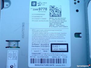

1 - is here any way to recognize on the picture is the 950 or i can only trust, the seller is not mistaken?
2- by "setting up" u mean programing by diagnostic cable? Setting VIN or something? If yes. What is the correct cable for that. Unfortunately, i have cables for PSA, Renault, Ford not for Opel specifically.
Is there any chance to read from this pix, if this is the 950?
That is a 950 yes
