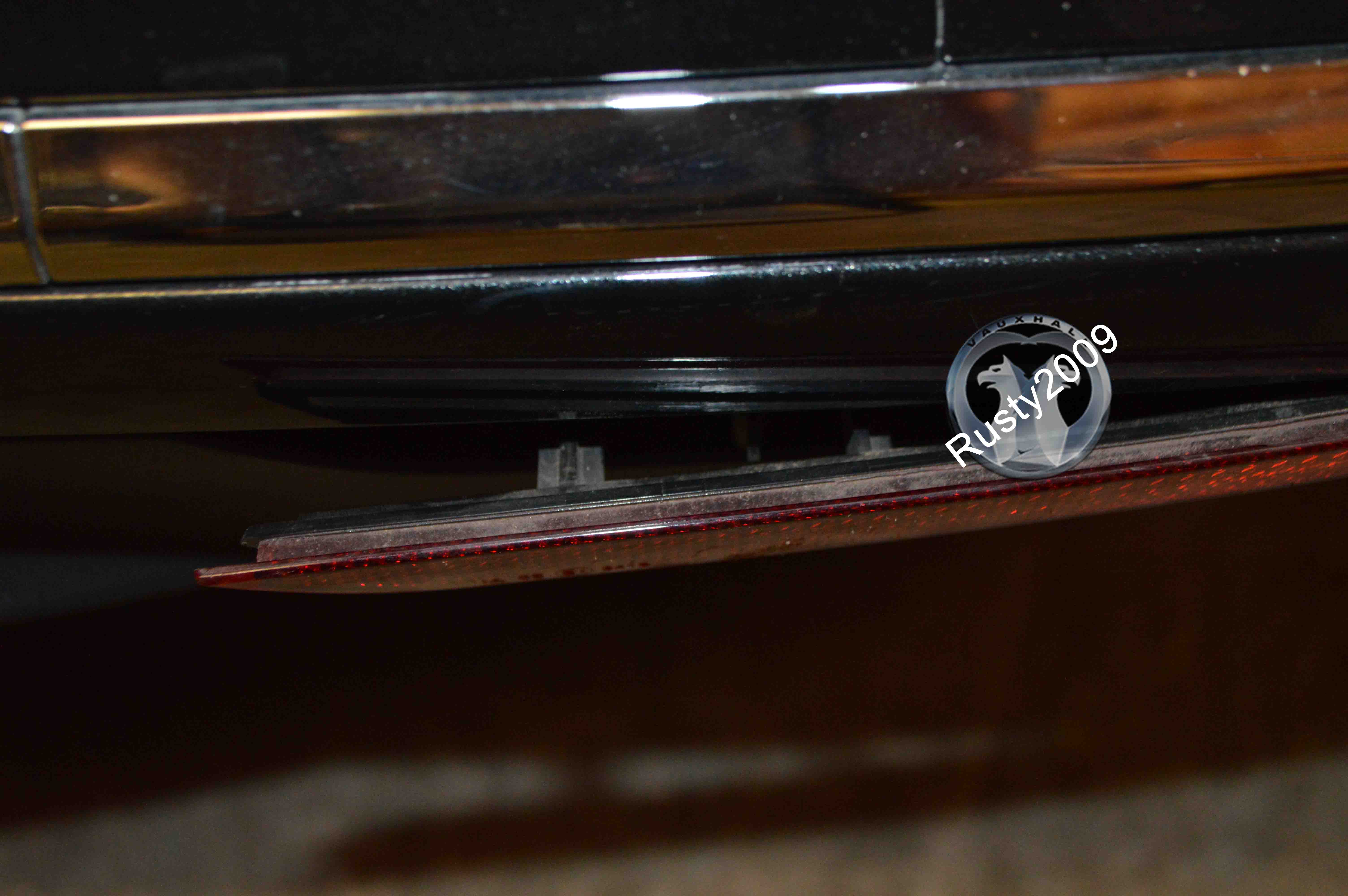

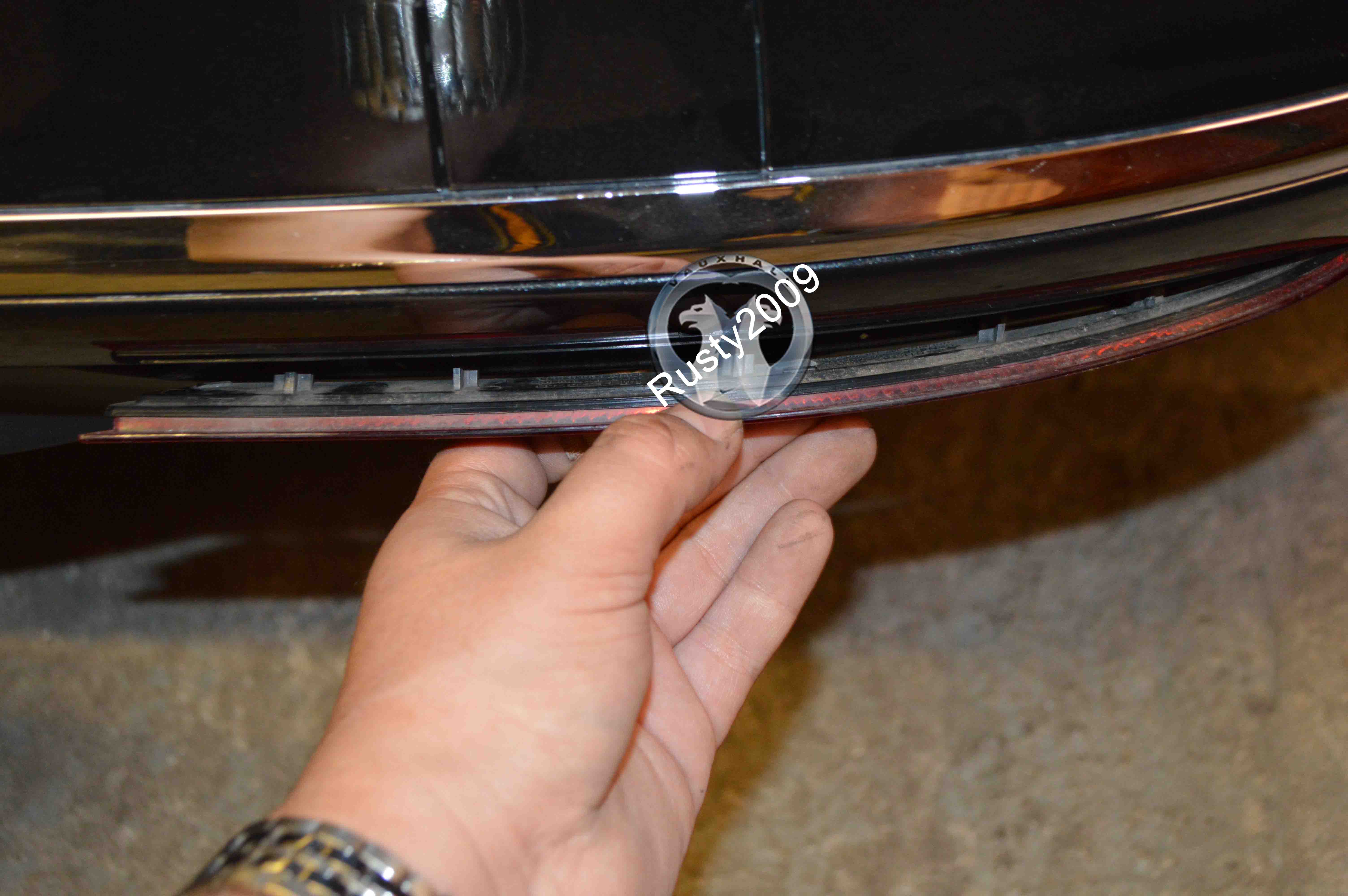

The best way to do this is to stick you hand up behind the bumper and feel for the two push tabs, as shown in the below pic.
Once you have found them push one in at a time and push it forward (towards the rear of the car).
and it will start to come out like so.

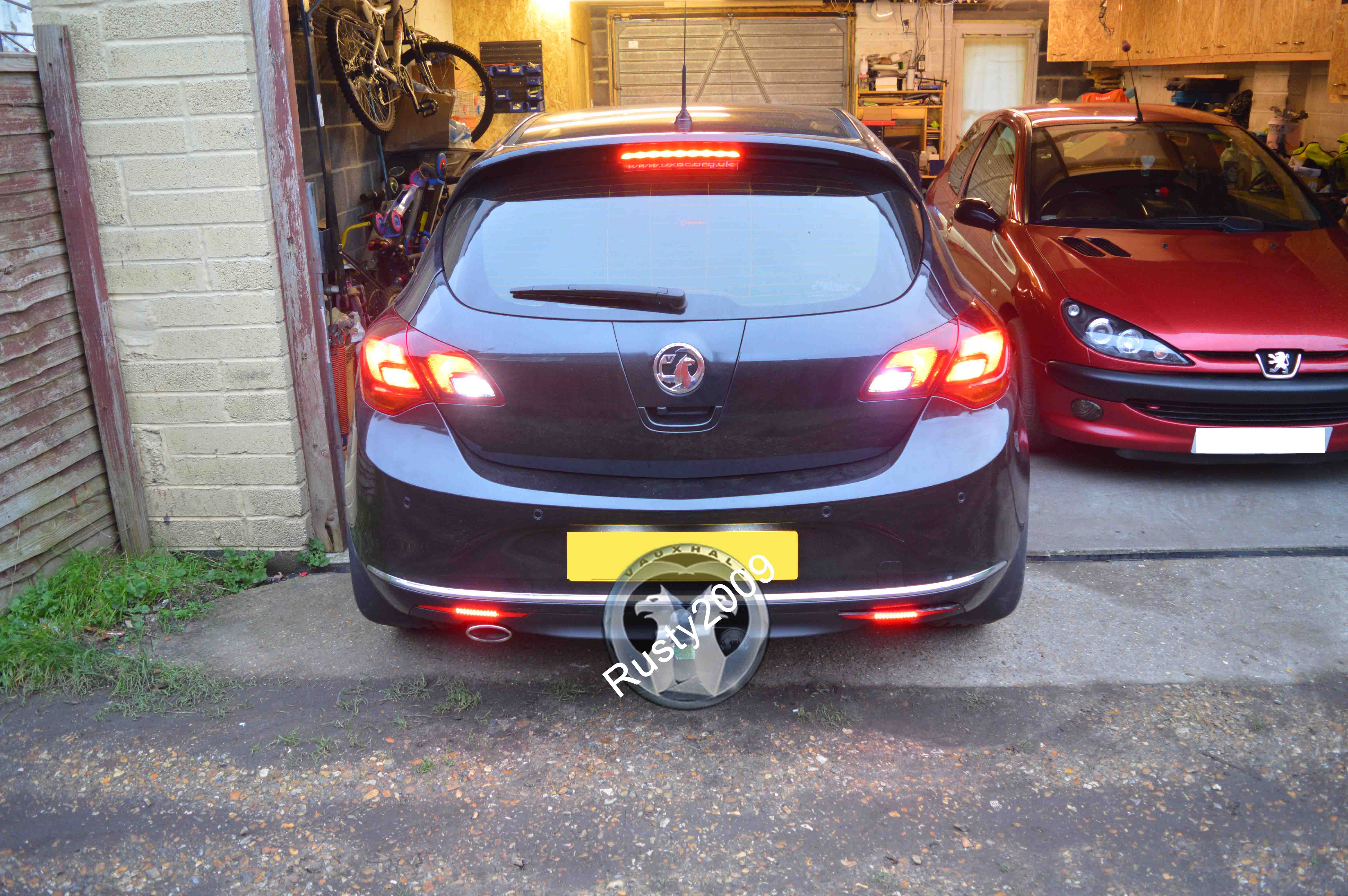

it would be a good idea to drill little holes in the back of the reflectors and fit some LED.s in them
and rig them up to the high level brake light

tucpal Wrote:it would be a good idea to drill little holes in the back of the reflectors and fit some LED.s in them
Sounds good :P but would it be legal?
i don't see why it would be
here is a link but he rigged them up to the indicators
the high level brake light would have been a much better option
Looks good on the reflectors :-p
Like this mate
i may have a little play with this in the summer
tucpal Wrote:i may have a little play with this in the summer
How-to here http://www.vxoc.org.uk/forum/Thread-How-...reflectors
