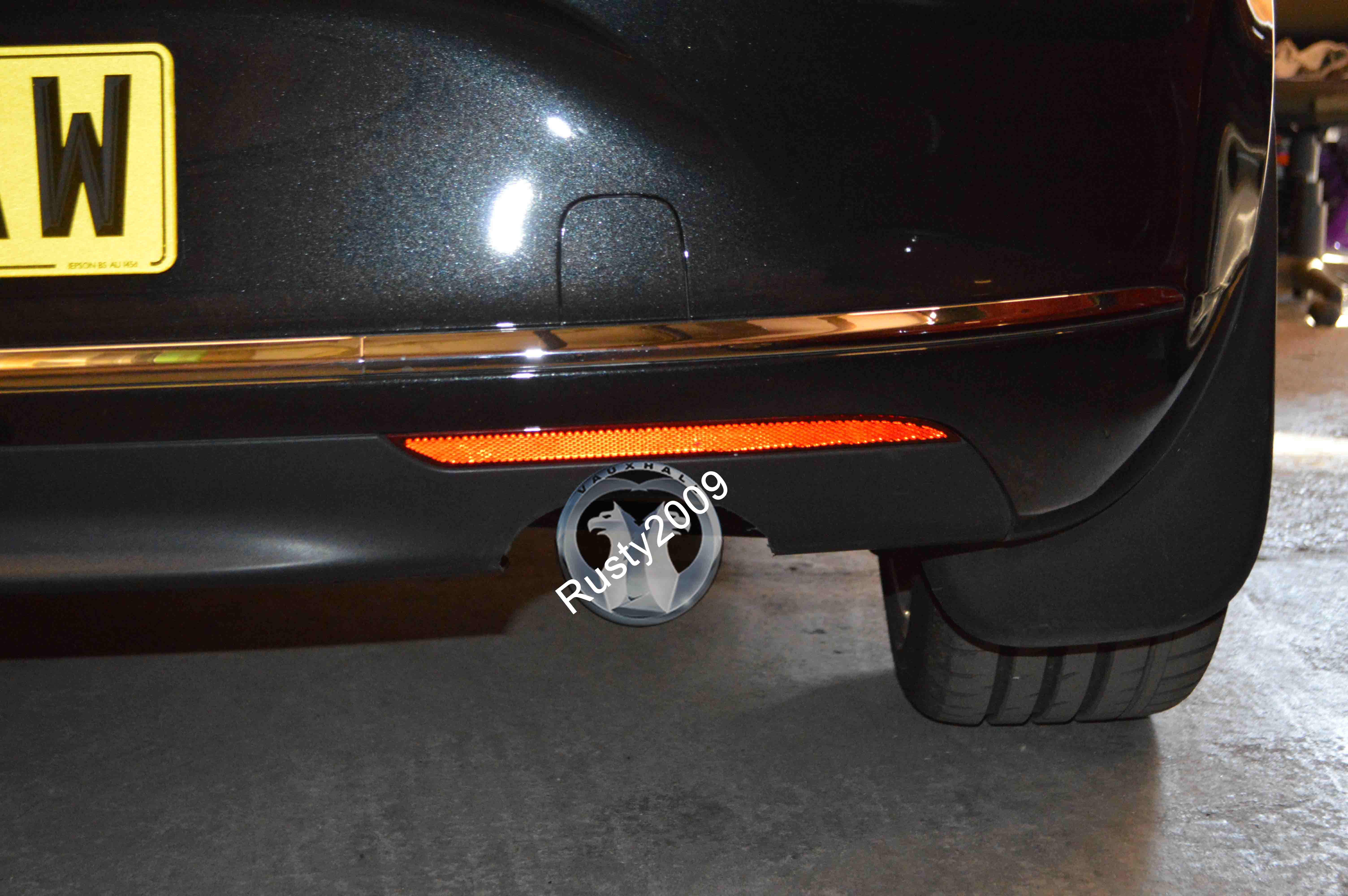

How to remove reflectors from the rear bumper??.
The ones just above the exhaust on this picture? I want to wrap them black

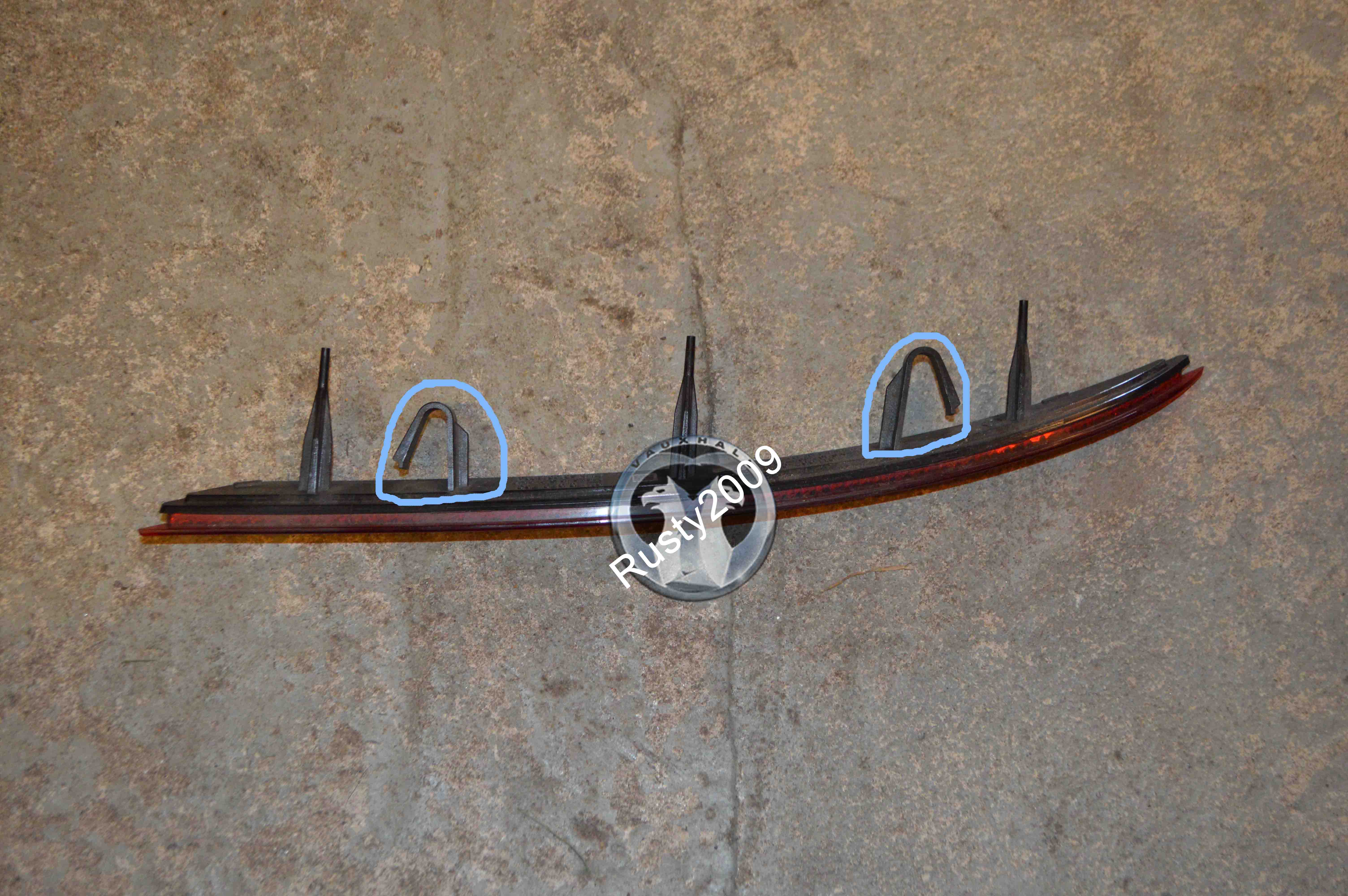

The best way to do this is to stick you hand up behind the bumper and feel for the two push tabs, as shown in the below pic.
[Image: https://www.vxoc.org.uk/Images/rusty/How...tors/4.JPG]
Once you have found them push one in at a time and push it forward (towards t

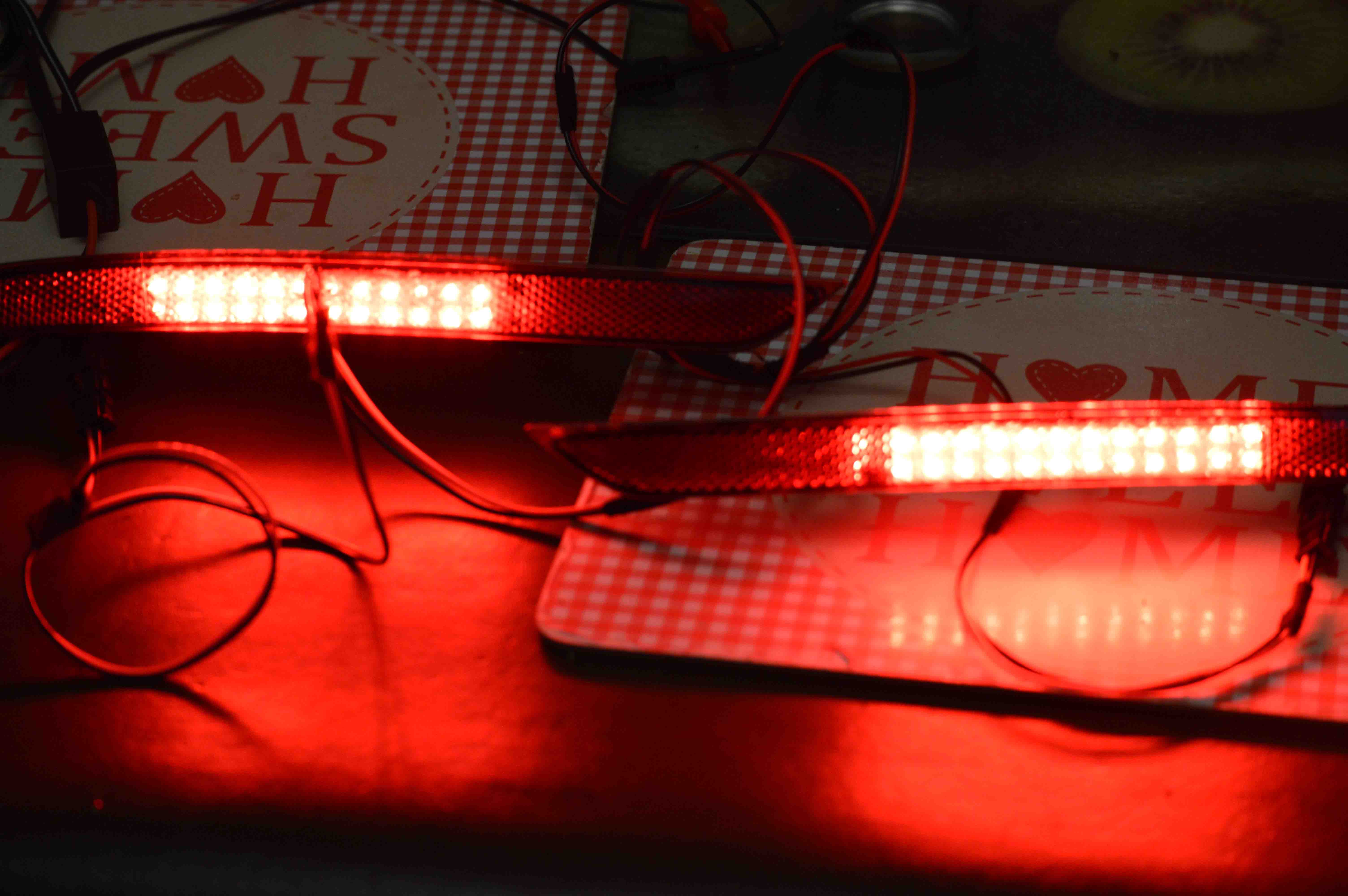

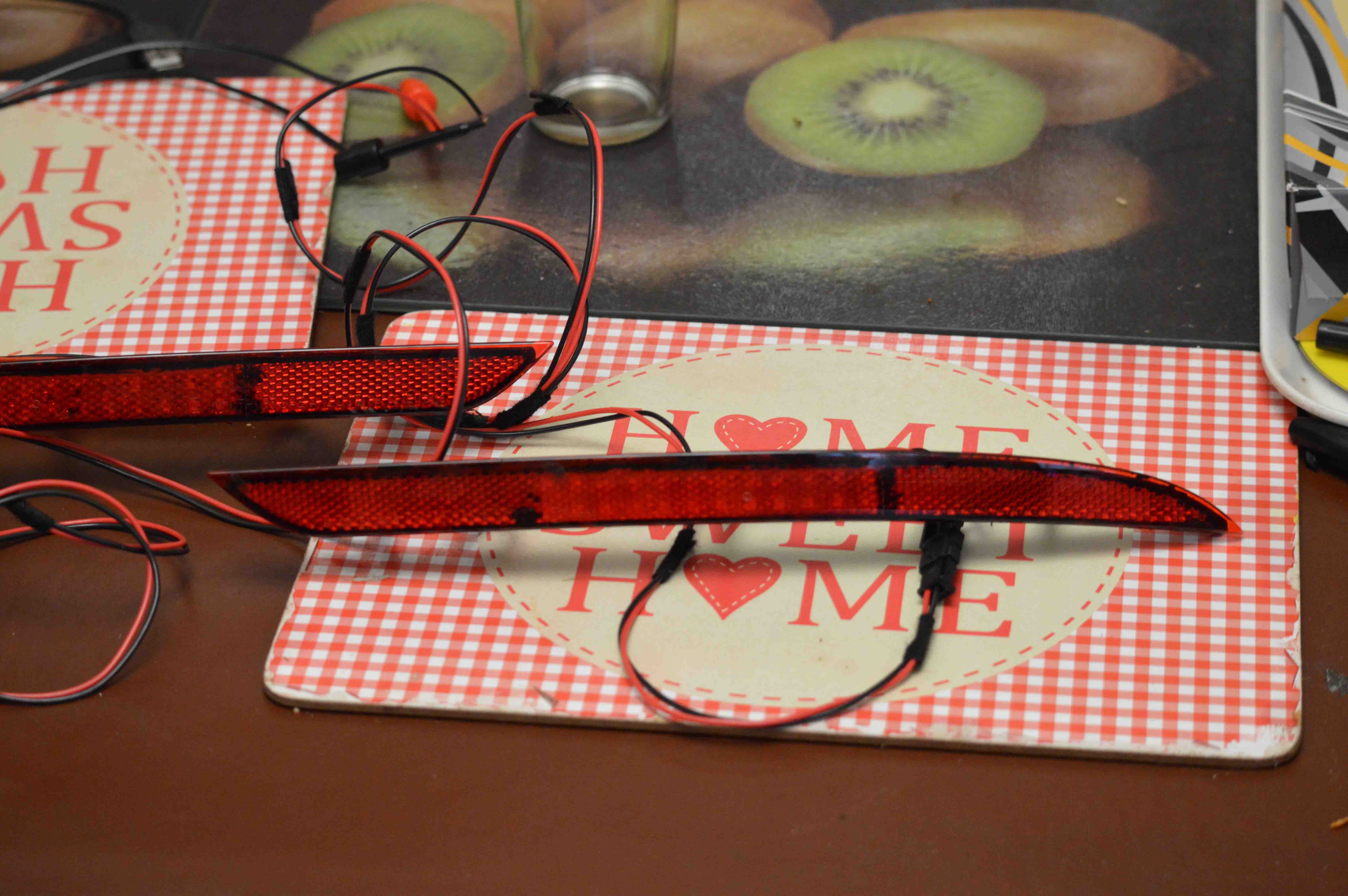

How-to LED rear reflectors
How-to LED rear reflectors.
You will need the following items.
1. A pair of reflectors.
2. A Stanley knife with some Sharpe blades.
3. Plastex (CLEAR) you can buy it here http://www.repairproducts.co.uk/page20.htm
4. A pair of RED LED strips [url=http://www.ebay.co.uk/itm/171505511260?_trksid=p2059210.m2749.l2649&var=470532550287&ssP
