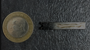

At below video, I tried to explain how the remote start/stop system, that I bought and installed, works on my car.  Also, I tried to show how the kick sensing system on the tailgate lift. This kick sensing system has been done by myself.
BTW, the video is in Turkish, sorry for it in advance.
As a summary, the system package (Keyless entry and remote start/stop system) is compitable with Opel Astra J Mk6 models. It's just a plug&play system that I purchased from Aliexpress (product links are given at the buttom of the video).

Hi, i am new in this forum. Quick question about the AM start&stop:.How does work the mechanical lock on the steering wheel?? Normally it is lock if you turn the steering wheel without the key and unblocked when you insert the key
(13:th-Jun-2021, 23:38:38)oliv.cleiton Wrote: Hi, i am new in this forum. Quick question about the AM start&stop:.How does work the mechanical lock on the steering wheel?? Normally it is lock if you turn the steering wheel without the key and unblocked when you insert the key
Hello there,
There is a car key shaft in the start-stop kit, you insert it and turn it, there is a (google drive) link under the youtube video, you can access the pictures from there.https://www.youtube.com/watch?v=GsB9Kv1N4dY
