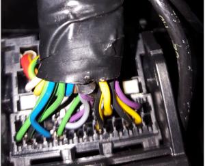

You can also see other pictures of my original screen connector. But there goes only one wire to that connector from the Android CANBUS system and normally that works for a CD400 model. So i hope if there is someone who can help me out whit this wire diagrams.
And this is my original ISO connector from radio:

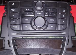

You need to swap wires around between the screen and control panel & also at the main radio plug.
(3:rd-Jan-2017, 11:52:55)DNT Wrote: So did you find a solution to this? I m also interested in replacing my factory CD500 with an aftermarket one.
Yes I found a solution for it but it cost time and maybe a CD400 control panel. I contact seller from Aliexpress aswell and he send me later a CD500 wirebox and if you could compare it whit a CD400 wireunit+CANBUS there the difference is only 2 wires that goes from radio unit to the controlpanel. If you have the CD500 wires+CANBUS whit a CD500 control panel and the android radio the panel will power up and the buttons will function but not all the buttons functioning correctly because of the firmware of the CANBUS what is normally compatible whit a CD400 control unit. So I bought a used CD400 controlpanel from Ebay for 45 EUR and replaced my CD500 controlpanel for full funtionality. So yes you can make it work because now you don't need to find out what to do :-).

That's great! So you just replaced CD500 button panel with CD400 button panel? You didnt use the CD500 wirebox with canbus that the seller sent you?
(13:th-Jan-2017, 22:22:51)DNT Wrote: That's great! So you just replaced CD500 button panel with CD400 button panel? You didnt use the CD500 wirebox with canbus that the seller sent you?
Wiring changes has to be made.
The cd400 is wired totally different to the rest you need to make your wiring match a cd400.
The cd400 buttons will then work, you can't make the changes and expect a cd500 control panel to work.

So is changing wires and make them match a CD400 a difficult task to do? Relocating 3 or 4 cables in the factory iso connector wouldn't be a big deal but if it is needed more than this then it would be nearly impossible to make it. Maybe Amir Khezri could enlighten us about the alterations he did
Ok, answering to my question , all you need to do in order to replace your CD500/DVD800 unit with an android one, is to use a CD400 button control panel, and cut the purple wire from the display (14:45 at the video) and connect it to the second empty pin slot at the connector plug (16:00 at the video).

Hello I'am a newbie from The Netherlands. I seriously need help. My car is an Astra J GTC 2012 with Navi 900. After colour scheme update the unit crashed. So I replaced it with an Android 5.1 head init. I can use my Navi 900 control panel in combination with the head unit (the push buttons are not correct, when I push PHONE the NAVI app starts up). On Ebay I bought an used CD 400 panel.
I did the wiring as showed on Youtube (OPC Club Franken) :
https://www.youtube.com/watch?v=GvSAB8IKEXw
Unfortunately for me it did not work, the CD 400 did not light up.
Is it possible to re-wire?

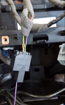

Pic 2 :  Connector from Navi900 display (pink wire cutted in middle position)

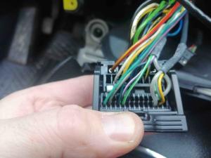

Pic 3 :  Connecter from head unit
Pic 4 :  Connector from Navi900 (pos 2 connect to pink wire (pic 2)
Pic 6 :  CD400  panel connect
Pic 7 :  Navi900 panel connect

Problem solved , big thanks to Rusty2009
Glad you sorted this out using the above method. I m afraid there is no easy way to change what each button do

1) CD500 button panel - is it a definite no-go or still usable with some alterations to the wiring?
1.1) If CD500 button panel is unusable, then is just buying a CD400 panel enough to get everything working properly?
2) Is the Android HU able to change some of the car settings (rear wiper, automatic locking, etc..) as well?
Well, now I'm exactly in the same position as OP.
Original CD500 panel lights up but all the button's functions are messed up (as expected).
When I connect a CD400 panel, then nothing happens (seems to be also an expected behavior).
Tried one of the tips shared here - cutting the purple wire from the display and connecting it to the second empty pin slot at the connector plug. Didn't work. Panel still doesn't light up.
Also, the new HU's wiring loom has a single purple wire with a connector. Another end of that goes to the CANBUS box.
On different pictures I've found over the internet, it seems to be connected with one of the display connectors. Looking more closely I discovered that it's exactly the same purple wire that I should cut to get the panel working.
