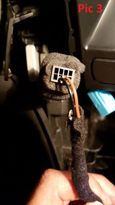

Hello I'am a newbie from The Netherlands. I seriously need help. My car is an Astra J GTC 2012 with Navi 900. After colour scheme update the unit crashed. So I replaced it with an Android 5.1 head init. I can use my Navi 900 control panel in combination with the head unit (the push buttons are not correct, when I push PHONE the NAVI app starts up). On Ebay I bought an used CD 400 panel.
I did the wiring as showed on Youtube (OPC Club Franken) :
https://www.youtube.com/watch?v=GvSAB8IKEXw
Unfortunately for me it did not work, the CD 400 did not light up.
Is it possible to re-wire?
Pic 2 :  Connector from Navi900 display (pink wire cutted in middle position)
Pic 3 :  Connecter from head unit
Pic 4 :  Connector from Navi900 (pos 2 connect to pink wire (pic 2)
Pic 6 :  CD400  panel connect
Pic 7 :  Navi900 panel connect

Problem solved , big thanks to Rusty2009
