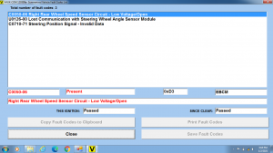

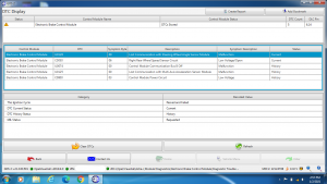

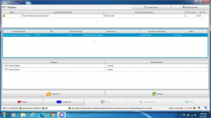

The faults are:
U0126-00 Lost Communication with steering wheel angle sensor module
B2955-00 Security sensor data circuit
C0710-71 Steering Position Signal
B1405-05 Control module voltage reference output 2 circuit - High voltage / open
U152D-00 LIN Bus 2 lost communication with device 13
U1538-00 LIN Bus 3 lost communication with device 8

C0050-06 Right rear wheel speed sensor circuit - Low voltage / open
They did not mention this in the garage.
