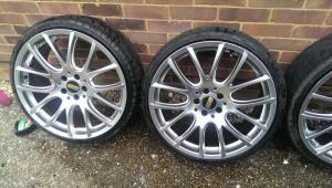

Hi guys,
Has anyone fitted 20" wheels to a 5dr J?
Reason being is I've found a set of 20" wheels which are 5x112 & ET35 - I'm fairly sure these will fit with wobbly bolts?
Just don't want to waste £400 odd if they'll look way too big.
rusty had 19 with a 45 profile and they rubbed the inside arch
the 19 profile is 40 so if you were to fit a 20 inch alloy the profile at a guess
would have to be about 30 and that is going to give a harsh ride
as for wobbly bolts that is a chance you have to take
i would not bother and look for 5 115 but up to you mate risky
what size are the tyres and what is on you car now ?
245/30/20 are currently fitted to those.
My car is a standard SRI with 17's.
