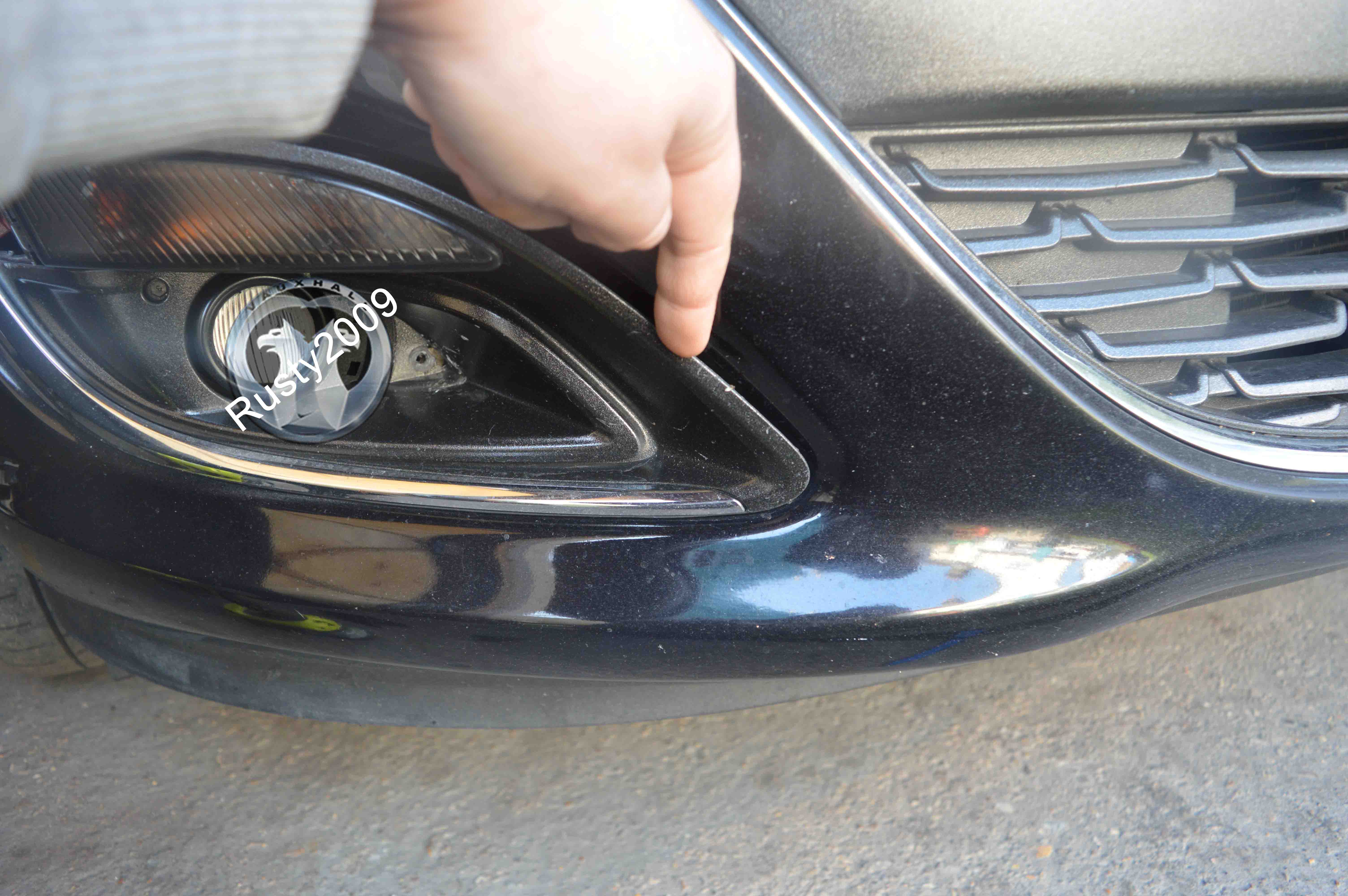

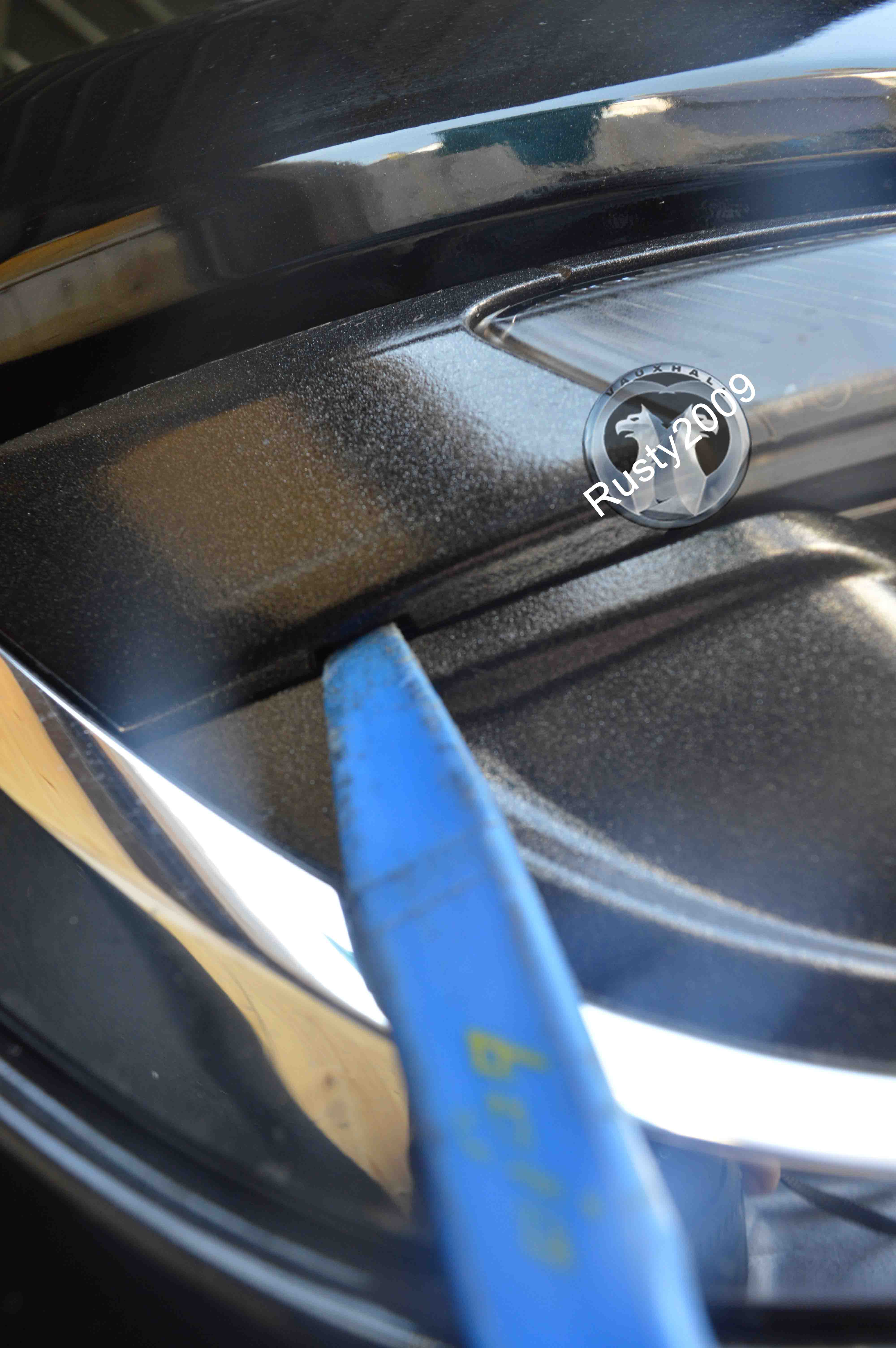

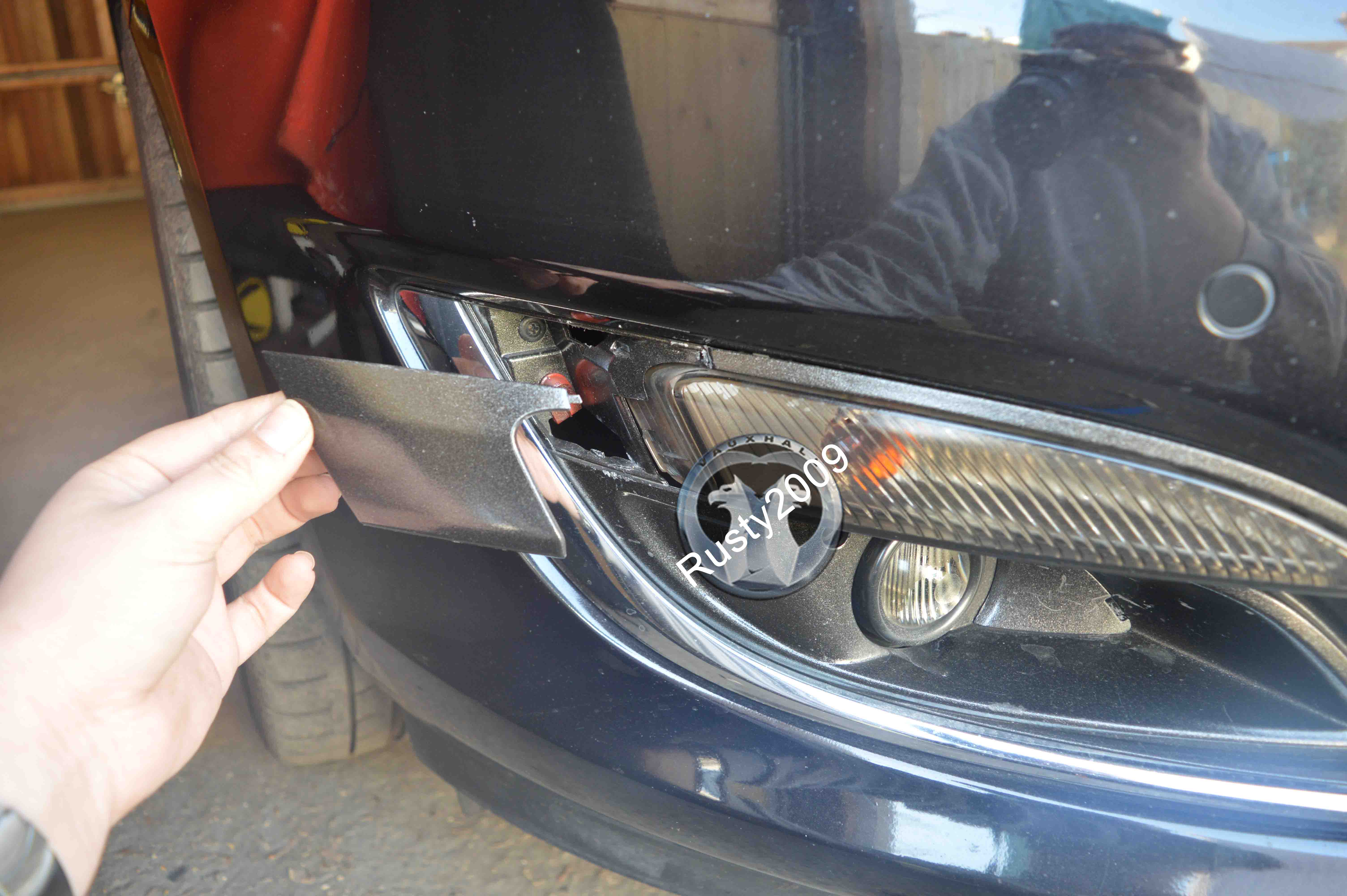

Ok so the first thing we need to do is pop the two covers off that are hiding the screws.

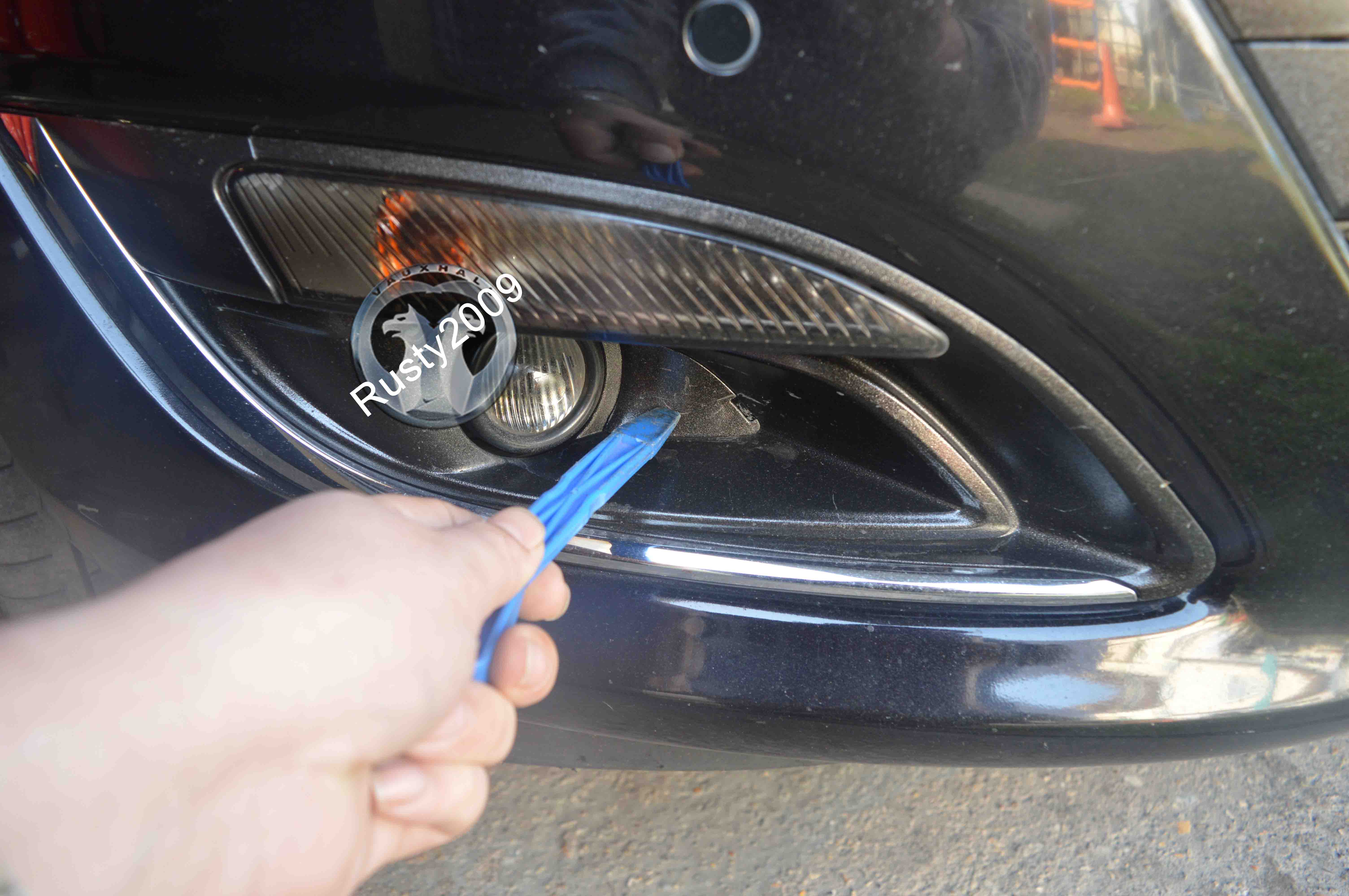

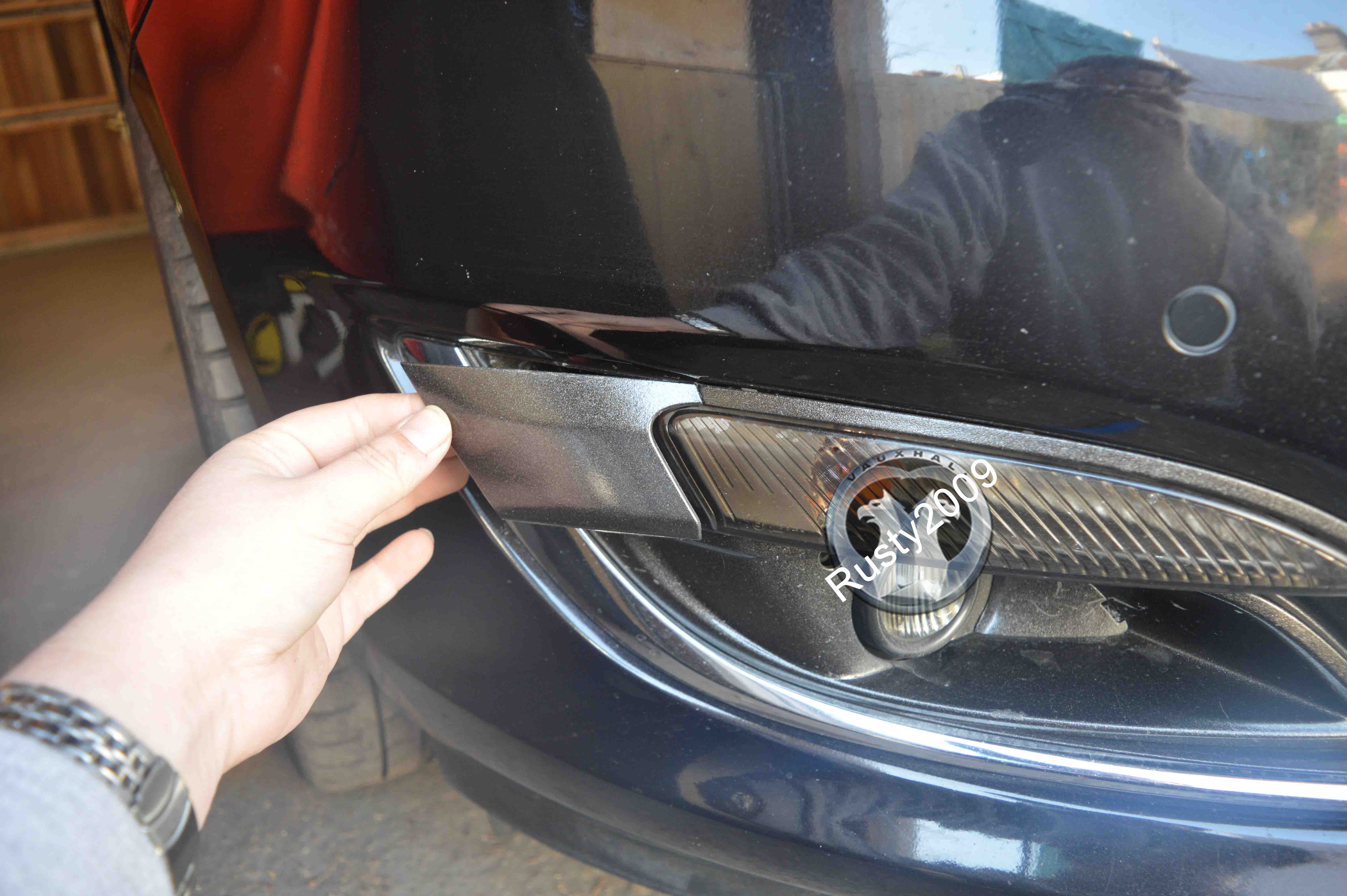

So we shall start with the top one, so grab your trim tool there is a slit which will allow you pop this cover of it's very tight.

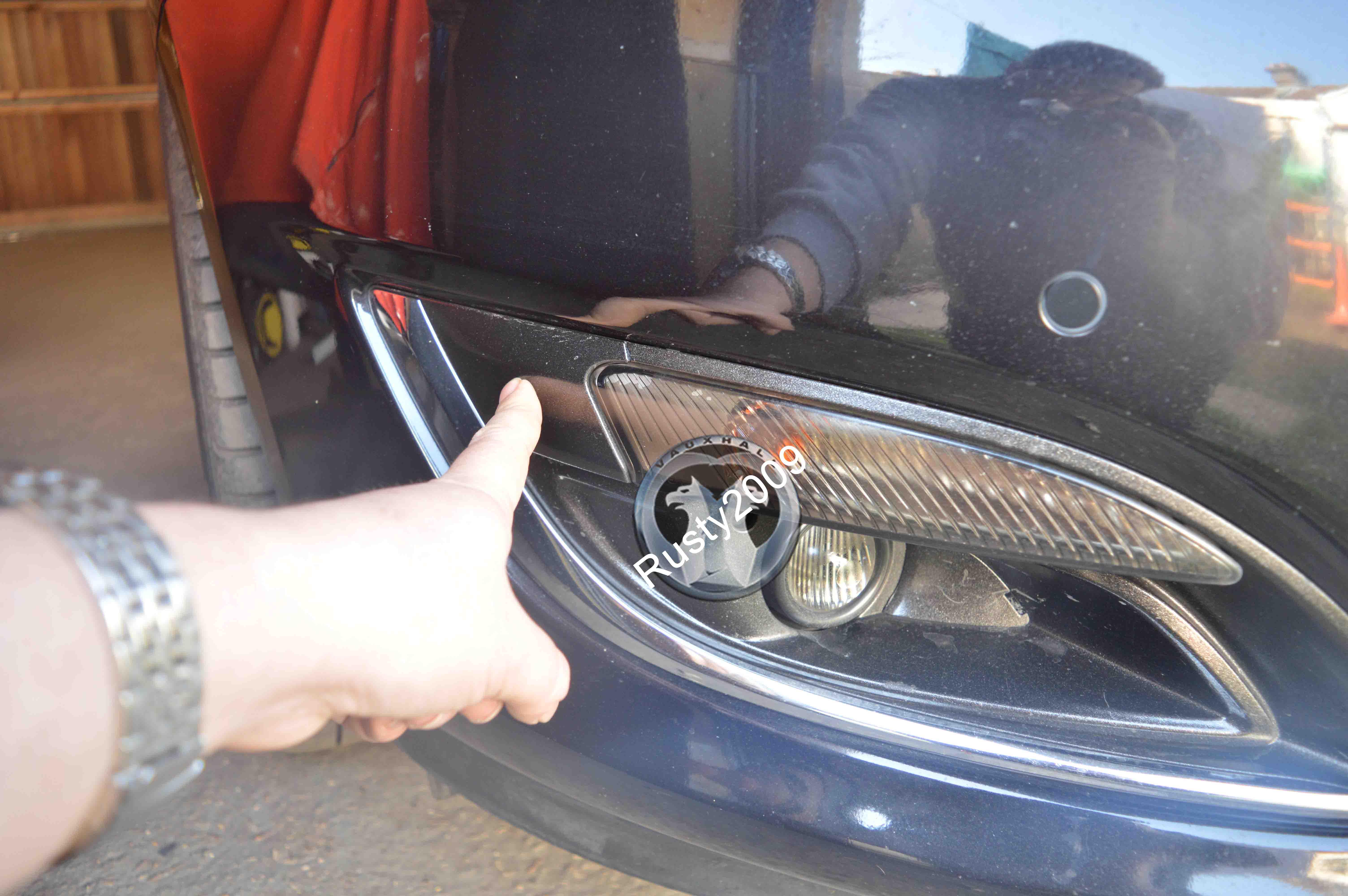

Once it popped off so far you then need to pull it towards the back of the car.

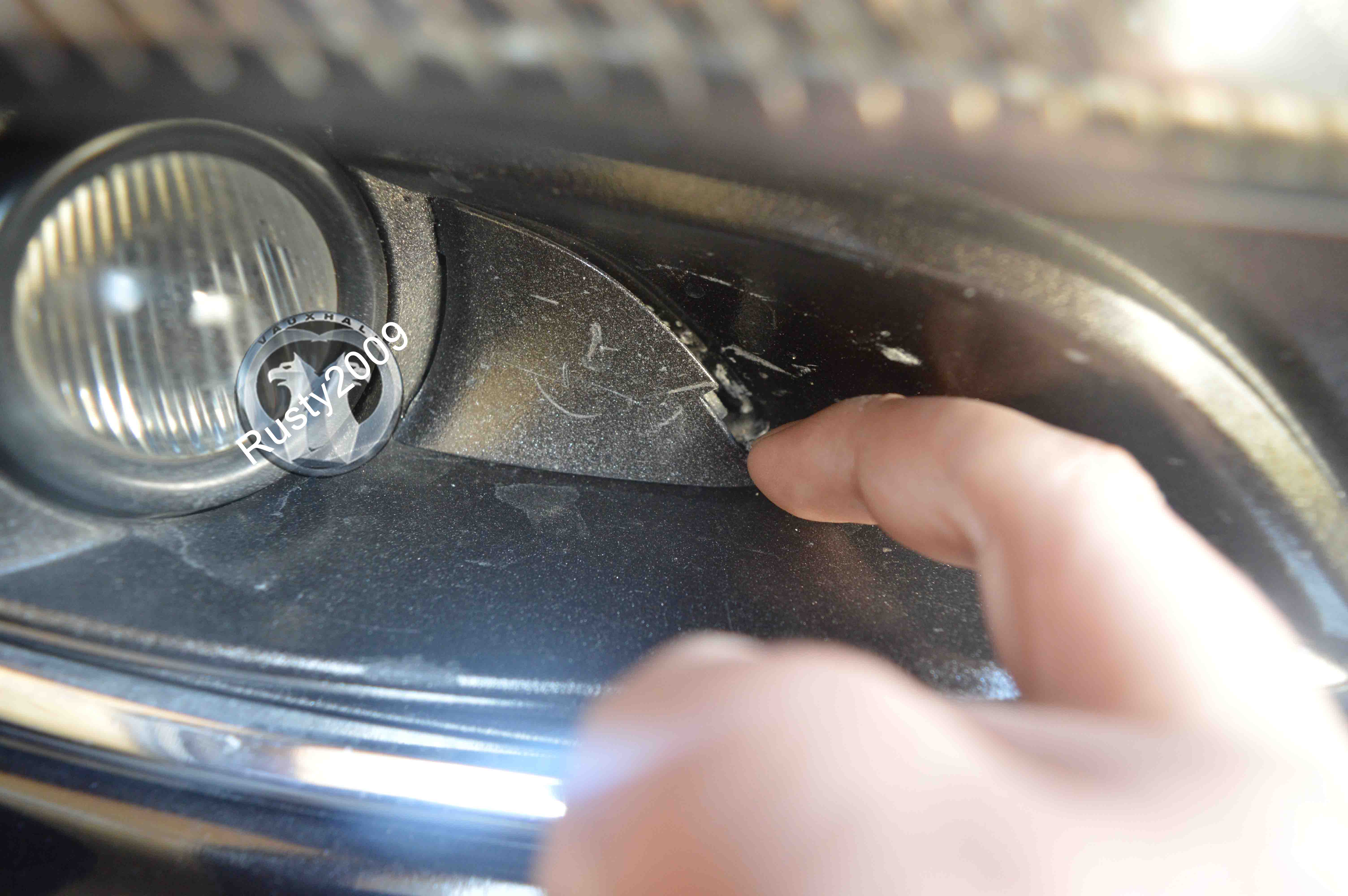

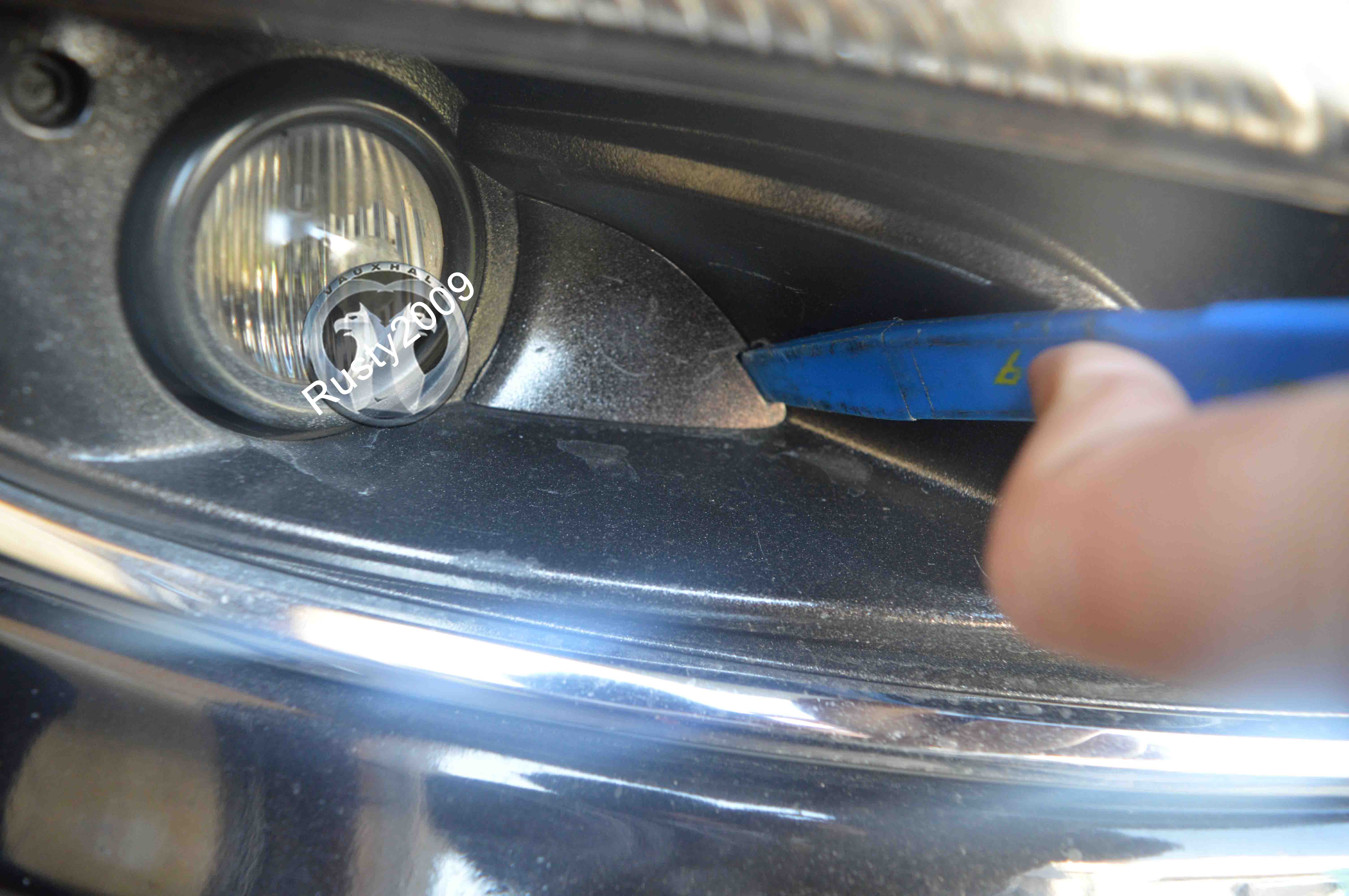

Now onto the bottom cover, again there is slit for getting the trim tool in, and you just pull towards you (be careful I broke mine the first time I did it).

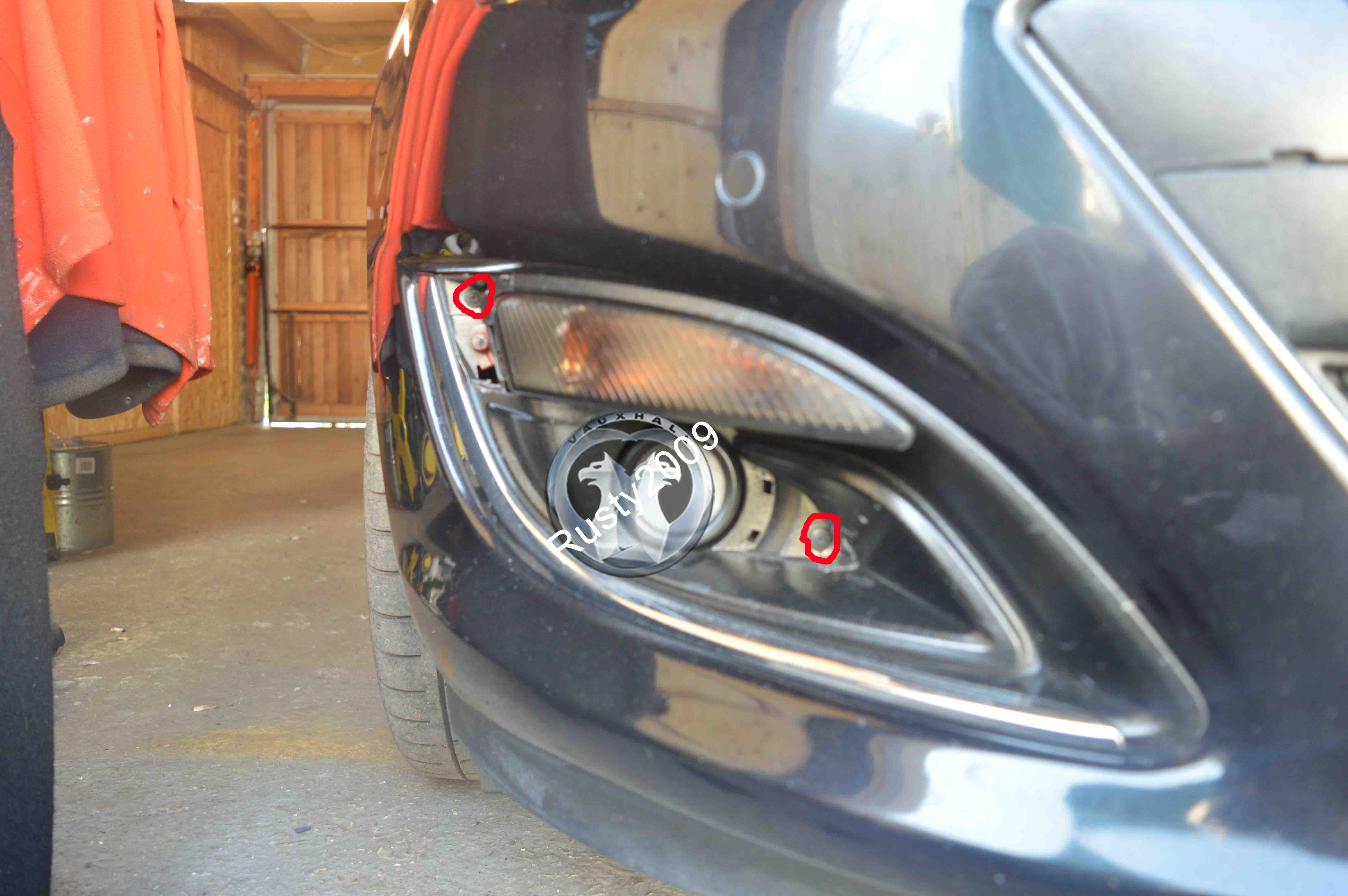

Now undo the screws one behind each cover.

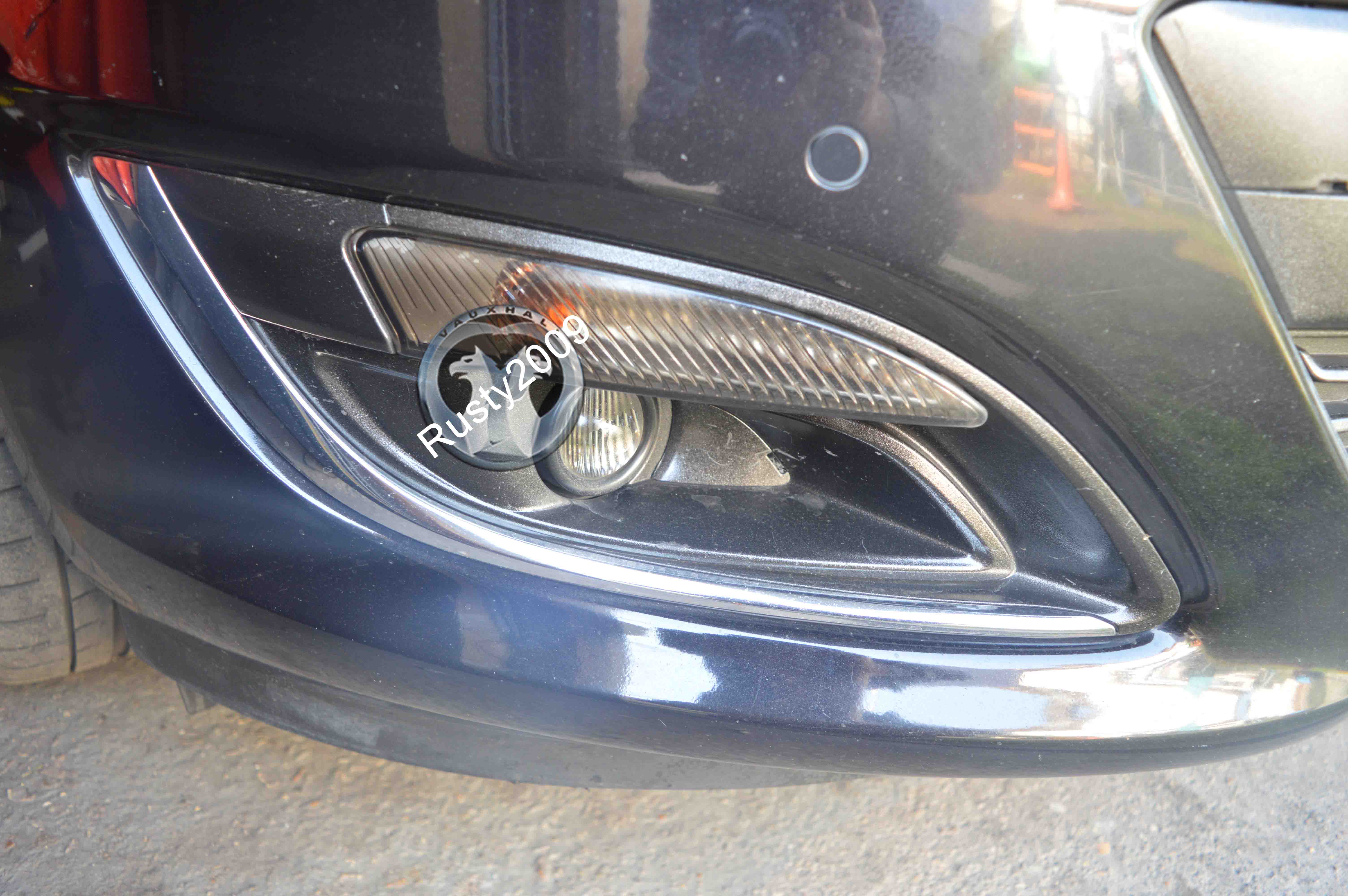

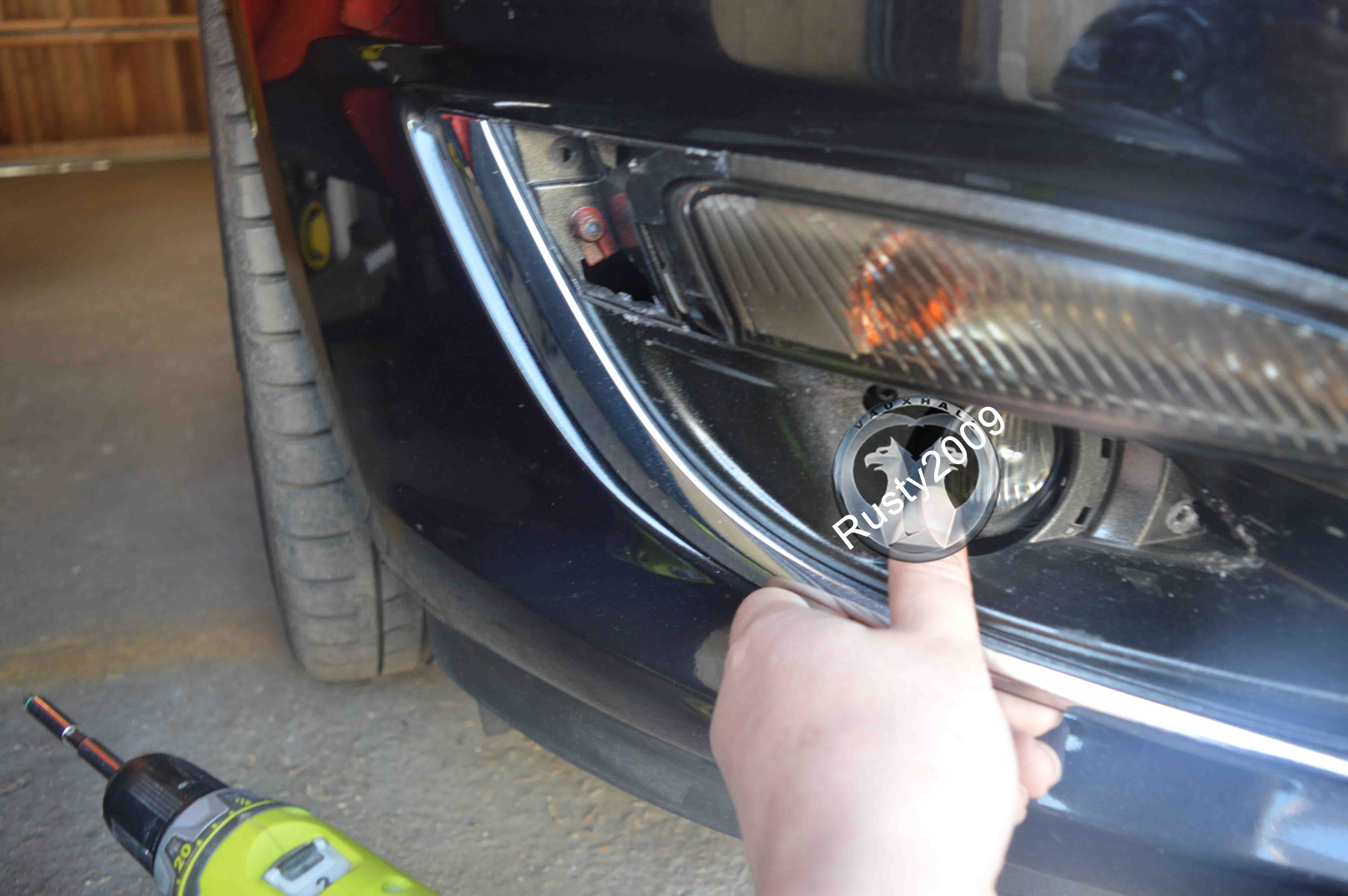

Now pull the surround towards you from the grill side (Be warned there is a very flimsy plastic clip here that could break).

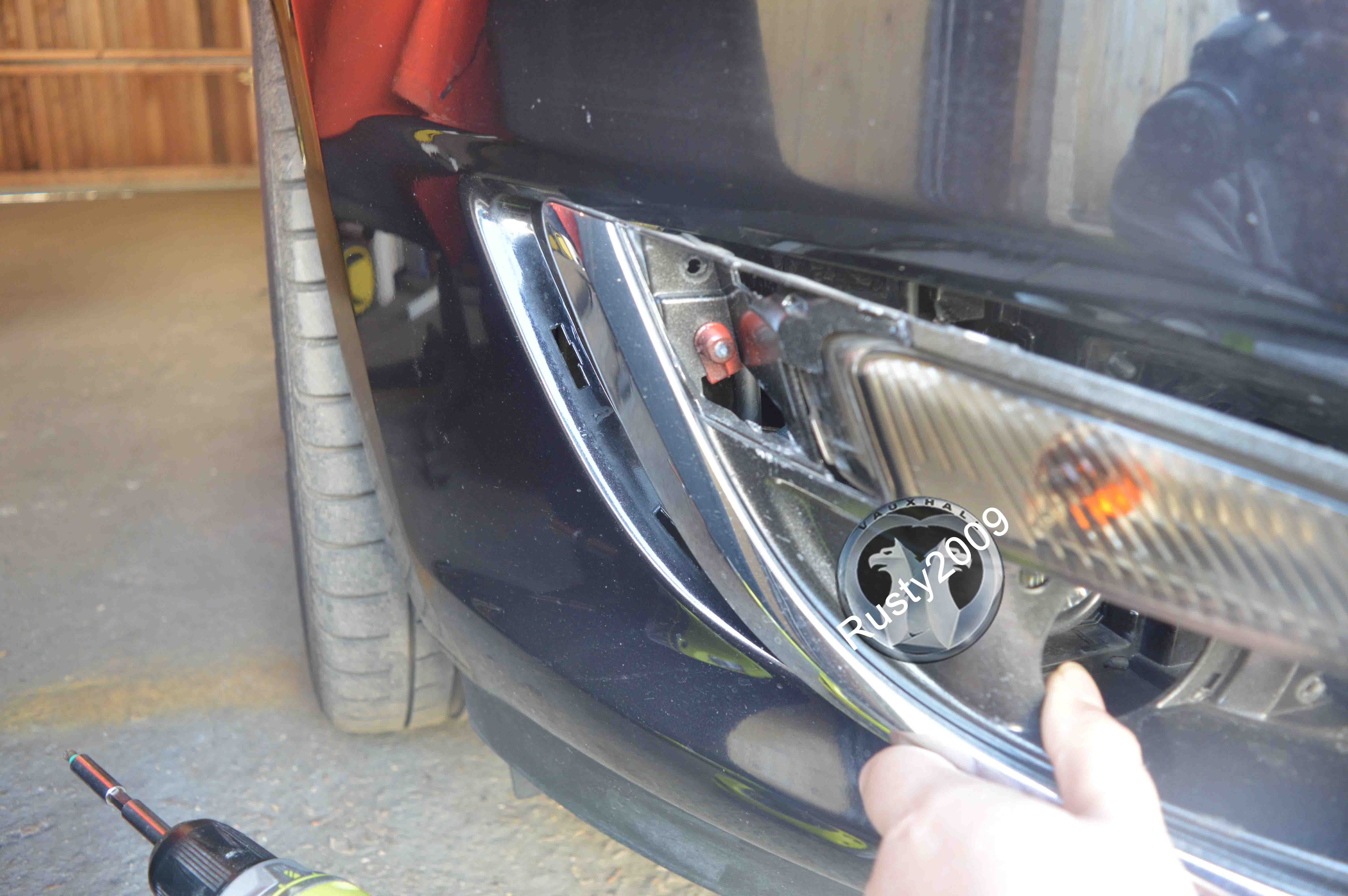

Once free then you need to pull the outside towards you.
Now you can change the indicator bulb if needed.

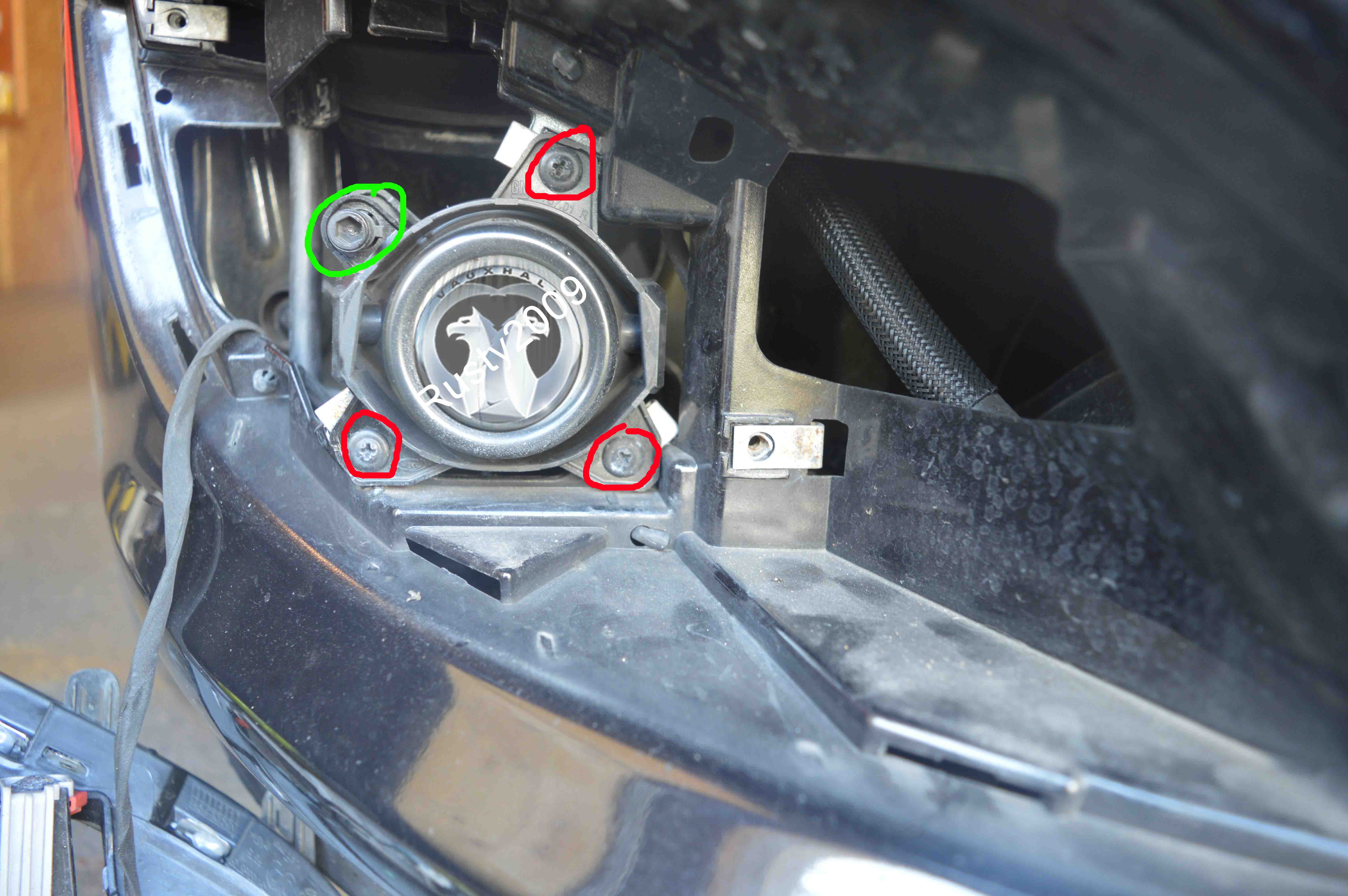

If you want to remove the fog light then undo the 3 screws marked in RED, the one marked green is for adjustment.
